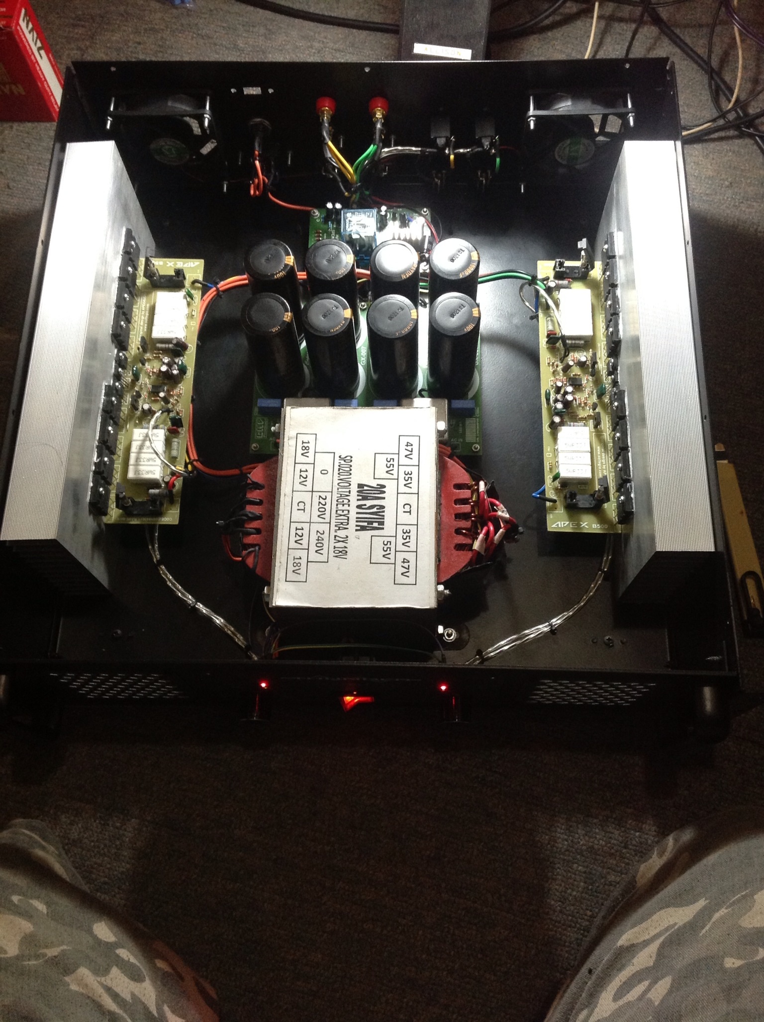

Just finish build another 3 B500 amp. So amazing, i don't have any difficulties to finish this amp. Again thank you so much for sharing your knowledge.
