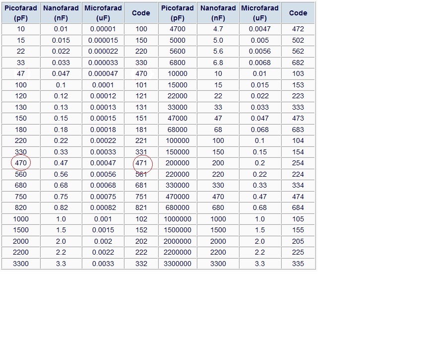

Hello Jaagut,
471 equates to 470pF, 471 and 470 are same thing, both 470pF, so this one's correct.
However, 33pF cap should have 33 printed on either side,
331 and 330 both equates to 330pF, so this one's incorrect.

anybody who can confirm regarding capacitor codes to my previous post #2518? thanks in advance.
Hello Jaagut,
Aniket
Big thanks Aniket!
If I found caps marked with 100 to 470, I would measure every one of them to ensure they are indeed <=47pF

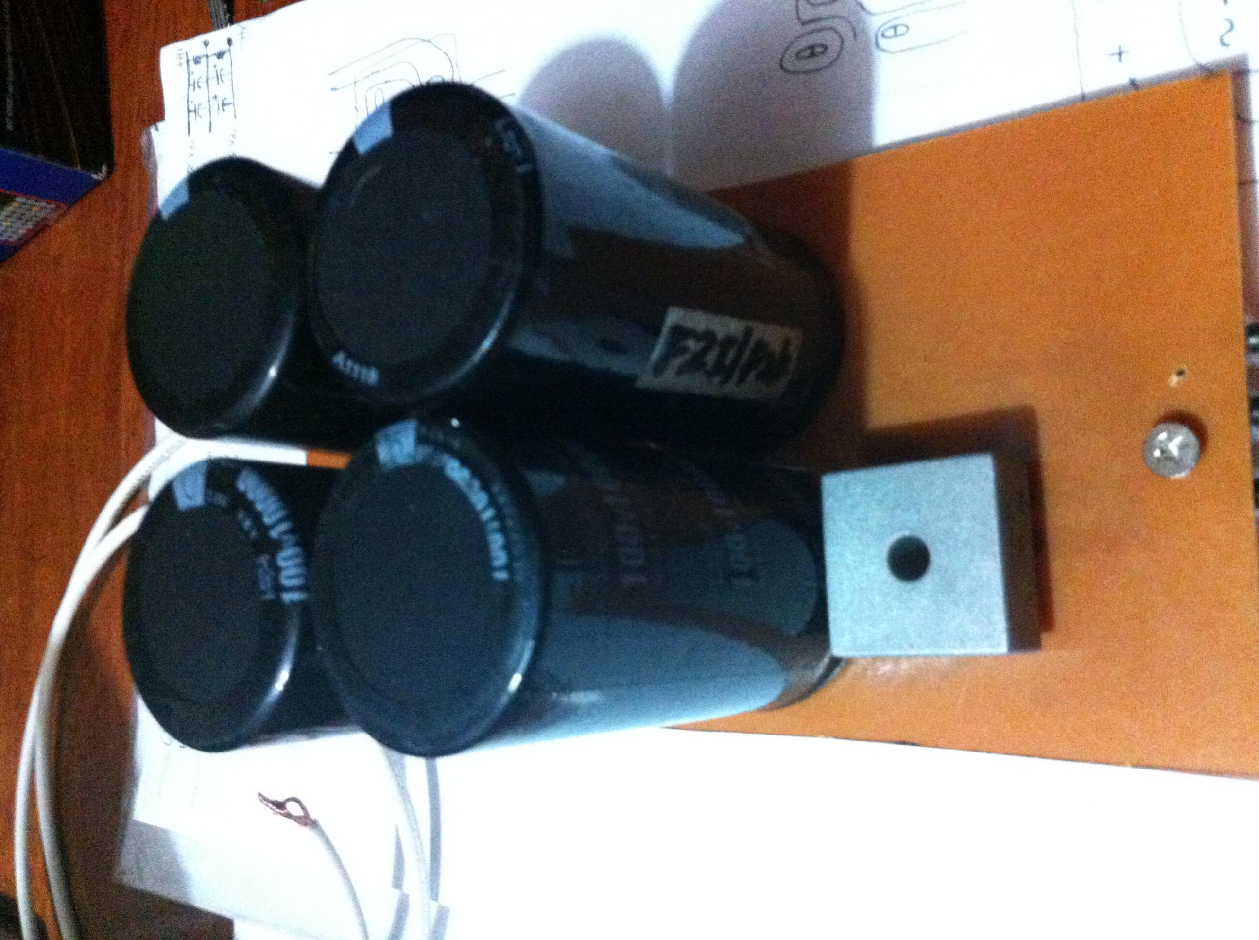

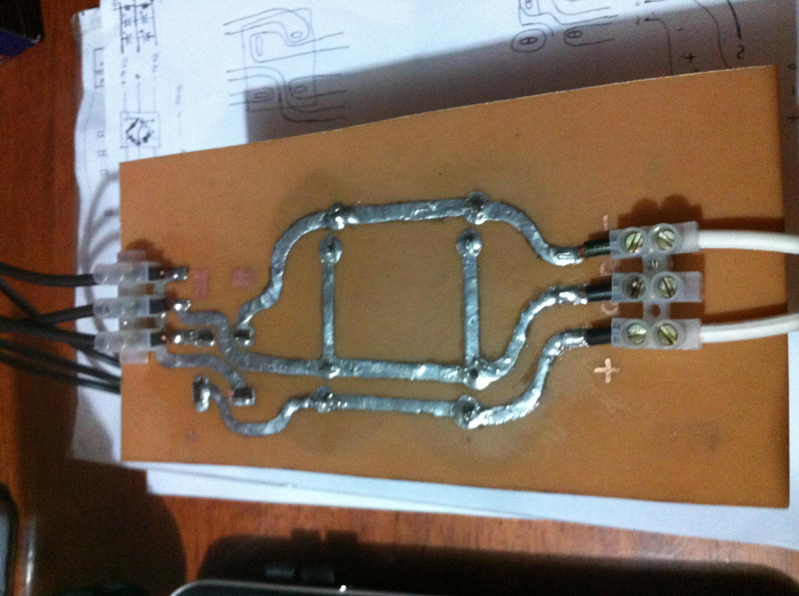

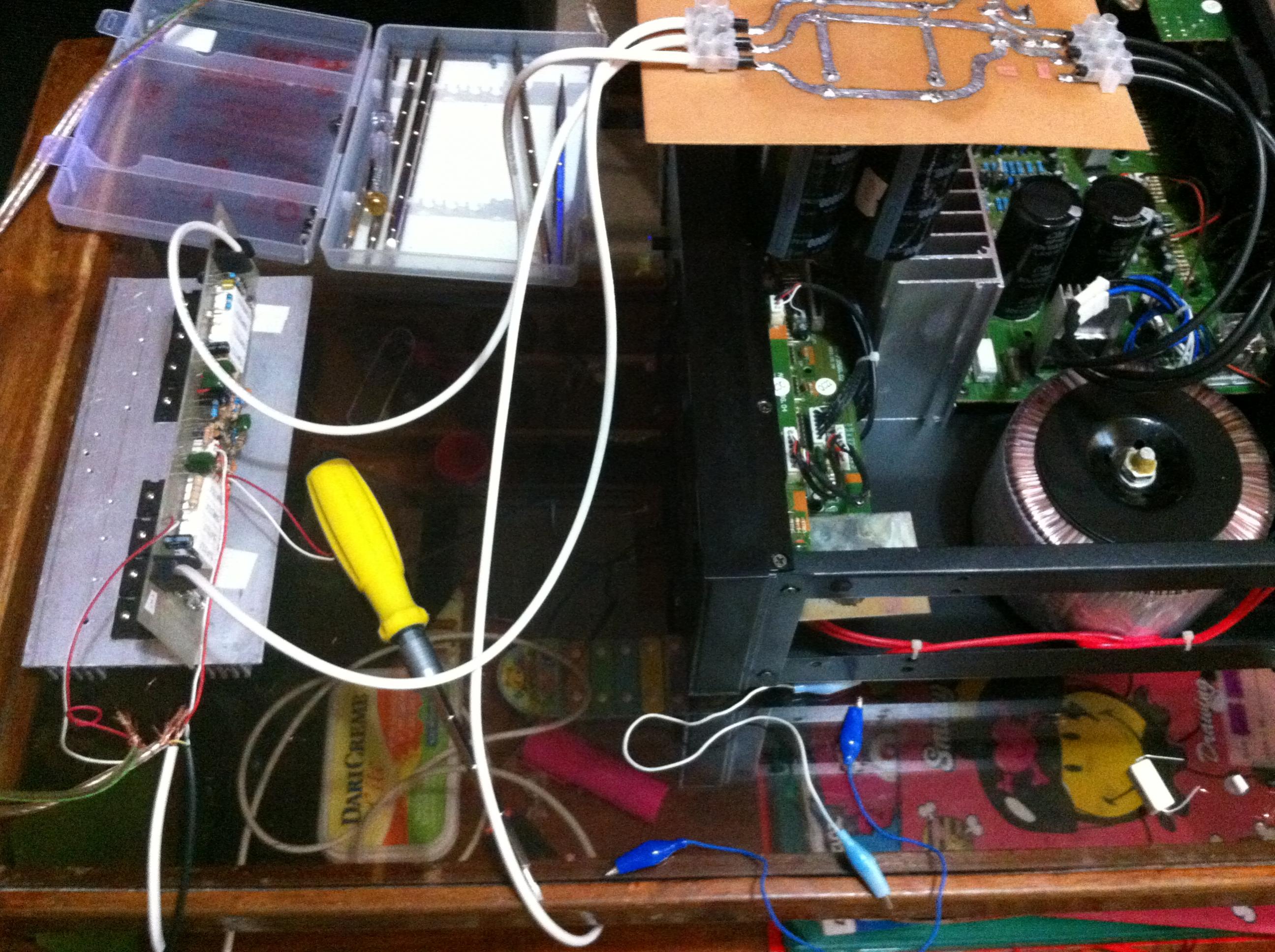

pics of the testing.
no hiccup during testing, no blown fuses, although some sparks occur in the PSU board due to loose contact in one of the capacitor pin, overall it is success. after confirmation that output DC offsets read 10mV, I connected the speaker and fed some music on the input signal.
my impression, the sound is pleasing, crisp and clear, better than my commercial amplifier in terms of sound quality.
i'm using 45-0-45Vac transformer temporarily from my existing commercial amp.
off to make additional channel for stereo mode.
many thanks apex for the good design of this amplifier! 😎

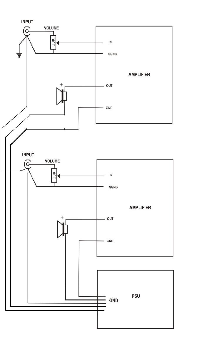

Hi Apex and friends!
I have 2 channels of B500 connected to only one PSU. My torroidal transformer is giving output of 2x55vac to rectifier giving an output +/-80vdc rail voltage.
All grounds (input, output and speakers) of 2x B500 are connected to the PSU ground. Signal input of one B500 is connected to left signal source while the other is connected to right signal source. Although the 2x B500 is working, however the sound is not so clean because some noise or hum is present. How do I correct this problem?
Note: If I remove one of the B500, the other one performs a clean sound. No hum is present.

a picture of your set-up helps...make sure your speaker ground return leads go direct to psu 0volt point abd not thru any pcb gound...

Attached illustrates how I set the ground wirings.
Try to disconnect the one without noise and see if the noise still exist on the suspected one, if the noise disappear while anyone of them is disconnected then there must be grounding issue somewhere.....

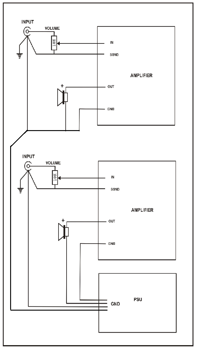

There's your mistake..........All grounds (input, output and speakers) of 2x B500 are connected to the PSU ground. ............. the sound is not so clean because some noise or hum is present. ...........
Never use the PSU Zero Volts as the Main Audio Ground (MAG).
Build a separate MAG with it's location optimised for good audio signal processing.
Bring a wire from the PSU Zero Volts to the MAG.
do not allow your signal ground share the same wire as your speaker ground wire, run them separate going to the 0 voltage(ground) point...
Use this ground wireing circuit.
Please enlighten me, what is the technical difference of using separate wires down to the PSU ground against bringing one single wire from PSU ground to a common single connection point where all ground wires meet? 😕
The charging current pulses in the transformer secondary circuit MUST NOT be allowed to contaminate any other signal return connection.
The easiset way to avoid that is to take a single wire from the PSU zero volts to the MAG.
The MAG MUST be located for best audio performance. That location is usually not at the PSU.
