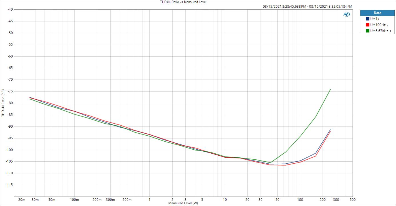

Have you posted any phase plots?
I’m just curious as I have been reading about Technics GaN implementation about higher switching speeds.
Not that I’m unhappy, your amps are spectacular, I got my mono block for my center channel built yesterday. Put it in a slim Ghent case, just missing your beautiful logo : (
GaN Amplifier Module - Orchard Audio
Scroll down to test results section. Phase plots are posted.
