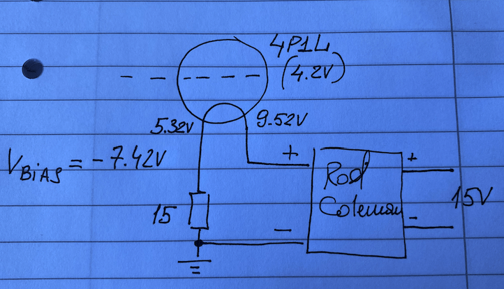

So then in the case above,
Bias voltage is 0.355A * 15 Ohm + 2.1V = -7.42V ?
3.) Raw DC for R.C:
Rbias*filament current + filament voltage + 5-6V headroom for R.C. regulator.
Rod has mentioned about 2.6V of headroom in his instruction. so is 5-6V better sounding?

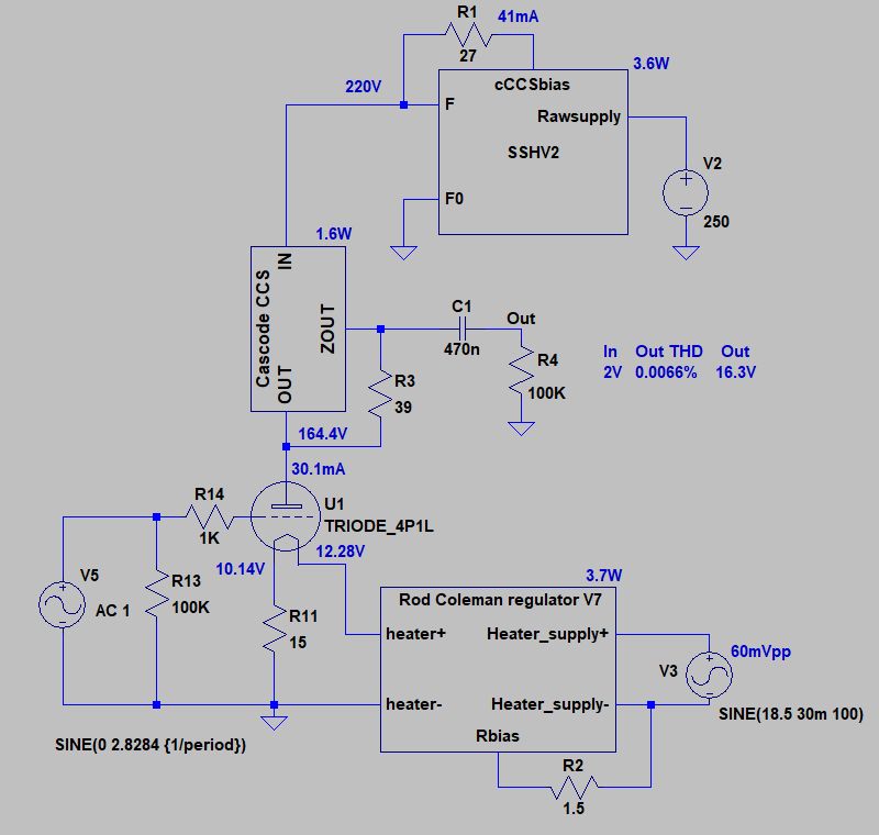

BTW. such (#1780) low bias -for me- only acceptable if the anode load is CCS, else distortion would be growing.
Would you recommend having -8V or -9V of bias for 4p1l?
What's the load of 4P1L?
CCS, gyrator, transformer, resistor .....
If the last two, how many the impedance?

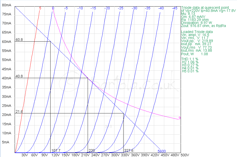

For preamp the "recommended" anode current is 25..40mA.
Desired anode current and estimated anode (relative to cathode) voltage determinates operating point.
This operating point -on trioded curves- and load (impedance) defines working range.
Sample:
With a 4P1L I and others found it sounds fuller at 25mA up to 35mA, otherwise it was a trifle skinny sounding. So that points to a plate choke or CCS rather than a resistor. The 2P29L sounds nice with a resistor which if you have 300v B+ can be around 12mA. I like resistor loads - they sound purest to me for the timbre of acoustic instruments and voices, so I use 2P29L in preference, or indeed 10Y or 46. But as Bela says, a resistor is not viable for the 4P1L unless you have very high B+ which is unlikely and un-needed.

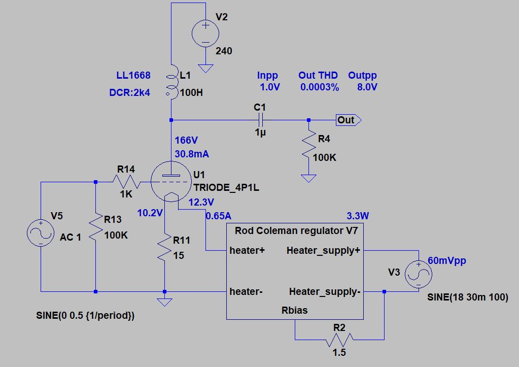

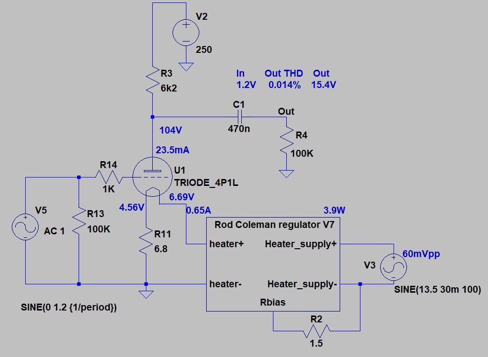

it looks like the second pic is closer to my case.. but with a 2.1V filament supply
so, 0.65*6.8+1.1V or - 5.52V bias for resistor load, right?

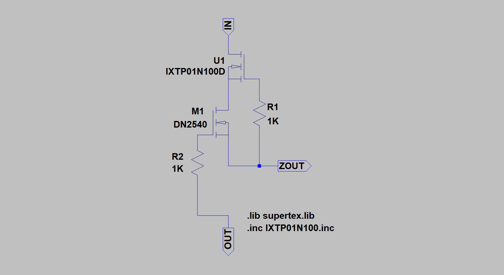

what is the "cascode CSS"? I do not find anything in google
