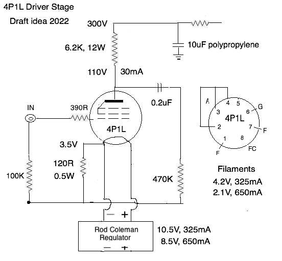

I may try a 4P1L driver stage into a SE EL12n. That's an East German tube which sounds good in triode, and no top cap. Old Y8A base and mu of around 18 in triode. 18W dissipation. I'll try 4P1L and 2P29L. I have a 2P29L stage up and running so that shouldn't take long to set up. I've always 4P1L in filament bias before but I'm wondering if this would work, att.

Hi Andy,
for 4P1L, gm is nominally 6mA/V. That makes an intrinsic cathode 'resistance' of ca. 167Ω, so using an external resistor of 120Ω is a bit too high: it will reduce gm to ca. 3.5mA/V and raise ra correspondingly (bad for driving purposes).
How about using Rk of 10-12Ω, and using filament bias with 650mA filament current (parallel-connected filament-halves is the best way in all cases: lower Uf reduces the skew of bias across the filament).
The bias becomes 6.5-8V, and you can adjust Ua to get the desired anode current.
A 10-12Ω cathode resistor will keep the 4P1L performance at the optimum for driver applications.
Hi Andy, for 4P1L, gm is nominally 6mA/V. That makes an intrinsic cathode 'resistance' of ca. 167Ω, so using an external resistor of 120Ω is a bit too high: it will reduce gm to ca. 3.5mA/V and raise ra correspondingly (bad for driving purposes). How about using Rk of 10-12Ω, and using filament bias with 650mA filament current (parallel-connected filament-halves is the best way in all cases: lower Uf reduces the skew of bias across the filament). The bias becomes 6.5-8V, and you can adjust Ua to get the desired anode current. A 10-12Ω cathode resistor will keep the 4P1L performance at the optimum for driver applications.

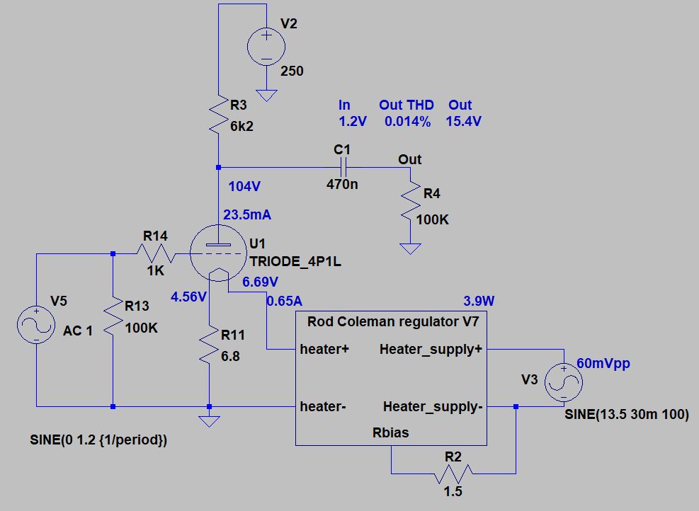

I've made a note of your values, one version of which comes out at 6.75V bias, 10R cathode resistor, 141V on anode, 296V B+, anode resistor of 6.2K, 25mA current. Filament supply would be 15V DC
For practical purposes I want to use a 12V AC transformer for the filament bias supply into your reg, which would give more like 13.5V DC with some filtering, so would be looking at a maximum of 4.5V bias. That should be in the ballpark. Cathode resistor of 6.8R

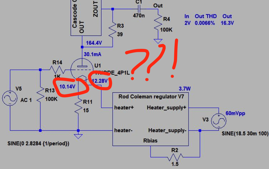

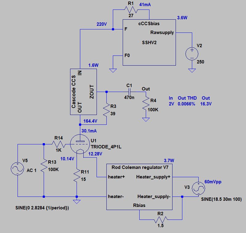

Keep in mind that standard DAC output is 2V rms nominal, and is often more than that, since it makes the SNR look better.
2V rms is ca. 2.84V zero-to-peak, 5.7V peak-to-peak. I think it's risky to offer a DAC-input that can't support at least 8-9V signal swings, like we do with the 26 preamps.
