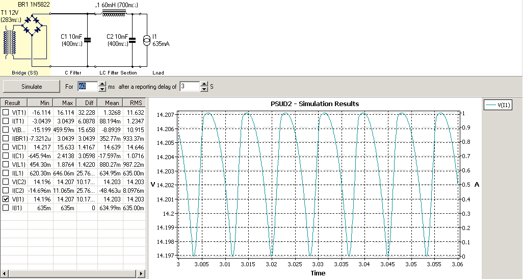

I have been working on a 4P1L project over the past year and a half. I have Rod's regulators and raw supply kit and Ale's gyrator boards.
I am at the stage where I've assembled the raw supply, along with the regulators and ready to test but I would like to get some suggestions on how to proceed and what my first attempt at using PSUD to model the supply looks like.
Using Rod's supply kit with a Hammond 266L24, Wurth ATPG caps, 159ZC as L1 in lieu of R2, a 0.82 R3. When building the model I don't know how to account for having the second dropping resistor on the bottom. I set it to that because it measured similar to the DCR of the choke. I do not know the ESR of the Wurth caps. I measured the parallel connected primary and secondary on the power transformer.
Here is a look at the results I got.

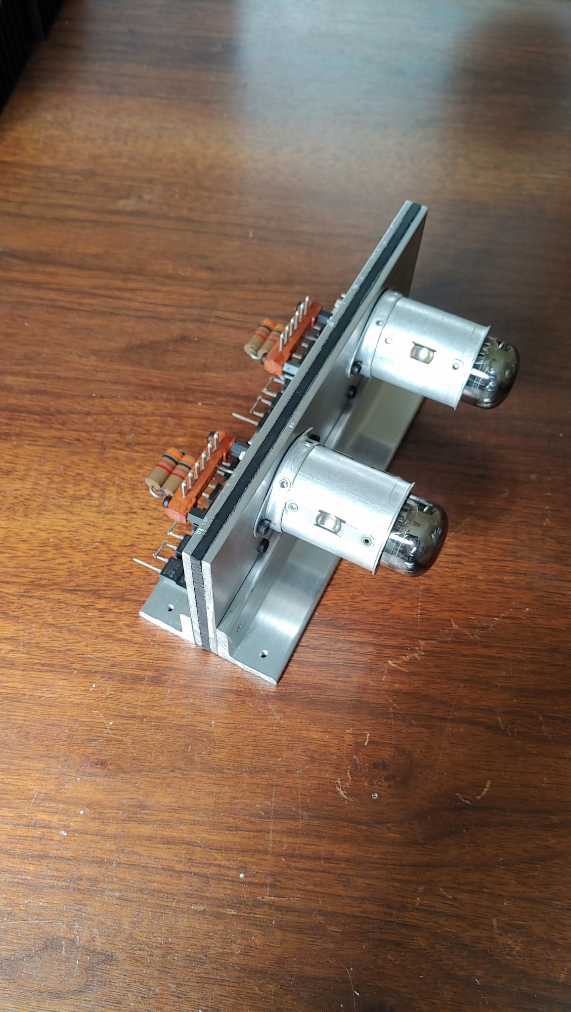

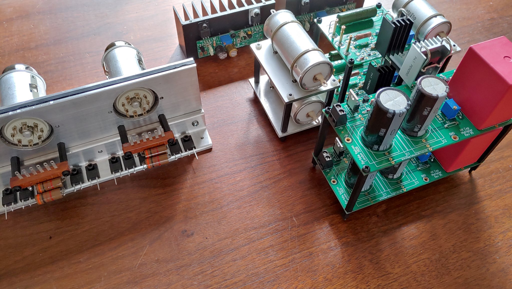

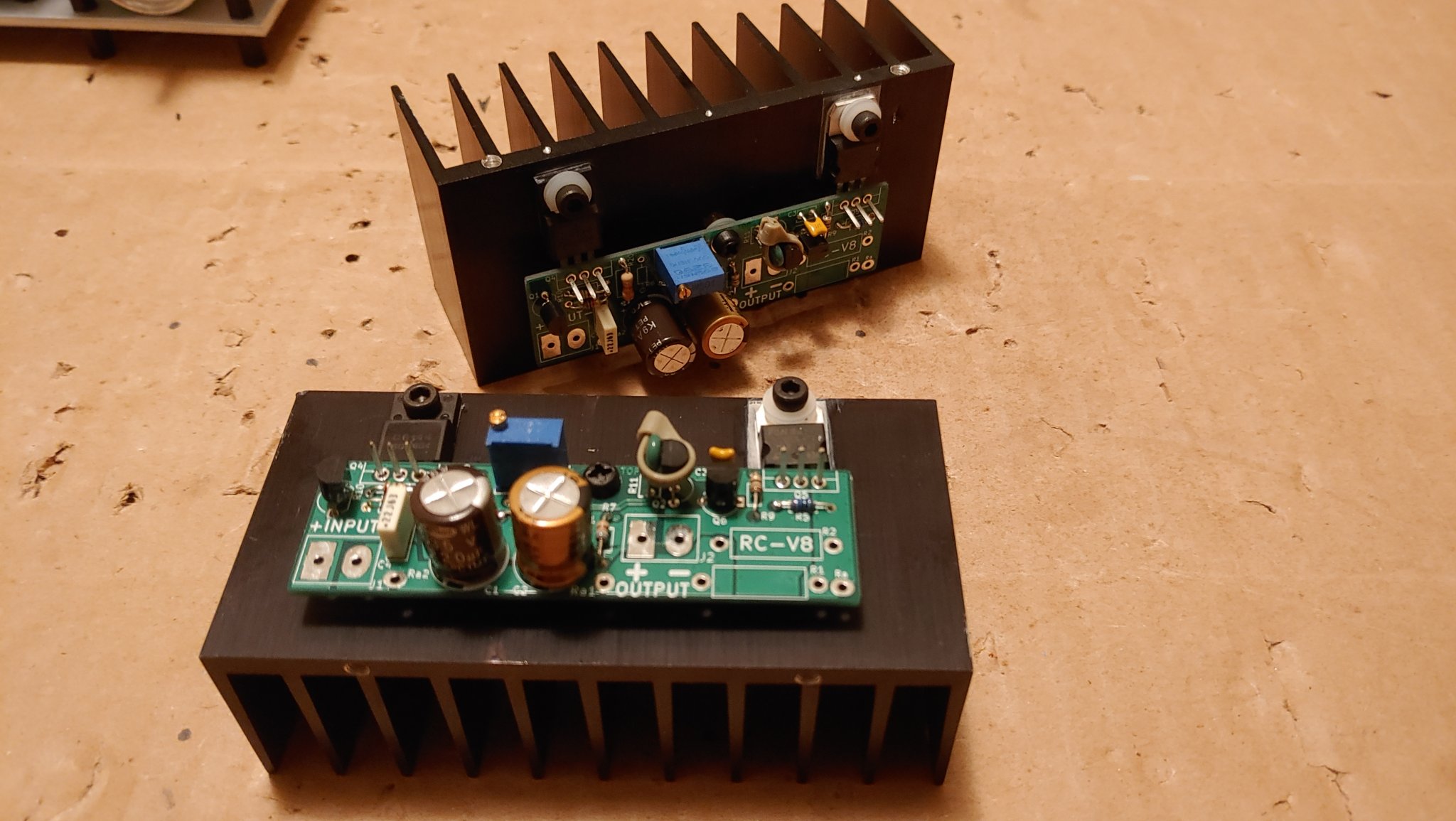

Here are some pictures of the boards and chassis I built to mount the tubes, diodes and grid resistors. I assembled what I call the gyrator tower to fit the FT-3 bypass and output caps. Also seen are Ale's cap multiplier boards in lieu of a HT reg. On hand are the new Bartola HT supply PCB which are having parts sourced and also something I may have questions about when it comes time to model.
I've yet to decide on how I want to implement a volume control. My plan for this preamp was to use its full 19dB of gain in conjunction with an F4 (convert my Aleph J) or some yet to be released SIT high power follower amp from Nelson or Zen Mod.

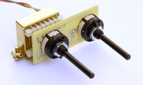

I'm running a 4P1L linestage using Rod Coleman's boards, filament bias, SSHV2 reg, and bottlehead style ccs plate loads, but THE biggest improvement came when I added Dave Slagle autoformers for attenuators. Transparency and you-are-thereness are unbelievable.

The assembly work looks good. What's the little heatsink?
Notes on the filament regulator Raw DC:
I prefer resistor filament bias, but you can easily try the diodes filament biased - just add of subtract diodes to get the approximately correct voltage.
- aim for input voltage 4V above the output;
- PSUD2 value for ESR of 10mF capacitor is about 50m Ohm.
- to account for the dropper resistor in the negative side, simply add the value to the positive side resistor (or the ESR of the choke);
- PSUD2 will give a reasonable estimate for the power transformer if you double click on it, then hit the ... button and put the voltage and current rating in. Use 12% for the regulation value. It then gives you an open circuit voltage and ESR...
