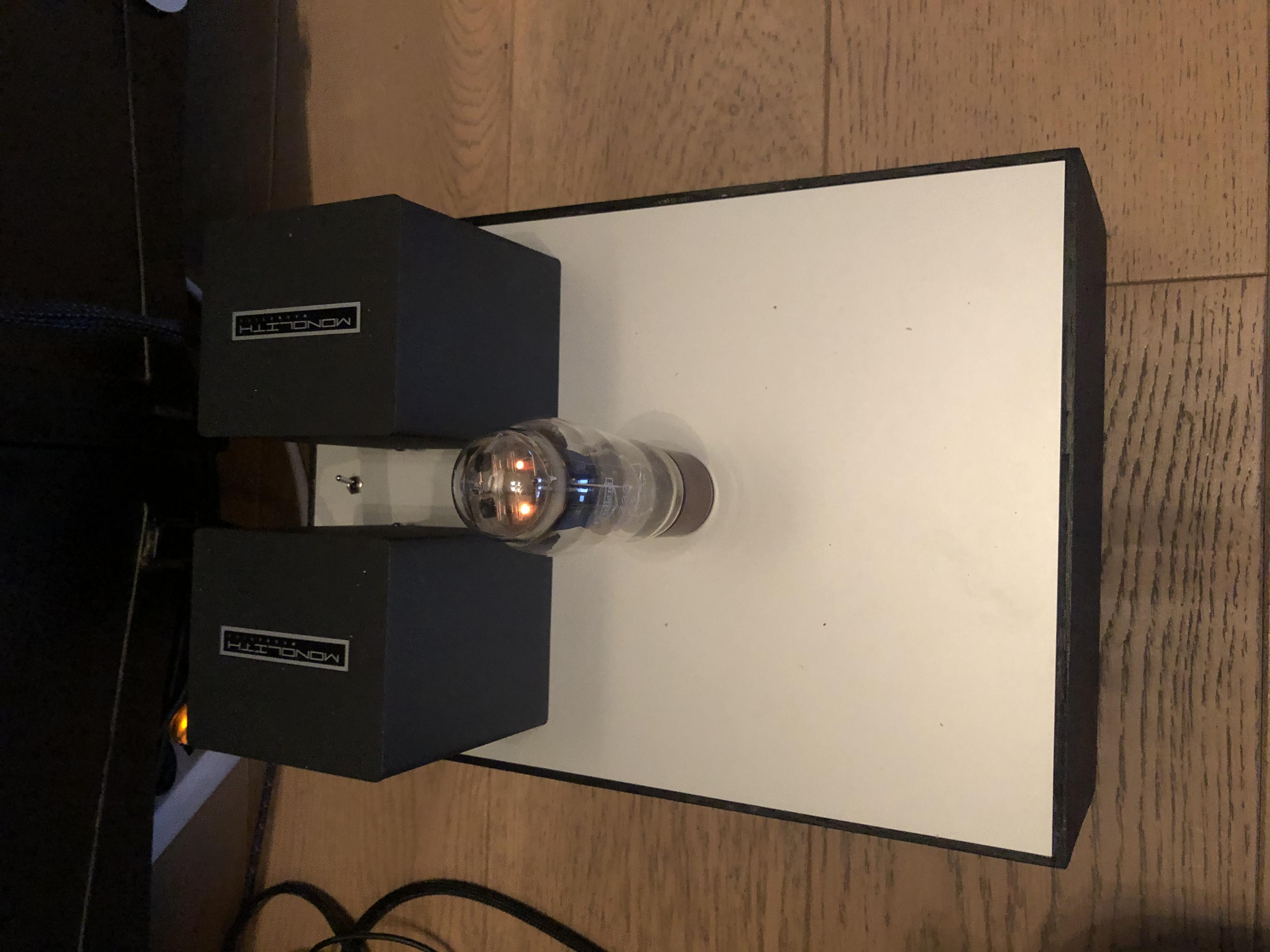

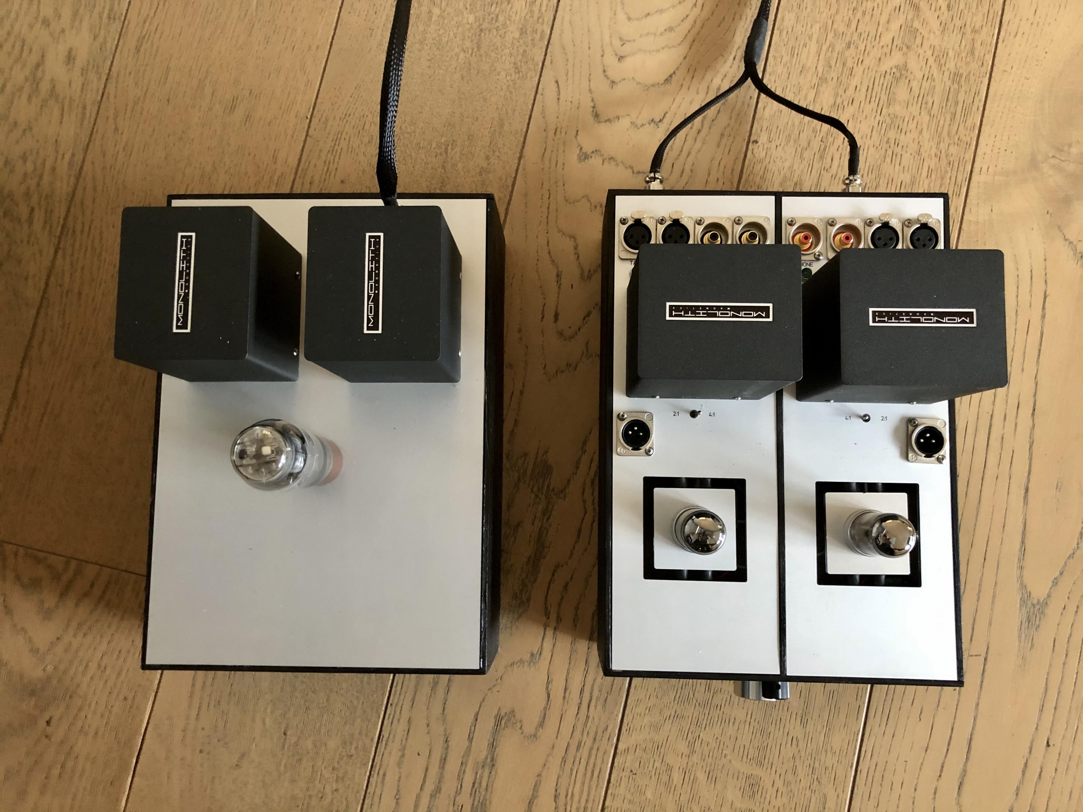

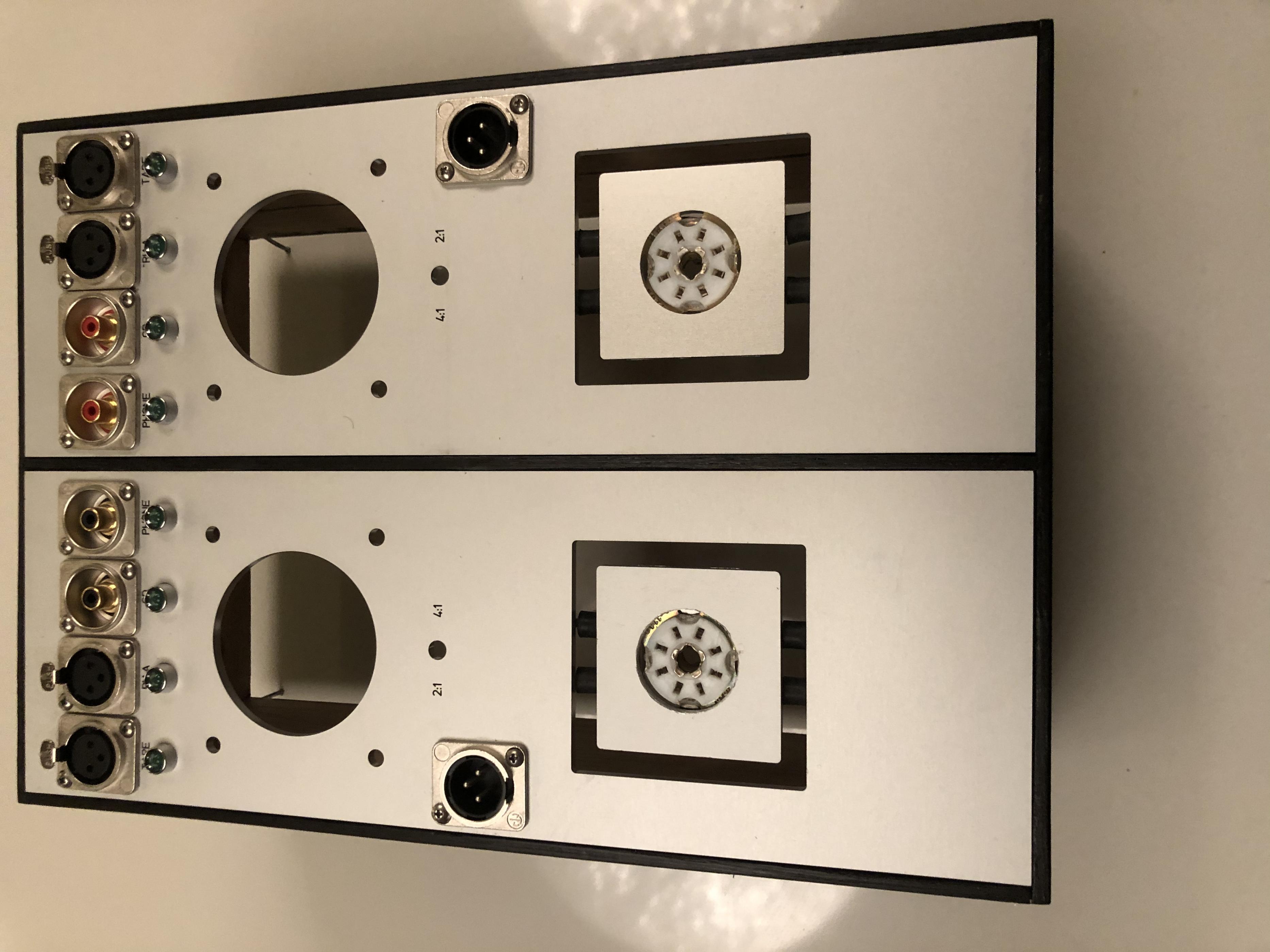

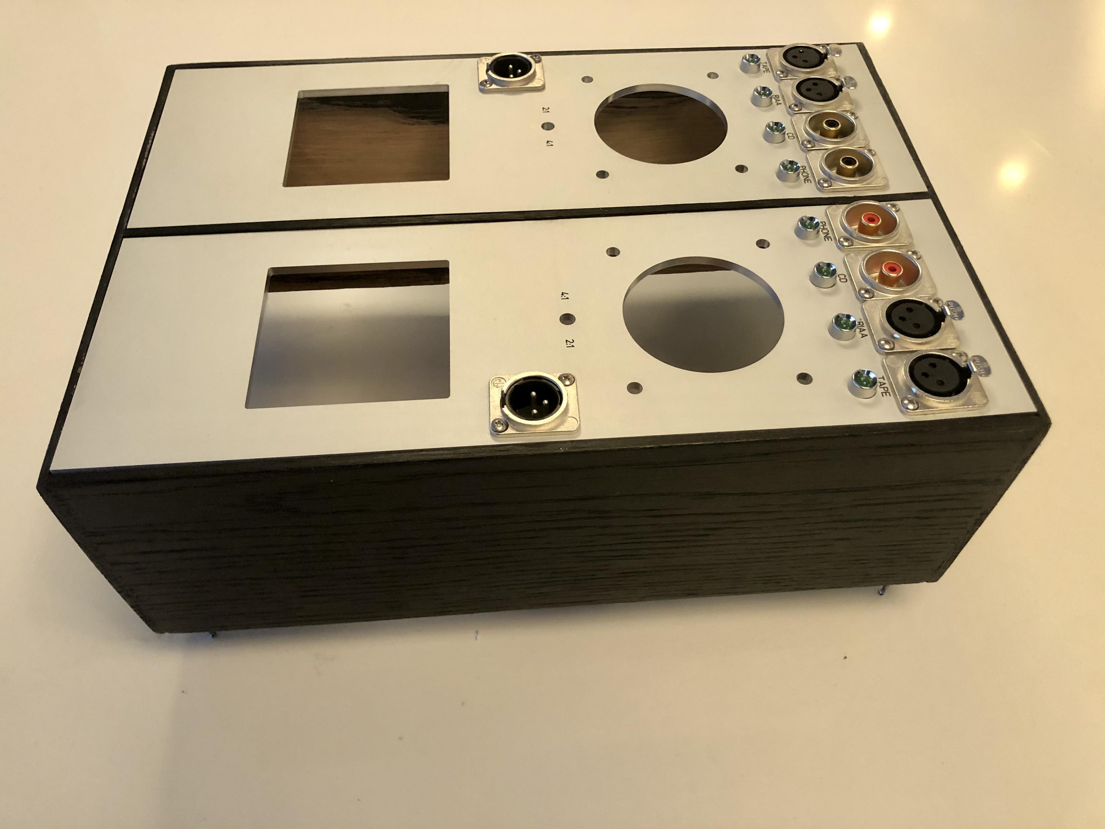

Hi Vegard
That looks amazing!
Ping me an email and I will send you a pair of ceramic Russian NOS socket to get rid of those Chinese ones which aren’t good enough [emoji3]
Such a great build deserves the best components
Ale
