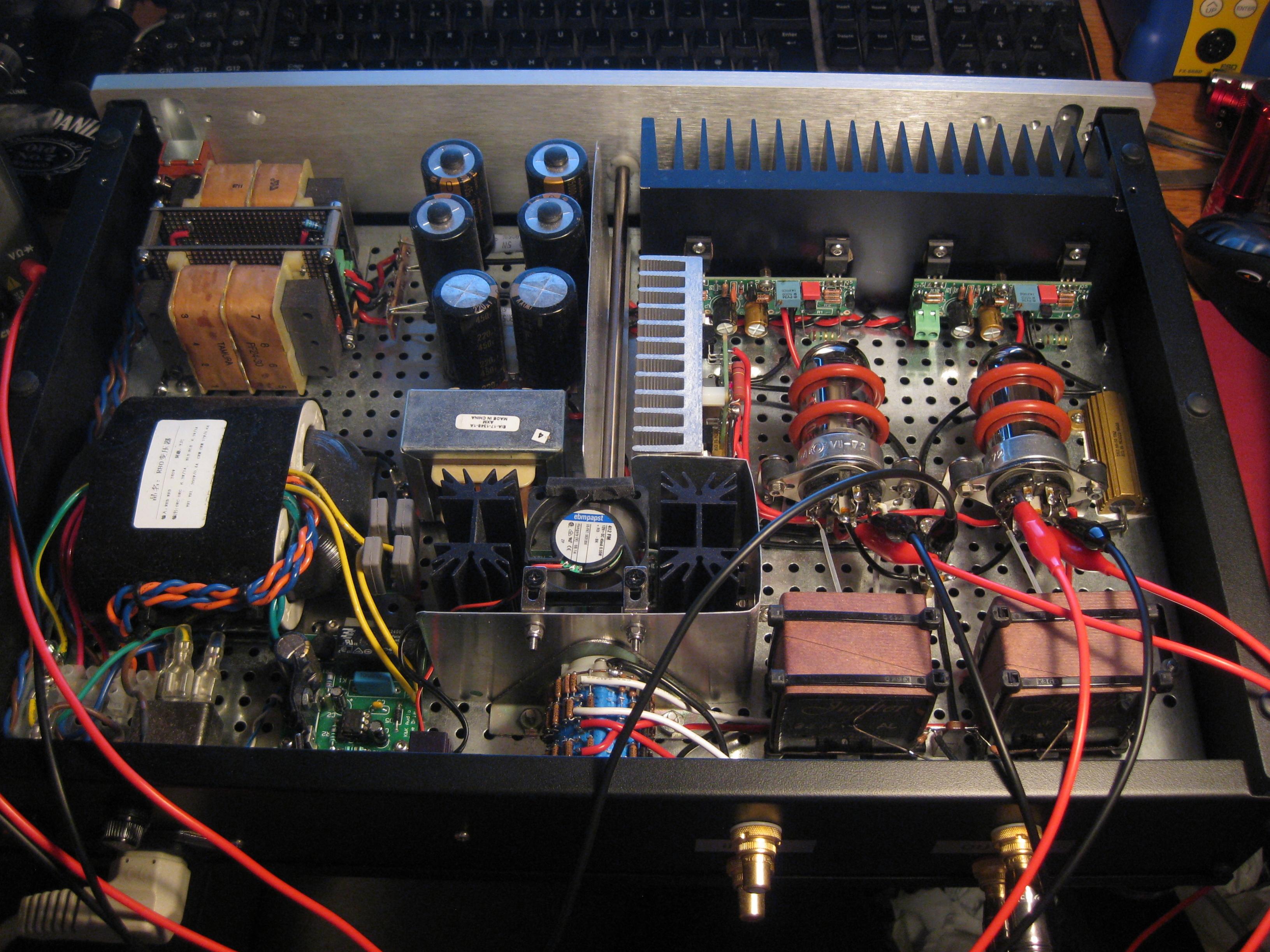

Another 4P1L is born, still needs a few tweaks before i button it up but it's 90% done. Big thank you to KevinC and Ale for your help and inspiration!
Layout is based around the Siberian Gen 3 schematic with Kevin's shunt regular supply, Rod Coleman regulators running filament bias, and CCS plate loads with a capacitor coupled output instead of some iron. Its big and hot and sounds fantastic, just like the F4 amp its driving

Hello Ireland,
I like the way you mounted the two split bobbin transformers!.
You dont have much space for improvement.
If that is a choke in the center. You could try a Lundahl choke. How much henry, current and DCR is that choke if it is one? I like them a lot but i hate the flimsy soldering tags that they use on a lot of models. They need careful soldering.
