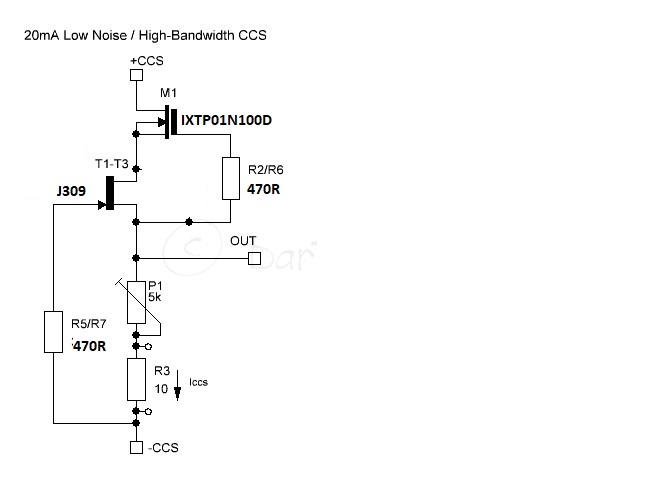

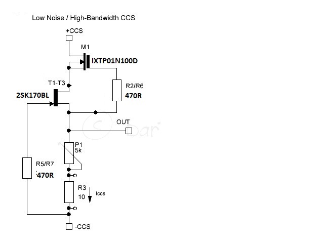

I used Gyrator directly without SSHV2 for 26, I'm not surprised. Crystal clear but without body & bass. It's a lot better SSHV2 + CCS Ixys as upper and sk170bl for lower for 26, for 4p1l same uppwer device and for lower J310 attached pic with J309 because used only for 15mA for 5687.
It would seem a step backwards to me to run without the SSHV2 boards as they are going to give a much quieter supply, and a lower impedance. I used the BF862 JFET in the lower position as per Ales recommendation and it performs beautifully. Still have a few things i want to test out with the biasing setup, but so far i am more than happy with how it is performing..similar to Andys comments above, it just sounds more cohesive then the 4P1L ever did.

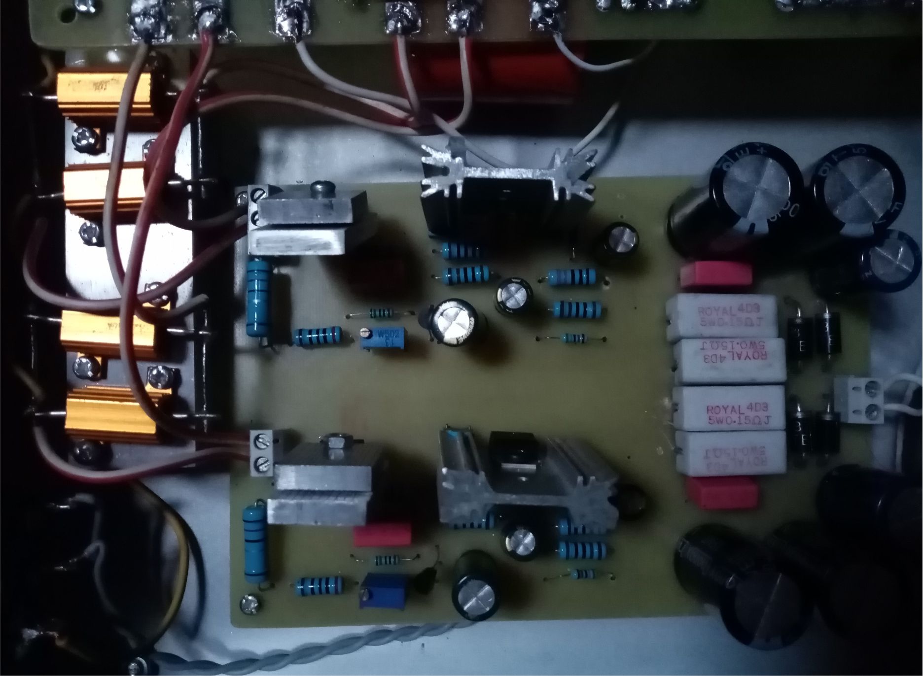

Are you running SSHV2's Andy?
That's pretty much my PSU - low value cap, choke and then 47uF doubled. All caps are polypropylene motor run. I use a separate PSU for the input stage of my 2-stage amp and I like to use a mesh rectifier like AZ1.
Using a separate PSU for the input allows the output PSU to just provide around 140mA (70+70) which is easier on all the components. Sounds nice too, and can be designed for just the voltage needed, e.g. 200v. Plus I may want to use driver tubes with 30mA of current. That's certainly desirable with a 4P1L. I use plate chokes.

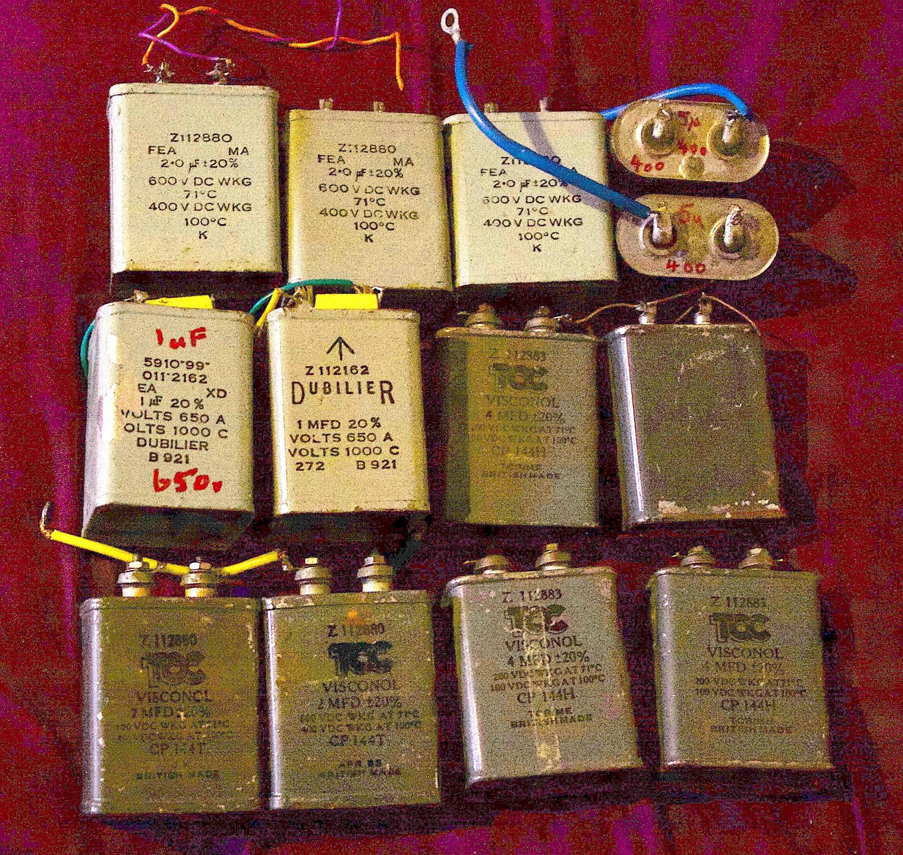

I have some of those big old box shaped grey paper in oil caps and I should take them out and use them. For instance as the last cap in the PSU. Has anyone used these? I have mostly 2uF at 400v.

Nice little stash Andy, those Dubilier ones are very good too. My first cap is usually the exotic one & after that they get too expensive, but I'm a big fan of Lundahl chokes & Weiss/Lundahl Transformers.
I would do it the other way around, if your only going to use one nice film or PIO capacitor i would put it at the end of the supply just before the load.

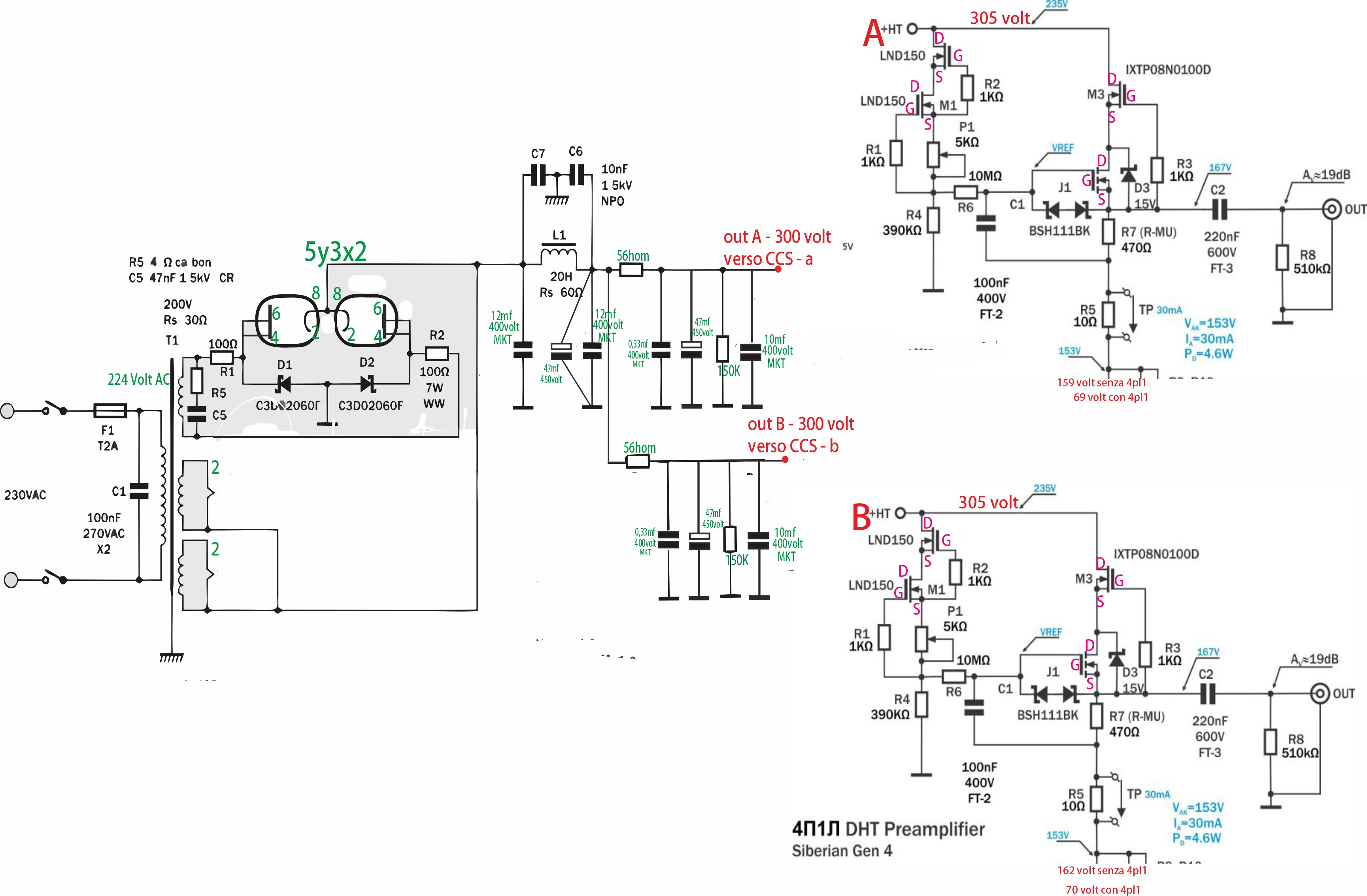

hi I introduce myself for the first time to write on the forum even if I have been reading a bit of everything for 20 years. I am a self-builder of tube pre-amplifiers and I have tried many types of preamps from SRPP to cathode follower etc. always with triodes having satisfaction in the listening tests but perhaps not finding what I wanted; what was present in one type was missing in the other or what a certain triode gave you you could not find in the other, and therefore always surfing the net in search of something different from what I had already realized I was intrigued to the construction of a preamp with the use of PENTODES and precisely with 4P1L and thanks to the information taken from Bartola's site I have created the preamp that I will show in the picture and that I could publish my printed circuits designed by me. I must say that being for the first time dealing with Pentodi I had a bit of difficulty that at the moment I still do not completely solve. I was able to listen to it in an undefined way and I immediately found in the listening an impact of well detached and distinct instruments and a well defined bass with a high volume listening without annoyance ..... I am satisfied
..... BUT WE COME TO THE PROBLEM THAT I STILL HAVE TO SOLVE AND ASK FOR AN OPINION DO YOU HAVE COLLABORATORS
I am using a transformer with secondary output of 220 volts and applied to the 2 rectifier valves 5y3 (I used these because I had them) after the capacitive / inductor / capacitive filter I get 310 volts DC which are doubled with a resistance of 47 hom 3 watts and again filtered with a 2 microfarad polypropylene capacitor per channel and applied to the CCS card I exit the 100 hom resistance with 160 vol. here we are
as soon as I insert [ONE VALVE ONLY the voltage drops to 71 volts. on one channel and the other with a 70 volt valve inserted. This leads to audible background noise without dull and continuous music typical when a transistor or Mos Fet jumps into a power amp
now in my opinion the problem could lie in the 5y3 valves which being each 150 millyamper max output and therefore having a total of 300 mA are few to manage the CCS and the 4P1L and to respect the socket I would like to mount the 5U4G valves or the 5C3S Russian they give me 500 mAmper in total
In your opinion it could be a problem of current absorption and therefore using tubes with higher amperage. I have the problem in the CCS?

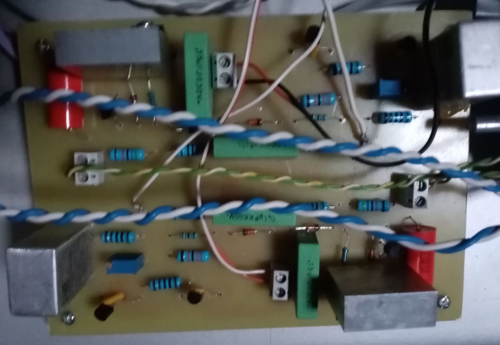

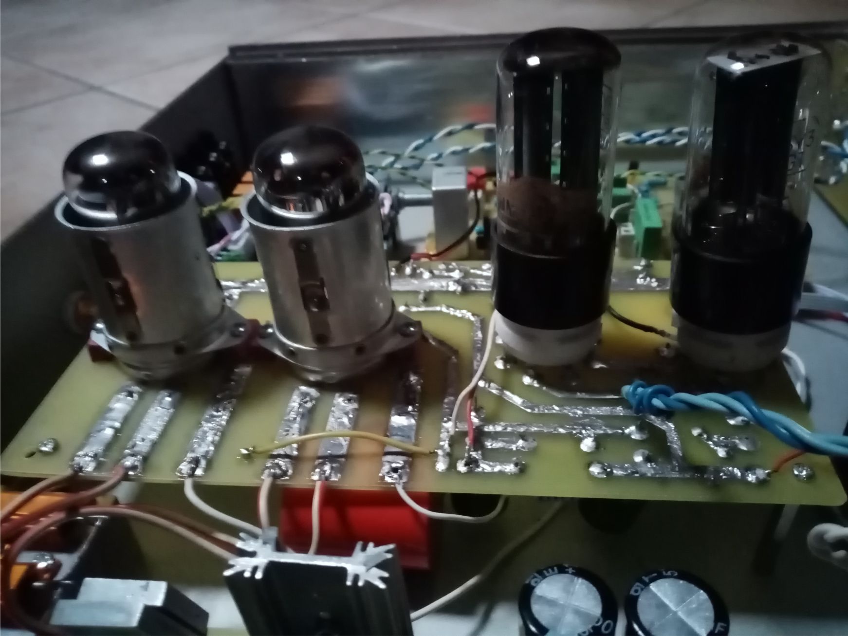

hello gerrit all the components both capacitors and resistors are welded under the valve board from the photo you can see the prolipropylene capacitor in red I am attaching the diagram that follows the original with some variations such as the straightening tubes and the splitting of the voltage. I think the problem lies in the rectifier valves I could try to rectify with diode bridge to see what happens
I repeat with the voltages I find myself and when I go to insert the valves that go down to 70 volts while they should be 145 volts
