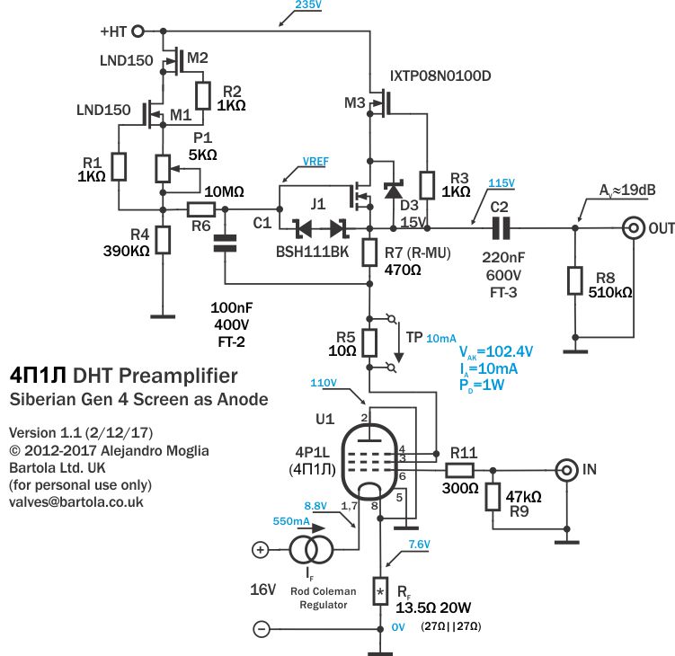

It's true ... if you use it with very low anode swing.I understand that the gyrator needs at least 30V above the intended 4P1L plate voltage to operate properly.
If swing greater, the headroom is
(anode voltage+swing peek voltage) + gyrator headroom.
If you have 170V static anode voltage and swing peek 10V, the B+ must be minimum
170+10+30 (gyrator headroom)= 210V

A question (possibly for @mogliaa) I have the pre setup as per the gen 4, screen mode (diagram from Ale's site below). I note that the filament voltage is very low indeed- 1.2V parallel. Why is this? Combat microphonics? And FWIW, the pair of valves I have in there are pretty microphonic - on a par with 01a I would say.
Set up this way, I have ~140V at the "anode", 10mA current, -8.5V grid bias (10r resistor + 3 SIC diodes).

Did you calibrate you Coleman regs for starved filaments at 550mA vs 600mA? There is filament current from regulator plus current from plate to cathode.
I used an online load calculator and was thinking of running mine 140-150. I know I questioned that value before but can't remember right now how I squared it.
Be aware that the 4P1L sounds best at 25mA or more. It really makes a difference. It can sound thin below that. For 10mA I'd rather use a 2P29L which is less fussy about current. Try the 4P1L at 25mA or 30mA and you should hear a difference. This isn't always a practical operating point, which is why I stopped using the 4P1L.

I did some digging through Ale's website, and I found in his blog comments that he said these were just measured values he got, not design targets as such. So maybe that clears that one up.

Ok, so grounding I think is sorted out, certainly it's now pretty quiet. The valves are microphonic though, at least as much as 01a and maybe worse.
Some figures:
Filament starved at 550mA
Screen as anode
Anode current 15mA
Anode voltage 150V
Filament bias with grid at -8.8V to K
Circuit as per Ales gen 4 with screen posted above
Star grounding
R-core tx for filaments, EI for HV
B+ 220V
It probably has more gain than I need so I might use a resistor divider at the output to drop the output a bit.

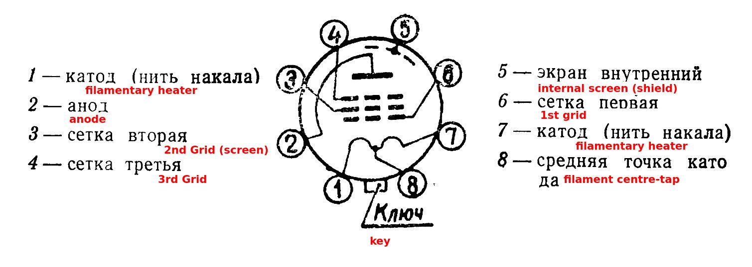

BTW, is there an english translated datasheet PDF for the 4P1L anywhere?
