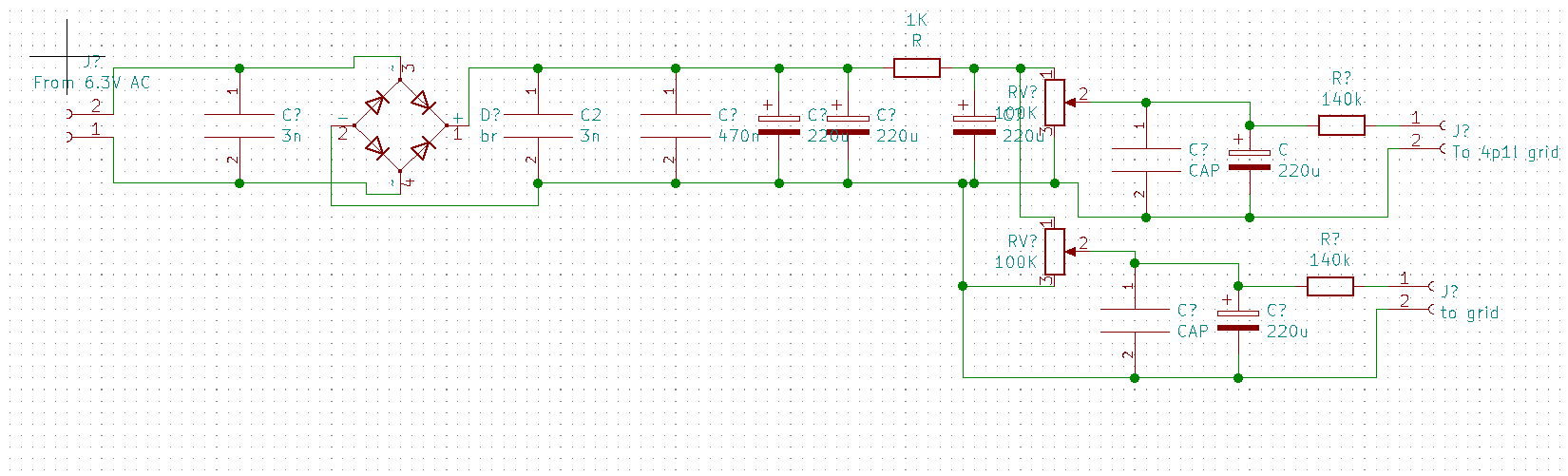

Also I will try to ground the cathodes and will make a separate fixed bias power supply. Something like this looks good?
after the pot the filmp cap would be 270n. I have another winding 6.3V unused on another EI transformer that Im using. 4P1L bias will be around 5-6V so this should do.
Would this schematic do? Thanks very much Rod.
> Also I will try to ground the cathodes and will make a separate fixed bias power supply. Something like this looks good.
It's a good idea to use grid bias, if you use a toroidal transformer.
That way, the common mode noise sinks directly into the ground.
But make sure the resistive path from grid to cathode complies with the data sheet maximum value.
A 9V battery might be a better plan - low noise and no leakage currents or ground loops, an no ripple voltage.

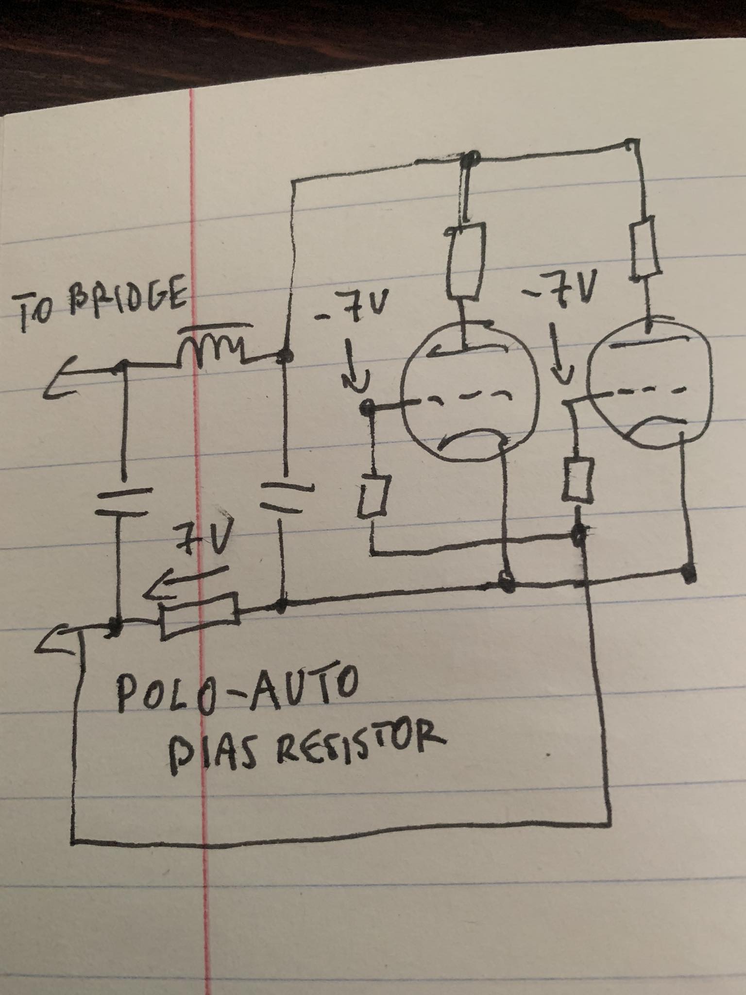

But I have another idea. Anybody experimented with something called poloautomatic bias?
Basically you put the bias resistor in the power supply, by the whole draw of the whole amplifier both channels. This is also bypassed by a cap, BUT the point of this idea is that the last powersupply cap will have straight audio path to the ground of the amplifying stage. Basically I just connect grid resistors after this resistor. I hope the image will do:
EDIT: this resistor would be bypassed by a cap to avoid voltage fluctuations, and the signal path will now consist only of the tube, its load, and last power supply capacitor.

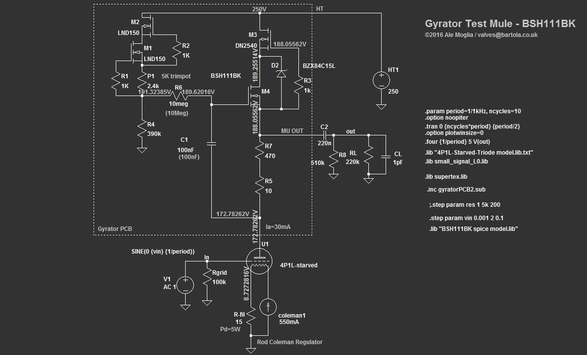

I have built the attached circuit posted in #1298 on a Rev. 0.5 board. Orientation of the BSH111 is correct and I included a 1k gate stopper on the BSH111. It works nicely with a 22k load and setting the 130V output voltage I want to use it with is no problem. When I change the load R to 8k6 to get closer to my use case (130V 15mA) output voltage drops to 54V and turning the trimmer doesn't do much. Cranking up the input voltage doesn't help.
Does anyone have a suggestion what to look for to make this work? Thank you very much.
