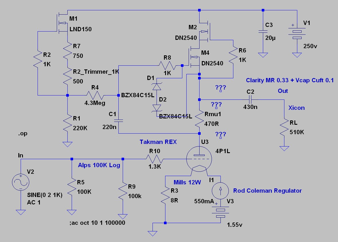

i think the falling bass with 1.5k have something to do with the output caps..The Tram use min 10uf
i use pt. 4.7uf and do not miss the deep bass,
Hi Michael,
As you know, "no free lunch". 🙂

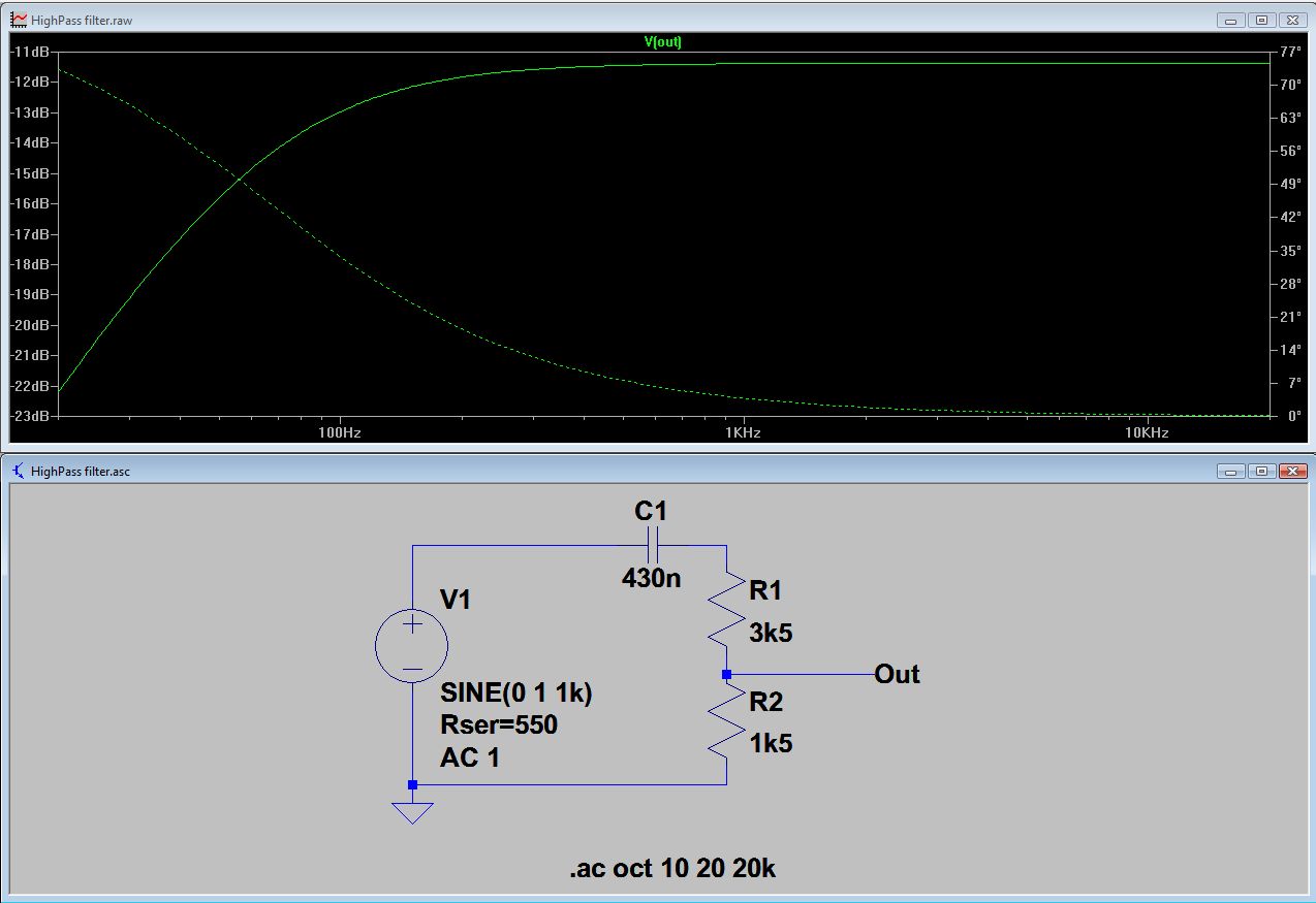

You realized a high pass filter (430nF - 3k5+1k5 resistor) with "enormous" (about 1k5) signal resistance. 😛
If you use (I think unnecessarily) R1 (1k) resistor between CCS and anode, and output is from the anode, output resistance will be about 1k5.
Leave this resistor, and use CCS bias resistor "upper" point as output (low Z output). Output resistance decreases to 200R region.

Your CCS schematic is wrong.

My CCS was just meant as an illustration. I'm using the gyrator ver 1b.
Which I like a lot.

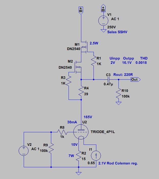

Hi
Due to some regulating issues Bjarne has with on of the posted CCS gyrator ver 1b
I'll release this Schematic for Caps which both works for 8R and 15R.
I'm playing on it right now. It's very very stable on my 8R and the mA is only "drifting" 0.35% when I set it to 30mA.
I can adjust the gyrator from 15.8mA to 40mA. When 30mA is my favourite.
Schematic for 8R Caps.
PS! Forget about the voltage Amps on Lt-Spice, it's different in real life.
/Michael.

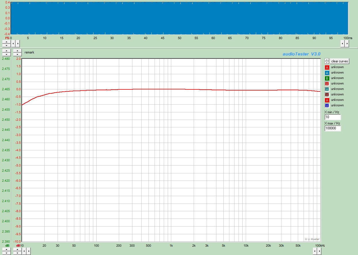

This sample is one of my (graphite anode) 801 measured transfer function (LND150 biased DN2540 cascode gyrator, 1Veff input, 30mA anode current, 400V B+).
