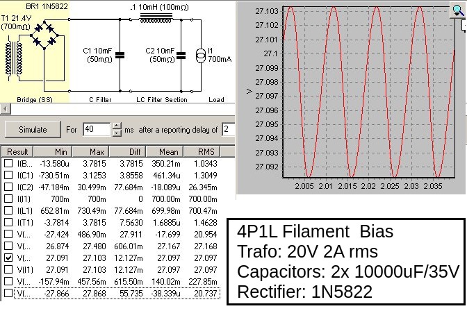

15V AC (40VA), schottky graetz, 4700uF-1R (in both [+/-] wire)-10000uF (18.5V loaded) for R.C. V7 regulator (4P1L, 650mA, 15R filament bias).
