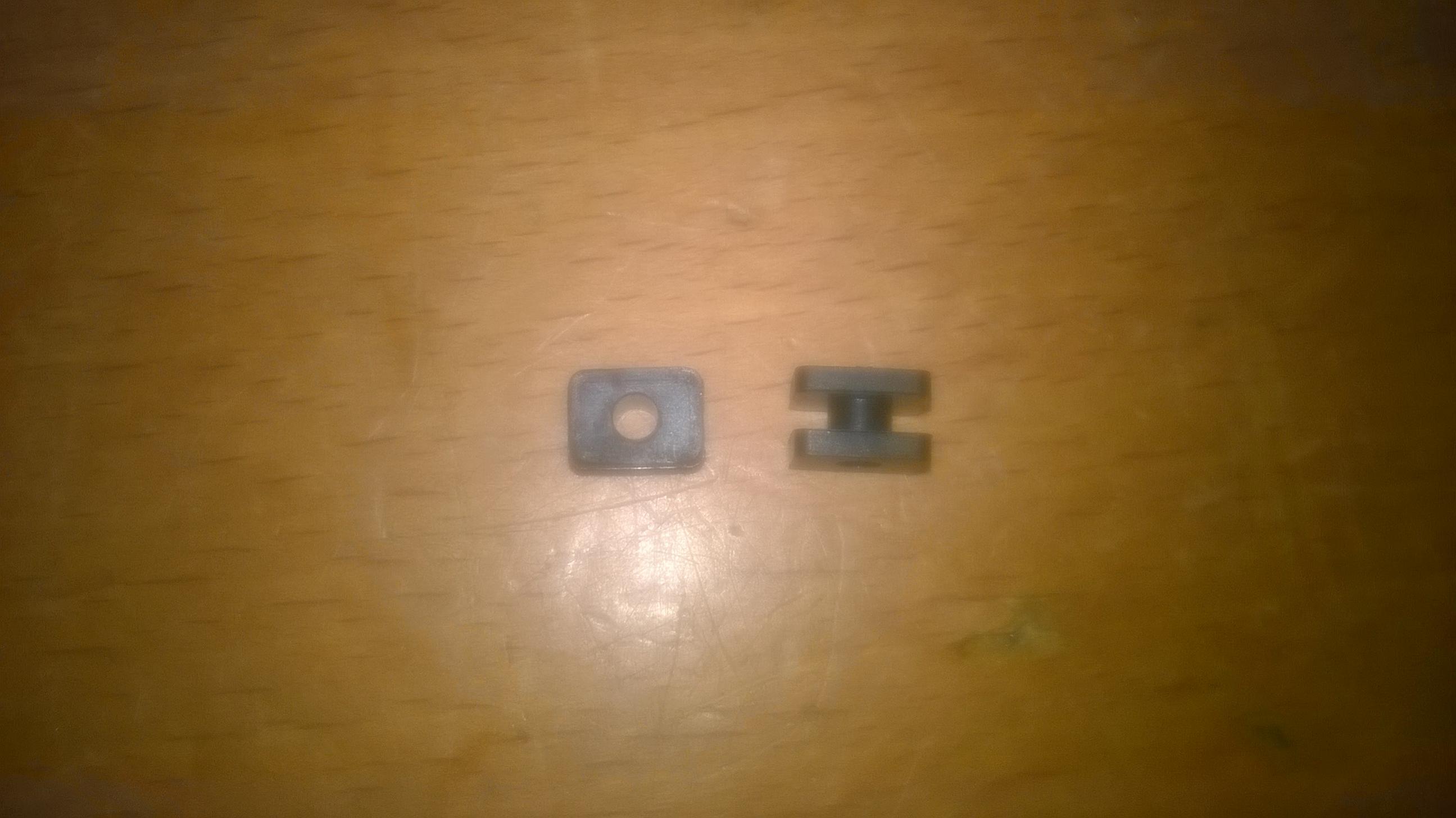

I use these
Model aircraft flying silent blocks for servo M3
where can those blocks be purchased?
I bought in a local model RC/aircraft/etc store you can ask for Futaba servo silent blocks but you can buy:
IberHobby
Accesorios servos futaba - - Silent Block cuadrado servo
IberHobby
