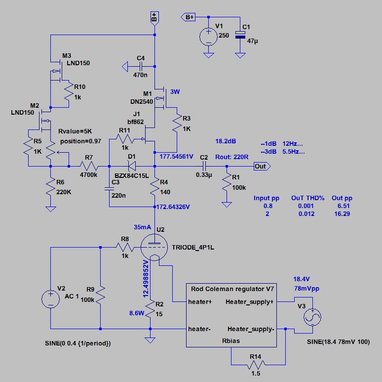

Bela,
Looking at your diagram again, I just realised that the BF862 hasn't got the stones for this the 4P1L at 35mA. The IDSS is 20mA and you are pushing the limits of a very sensitive JFET if you want to run it at 30-35mA and you will need a negative VGS I think above -1V. Check the data sheet.
Best JFET for this at 20mA or higher is the J310 or SMD version (MMBFJ310).
Ale
Ale

Hi Bjarne, the gyrator version you're using will work well but is not optimal. The lower FET in a cascode circuit like this is running under challenging conditions for most of the MOSFETs. The VDS is very low due as is set by the VGS requirements of the top FET. This means that VDS is less than a couple of volts where the reverse capacitances go to the roof (check the data sheets). The JFET perform much better here and the HF response of the gyrator is far better. I measured above 100kHZ on my 01a Preamp. Have a read at my 01a preamp blog entry http://www.bartola.co.uk/valves/dht-pre-amplifier/01a-preamp-gen2/.
For valves with low current requirements (<10mA) you can use the 2SK170 and BF862. They do sound beautiful. For higher currents, like what you need for the 4P1L, you will need to use different FETs given the current needs. The J310 works really well here.
You will need the protection zener between gate and source and you will need a zener between drain and source for a sensitive device like the BF862. Otherwise it will not withstand the power on. Been there than that.
Hope this helps
Ale
Hi Ale, don't you think that a Mosfet like BSP129 is better suited for current above 20mA due to higher Gm?
Hi Indra,
I've used the BSP129 before and works really well. However, the 2SK170/BF862/J310 jFETs are superior in the treble response.
Have a look at the data sheet and you will see that the BSP129 reverse capacitance goes to the roof (100pF) at VDS lower than 4V. If you also check the transconductance plot you will see that it goes down below 100mS.
It's true that it has a x10 transconductance compared to the MMBFJ310 (10mS) however the latter has a capacitance between 1pF to 5pF at the same operating conditions. The BF862 has a Crss of just 2pF. I've tested the gyrator circuit with the BF862 recently and was amazed with its performance.
Cheers
Ale

Will the MOGLIAA Gyrator have a lower output impedance than a transformer coupling? Assuming the LUNDAHL transformer ...
With BF862 as "lower" FET the Rout about 220R (in my 4P1L preamp simulation).
