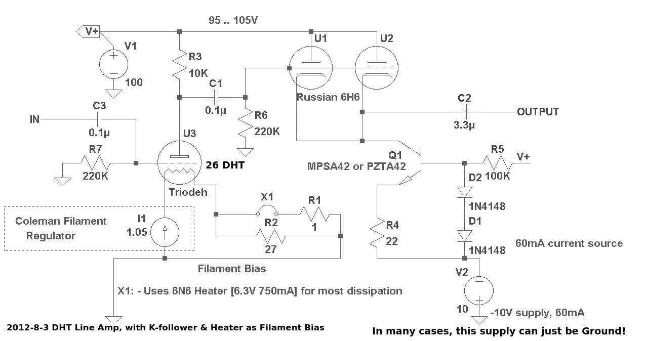

Yes, Erik,
It was my design-suggestion for adding a cathode follower.
A low cost alternative for a cable-driver.
The IDHT cathode follower has its heater fed from the filament current of the 4P1L (etc); the 4P1L bias is developed from the IDHT heater.
I don't know if it has been tried.

Hi Rod,
indeed, yours was one! But I remember someone else as well who built a RIAA stage with indirectly heated tubes, and lit those up with a filament bias circuit.
I am working on a "raven style" preamp/headphone amp with the 4P1L, using cascoded TIP125s as CCS for the cathodes and biasing the whole with a 9V battery. I am thinking about filament bias using the filament of a 6P15P, which I want to use in a shunt regulator arrangement for the B+.
best regards, Erik
