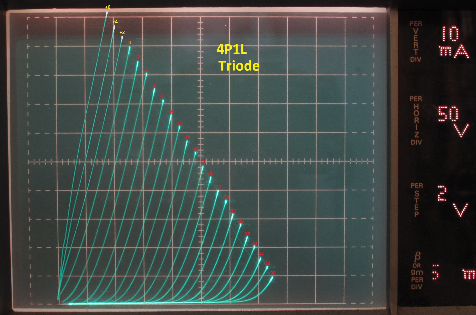

I had some time over so I traced some triode curves for 4P1L, I must say they are rather beautiful.
Thanks for the beautiful curves.
The +2V trace looks the most linear. Is +2V workable in a preamp? It seems like -8V is the standard?
Subscribing to this interesting thread.
Linearity is not seen from how straight the trace looks like. It's from how equal the spacing between each trace is. 4P1L is beautifully linear because if you draw a straight horizontal line crossing all traces, the crossing points are evenly spaced from each other.
Also, positive grid voltage (+2v as you mentioned) would also mean you have grid current and as such, lowers the input impedance greatly which is usually something we want to avoid.
