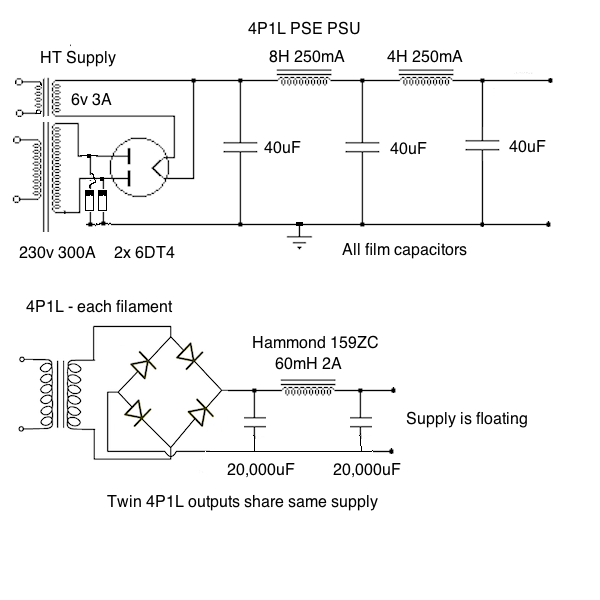

Here's the PSU I'm using. I have a few others which vary. I often use Thurlby Thandar bench power supplies 30v 2A for the filaments - I bought a bunch of used ones. Really clean supply.
