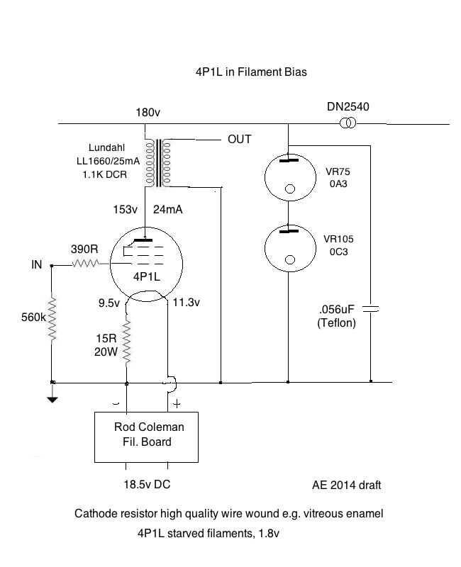

I can't answer for Ale, but here's my schematic if it's of use. This has been running 24/7 for over a year and sounds great.
You're welcome to use it.

Sure, you are welcomed to use it for personal use only
Ale
Thank you Andy and Ale. I am novice so want to make sure I start from a good working implementation.
Andy, I believe your's is for amp, correct?

The preamp is in fact the first stage of my 2-stage PSE 4P1L amp. Same thing - just in the amp chassis. I use the LL1660 in 4:4.5 since I want to keep all the gain. I keep it running all the time because I can't be bothered to turn it off, and because I go to sleep listening to music so it's on all night. All my sound goes through the amp - it's fed by my Mac Mini so has Youtube, Spotify, online sites and also radio and TV programmes And I have 200 of 4P1L so I don't care about replacing them. They carry on for at least 6 months - tough little things. You can add up the drain on electricity - PSU plus filament supply. I haven't added it up but the whole amp is probably not much more than a 100 watt lightbulb.

Hi Kazap..
I'm on the version 1, on the 4P1L. Where I use 8 Ohm as
cathode resistor.
I use some big Filament Elma Transformer 90Va, and the total
power consumption is 73 watt.
The Filament part, 2 Trafo, 2 AC/DC board + Coleman ver 4 eats
in total 52-53 watt.
This will properly be a little lower with less greedy Transformers and
Rod Coleman ver 5 filament regulators...
/Michael.
Hello guys,
I want to give it a try!
But right now I only have available CCS from Garry Pimm as a load.
So my thought was a little MU-follower, whit 30mA, the ouptut impedance would
be less then 100ohms. In this way I could also make an ccs loaded parafeed whit
CM-2810 transformers. So any thoughts? And whats the difference in sound iron vs ccs used

Ale can tell you more about active load versus transformer. I don't particularly like active loads - find them a bit sharp - and I avoid capacitors because they blur the sound subtly. I have always found transformer coupling to sound the most natural. It's just a question of getting the right transformer - the quality does make a difference. I find the LL1660 pretty good - better than the LL1692 for instance and the Hammond 126. Thomas Mayer says the Tango is audibly better than Lundahl but I don't think there's any new production of those. Don't know about Hashimoto - that's the usual suspect these days, though maybe Silk should be considered.
