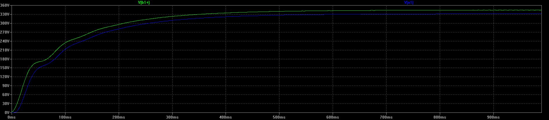

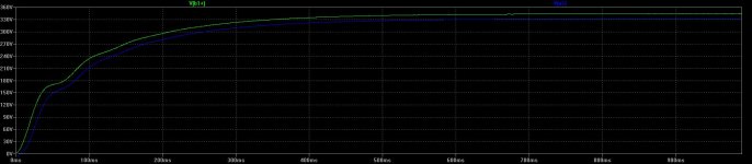

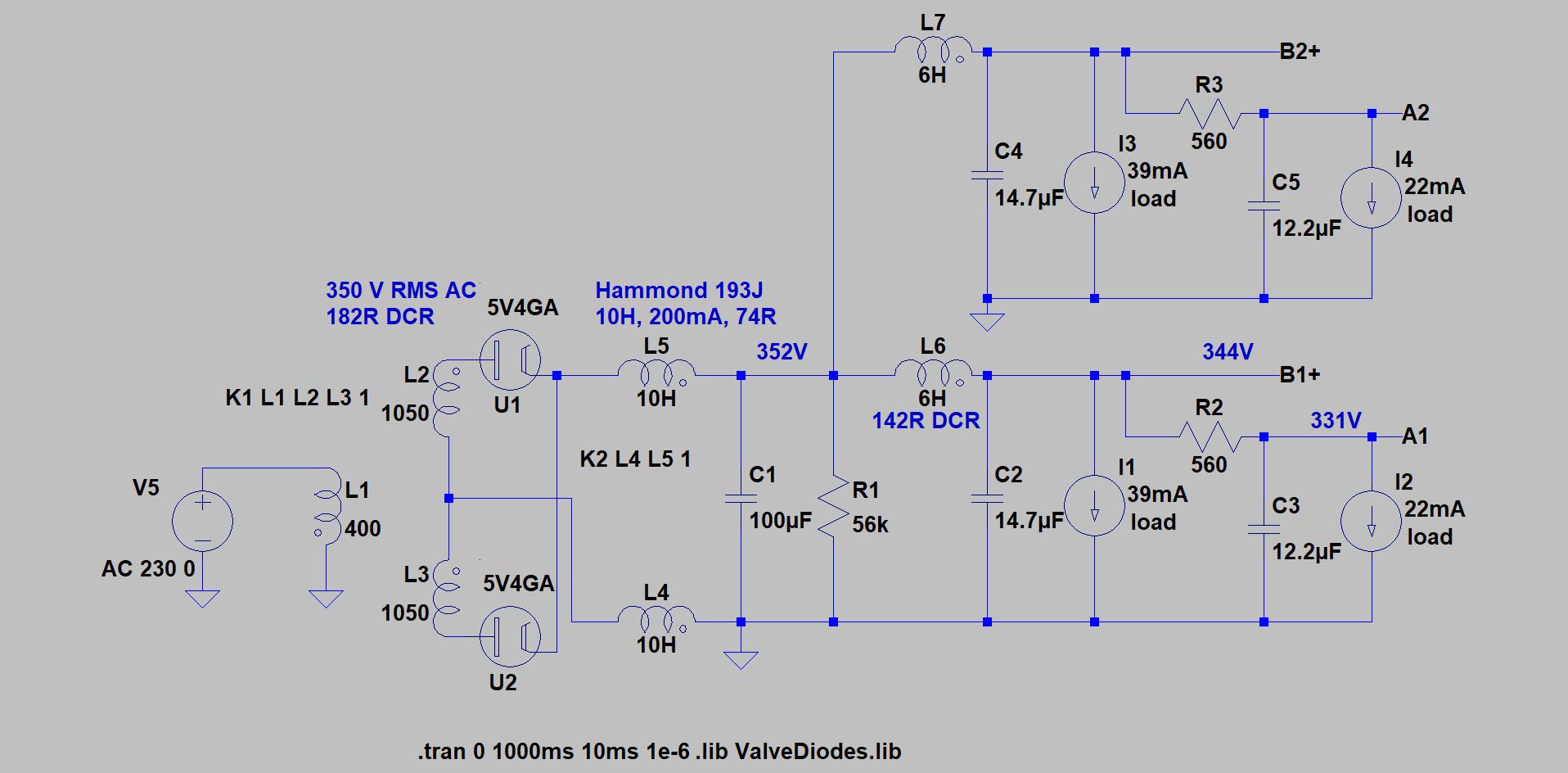

IMHO 350V AC transformer is a bit "large" for 300V DC output.
My LTSpice simulation shows about 344V output (PSUD is too modest for complex circuits).
Each L-C circuit generates enormous current not only within choke, but in diode.
The rectifier's peek current is about 400mA (at startup the 100uF charging current and the 10H magnetising current sum exceed 1A!), the RMS current about 200mA.

You might remove the 100uF, then put one 14.7uf right after the first choke, and put a 50 uF after each 6H choke. Just requires one more 50 uF cap, but it makes the job easier for both the rectifier and the power transformer secondary (less power up current transient, less running ripple current, and less hot when operating). You will have about the same ripple as before. And . . . B+1 and B+2 will not move as much when bass notes come along (rectifier ripple at 100Hz filtering, versus B+ variations with 30, 40, 50Hz organ and bass notes that suck out current over the longer time periods of the low frequencies).
Hello, Using 100uf will indeed give a the choke ,the rectifier and the ttransformer a huge task. If the current through the choke will be to big it will not act like a choke anymore and the rectifier will not work as it is supposed to do. When the choke will not act as a choke the system turns into a capacitor inputduring the short '' time '' when there is a charging pulse i presume and the voltages will be higher. An ordinary meter will of course not show these peaks. That is why i usually go for higher henry chokes which have higher dcr AND reduce the seize of the first capacitor.

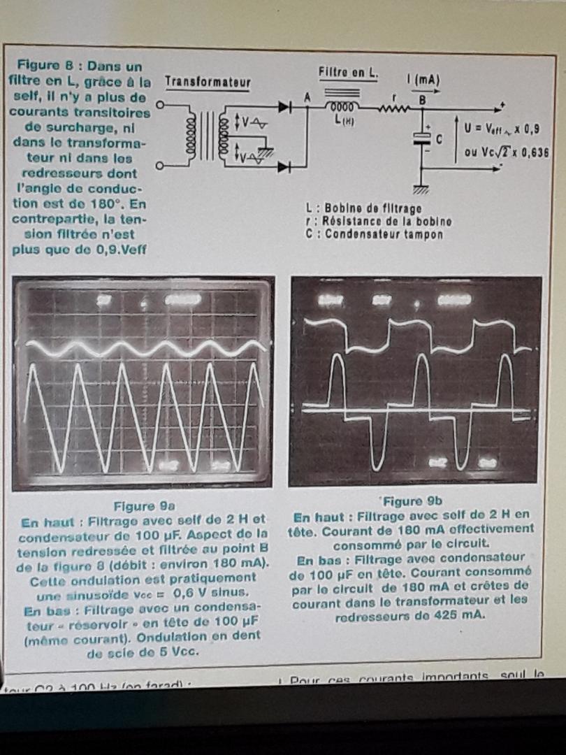

some info
Hello,
For those not yet convinced that choke input is the way to go.
Extract of an article from Rinaldp Bassi in France.
9A top choke input sine wave 0,6 volts at point B in figure 8
9A bottom no choke saw tooth 5 volts
9B top choke charging current the same as the current being drawn by the circuit.
9B bottom current fluctuating between circuit current ( 180mA) and charging pulses well over 400 mA

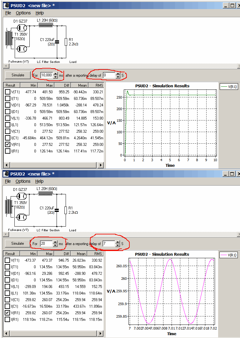

I have been playing with psud2 and can't get rid of the overshoot and the ringing (on the first C) with a choke input, I do seem to get the start-up current within limits .
I need to read more about psu design and probably learn to work with LT Spice .
The funny thing is the amp sounds nice with this bad designed psu
... psud2 ? ... it gives a huge overshoot and voltages are not realistic. ....
You have started from ZERO time. Yes, an L-C filter tends to overshoot *at turn-on*. This seems to be settled by 0.5 Seconds. How much music can you listen to in a half a second?
Forget the start-up, except to be sure the peak will not blow-up your capacitors. Set "reporting delay" to several seconds. In this case, 1 second gets past the big bump, but it takes like 7 seconds to settle to final value.
Your "350V 182r" transformer is delivering 475V peak, which implies 339Vrms, so you lose some there.
Choke-load "should" make a DC about 0.9X the ACrms, so 304V.
The GZ37 has about 29V drop, steady because of choke-load. So now 275V.
118mA in 60r choke is a 7V drop, down to 268V DC.
PSUD says 260V.... BUT I have to let the sim run 7 seconds to settle-down to final value. Which agrees with bench-test: a big-choke big-cap filter can take visible time to get to its long-term final value. (And in real life tube-warm-up causes several other delays and burbles.)
I am mildly curious why 268V versus 260V, but 3% difference is "nothing" in tube-work where anything +/-20% is all about the same.

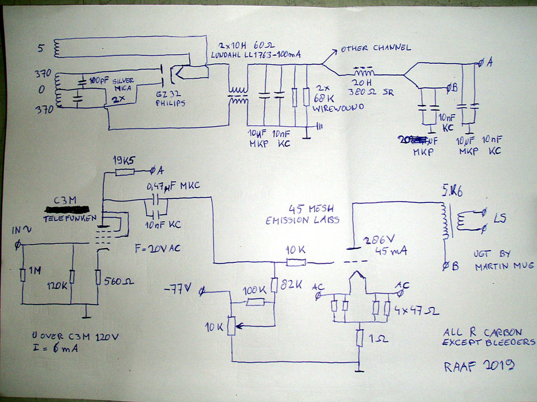

Here's the definitive version, for as far as my amps are ever definitive.
I have found by-pass caps I am truly happy with.
The psu caps are as close as possible to the circuits they supply, the C3M has a different circuit, draws only 6 mA instead of 20 mA but amplifies more, the system does 105dB now.
I am aware that a 400v transformer and better chokes should give me better performance so nice to know that a upgrade is possible .
I am happy with this Amp, expected a better performance than my EL3N pushpull but the sonic difference is way more than I hoped for .
Enjoying music has reached another level .
Hello,
Check the voltage rating of the wire wound bleeder resistors.
They can som,etimes handle a lot of current but can be restricted in voltage and in this position there is a lot of voltage.
Greetings, Eduard

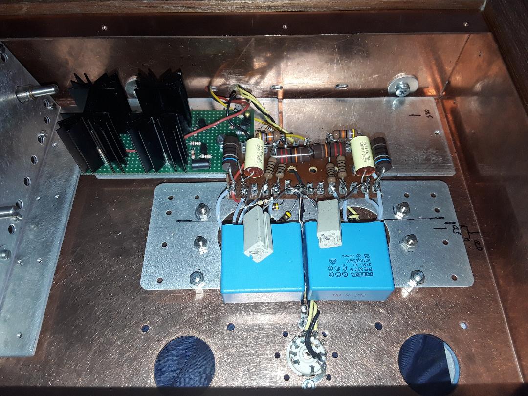

P.s in the attachment my new line preamplifier. Everything mounted so far is power supply. At the far right there is a noval support for the signal tube and two round holes for the Tango output transformer. The empty space in the right part will be occupied by Slagle AVC
