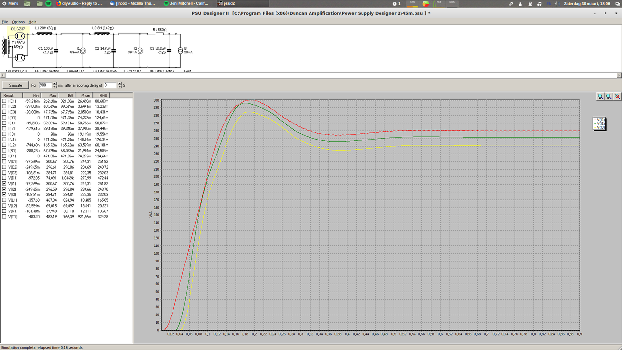

OK I have two questions :
- How can I simulate this psu in psud2 ? I have tried to simulate the psu it gives a huge overshoot and voltages are not realistic .
- If I make the dcr of the first choke 260 ohms (in psud2) things look a lot better. Can I just add 2 100R resistors after the choke to get the same effect ?
Hello,
See what happens if you '' use '' the LL2743 which has total 41 Henry and two times 200Ohm dcr and reduce the seize of the first cap.
Greetings, Eduard

If I don't change the cap things look better, but it looks bad if I take 50uF.
But a 20v drop is not acceptable for me
