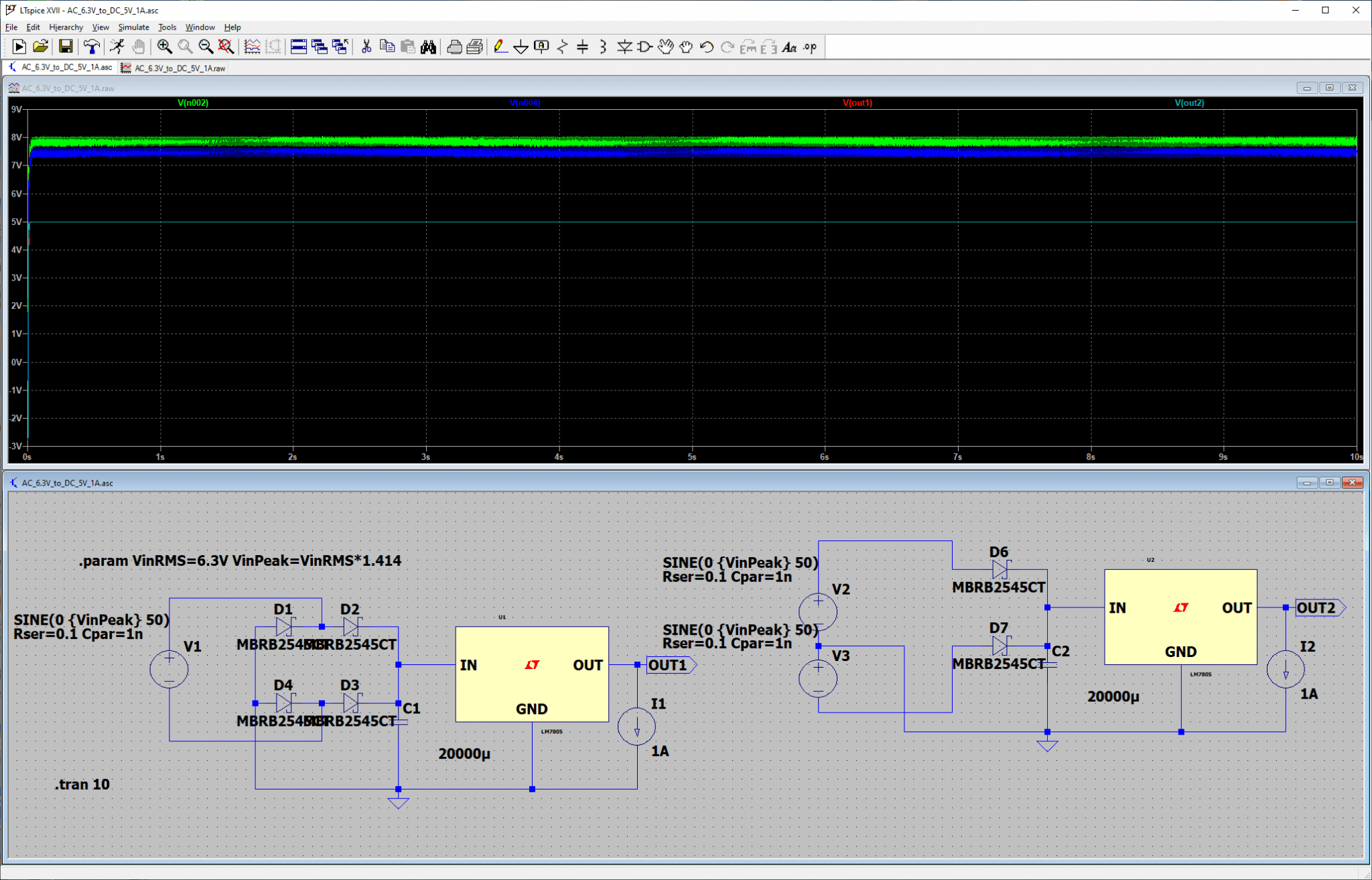

You can even do it with normal diodes and caps. A doubler with a couple of 3300uf works perfectly too.So everyone with normal brains knows a 7805 won’t work with a 6.3V transformer, normal value filter cap (i.e. the meanwhile famous 2200 uF cap of the rule of thumb) and normal diodes. Then, to kill time, people mix in Schottky diodes, LDO regs and large value caps to prove a 5V regulator works OK on 6.3V AC!?!?
Fact: a 7805 can work with 6.3VAC.
Apologies for my abnormal brain.
Not with a standard single winding 6.3V transformer and not without tricks. Fact. Apologies accepted 😉
Standard single winding 6.3VAC secondary, two standard rectifier diodes, two standard 3300uF caps, one standard 7805. Where is the trick? The voltage doubler (1908 tech)?Not with a standard single winding 6.3V transformer and without tricks. Fact.
Schottky diodes aren't a (expletive) trick dude. LMAO There's NOTHING exotic about this at all. Just a stubborn person who can't move past 1N4001 diodes.Not with a standard single winding 6.3V transformer and not without tricks. Fact. Apologies accepted 😉

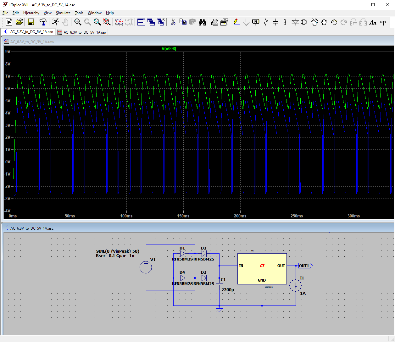

@jcalvarez To make jean-paul happy, please model a 6V3 primary, and use 1N4007 as bridge and a 2200µF cap so we can see he's right 🙄

If you use archaic rectifiers and small caps "That was a good guideline" in the 1970's, then yes, you should use at least an 8V primary. If you can use modern stuff, and maybe go full wave instead of bridge to save one diode drop, you can use 6V3 for bridge or 12VCT FW. I really don't understand what all the fuss is about.

Damn, it does not work with normal diodes, normal capacitors and without tricks :-(@jcalvarez To make jean-paul happy, please model a 6V3 primary, and use 1N4007 as bridge and a 2200µF cap so we can see he's right 🙄

It was designed to fail, by using the wrong components. I got the expected result. No surprises here.What a surprise.

Everyone on this thread knows how to multiply 6.3 by 1.414 and subtract 2 volts, as you have been doing. There is nothing very clever in that. However, it doesn't match reality with any mains transformer I have ever used.
(It doesn't match reality with any silicon rectifier diodes I've used either: I've rarely seen a voltage drop bigger than 0.8 volts across any of them. I don't think I've ever seen a full 1 volt; that must be a conservative datasheet upper bound.)
In reality, with every transformer I have tried, a 6.3V AC RMS transformer, and ordinary silicon rectifier diodes, work just fine to power a 7805. The reasons for this have been explained several times in this thread, but you refuse to acknowledge them. Many people have successfully built and used power supplies using 6.3V AC transformers, ordinary 1N400x rectifier diodes, and 7805 regulators, but you refuse to acknowledge that, too. You're literally refusing to acknowledge reality.
