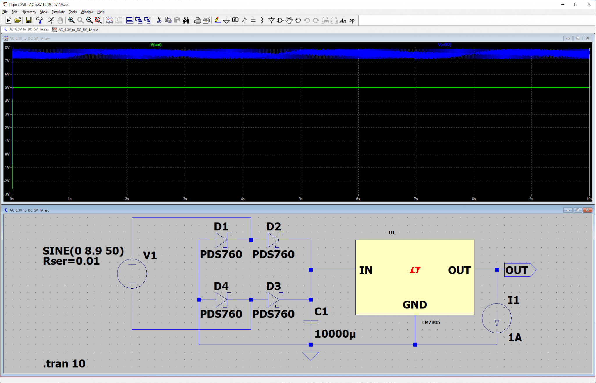

Back to school! You forget the 2 x diode dropout voltage AND ripple voltage6.3*1.414=8.9... Plenty of drop out room for a 7805.

It will work perfectly with Schottky diodes and the right capacitor, I have done that, no problems whatsoever, other than needing a big cap.Back to school! You forget the 2 x diode dropout voltage AND ripple voltage

If the model for your source is accurate. Looks optimistic to me. Just a hundredth of an ohm, and no leakage L? Yeah, right. Let me know where you can buy that transformer, I want a few.
As I mentioned above, I have tried this in real life, more than once. I just modelled it quickly to see the values. I just checked the power transformer I use, Hammond 372JX, 0.027 ohms DC resistance on the 6.3V secondary. Maybe you should buy one 🙂If the model for your source is accurate. Looks optimistic to me. Just a hundredth of an ohm, and no leakage L? Yeah, right. Let me know where you can buy that transformer, I want a few.
I just tried simulation using 0.1 ohm and 1000pf. Still works, a bit of ripple appeared, cured by increasing the cap to 16000uF.
It's at the edge of failing anyway. The slightest deviation of the mains voltage will make the 7805 go in dropout, as was to be expected.

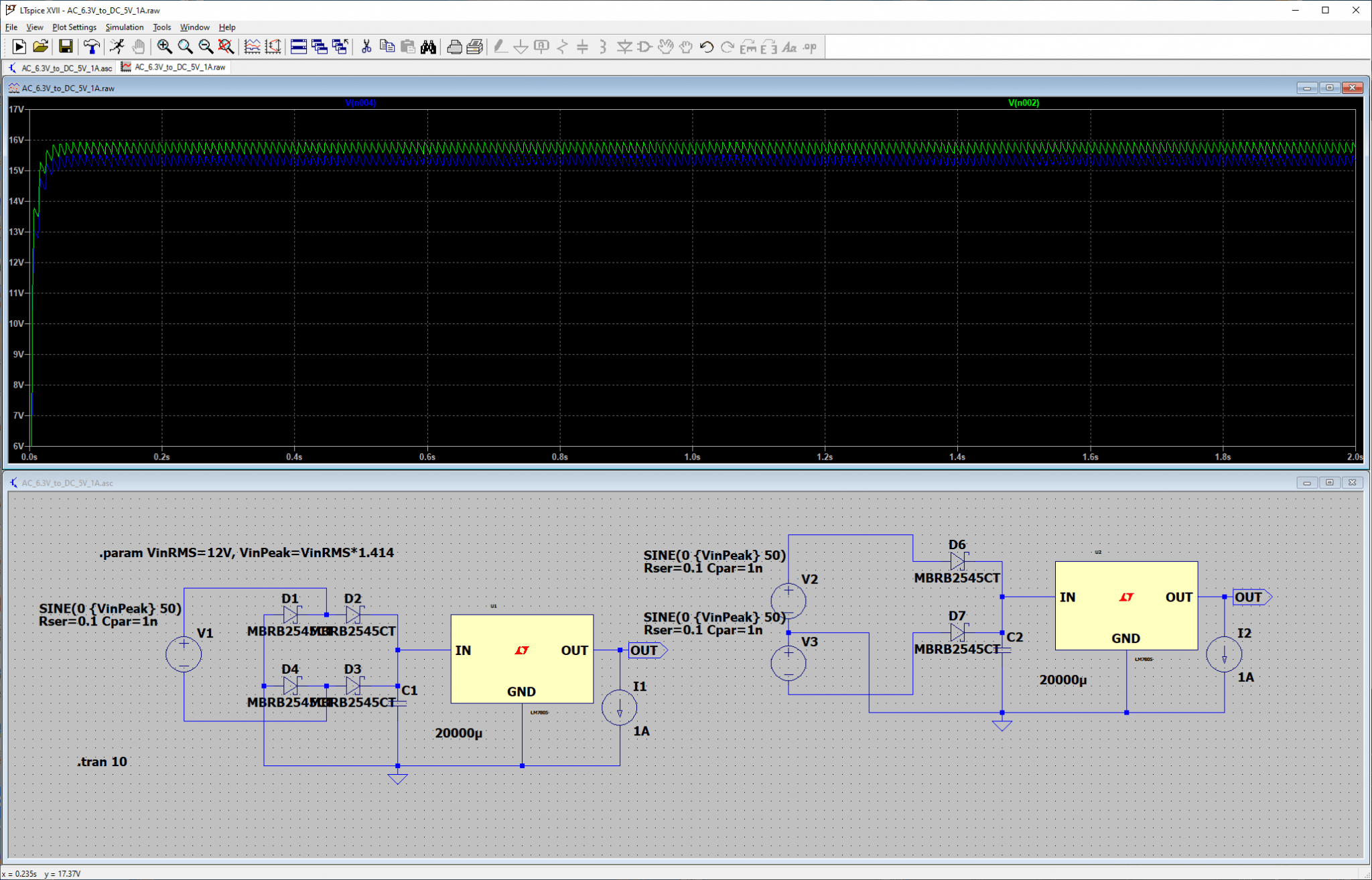

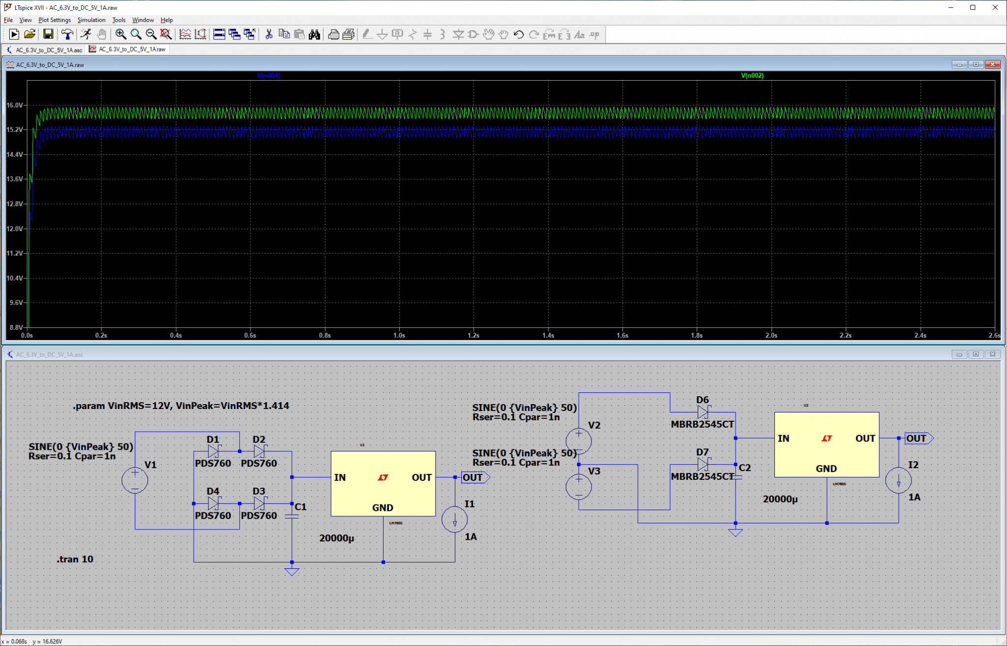

Now can you sim this using 12VCT and MBR6045? 🙂 C1=20,000µF It'd be interesting to compare.

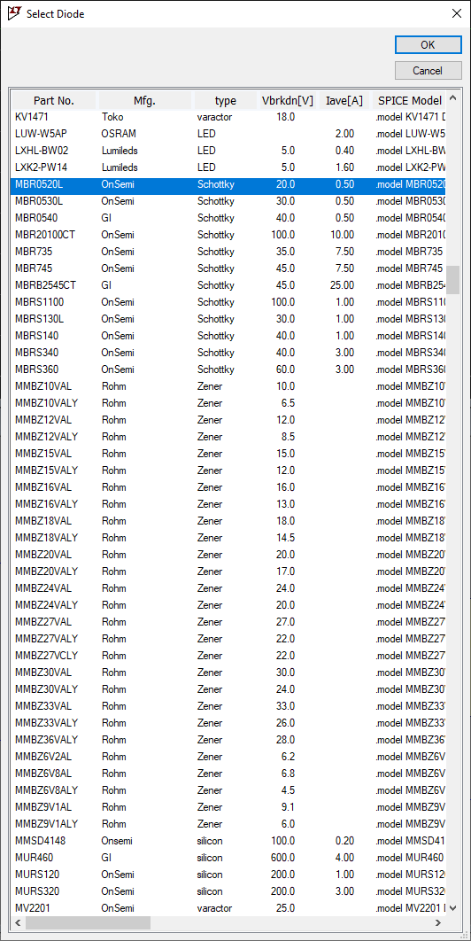

Any other diode choice? It does not show in my LTSpiceNow can you sim this using 12VCT and MBR6045? 🙂 C1=20,000µF It'd be interesting to compare.
Using my diodes:
Green: full bridge CT. Blue: the other one.Thanks, however...
12VCT == full wave with centre tap 🙂
Try the MBRB2545CT?
True, but then I one can use a LDO regulator. The 78xx series is ancient. Alternatively, just use a doubler if the transformer is good enough for the peak currents.
Then we agree. I think everyone agreed straight from the start that it can work with Schottky diodes and an LDO.
I think V2 and V3 are supposed to be 6 V RMS each, together 12 V.
