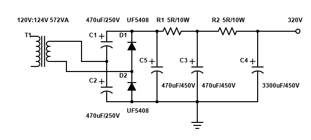

Usefull caps if a bit overkill and you'd need a hefty transformer to charge them. Roughly speaking a 100w valve amp needs about 1A at full whack ( a bit less but some headroom is nice for LF transients). According to what I've read you need about 1000u per 1A, therefore a 4100u cap would be good for a 400w valve amp, using say 10 807's in parallel or a lesser number of KT88's. That's with a HT of 450v, for higher HT/B+ use four ( 2 x 2 in series for a CLC/CRC filter) in a 200w amp perhaps.
This is all bag of a fag packet rough calculations, and again as mentioned you'd need a mains tfmr that can supply the current else you get big ripple current.

It really needs to be CLC or CRC filter (with the big on at the output like Koda’s). Way too big to be the first cap unless you’re load current is much higher with a very big (1.5 to 2 kVA) trafo. The proper value for a solid state amp is 20,000 uF. What goes into that number? It’s for a 4 Hz corner frequency (5 time constants at 20 Hz) at 2 ohms (Two channels at 4 ohms driven off a common power supply). The resulting conduction angle gives about 60% power factor. Tube amps really aren‘t any different - the LOAD impedance is higher. 1/4 of Ra-a, divided by the number of channels, plus some overhead. That’s how big the first cap should be. Turns out 100 to 500 uF is plenty - even for a big amp. If that’s the only cap, you could go a little larger but certainly not more than about 2X. Anode+g2 current is strictly limited and can’t just scale up by halving or quartering the load Z like a transistor amp can. Additional filtering can be used if you want to drop the ripple, but needs LC or RC to increase the conduction angle or the power trafo won’t really like it. You will get BETTER regulation with the first cap in the right range because it keeps the conduction angle from getting insanely short if you’re drawing high current. Low conduction angle is par for the course if a class AB amp is idling but it’s not trying to pull full current off the trafo either. If you are running class A with constant high load you REALLY don’t want to push the power factor below about 60% unless you like very hot transformers. Which means use CLC (or just LC) filtering if you design for very low ripple on the B+.

There is an important bit of context missing here. In fact, you need less capacitance per ampere as the supply voltage goes up....According to what I've read you need about 1000u per 1A...

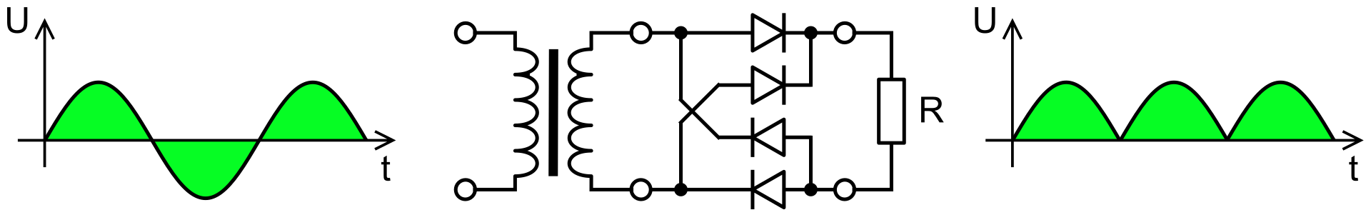

There is a very simple way to estimate the amount of ripple voltage from a diode feeding a capacitor, in turn feeding a load. Look at the ripple voltage with an oscilloscope, and you find it has nearly a sawtooth waveform. We can enormously simplify our calculation by pretending that it is exactly a sawtooth waveform, so that's what we'll do.
The "teeth" have a height equal to the ripple voltage (let's call it Vr). For a bridge or full-wave rectifier circuit, the ripple voltage teeth have a "width" (time duration) equal to one-half the period of the incoming AC. Since period of a waveform is (1/frequency), half that is 1/(2f).
Now we can estimate the slope of the sloping edge of each "tooth", using the simple formula used by carpenters and construction crews everywhere (slope = rise/run). Rise equals Vr, run equals 1/(2f), so rise/run equals (2 x Vr x f).
What we've just calculated has units of (ripple) volts per second; by definition, this is the rate of change of voltage with time.
Next we need the basic definition of what a capacitor does: the current (I) through a capacitor (C) is given by I = C x (rate of change of voltage across the cap).
We've already calculated the rate of change of voltage (it's the slope of the ripple voltage sawteeth), so we can put the two pieces together:
I = C x 2 x Vr x f
What we are interested in is the ripple voltage (Vr) as a function of the current draw (I). Rearranging the above equation gives us
Vr = I / (2 f C)
And there we are. Given the current draw (I), and size of the cap in Farads (C), and the frequency of the AC (f), we can now easily calculate the approximate ripple voltage.
In this case, f = 60 Hz, and C = 4100 uF = 0.0041 Farads. For a one-ampere current I, then,
Vr ~ 2 volts peak-to-peak.
Okay. So if we use a 4100uF cap in a country with a 60 Hz AC mains frequency, we get 2 volts of ripple per ampere of current draw.
