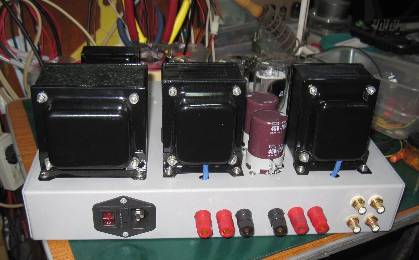

Hey guys.
I just got a bunch, 30 pieces of so, of these really BIG capacitors, only because it was for sale at a very low price.
Now... Is there any use for such big caps in tube amps, or should I just try and resell them to buy other more useful parts?
Seems too big for tube amps for me. Most of what I see use 100 or 220uF high voltage caps, 470uF at most.
And just out of curiosity... What are those big 450v caps used for? Heavy industrial equipment, maybe? What else?
So... Should I just sell them for a burn price online, and buy me more tubes and transformers, or should I keep and use them on tube amps?
What you guys think?
Thanks on advance for any light on this subject!

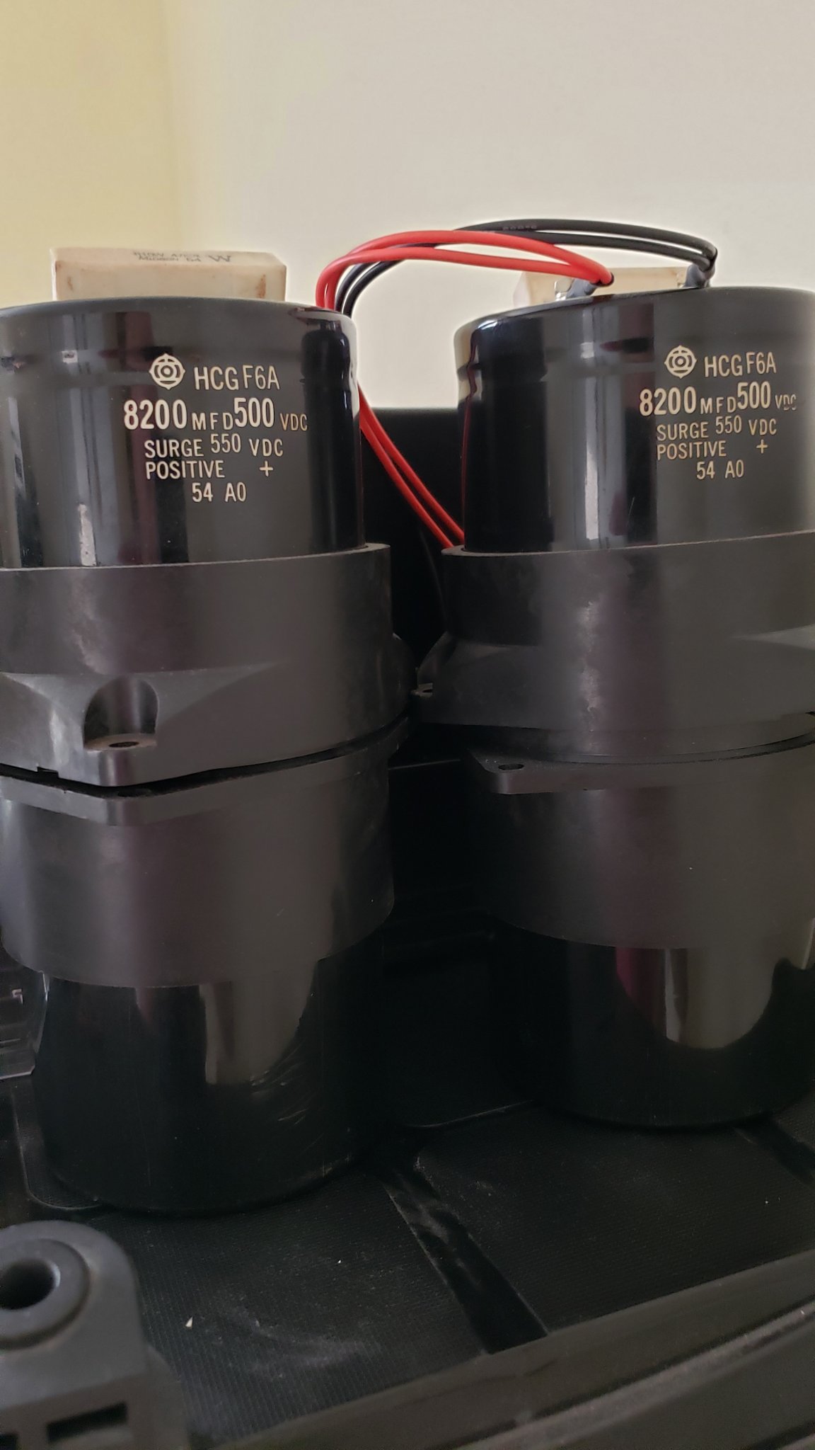

Those are ok, but not as big as these...

And that power trafo isn‘t exactly peanut sized - I think it can handle the high(er) harmonic current of oversized caps. How high a B+ are you running those? My guess is 400 to 420, with an 8 or 6.6k load, maybe 5k if you’re trying to push them beyond the vertical amp Pdiss rating. But that means more distortion so I’m guessing you’re using the higher Z. Not exactly a huuuuge amp. 30 watts-ish per channel? Over sizing caps won’t cause as many problems at sane power levels as it does when you’re trying to see if you can melt glass.
Not necessarily 160 watts output - calculate based on secondary voltage into the load Z. The applied primary voltage won’t be more than the design voltage of 120/240 or you risk the primary inductance going nonlinear enough to notice. A 2x9 V secondary will give 40 clean watts at 8 ohms and 50 Hz- keeping the flux density at what it was DESIGNED for. I doubt you could get any 4X unless you cut out the bass. It doesn’t look like this was one where he stacked two of them.
I understand, hence my question. Those are standard power transformers, plenty of iron for 160VA, I'm interested how much low can they get on the frequency scale before saturation, as well as parasitic capacitance for the top. The 6P45S should do well, plenty of current to spare.
