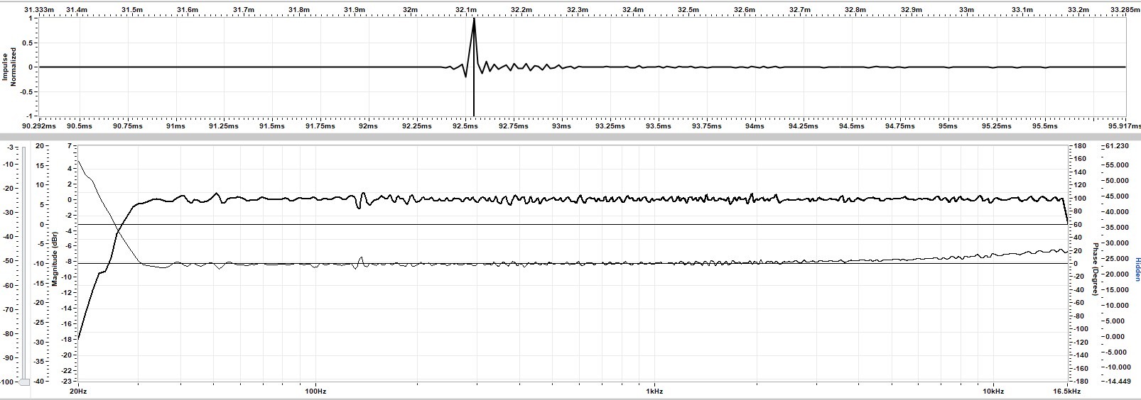

I've used LR 96dB/oct linear-phase routinely, on dozens of projects for about 10 years.
Problems they overcome/advantages:
They allow drivers to be used exclusively in their "sweet bandwidth" where mag is flat, and consequentially phase is naturally flat too.
They reduce lobing by reducing the frequency range of critical summation.
They are damn easy to implement, because impulse peaks align which are easy to identify.
Unlike IIR filters that must have initial impulse rises properly identified. Almost impossible with low frequencies.
They don't change time and phase relationships when changing the crossover frequency (again, like IIR does)
They reduce phase rotations, and make group delay between driver sections equate simply to time-of-flight between sections.
And they rock, because they make it easy for anyone to achieve excellent results. 😀
No more slippery-slope, hoo-doo voodo IIR crossovers to contend with.

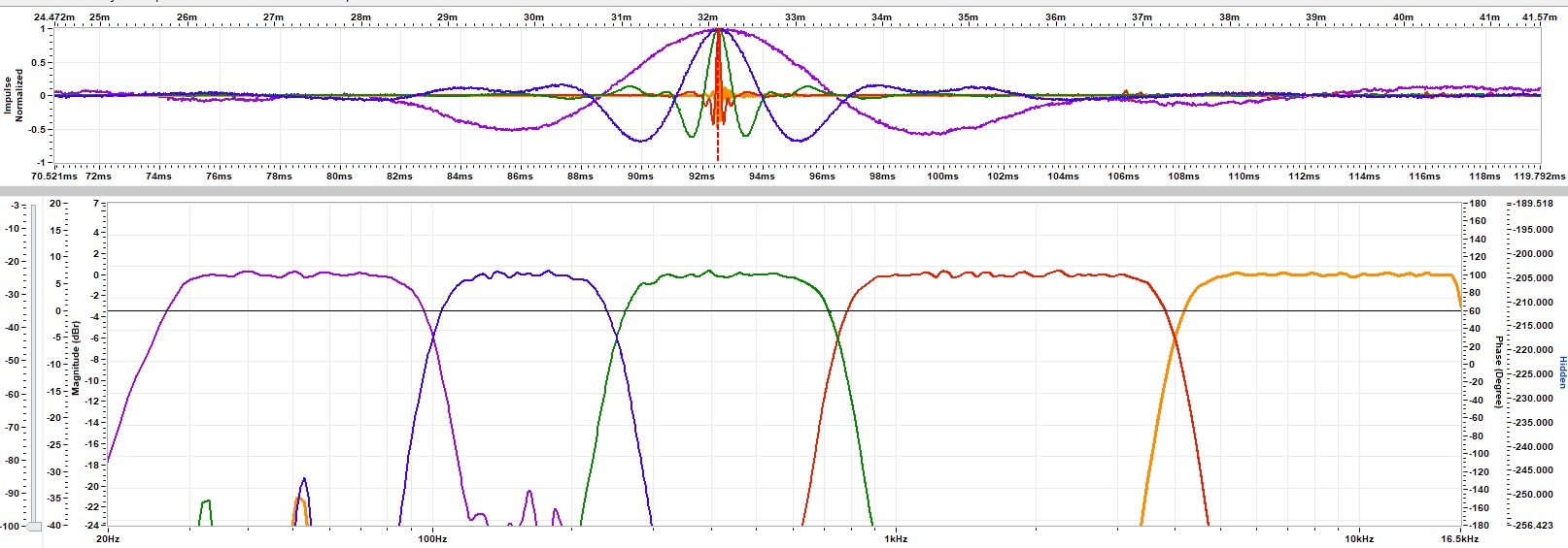

Here's an example of a 5-way measured today.
Individual sections mag and impulses, with xovers at 100, 250, 750, & 4000Hz, all 96 dB/pct.
All below indoors 1m no gating. Sub and main spliced.
Measured full speaker. 1/48th

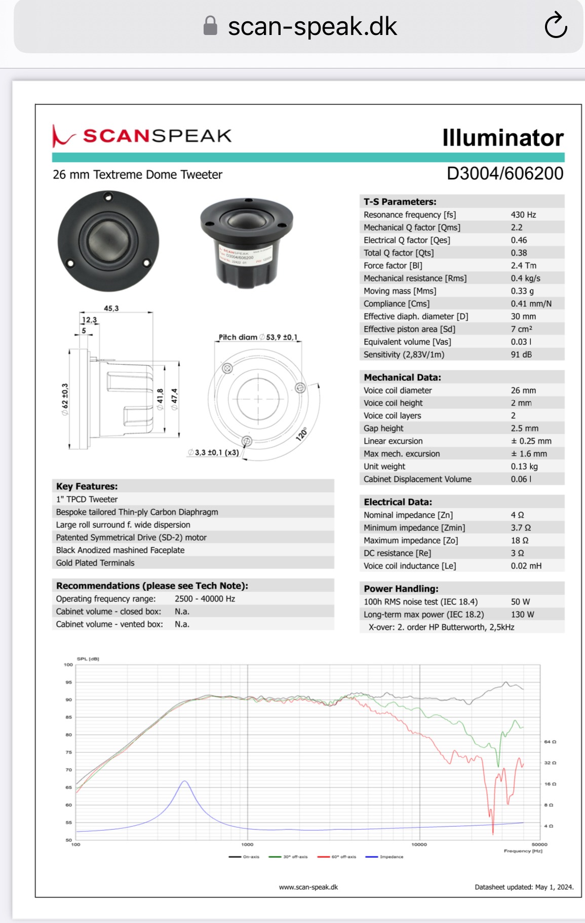

Hmm. I’ve had a look at your drivers and your comments.
Your tweeter is definitely out of date.
I would not change everything at once so l suggest keep using the ATC mid for now.
On the bass that could be your using the SVS sub. You are obviously reaching for more bass and lower because you’re using the SVS.
Is the Volt 2500.1 in a sealed enclosure?
Okay l fed it all into the super computer
This is what l suggest :
Tack it in two stages. The reason is it you change everything it might confuse you.
The mid treble step
Then later the bass step
The tweeter
https://www.scan-speak.dk/datasheet/pdf/d3004-606200.pdf
Your current tweeter has fero fluid. That idea went out of fashion a long time ago. This is a thin carbon tweeter of varying thickness. I think it’s a better material (close to beryllium) for high frequencies. Mount the tweeter like the B&W 801 D4 atop the mid dome. This should make the highs more airy.

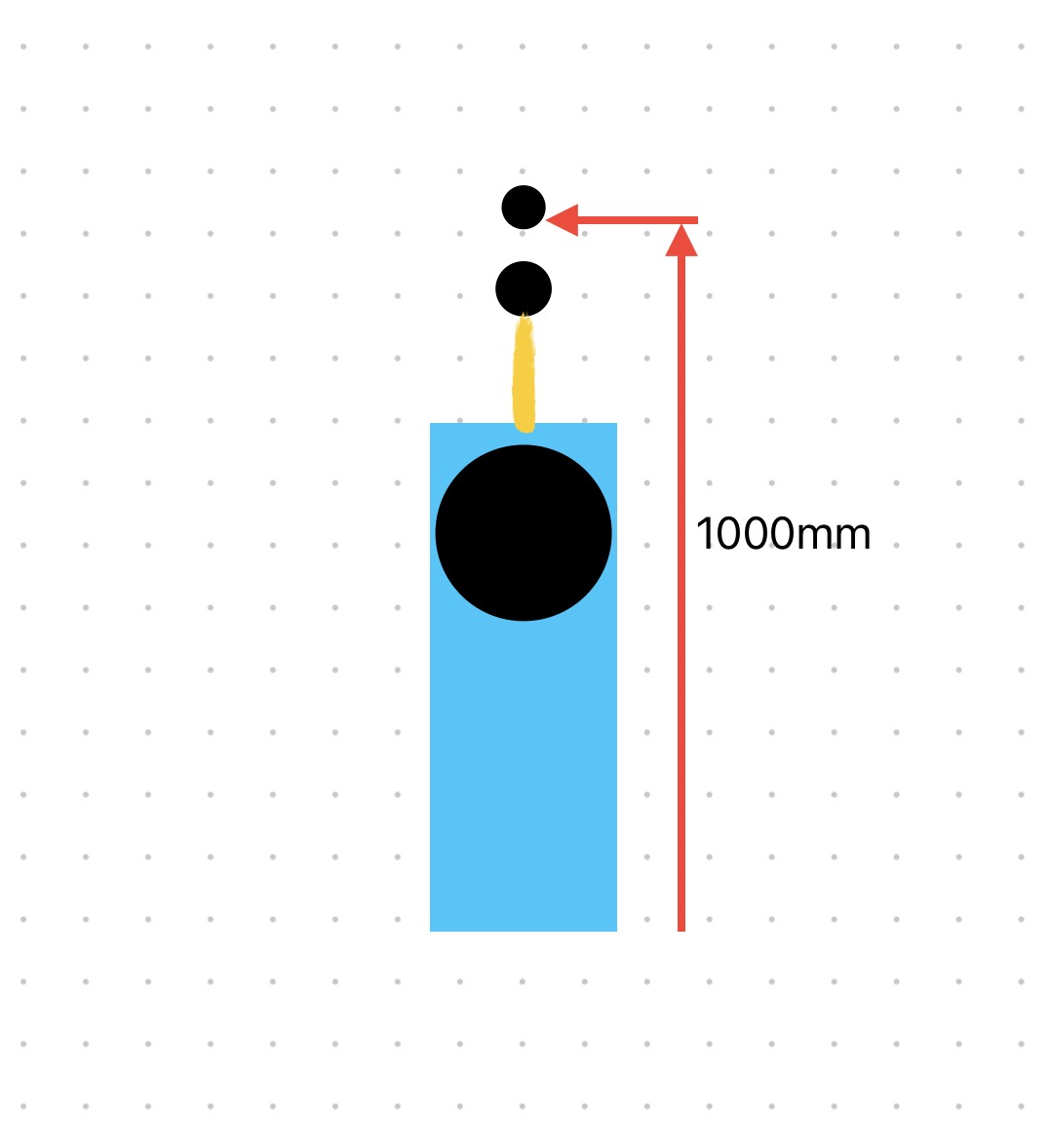

Midrange
Retain the ATC dome for now. Place it in a tube with a round over if possible. Keep it well above the bass enclosure.
The crossover
Take 7 individual measurements around your listening position of the tweeter and then the dome mid.
Then average them and make a driver correction curve for each driver.
Apply the correction and set about creating your FIR crossover filters
Of the mid kid still isn’t doing it for you my suggestion is to try the Purifi 6.5 in midrange. Don’t search for anything else. This is likely the best mid on the planet.
I think the larger radiating area is likely to project better for HiFi listeners as apposed to near field monitors

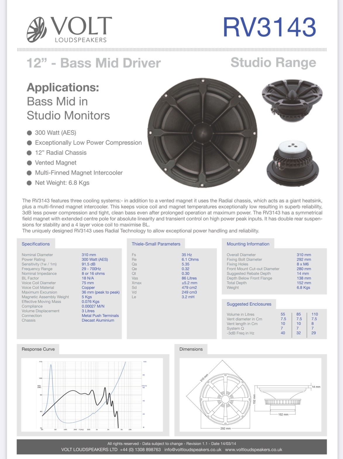

Woofer step.
I would keep your existing Woofer ams used in the recommended vented enclosure. Driven actively it will perform better. If your running it sealed stop doing this. Use the 40L enclosure.
Assess the bass ouput. If you need more bass add a side 12 inch Volt woofer.

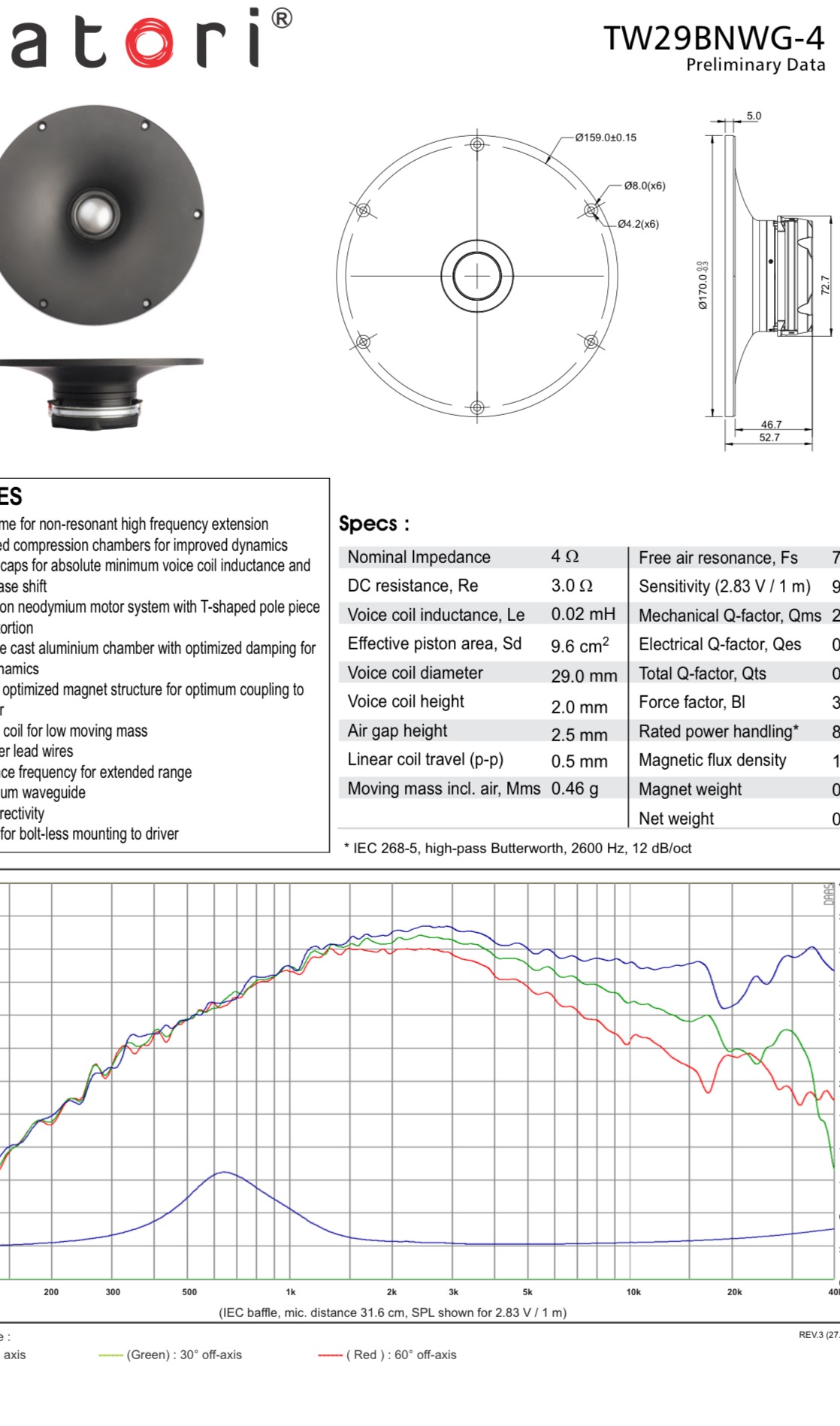

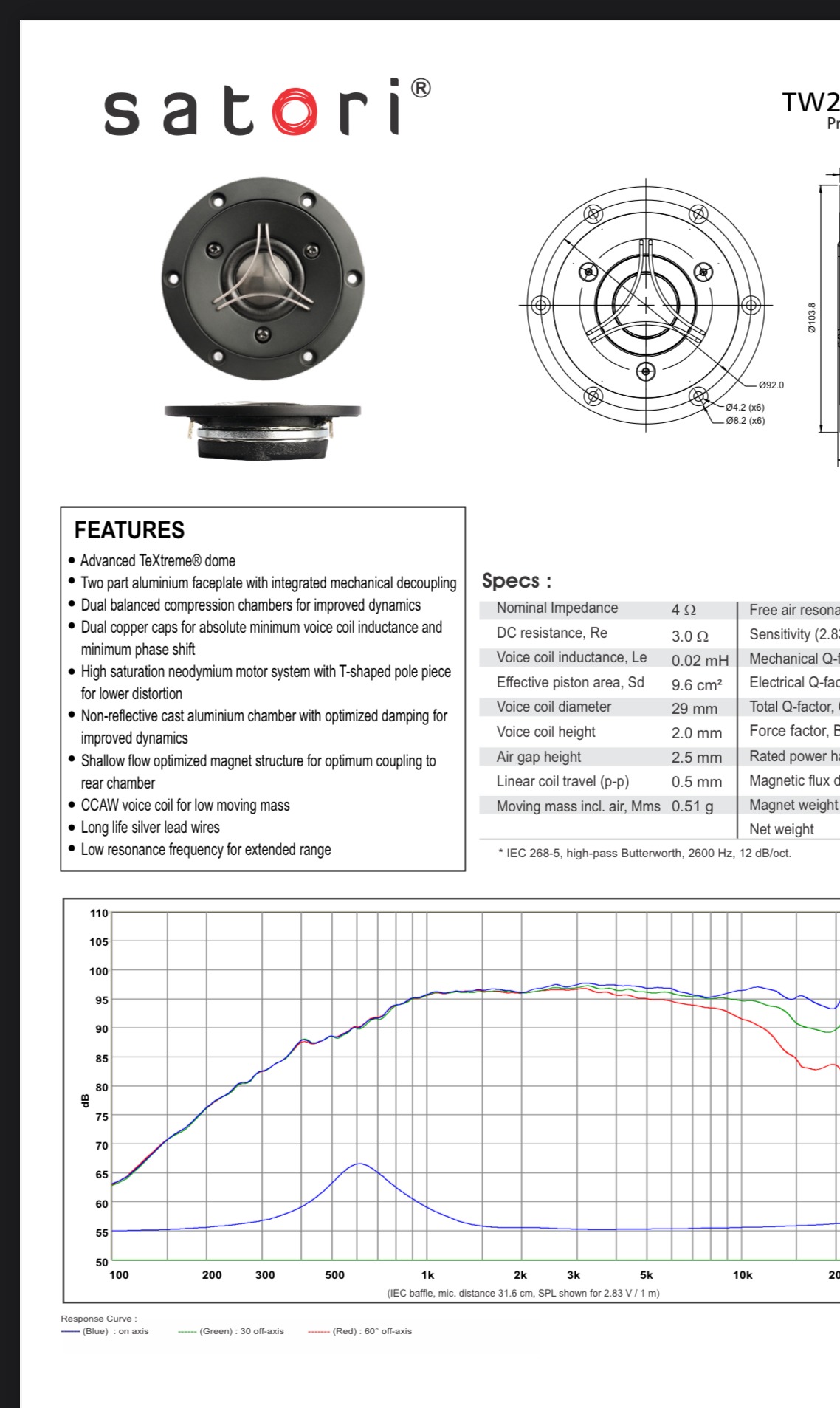

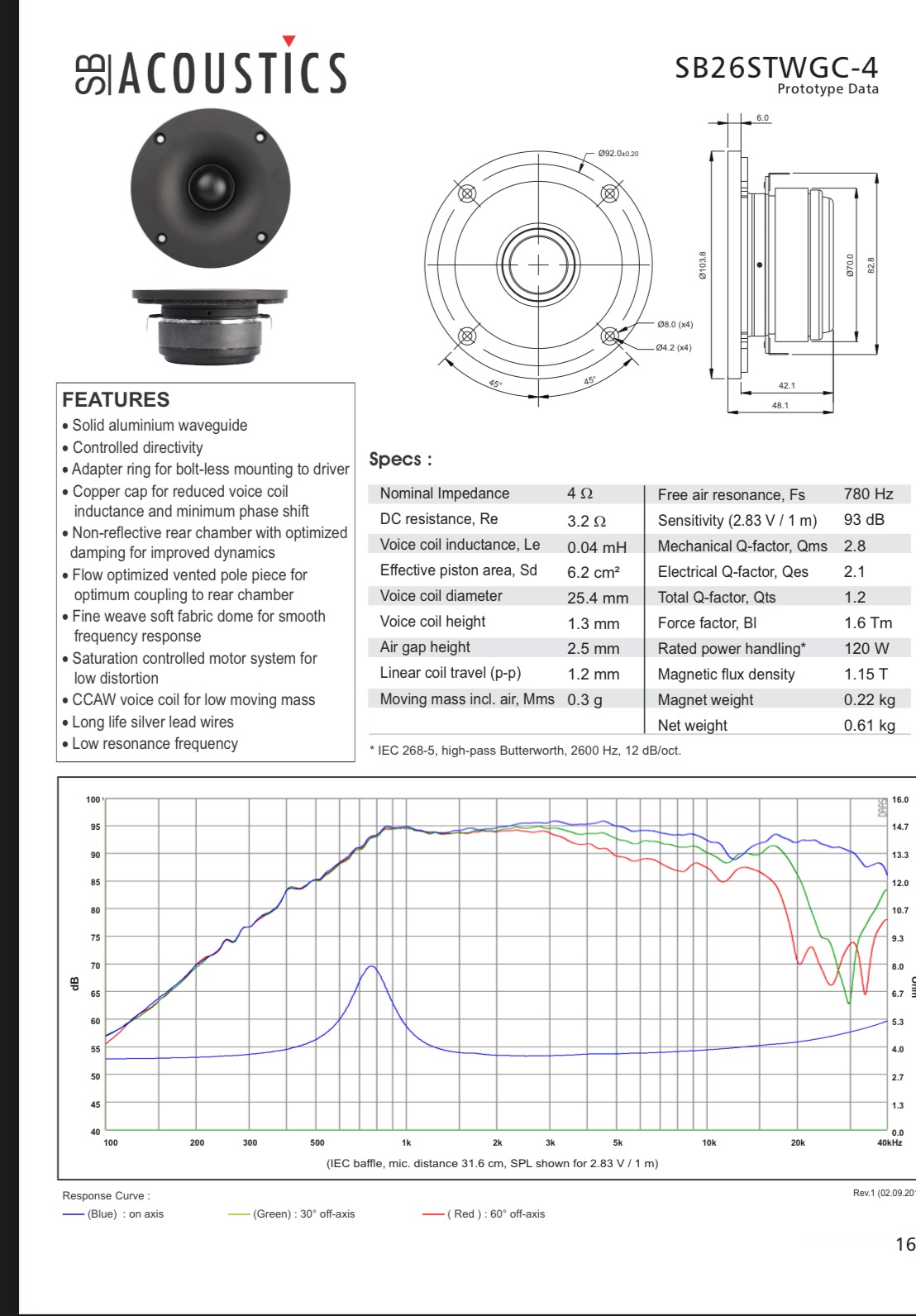

https://sbacoustics.com/wp-content/uploads/2020/05/SATORI-TW29DN.pdf
This tweeter with a wave guide may be a good match to the ATC mid dome at 3.8 khertz
https://sbacoustics.com/wp-content/uploads/2020/05/SB26STWGC-4.pdf
https://sbacoustics.com/wp-content/uploads/2022/09/SATORI-TW29BNWG-8.pdf

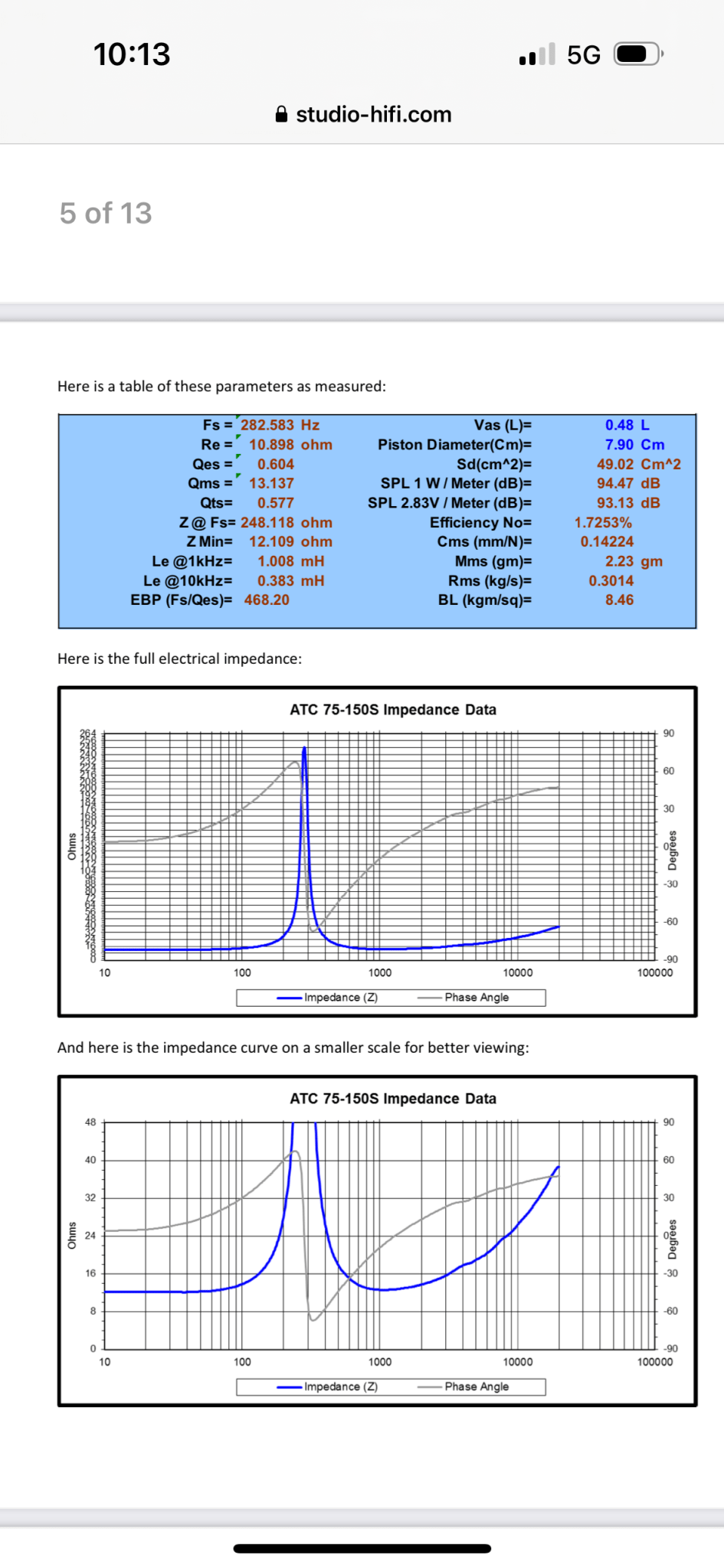

That ATC dome is expensive but it certainly measures really well.
On the active ATC monitors I have heard vocals are really beautiful.
Its Mms / Bl ratio of 2.23g / Bl of 8.46 is outstanding, the best I have ever seen in cones or domes... For me this is the most important TS stat.
The superb CSD graph ultra low distortion and high sensitivity are all linked to this ultra low Mms and high Bl ratio.

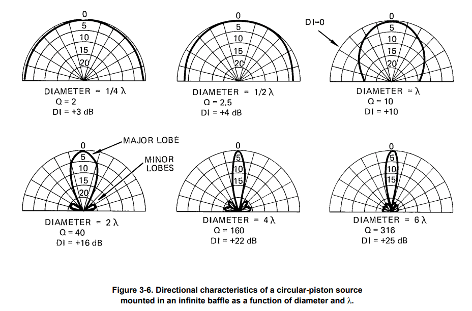

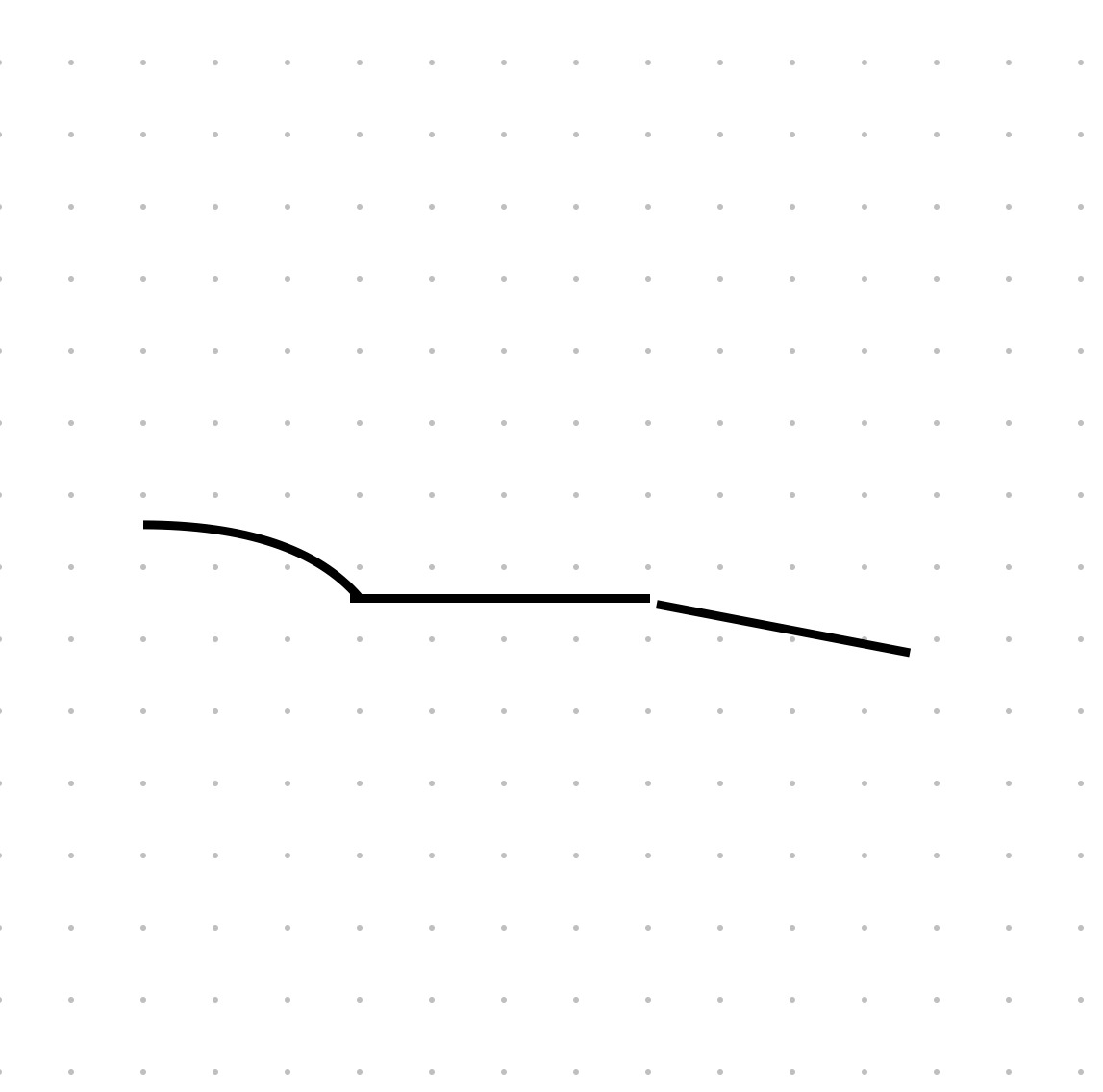

My 'big picture' way at looking at directivity matching between multi-way sections, is that every radiator has a pattern of its own to begin with.
And the that beginning radiator pattern gets further altered (narrowed) by whatever baffle, waveguide, horn, etc it's mounted on.
So, in a sense, even direct radiators are "waveguides", like shown below.
And flat baffles are 180 degree "waveguides".
So again staying big picture, it seems to me matching driver sizes and baffle widths for each driver section, to flow together smoothly, is the name of the game for conventional flat-baffle multi-way designs.
Ime, getting that good acoustic design correct, pretty much mandates the relatively small ranges of acceptable xover frequencies between each set of driver sections.

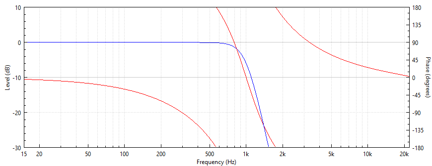

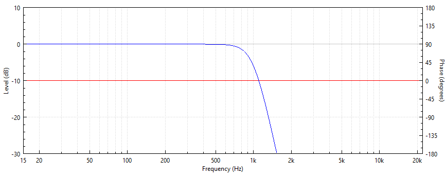

Thanks! The plots are impressive. Just out of curiosity, what do you mean by LR linear-phase? I thought there were only IIR version of LR filters.
Welcome, and hi again 🙂
FIR filters can replicate any from of IIR filters (both frequency magnitude and phase).
So any named IIR filter, either with IIR's phase rotation, or without as linear-phase, is available.
For instance, here is a FIR version of a LR 48 dB/oct low-pass with normal IIR phase rotation,
And then same LR48 linear phase.

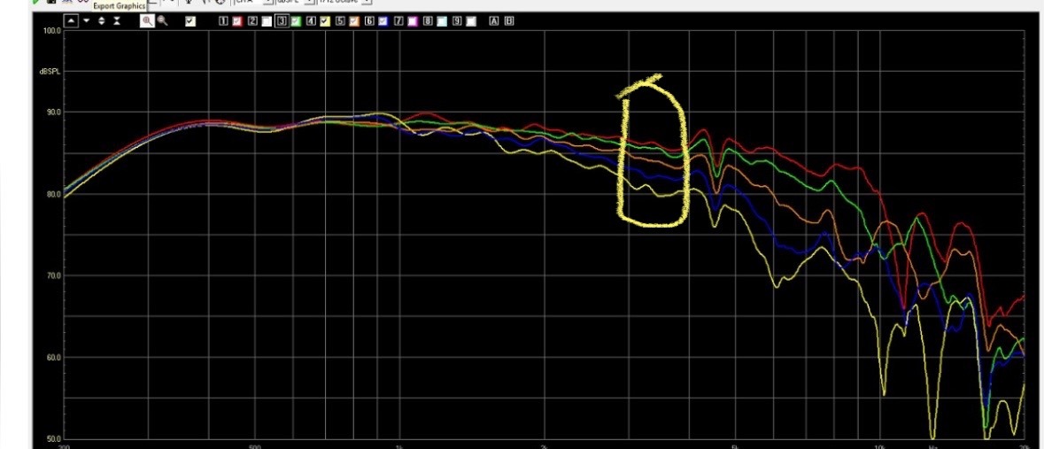

The radiation patterns in #532 show that through the crossover region the small driver has a radiation pattern that changes little with frequency but the large driver has a radiation pattern that changes significantly through the crossover region. This means if you want the weighted sum of the two patterns to be a constant width or changing smoothly with frequency then the crossover slopes need to be curved and not straight like analogue ones as shown in #533. FIR filters can be used to achieve this and is one of their significant advantages over analogue filters (and digital filters mimicking analogue).
OK I appreciate the OP has little interest in this sort of thing for his project but how to go about designing a wide beamwidth 4 way to a high standard is an interesting project. Is anyone aware of previous DIY efforts with narrow baffles and FIR filters to control the radiation pattern? One or two of Keele's publications are likely relevant (someone linked to one earlier) but a brief google found no obvious DIY efforts.
This is why l suggested looking at wave guide on the tweeter in terms the owner can understand
Looking at the patterns of the ATC mid dome it spreads apart much earlier than a flat face plate because of the short wave guide.
This means it’s best to match it with a tweeter which has a wave guide to optimise the continuity between the mid dome and the tweeter patterns.
None of this is rocket science when observed visually.
See the attachments below.
The ATC dome pattern spreads to about 4 db relative to on axis at 3Khertz referring to 0, 10, 20, 30, 40 degrees.
Therefore the objective is to match these patterns to a tweeter at the cross over point
Moving back to 2 khertz would place the cross over in a critical part of the hearing range. All is not lost however.
Because you want low diffraction the mid dome has this built into it with the short waveguide.
Taking this benefit you can apply it to a tweeter with a waveguide. What is apparent when looking at the off axis patterns of a tweeter with a wave guide is that they are also spread.
By my eye about 3.6 khertz would be a good place to cross over to a tweeter waveguide.
When combined the off axis pattern should be smooth.
An additional point is that the owner does not necessarily need to have a ruler flat response in-room. Depending on the room acoustics a smooth taper above 2 khertz is appropriate with constant directivity. The build up of high frequency reverberant energy is best balanced with low freq shelf EQ below 100 hertz. We do this in the case of the JBL M2 clones because that wave guide has very wide directivity
I prefer to outlines these concepts visually on a forum to make it easier to interpret. I also believe in KISS in diy. Simple solutions to complex problems often work best in audio.
In diy we are not loudspeaker designers in the sense that we don’t do this all day every day and nor do we have an acoustic test chamber and two decades of experience. So we need an explanation of the underlying concepts. Over thinking details can easily lead to confusion and miss direction. The advantage is in diy we don’t need to listen to the marketing department or the accountant.
The above approach avoid the need to fabricate low diffraction baffles. To finish the industrial design a grill cloth stretched over a frame like the vintage ESS AMT 1 might work.
When proportioned appropriately this would compliment the tower form factor.
Edit In the ATC patterns the 30 degree lines is in blue which is hard to see.
If the acoustic design has pattern transition problems, my guess is low order xovers are going to hide them better than high.
With a very good acoustic design, my experience is high order-works better by narrowing the frequency range of xover induced lobing.
My turn to say, make sense? 🙂

My final comment is that rocking of the voice coil in large dome radiators is a known factor to distortions. ATC are to my knowledge the only one offer dual spiders and a 6mm peak Linear X max in a 75mm dome radiator. The voice coil is 3.5mm in a long gap with a Peak Xmax of 6.00mm. This under hung motor in an inherently low distortion masterpiece.
My understanding is the coil is always in the gap.
In the quote below the facts speak for themselves:
Quote
“I measured the electro-mechanical parameters of the ATC SM75-150S driver. The sample submitted to me had a fairly high Re of almost 11 Ohms, so it likely called a 16 ohm driver. (I believe a lower impedance 8
The one parameter that stands out for this midrange is the very high Qms value of 13, which means there is very little mechanical damping of the driver's resonance (mechanical losses are very low). The high Qms results in an impedance peak at Fs of 248 Ohm. This would indicate that the driver is not suitable for a first order electrical filter, but use of a properly designed second order electrical filter, especially one with an L-Pad resistor network will easily compensate for this impedance peak. My sample had a measured Fs of 282 Hz and a Qts (actually a sealed Qtc) of .577, for a nice well-damped second order roll-off.”
