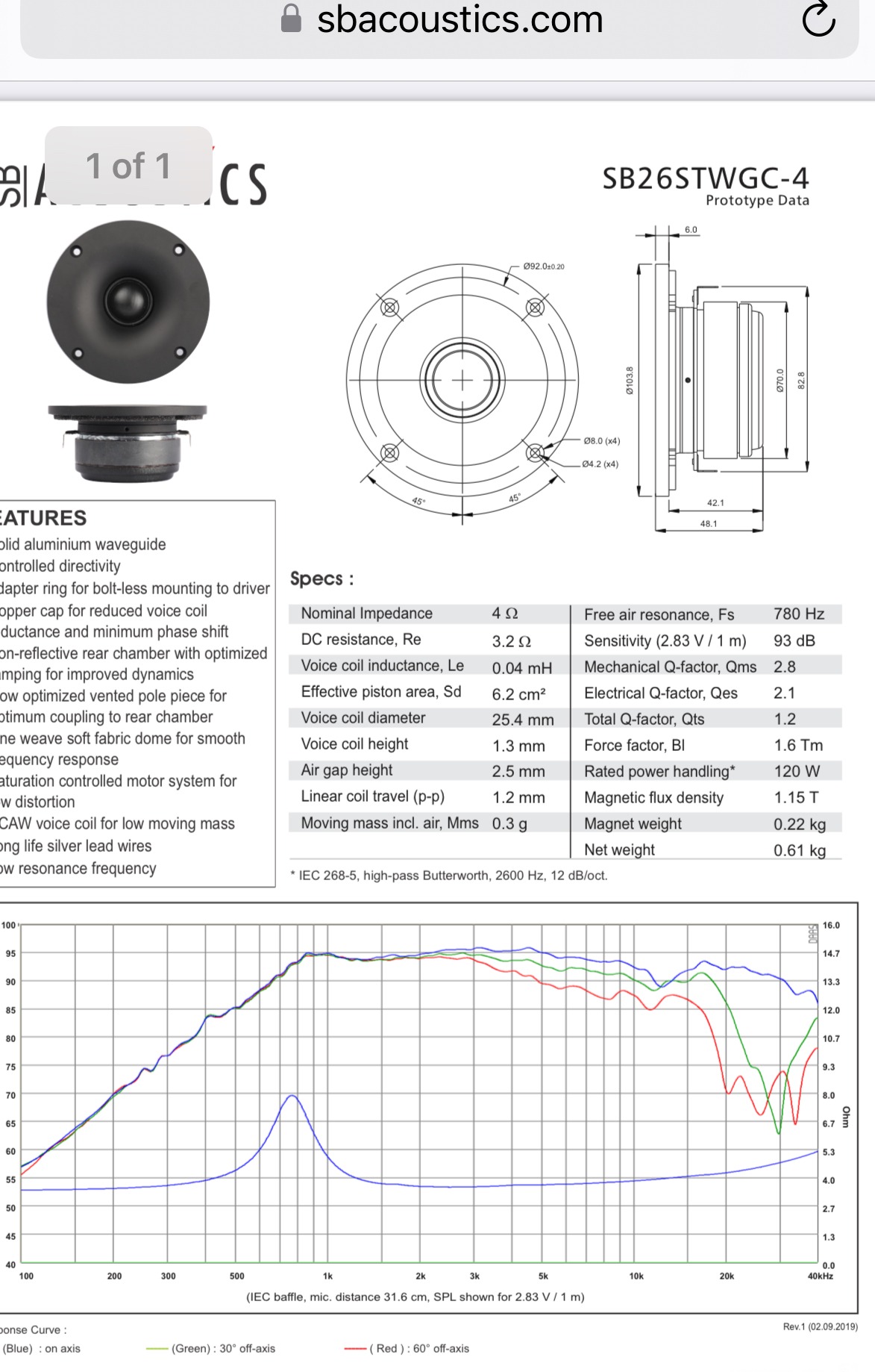

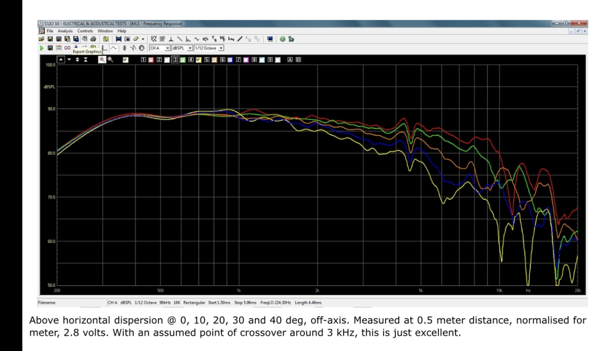

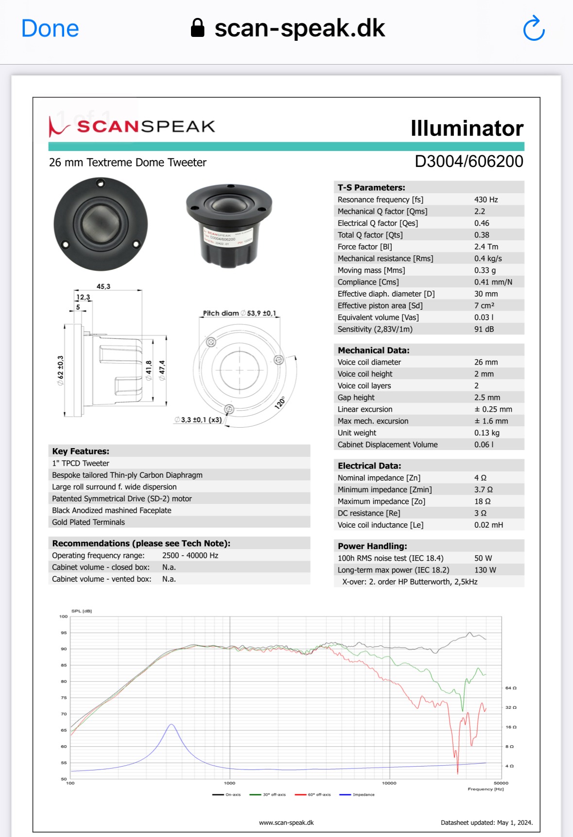

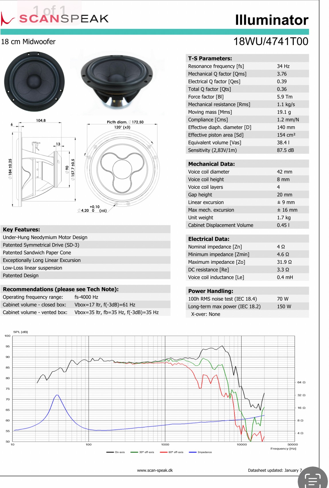

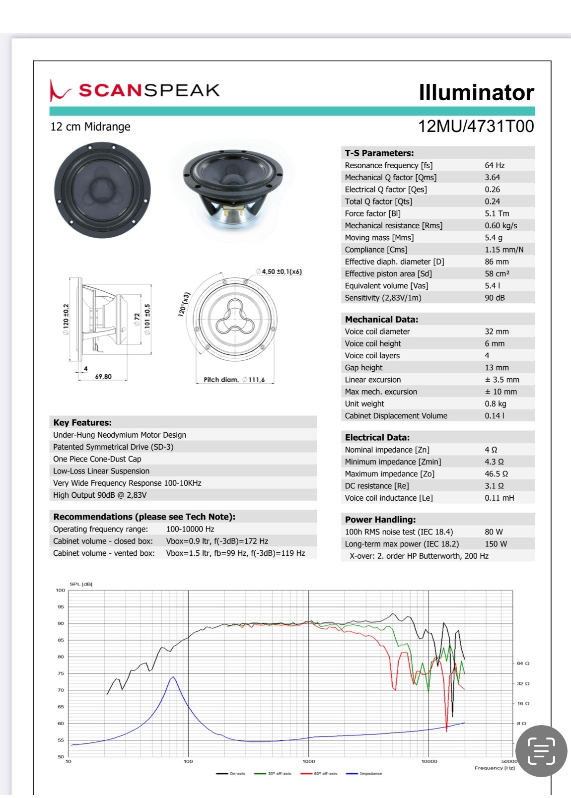

In the table below l have set out the matrix of drivers discussed as a measurement of off axis level relative to on axis at 3kertz.
30 degree off axis tracking
2.5K. 3K. 3.5K. 4K. 4.5K
18WU4741. -3. -4. -4. -7. -9
MD 60. -1.5. -2. -3. -3.5. -4.5
ATC mid. -2.5. -3.5 -4.0 -4.5 -5
Tweeter
3004/606. 0.0. +1.5 +1. -1.5. -1
Wave guide
SB26STW -1. -1.5 -2. -2.5. -3
Scan mid
12MU4731. -1. -2. -2. -3. -4
Looking at the above results my pick of any pairing is as follows. Ranked in degree of difficulty to implement easiest to hard work.
  1. ATC mid + SB26STW crossover 3Khertz
Comment. Both have a falling off axis
trend Simple solution as both drivers
have designed in diffraction and CD
3. 18WU4741+MD60+SB26STW
150 hertz - 800 hertz in 17L for B2
sealed , cross to MD60 800 & 3,800 hz
Cross mid dual woofers with
independent low pass crossover filters.
Complex and difficult to implement.
2. 12MU4731+ SB26STW crossover
3.5Khertz, 18WU4741 crossover 350
hertz, delete 70 hertz HP filter
Comment. Both track closely relatively
A good combo with a discrete narrow
band mid bass woofers 70-350 hertz
Less complex than No 3 as the single
Mid driver operates 350-3.5 khertz
Dual 8 inch sealed mid mass woofers
require only one low pass cross over @
350 hertz. 12 db HP Bessel Transfer
function will does not require an
active high pass filter
an active HP filter @ 70 hertz for
music reproduction.

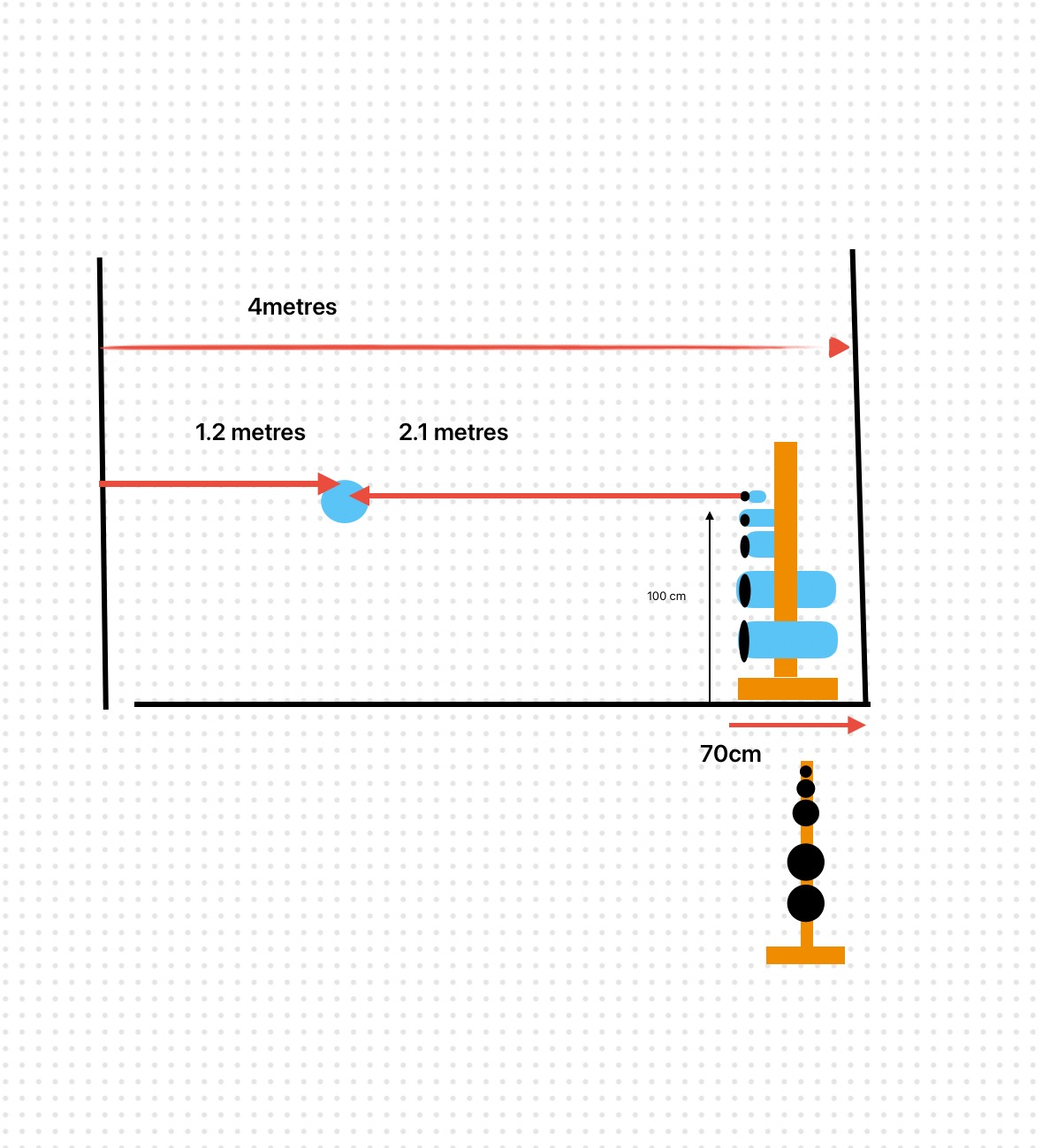

A question(s)for the owner
How many feet do you sit from the Winslow system?
How far out is the front baffle from the front wall?
What is the distance from your listening position to the rear wall?
How far is the left and right loudspeaker from each side wall?
I re read your previous post on your experiences with room correction and the affirmative feedback from your friends.
Can you describe how you went above getting the Winslow system to perform to the point it is now?
What have you discovered along the way?
Looking at the attached sketch how have you located your listening position?

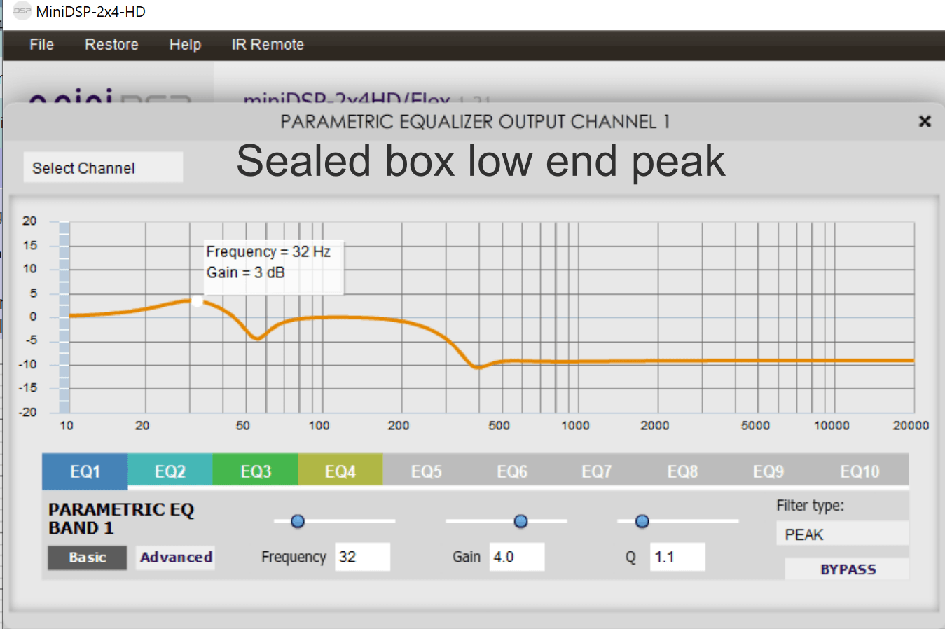

Yes, if you want a sealed box Qtc of 0.5, the box volume is always large. Are you sure you want a natural system Qtc of 0.5? With an active DSP system, it is often a better compromise to design a Qtc of 0.7 to 1.0, and then use DSP EQ to extend the bass. You can mimic exactly a Qtc of 0.5 if you wish, but with a much smaller cabinet size. A smaller cabinet has less surface area, and less opportunity for structural resonance.
In my room, I found a system Qtc of about 0.6 is the most natural sounding... This is after DSP Eq. My natural system Qtc is about 0.9 .
j.
Thank you hifijim.
I wish I could just quote a reply right below it. I can definitely boost the bass below the natural f3. Expecting the SVS 13" sub or future 12~15" side-firing passive subwoofer below it, what f3 do you think I should aim at with 2 8" woofer? 40~50Hz?

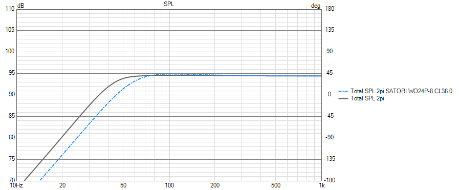

As an example of what can be done....
Here is a pair of SB Satori MW19P-8 woofers in a 36 liter box (18 liter per driver). The dashed line is the natural response which has a Qtc of 0.85 and F3/F6 of 52/42 Hz. The solid line is with a shelf filter. Now the F3/F6 is 39/32 Hz, and the Qtc is about 0.8. The shelf filter is +4 dB, 47 Hz, 2nd order, Q=1.0

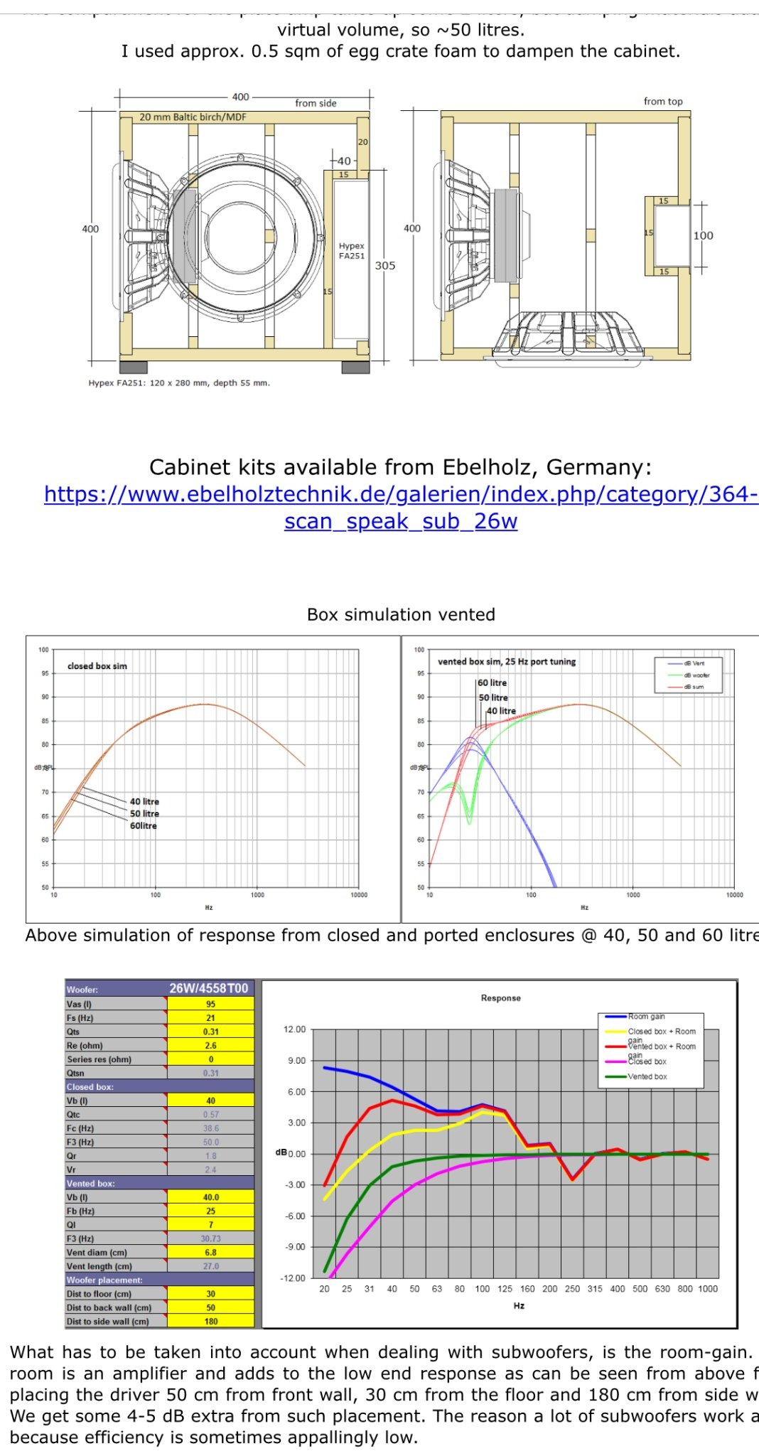

1. A music sub such as the high quality Troels design l posted. This will in fact easily operate up to 150 hertz giving you some margin. The 30 cm woofer requires a 40x40x40 cm box - with passive radiators
2. Given the specifications of the music sub you can operate mid bass sealed enclosure with just a single woofer over 150-500 range
This would be an optimal mid bass situation in a sealed enclosure. You could go up to 800 hertz if that’s what ya want to do.
If your using stereo music subs thus is quite workable with a 150 hertz crossover point. A single woofer would be okay down to 100 hertz.
In my experience an 8 inch mid bass is best from 120-150 hertz . The small cone area just isn’t suitable for dynamic chest thumping bass at 50 hertz. The sub will over power two 8 inch sealed woofers.
