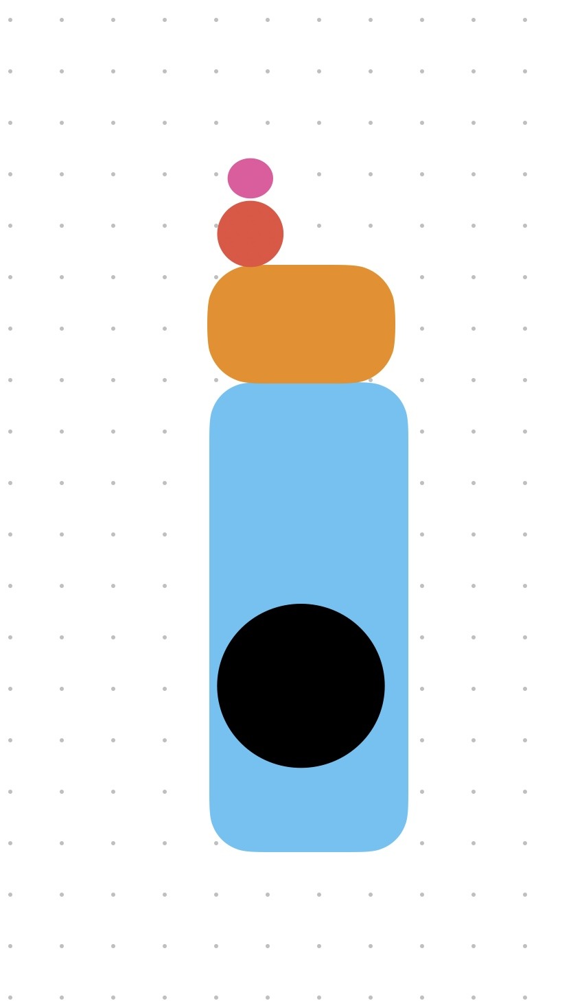

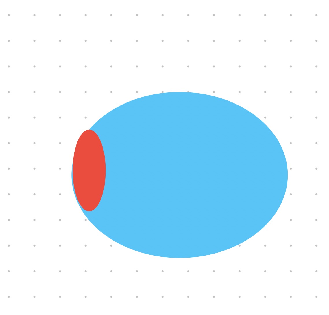

The the attached sketch the woofer enclosure could be integrated into the main enclosure with dimensions of 16.5 x 35x 80 cm. The front facing mid - bass driver single cone would neatly sit on top of your woofer enclosure.
I would look at modelling clay to come up with an egg shaped enclosure that your Satori 60mm dome mid and tweeter could fit into.
Once you have the shape it will go hard in a few days. Then spray paint it with an aerosol can pack.

Let me clarify this. The double-woofer module is a front-firing bass(or "woofer") module, meaning traditional woofer section. For the side-firing subwoofer modules in somewhat distant future, I'd use 12 ~ 15" drivers.

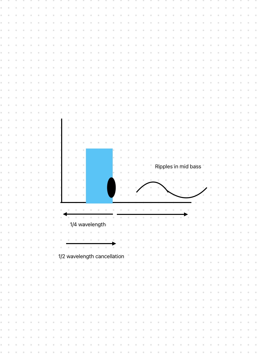

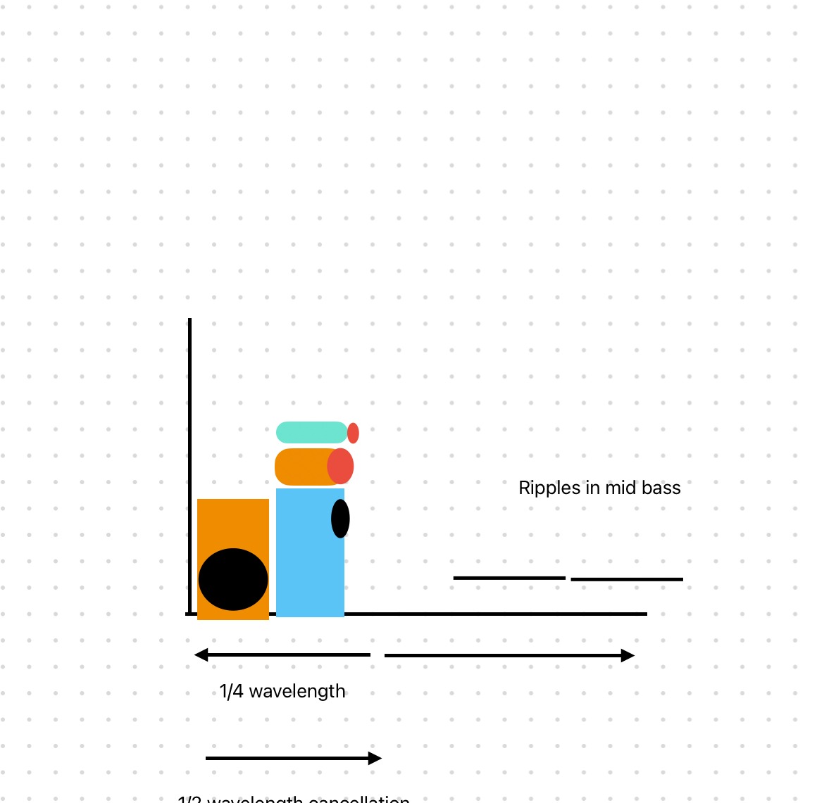

I while ago l bought Douglas Self’s book on active crossover. This was the analogue theory and design. But in the application he makes a very good point that placement of the woofer up against a wall significantly reduces 1/4 wave reflections off the wall. This results in a much smoother bass above 100 hertz. Logically a woofer placed sides is closer to the wall.
A 1/4 wave length of 344 hertz is 250 mm is ten inches. 1/4 wave of 150 hertz is 570 mm
The reflection off the wall cancels on return with the woofer at 180 degrees or 1/2 wavelength.
The further out in the room you move the loudspeaker the more ripples you get in the mid bass.
This can be at odds with obtaining the best sound stage.
So a separate woofer module place behind the main enclosure can solve some problems by getting the woofer much closer to the wall. If your main enclosure is deep then a side firing woofer would be an advantage.
