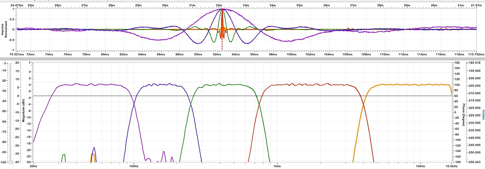

I've used LR 96dB/oct linear-phase routinely, on dozens of projects for about 10 years.
Problems they overcome/advantages:
They allow drivers to be used exclusively in their "sweet bandwidth" where mag is flat, and consequentially phase is naturally flat too.
They reduce lobing by reducing the frequency range of critical summation.
They are damn easy to implement, because impulse peaks align which are easy to identify.
Unlike IIR filters that must have initial impulse rises properly identified. Almost impossible with low frequencies.
They don't change time and phase relationships when changing the crossover frequency (again, like IIR does)
They reduce phase rotations, and make group delay between driver sections equate simply to time-of-flight between sections.
And they rock, because they make it easy for anyone to achieve excellent results. 😀
No more slippery-slope, hoo-doo voodo IIR crossovers to contend with.

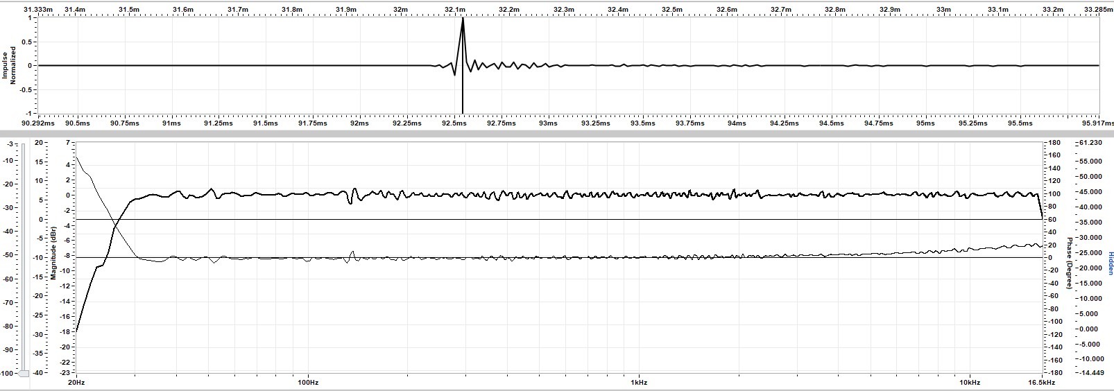

Here's an example of a 5-way measured today.
Individual sections mag and impulses, with xovers at 100, 250, 750, & 4000Hz, all 96 dB/pct.
All below indoors 1m no gating. Sub and main spliced.
Measured full speaker. 1/48th

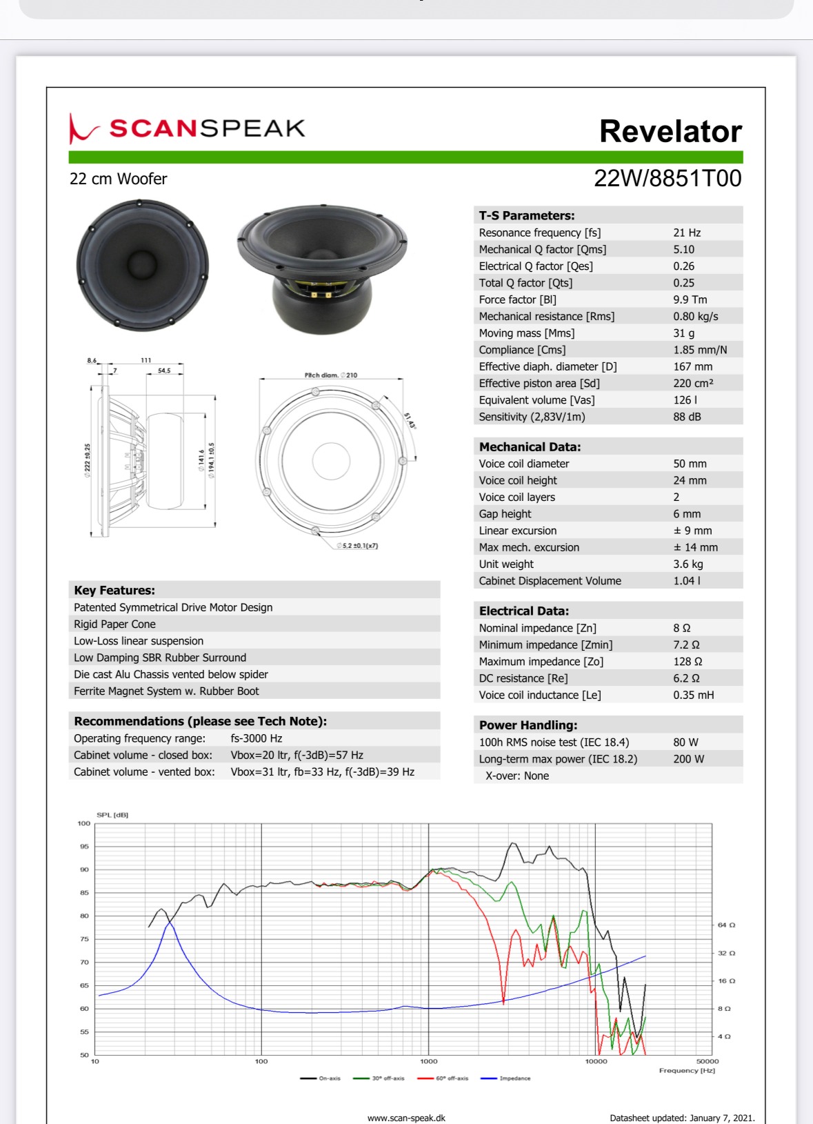

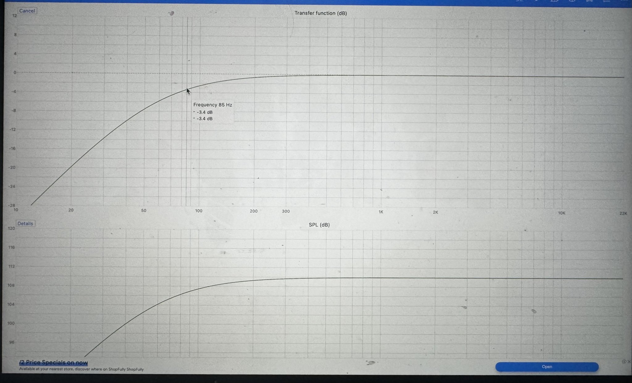

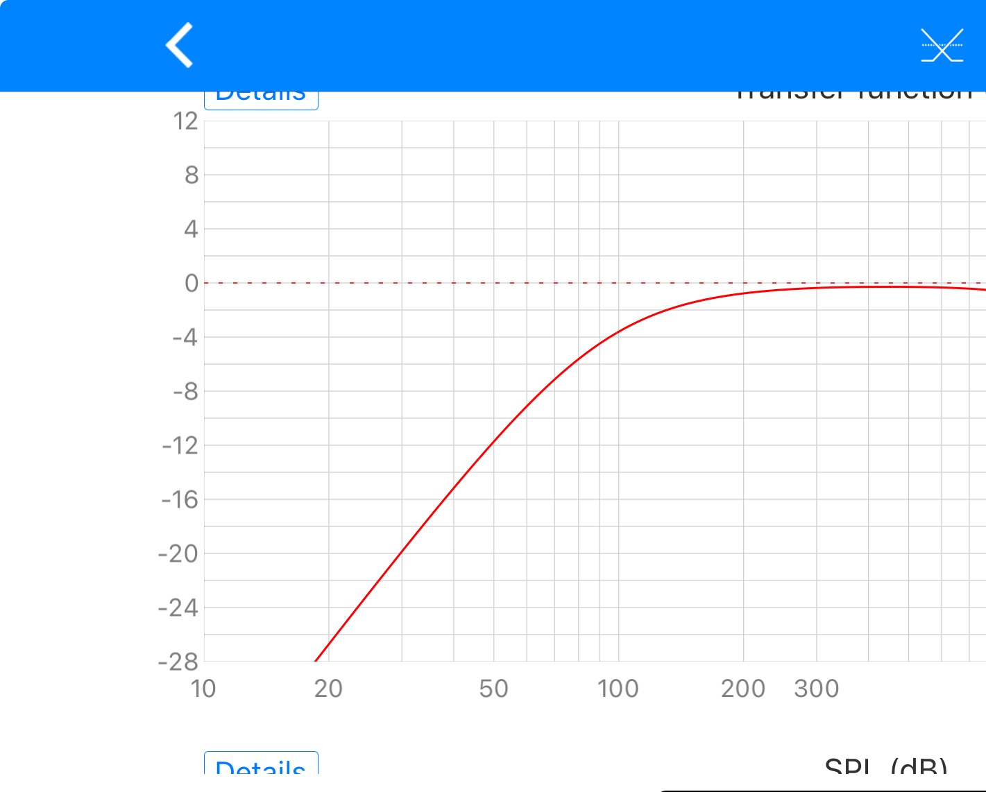

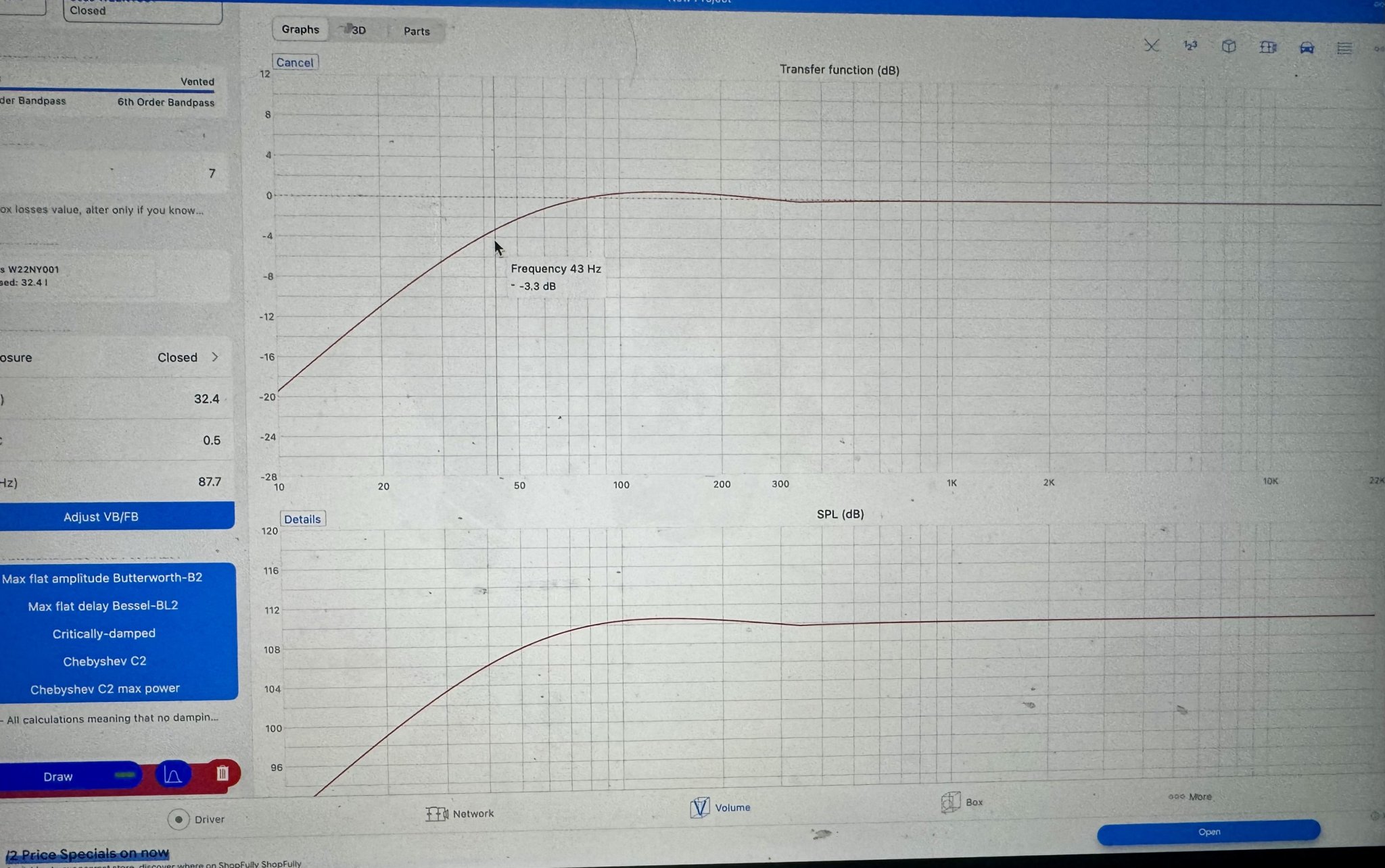

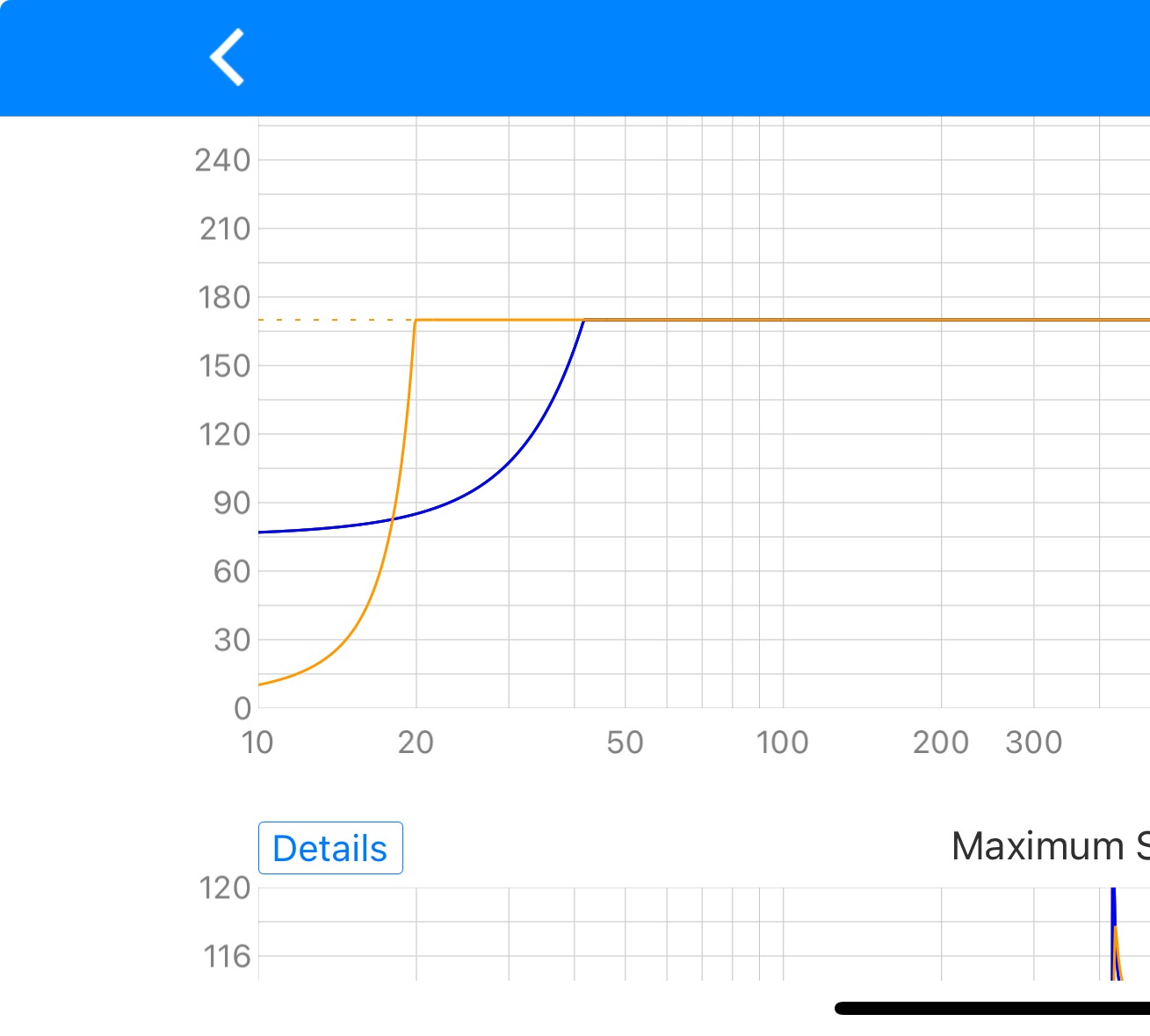

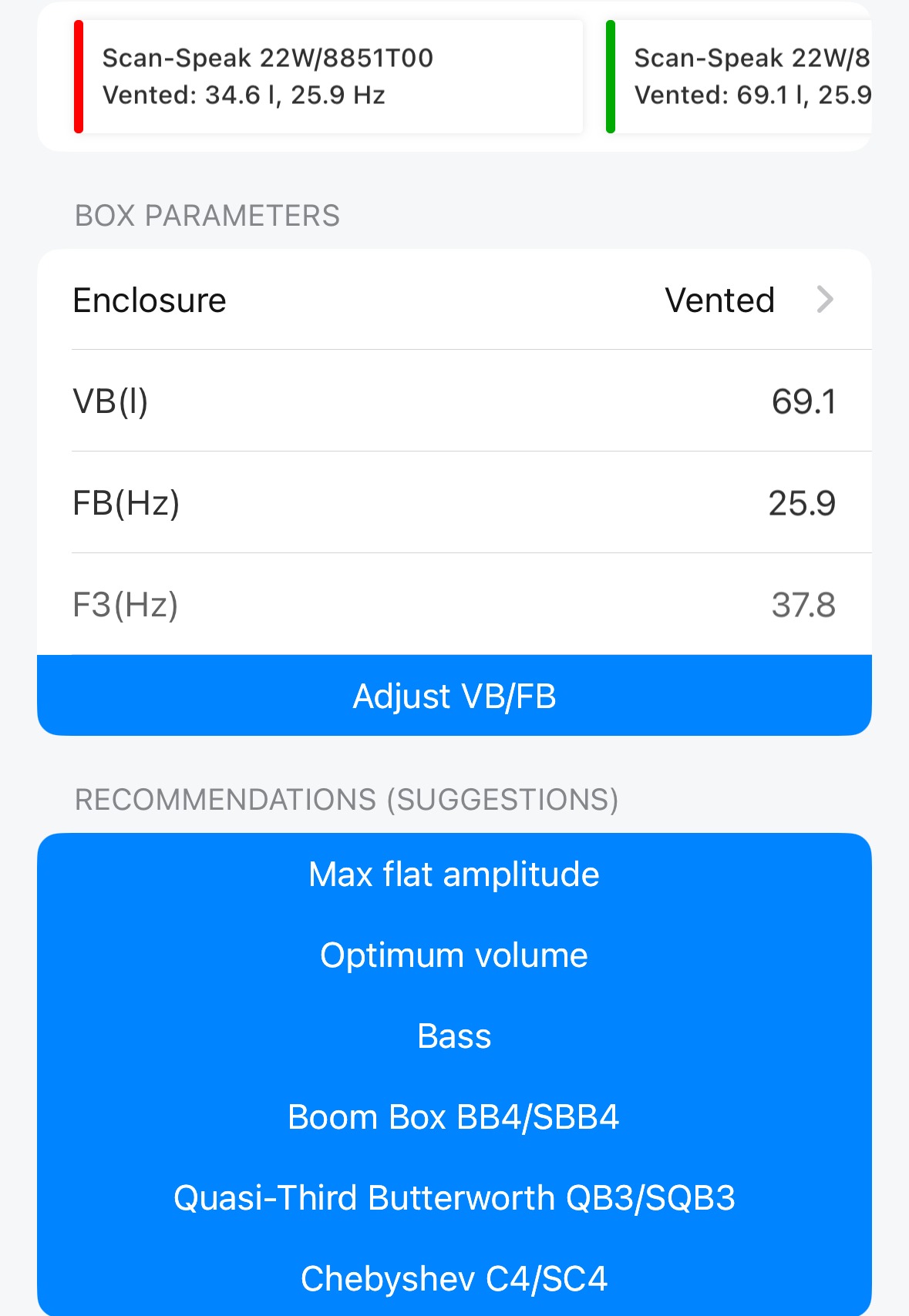

I had a look at the woofer list.
The best were either of the Scanspeak or the Volt woofers. The others aren’t worth thinking about. The Scan drivers have low inductance which is good indicator of a well engineered driver.

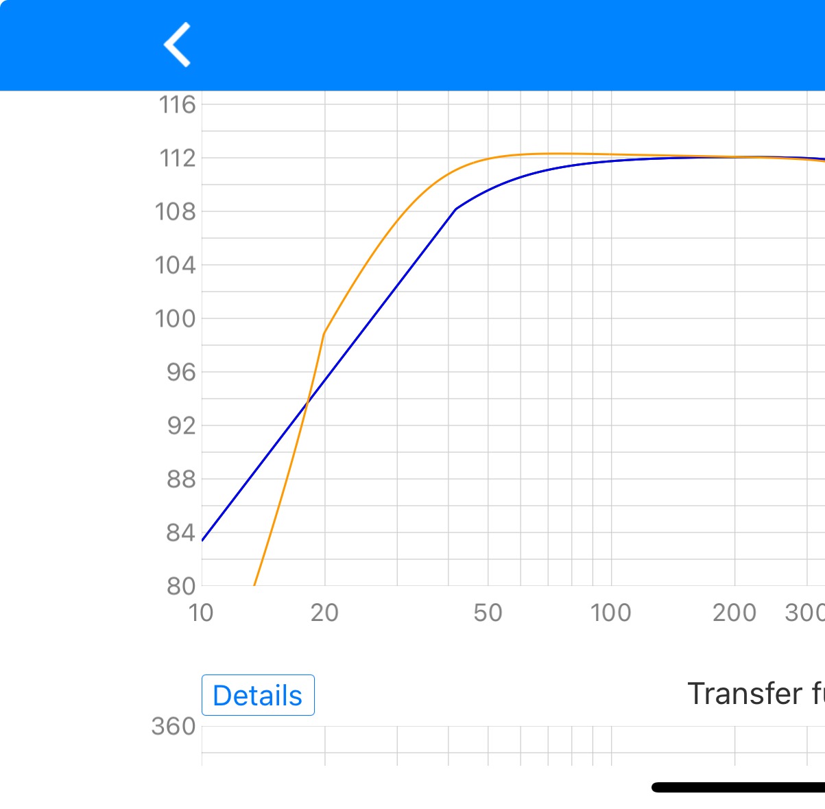

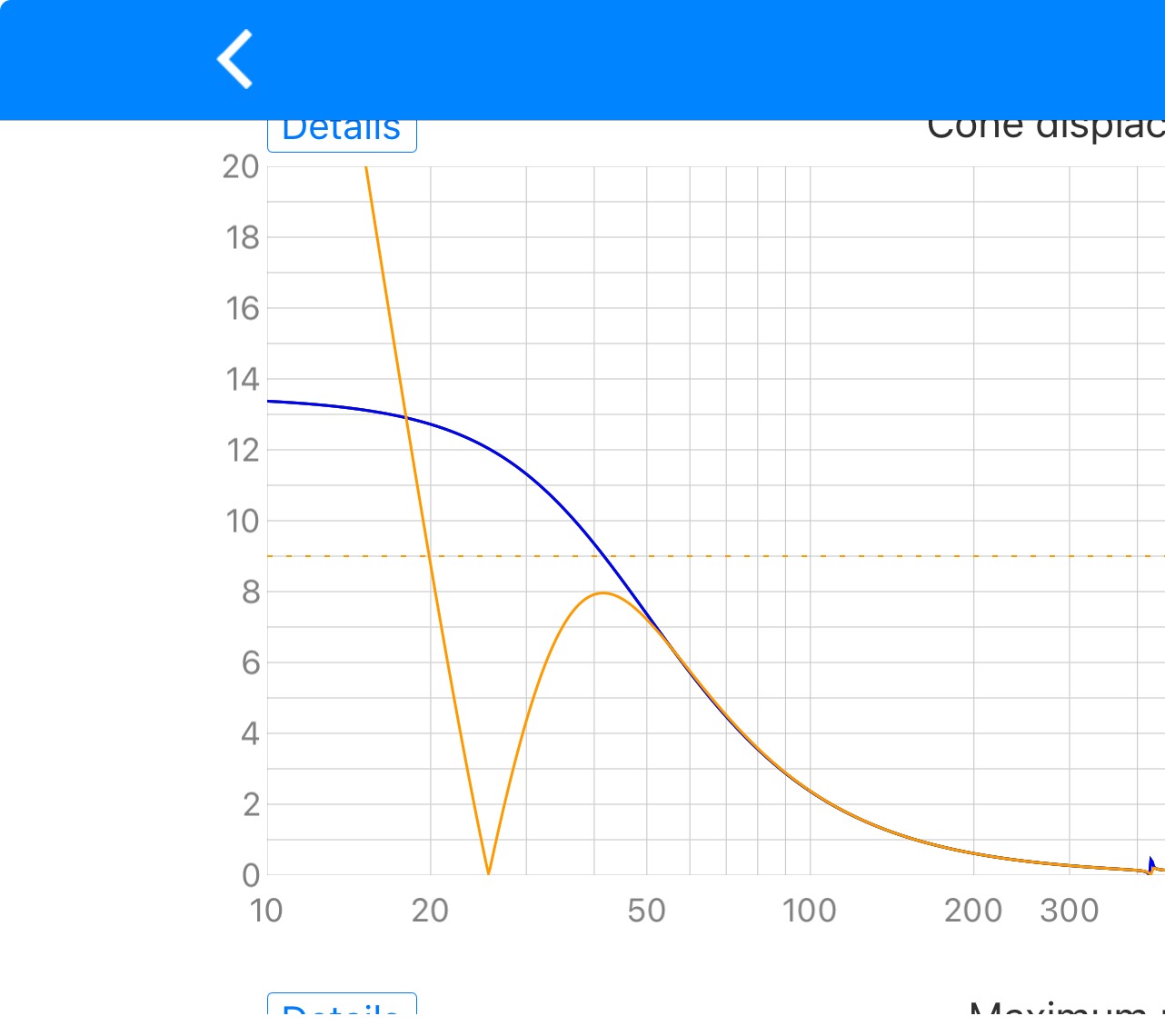

The simulation of a woofer in an enclosure is fairly matter of fact below 100 hertz. I would recommend a flat baffle supporting both woofers. Despite your desire for a narrow baffle it will still help load the drivers near the floor.
Because you’re only going up to 400 hertz your best bet is to place one woofer in it’s sealed volume and the other in an optimal vented alignment.
This will give you depth and speed in your bass.
In essence your sealed woofer acts as a mid bass driver. The sealed woofer is at the top with the vented woofer near the floor.
Halve the volume in the screen shot for a single woofer in a vented enclosure.
Add you floor loading and you have quite a robust low frequency system down to the low 30’s. I would rear vent the port as it will be a reasonable length in this size enclosure.

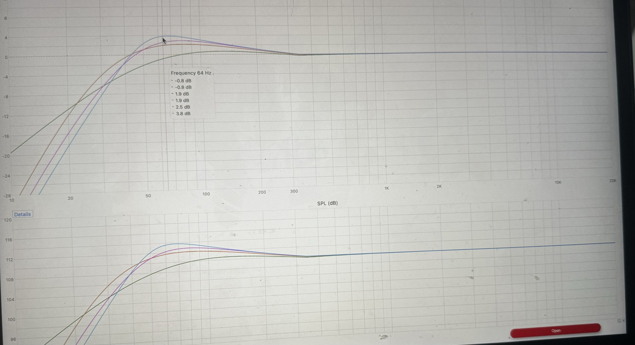

DI match at 400 hertz crossover point from the woofer??
Baffle step with a low pass cross over 400 hertz with two stacked 8 inch woofers. If there is simply EQ out. The dual woofers will candle it.
It’s an approach to obtaining a Bessel vented alignment which is quite difficult to do because of the exact QTS valve required.
Sealed enclosures have inherently better transient attack. That is beyond question. So do transmission lines because the line has a low Q spread over a broader frequency range. Thats the explanation from PMC in the UK who have refined the transmission line.
By operating both a seal and a vented enclosure together it’s possible to get the best of both. I personally owned a commercial consumer system using 6.5 in Scan woofers using the approach and it was excellent.
I wouldn’t default to EQ until assessment in the users own room.

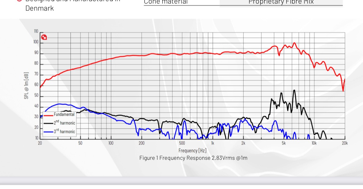

If the ATC mid dome falls through l would suggest the Purifi 6 inch mid range driver. There are several versions. The higher efficiency one. They have very low distortion and apparently don’t have a sound.
Below is an impartial test report by Vance Dickason
https://audioxpress.com/article/test-bench-the-ptt6-5m08-nfa-01-6-5-midrange-from-purifi-audio
The B2 simulation gives be a 5L sealed enclosure . It has a peak Xmax of 6 mm
The data sheet with full disclosure
They also provide data you can import into a simulator for design work
https://ptt.purifi-audio.com/web/content/product.template/271/x_studio_data_sheet?download=1
https://ptt.purifi-audio.com/web/co...quency_response_and_impedance_data?download=1

Buy many hifi fanatics mistake the boom of a bass reflex system as slow or resonant because of the design. Referring to the above explanation it's the flat response of the low F3 in the room that is stimulating model resonances. These resonances have a time related dimension referred as ringing. The import criteria here is the low frequency absorption coefficient of a given room at home. The more LF absorption the quicker the resonance is damped. This is low bass traps work.
See the attached graphic.
In this screen shot I have shown a sealed enclosure in free space and then added a +3 db LF self EQ below 100 hertz
I have then overlaid several bass reflex alignments including maximally flat, optimal and the BB4. The bass reflex alignments obviously end up with a hump in the response. This is quite audible because the ear is sensitive changes in LF amplitude
Generally common sense prevails and a user will move the enclosure to a location that while a compromise will have the smoothest overall bass response. On paper as in an REW an measurement every square foot in a room will show different snap shot of the bass response and the time domain room modal resonances. Only in a large acoustic room can these problems be ignored (larger than an indoor gym).
But if a diy builder wants a sealed system then that is on the menu. I firmly believe (sorry for the pun) that a sealed woofer can produce a more articulate mid or upper base because the system has the counter pressure of the enclosure. This is exactly the effect of adding a mid bass woofer just like in the L 250. But to simplify the implementation here for our friend I am suggesting to run the sealed enclosure over the same bandwidth of the vented enclosure. The vented enclosure can be tuned to a BB4 alignment which also has a response that tappers off early. The port doesn't become active until well below 30 hertz typically .
Yet another option of more experienced builders is a passive radiator aka Celestion Ditton 66 & 44 fame. In this implemented the passive radiator replaces the port. Above the tuning frequency of the passive radiator the enclosure is for all intentions sealed. These designs are coming back in both consumer hifi and near field monitors. They work very well when correctly engineered. But it more difficult to tune a radiator Han a ported bass reflex system
The simple fact is that a low Q alignment either sealed or bass reflex BB4 alignment will more often than not work better in any random listening room than a maximally flat base reflex tuning. This is because the earlier low frequency roll off is counted by the natural loading of a floor, a door and wall or a corner in what is referred small room acoustics. This can be graded into +3,+6, +9 db below 100 hertz. Every room is bit different and the actual location of the woofer transducer relative to the wall and floor effects the low frequency augmented response.
Most users experience this phenomenon.
