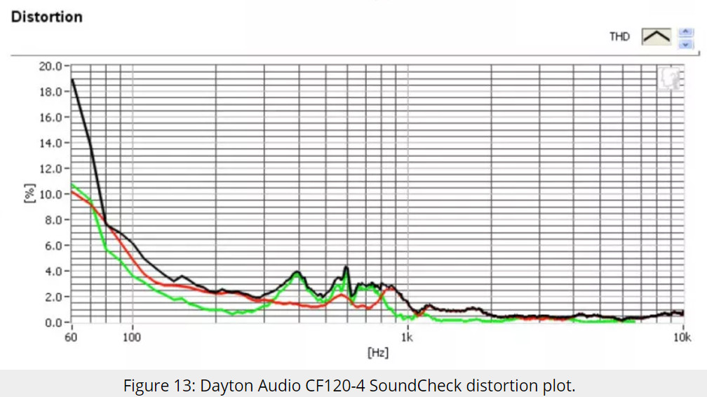

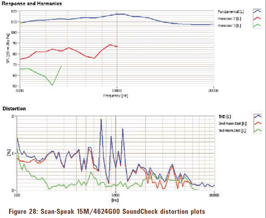

I looked up a couple of (slightly larger) drivers, the 15M I mentioned earlier, and the 4.5" Dayton that Bill Poster just mentioned. These are images from Voice Coil.
The Dayton midbass level was "a 2.83 V/1 m impulse response" (about 86dB) ...and it has ~3% distortion under 1kHz, rising sharply below 200Hz.
The 15M level was "setting the SPL to 94 dB at 1 m (1.16 V) using a pink noise stimulus" ...and it has ~1% distortion under 1kHz, rising sharply below 200Hz.
So: it looks like both units are suitable for a 200Hz crossover, but the 15M looks a jillion times better, with 1/3 the distortion when played 8dB louder.
Am I interpreting these graphs (and signal levels) correctly?
Thanks for posting. I hadnt realised the 3rd harmonic was that high on the cf120. What a shame. Whats causing it?
Insufficient copper in the motor I imagine. They say it's got a copper cap, but that's not going to match full symmetric drive. In fairness, this is not an expensive driver, so a state of the art motor is probably asking a bit much along with everything else if they're to make any profit. That said you can see some resonances in the impedance plot also, so there may be some cone / suspension issues creeping in between 700Hz - 2.2KHz.
Yeah I guess for the price. I have a pair of these and not sure what to use them for nowInsufficient copper in the motor I imagine. They say it's got a copper cap, but that's not going to match full symmetric drive. In fairness, this is not an expensive driver, so a state of the art motor is probably asking a bit much along with everything else if they're to make any profit.

The thing that surprises me is: if you were designing to minimise HD, particularly 3rd and higher order, you'd cross either driver at ~200Hz. This is despite one being a midbass (Fs ~50Hz), and the other a pure mid (Fs ~100Hz).
The usual rule of thumb is Fs times X (where X depends on crossover slope and stuff).
