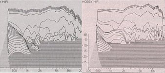

Having that in mind, look at these two measurements. It is practically the same driver but one is bas-midrange, other is dedicated midrange. Measured in the exactly the same conditions sao the results are comparable:
http://audiocomponents.nl/download/scan-speak/15M-4531K00 - Hobby HiFi 2003-2.pdf
http://audiocomponents.nl/download/scan-speak/15W-4531G00 - Hobby HiFi 2003-4.pdf
Look at the waterfall, but look very carefully. See how 15M shuts down much faster through the entire spectrum than 15W. It is more obvious at lower frequencies, but also quite a difference higher in spectrum.
OK: subtle, but real (I mean measurable - not just a Golden Ears fantasy). Thanks for that.

Well, it depends what do you consider subtle. We are splitting the hair in two regarding harmonic distortion - is 0.1% hd3 better than driver that has 0.5% at a certain frequency. Difference between csd in these two drivers would be much more than decimal figure of one percent and (imo) we are much more sensitive in changes/aberations in csd than in harmonic distortion.
Though i admit that resolution that Hobby HiFi magazine uses is good mostly for spotting large ridges of resonance.
