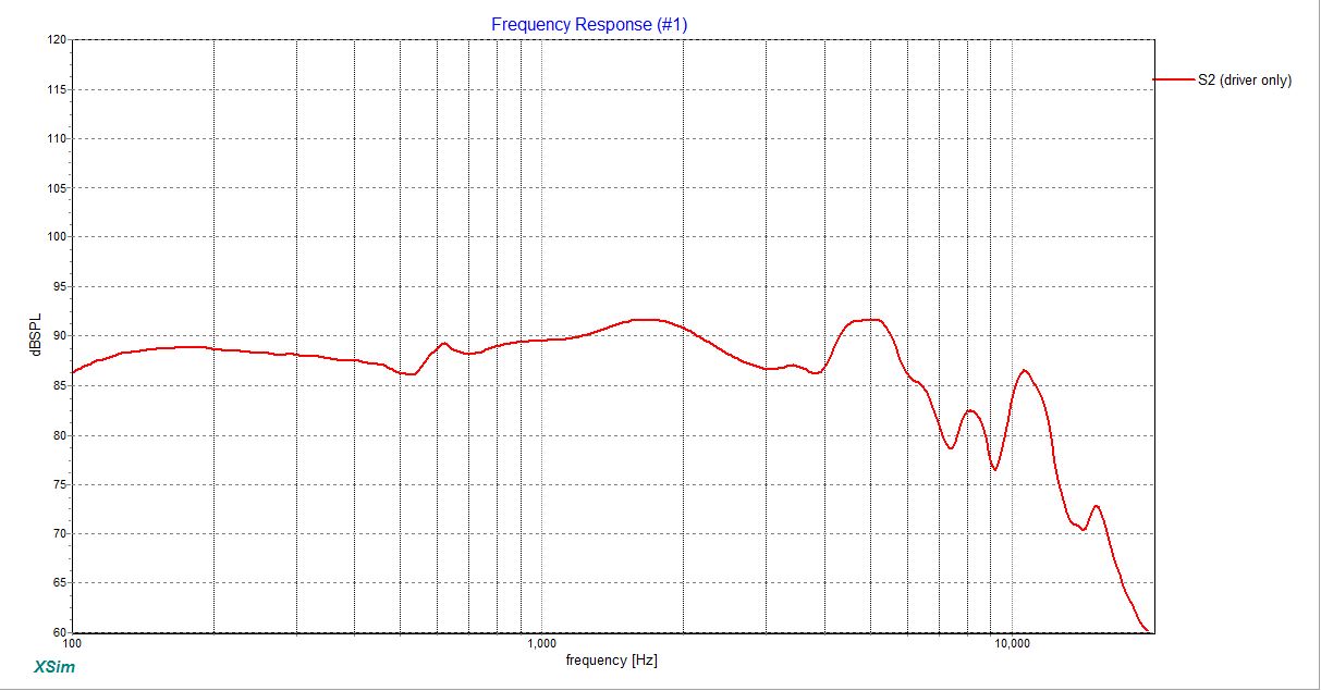

In regards to the Peerless 5 1/4" drivers, I really like the sound, but I feel they need a bit of a low roll-off (2-3kHz) due to the response. All I can do is offer you my own measurement of the 830991 (woven fiberglass) for you to draw your own conclusions from. Would definitely have been nice to be able to cross them a little higher.
This is the 830991 in a Dayton 0.25 ft^3 / 7L cabinet. Port not spliced in, so trust nothing below 100-200 Hz. 🙂

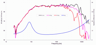

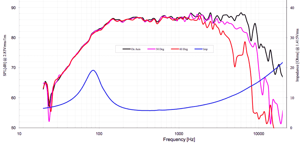

All i can offer for the 830870 is the factory response:
