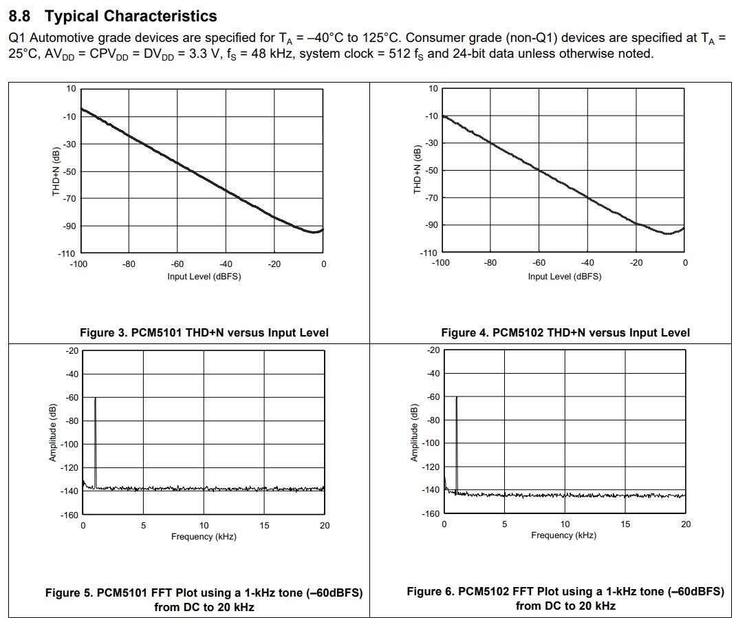

I actually found some more information on PCM5102A in the spec sheet, showing around -50db at -60 db input.
Question is how much the different parts will contribute to the overall performance. I think you add the different parts by taking the square root of the sum of squared parts. (think this is an approximation though)
So say we use PCM1804 as ADC and PCM4104 as DAC we would get (@-60db input):
-49db = 0.3548134
-56db = 0.1584893
Total THD+N = SQR( 0.3548134^2 + 0.1584893^2) = 0.38860 % = -48.2 db
But if we used PCM5102A as ADC with -50 db THD+N we would get
Total THD+N = SQR( 0.3548134^2 + 0.3162278^2) = 0.475281 % =46.5 db
Ok, not as good .... but the beauty about the PCM5102A is that it contains the output buffer and muting circuit, and therefore will require less space, cost and components

ADC: PCM1804
DAC: PCM5102A
DSP: ADAU1452
The use of PCM5102A is simply because I have good experience with it, it has a good muting function and does not require a buffer on the output, saving pcb space and cost.

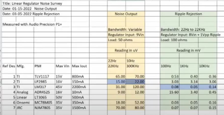

As mentioned, I'm trying to find components readily available at JLCPCB, also in high quantities so they do not run out. But I'm also truing to use what they call Basic component, in stead of Extended parts, as each extended part no will add 3 USD to the design in handling fee. .... that can add up to quite a lot 😉
Trying to decide on regulators and found these 2 small videos where a guy is testing. LTV1117, LP2985, LM317, ADR4525, MC78M05 and NJM7805
Seems the guy really knows what he is doing, so think you can follow his reccomendations.
He found that the overall best performer is the M317 if you only count a noise BW of 20-20kHz!!!
There are probably much better LDOs, but probably also much more expensive.
Looking at this I think I'll just stick to LM317 .... cheap and good 🙂
