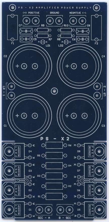

Would you like it in style like this ?
For a class A bias, it's better to use a Cap-Multiplier, where the rectifiers and the powertransistors are mounted under the PCB, in direct contact to the big heatsink. From power dissipation it should be possible to use this Capmu for A/B power amps lessor equal 100W.
A few figures will make the heatsink size clearer.
A First Watt amp, for example, will be biased approx at 1.5A per channel and if using one C-Mx per channel, this means it passes the same 1.5A per device (for each '+' and '-' rail) and for the IRFP devices, they drop about 4.5 v across each device and this generates 4.5 x 1.5 = 6.75 watts of heat to dissipate into a heatsink. [this means an added 13.5 watts dissipation for both channels - 2 x C-Mx for this type of amp]
If you want to restrict that heatsink temp to about a 15*C temp rise (pretty conservative), you simply divide the 15 by the 6.75 that gives here 2.2*C/W (degrees centigrade per watt) and this is how the heatsinks are rated - just look up this in any of the heatsink tables
So for 2 fets for each C-Mx in this example, the single heatsink needs to be rated at 1.1*C/W for the two fets - just look this up on the Mouser/Digikey/etc site for the size/cost.
From use over the years, you can run these IRFP fets to well over the usual 45*C transistor body/heatsink temp on a typical 25*C room temp day
... my 2 cents
