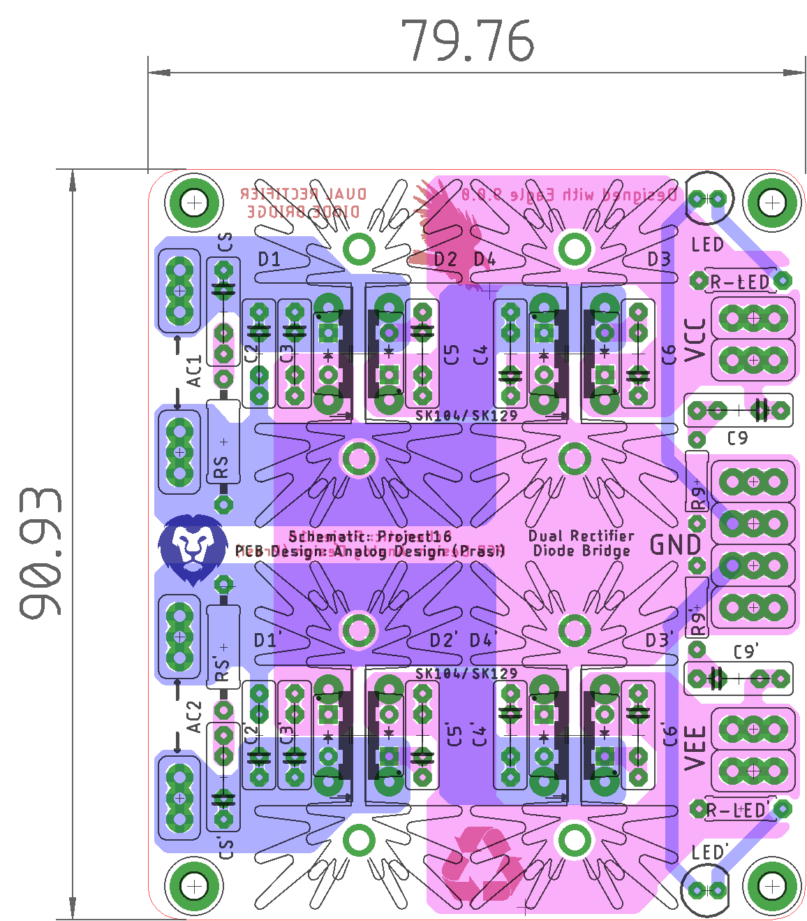

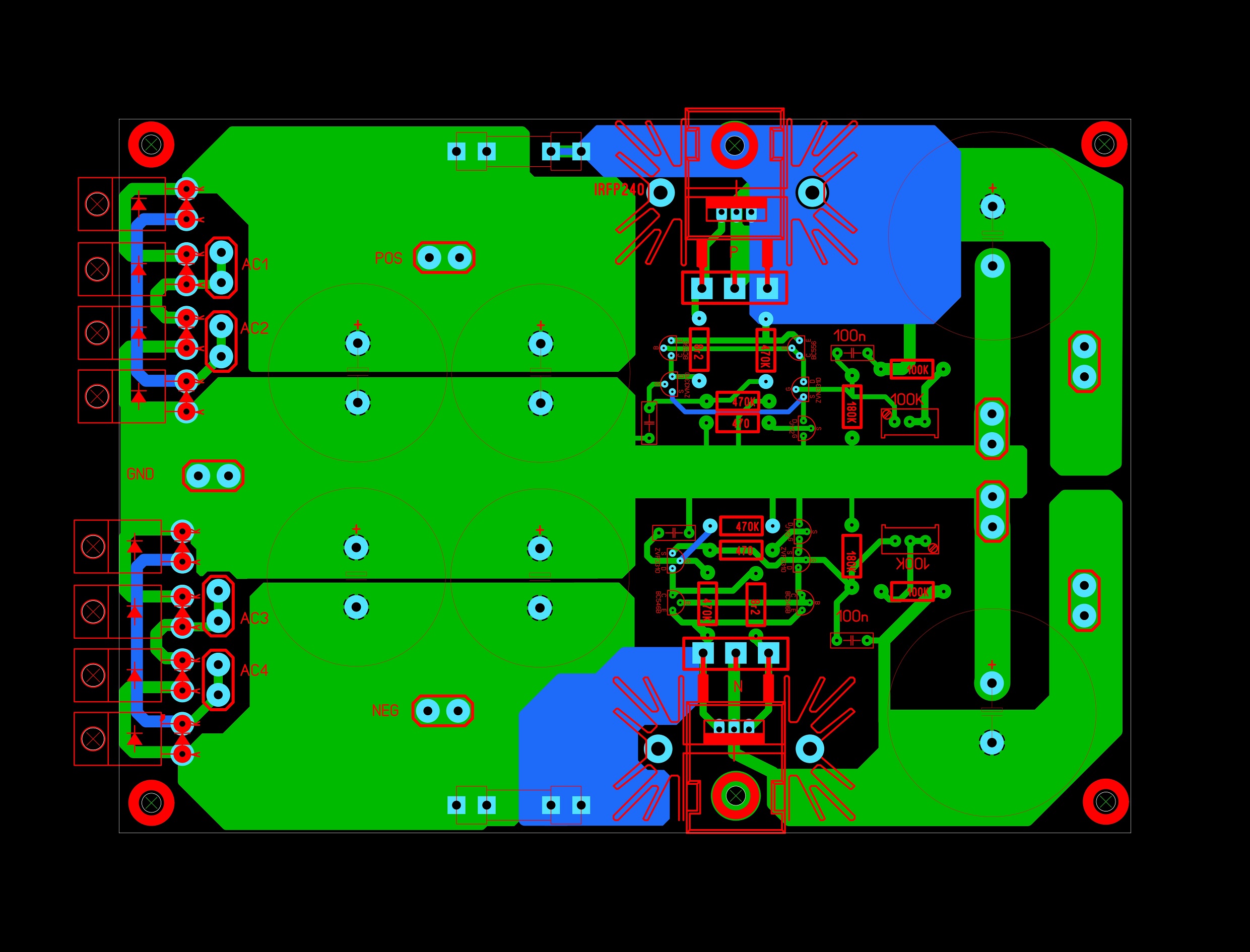

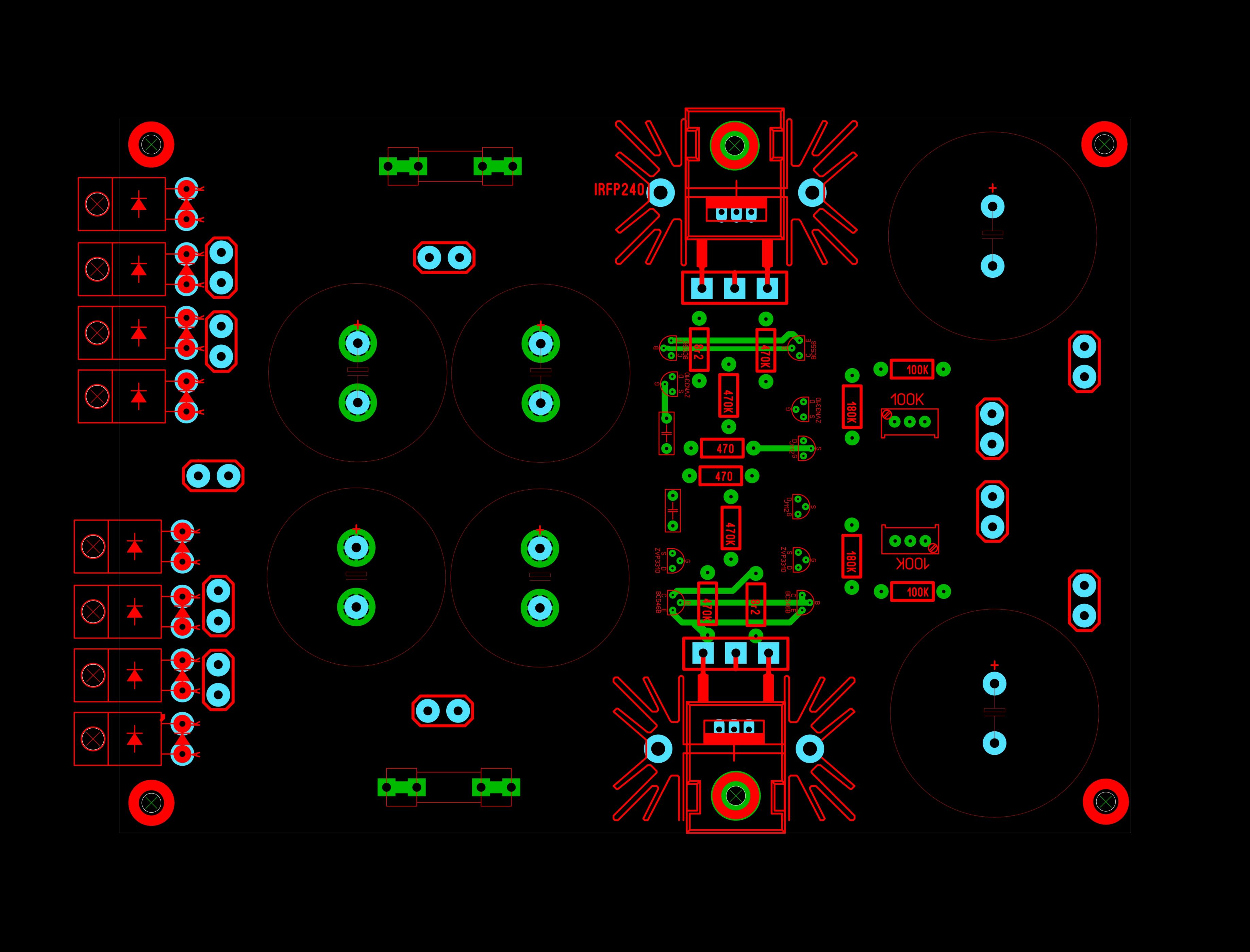

I'm kind of stucked because I did get requests to use bigger heatsinks for the recifier diodes . Some guys want to use this supply for Class A amps .
I could draw a new layout for using bigger powerfets and bigger heatsinks (diodes) or layout the board to use the main heatsink but this gonna get a big board .
What do you think guys of using a seperate recifier board ?
Hi meanman, nice to hear from you finally. The design you show in post #57 is OK with me, but you could maybe slightly increase the PCB size to allow for the bigger deeper TO220 heatsink sizes - don't forget they make these up to around 63mm high or so.
Also to make it more universal, you could then extend the tracks around the +/- pass transistors towards the edge of the PCB to alternatively mount these off the board on the main amp heatsinks with legs bent up to solder to the PCB, this would then allow these devices to be directly mounted on the PCB with a choice of TO220 heatsink size or off the board on the external amp heatsink for larger currents as required by Class A amps. I think adequately sized TO-220 heatsinks for the rectifiers would be OK for all solutions. Hope that makes sense for you.

If you keep the diodes close to the smoothing caps and the common connection between the caps wide track, this'll reduce the 'noise' of the diode switching to a minimum and localize the charging current spikes
You might consider adding some extra donuts for the low dropout SMD diode rectifier pcbs and/or the 'new' active rectifier bridges that don't actually need any heatsinks at all.
The design from Prasi is very flexible as it gives the builder the choice of either TO220 or TO147 sized diodes as well as the 2 different heat sink widths to accommodate what ever currents are being catered for. One then can choose the relevant height of heat sink to allow for anticipated device power dissipation.

If you use the main heatsink for the TO220 diodes will these be big enough for a Class A amp ?
I also planning the use the rectifier board of Prasi as option .

Hi meanman and thanks for putting the effort into this design and GB - appreciated.
If I may say so, I think you're in danger of chasing a universal design, which I think is never going to be achievable - someone will always want some little extra. I suggest you settle on a design that achieves a set of parameters, such as its current capability, heatsinking configuration, etc. that meet your requirements and then go with it. People can then choose to work within those parameters or do something else.
Just my penn'orth.
Just my penn'orth.
I know , have to draw a line somewhere or I never can finish .
So, barring the need to correct any actual errors that might slip in, I suggest that the next iteration of your board is the one to go with for the group buy. I am, of course, assuming it will meet your own personal needs.
