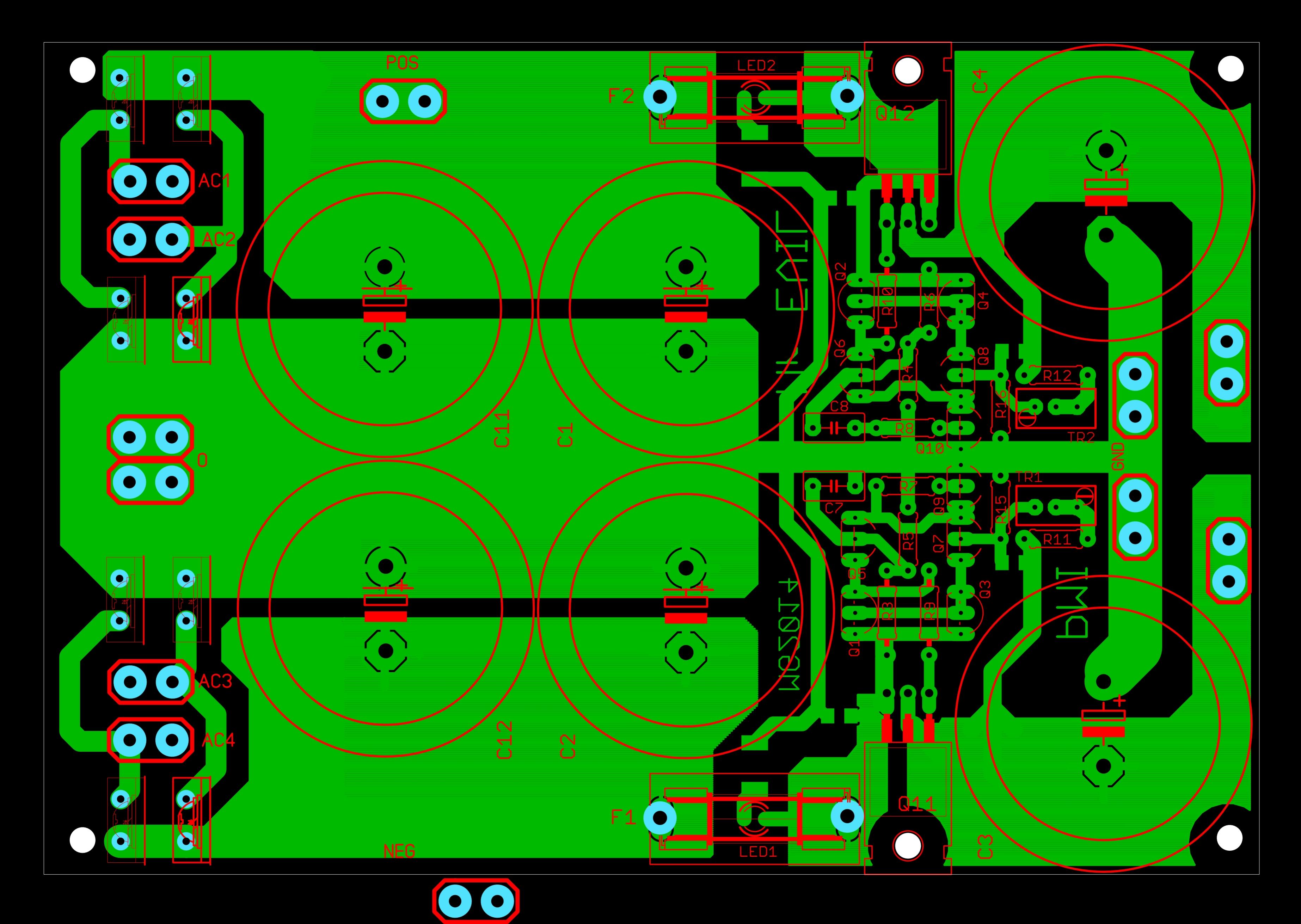

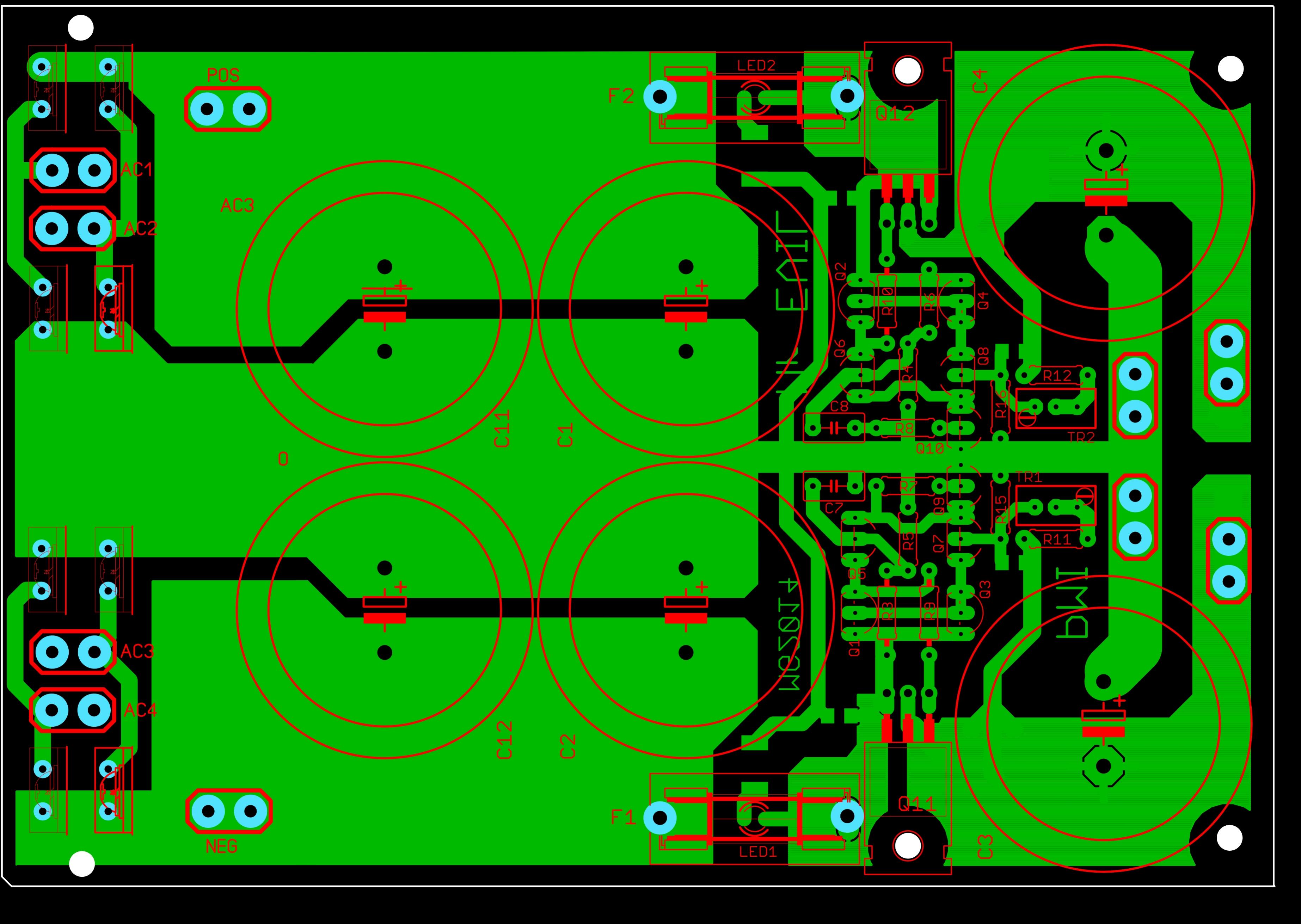

Just to say I really appreciate you going to the trouble of doing this for us. Is it possible to make the mounting holes line up, as per your previous version. Many thanks.
Stephen.
Stephen.
Hi Meanman, this is a really nice board, but I expect that the diodes may need heatsinking in some use cases. Is it possible to rearrange them?

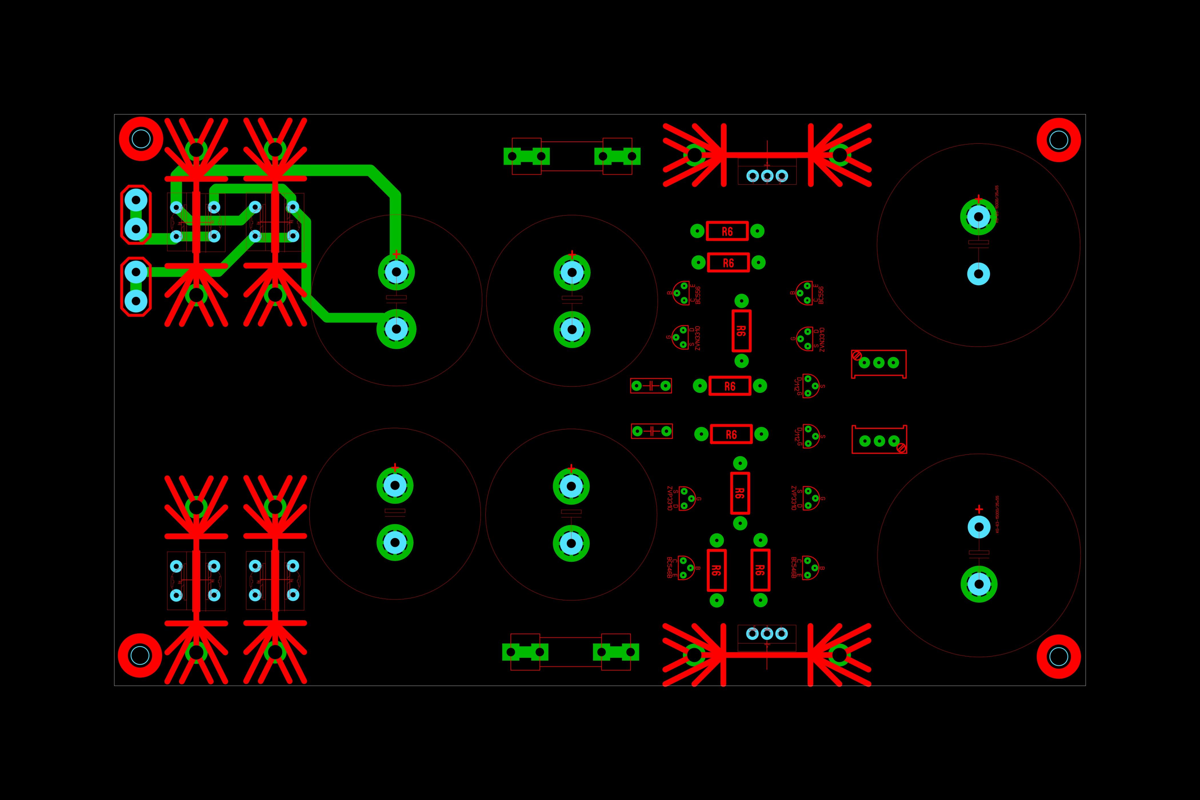

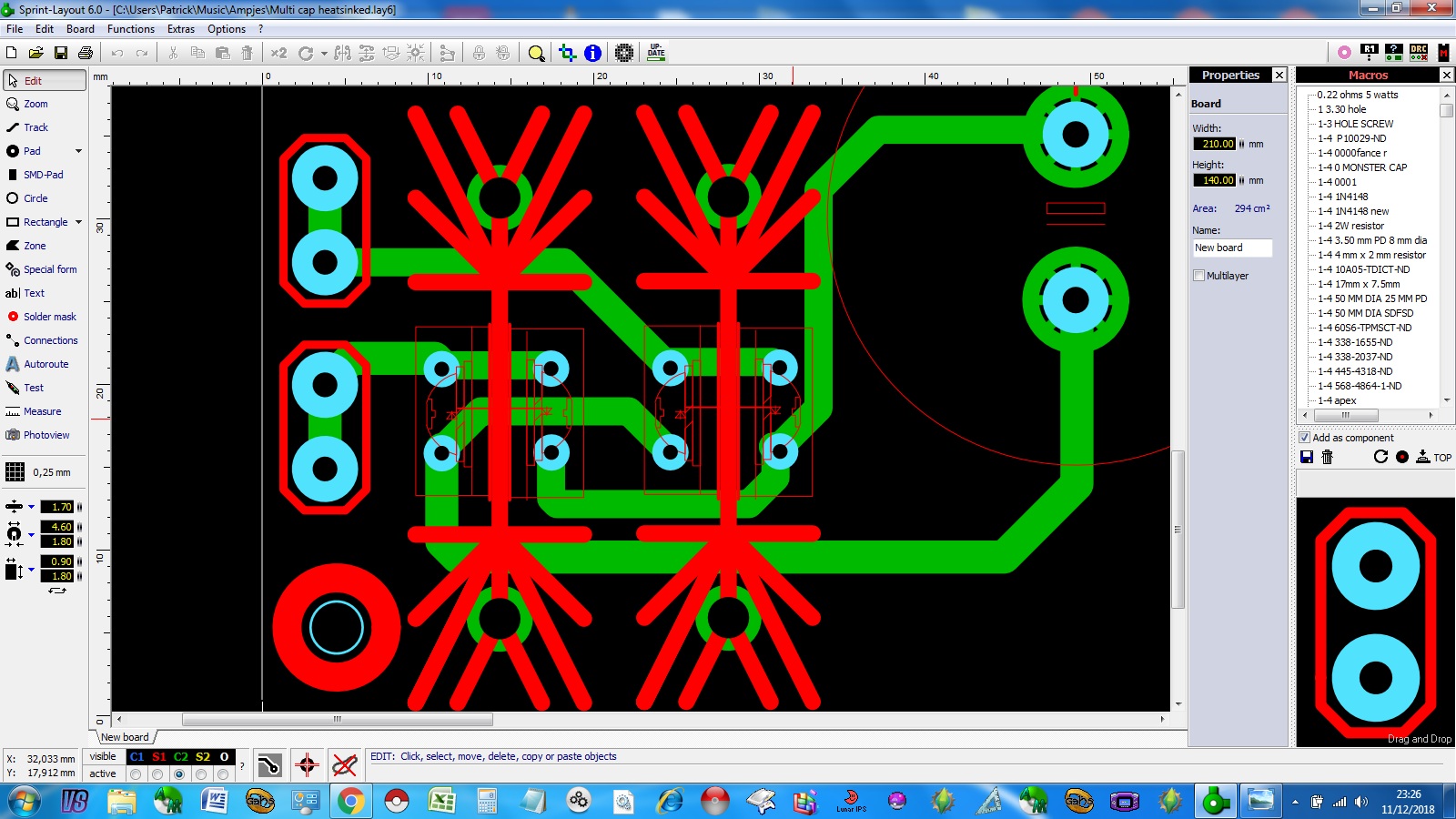

Like this ?
Not shure , are the connections right?

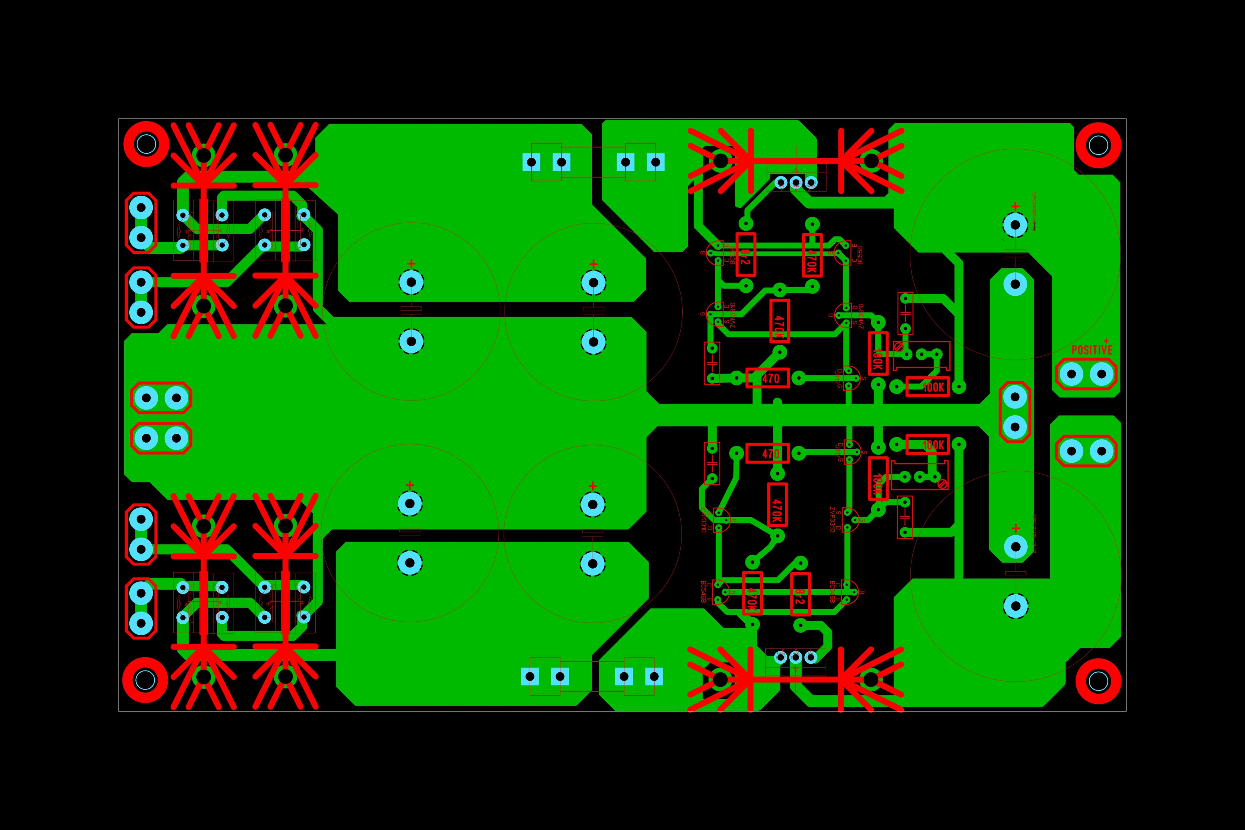

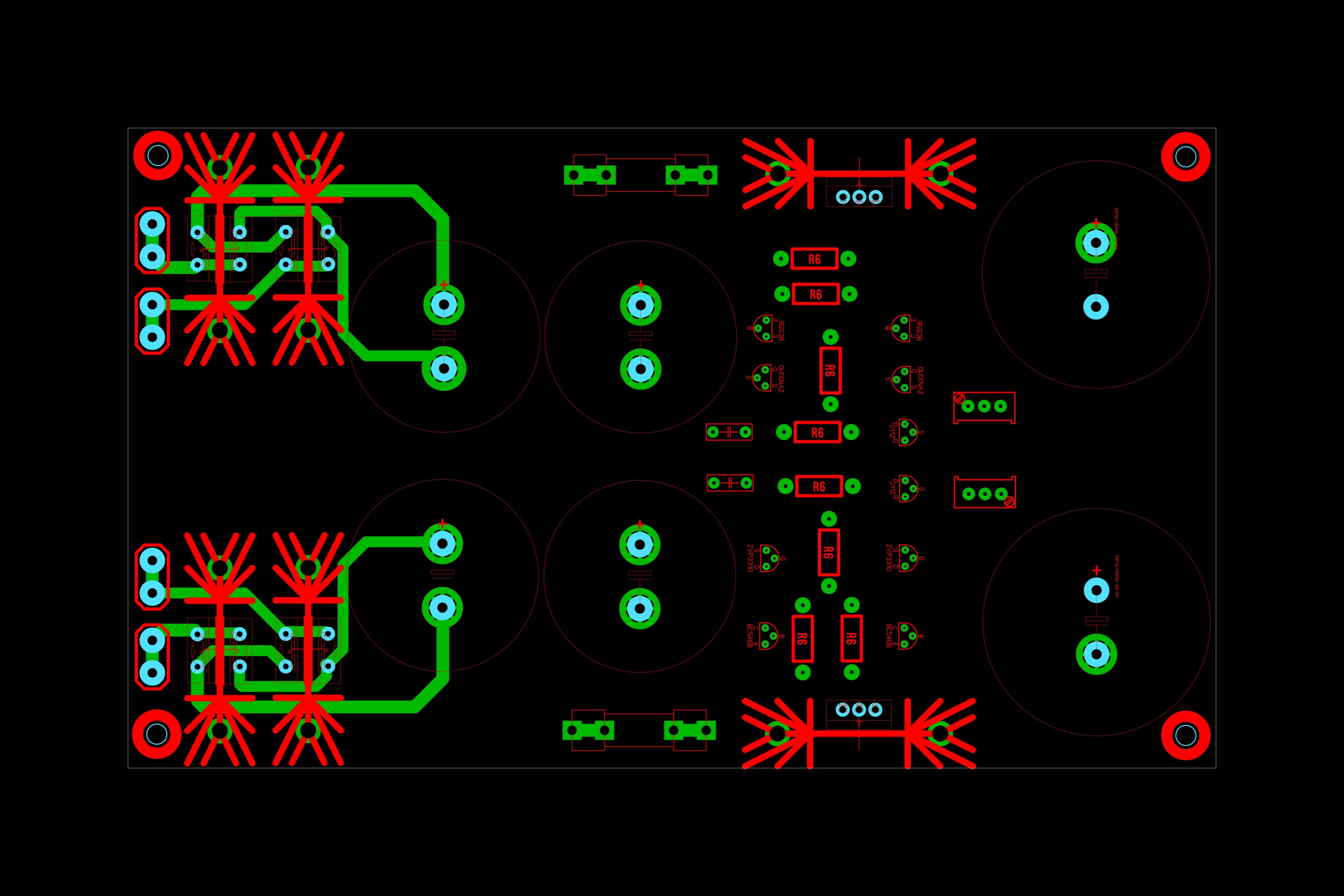

the track work looks right to me. I think the Vf is something like a volt for the MUR1620, so with a class A amp running 3A for example, its going to be 6 Watts per heatsink, or will it be half as they are conducting half cycle each? Either way, I think you would need much bigger sinks.
