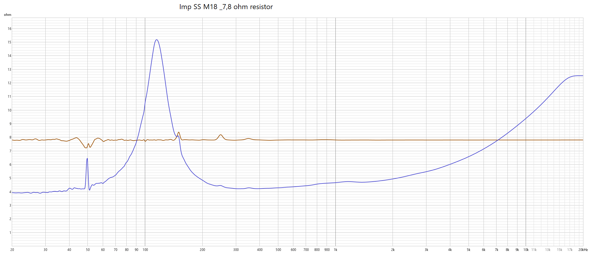

Here comes new impedance measurement markbakk.Could you please post the driver impedance curves (in situ of course…)? The midrange response looks a bit weird to me.
I having a hard time to set all the "right" settings in REW (because i never remember them)

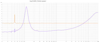

Have disturbances in the measuring circuit, but you have to "remove them" in your head when you look at the curve. ( it wasen´t any last year?)
Also get small differances ! ( as you can se in the plot) and peak is 115 hz.
Reference impedance line is a 7,8 ohm resistor.
if brown trace is 1cm
I interpreted it this way: the lower the curve, the bigger the measurement distance… a bit of clarification would be welcome.
Brown trace is 10 cm and then 8, 6, 4, 2 and ending at the top (97-99dB) with 1 cm Blue trace 👍
best regards John

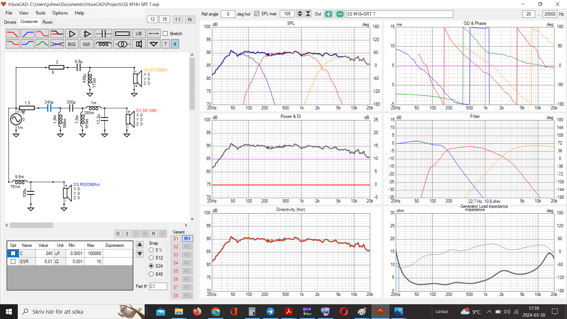

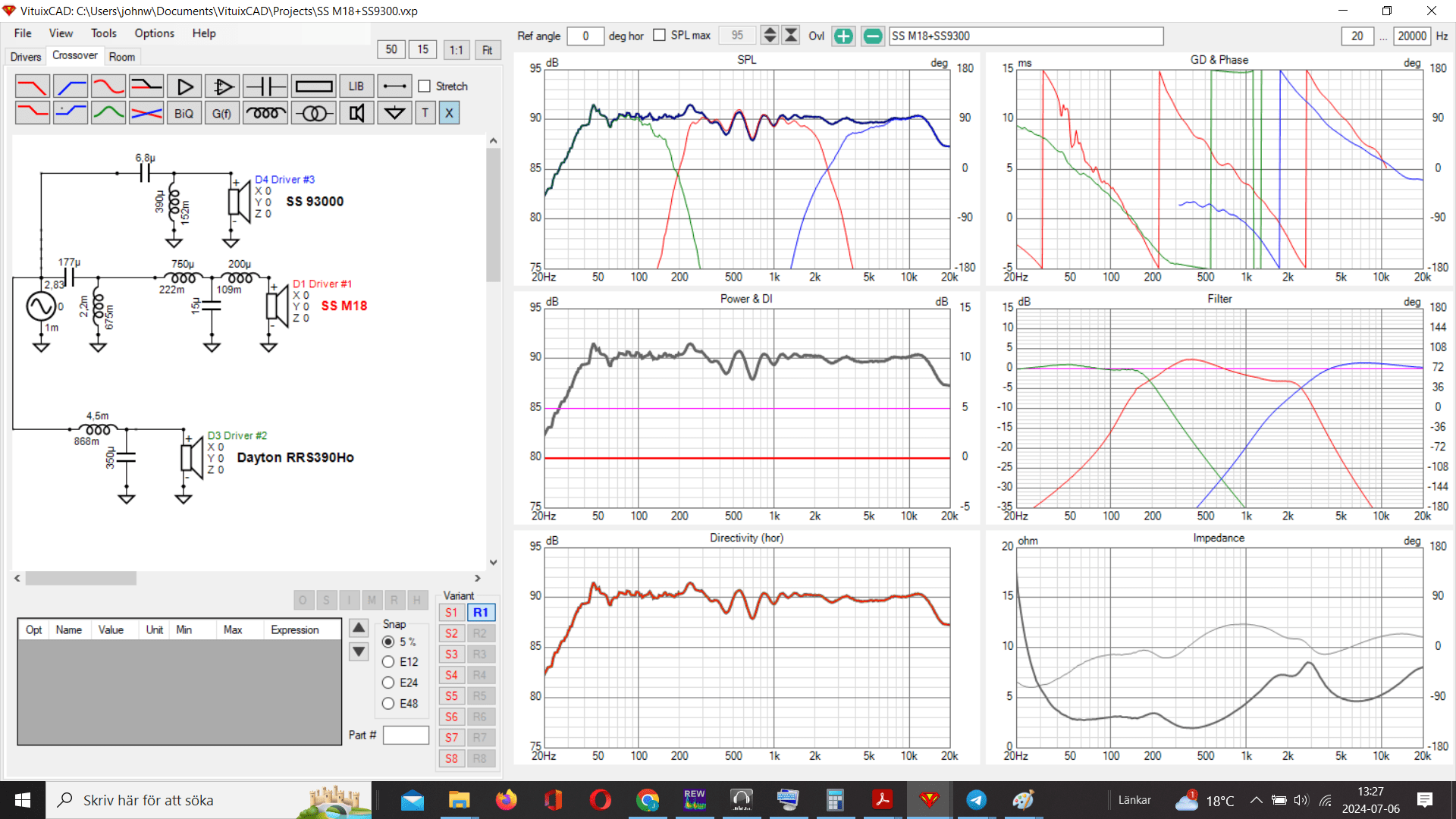

Ok thx. All in all, I think your crossover needs attention. The bass and mid section overlap too much. You can see that some cancellation is going on between 300 and 500Hz. The mid to high crossover could be finetuned, as a (modest) peak at around 3k generally has to be avoided.
Furthermore, although some of the measurements of the mid have some resemblance, others divert and show more or less the same issue. I can’t explain the differences. But the BSC in the mid crossover possibly isn’t adequate.
In your Vituixcad info the power and directivity does show that there is some excess energy in the 3Khz region, so that is definitely something you could go over and verify that the transition to the tweeter is maybe better than that old ? data set.
In terms of getting higher than 1 metre to avoid room bounce as they are separate enclosures it should be relatively simple to use a piece of household furniture or some old loudspeaker stands and some books to get them high enough to get a decent 1m or 2 metre reading on axis and maybe some 30 or 45 degree of axis so that you can see that they drop of smoothly. However, if you like the sound maybe leave well alone until you are feeling better.
Interestingly the Xover for all three units is positive phase, and looking at the derived phase they are not closely aligned. To satisfy this question what does the phase look like if you flip the midrange phase does the phase measurements for the bass-mid or mid tweeter become better aligned ?
If so, a bit of subtle tuning of a component in either high pass or low pass may be beneficial, keeping in mind you should be aiming for a smooth gradual taper downwards at the the high frequencies.
However as you listen maybe a bit further away you may not want to much attenuation. If the traces don't happen to look more aligned within one or two mouse clicks, i would be tempted to leave it alone and restore your original values and midrange phase and just work around the mid tweeter transition.

Yes you are right, but it´s a harder "true" thing in reallety, Vituaxcad don´t show the "xover-struggle" i had with the 130-400 hz area.The bass and mid section overlap too much
And the 300-500 cancellation don´t show up in the measuremts.
Yes, that was my gole when i started this thread 👍The mid to high crossover could be finetuned
But i can´t se it in most measuremts over 2 meters strange enough?
?. means what?

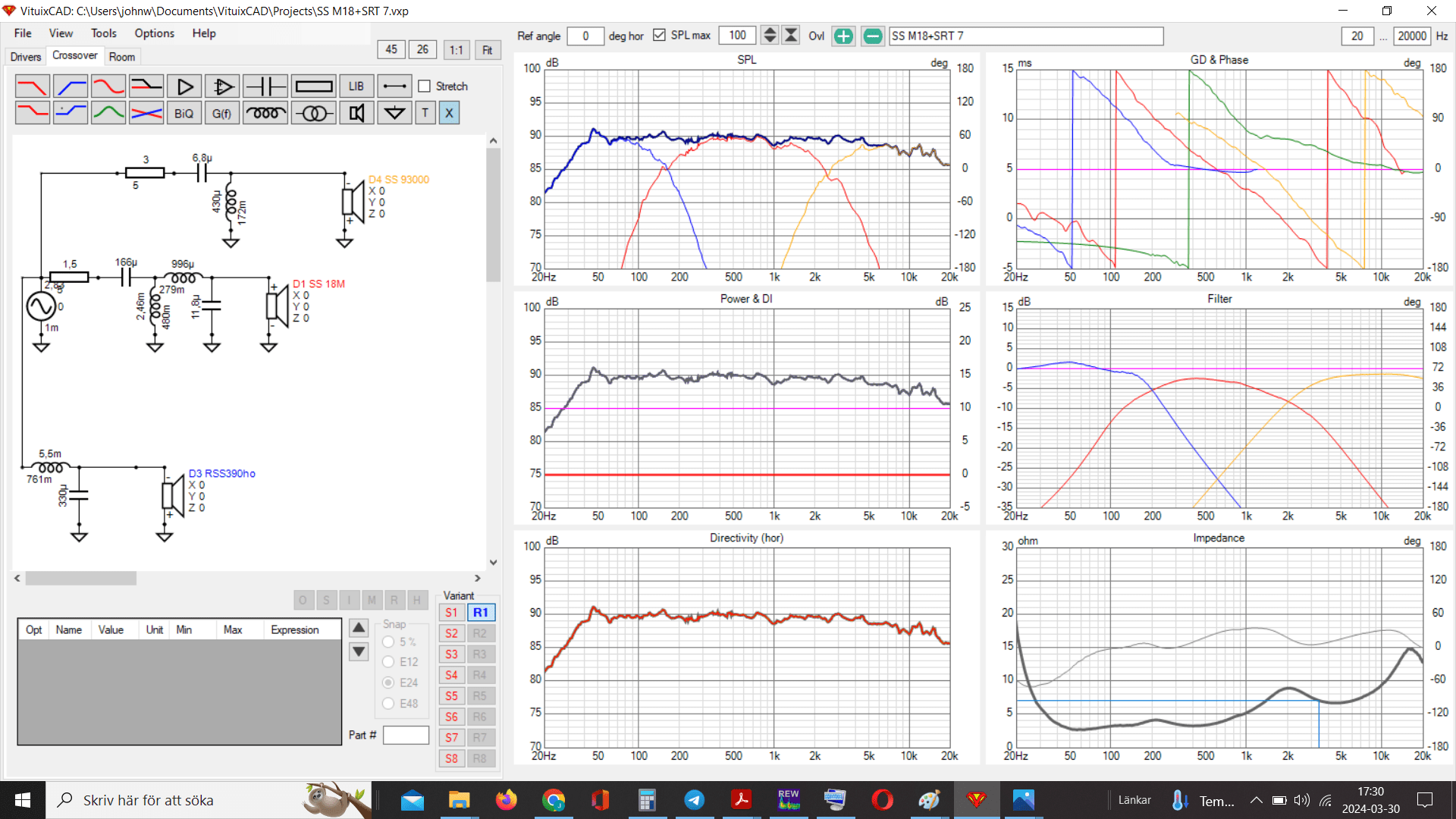

And i have try a little different xover solutions, and some is better with small margins (but with expensive components, like a 7,5 mH coil)
Here is one other xover solution, but more expensive.
And unother LR2 with litte lower impedance.
regards John
Yes Ray it can be better "above all in Vituaxcad" with more component, but not so much in reallyty. (difficult to balance more cash or not)verify that the transition to the tweeter is maybe better than that old
Absolutly Ray!higher than 1 metre to avoid room bounce as they are separate enclosures it should be relatively simple
Thats on my list!
I have aslo wonder about that!Interestingly the Xover for all three units is positive phase, and looking at the derived phase they are not closely aligned. To satisfy this question what does the phase look like if you flip the midrange phase does the phase measurements for the bass-mid or mid tweeter become better aligned ?
I think it´s so strange....
And tryed before to shift phase on the woofer, but no improvements at woofer-midrange meeting, but must test again! (also midrange)
👍 thanks for idea´s Ray 🙂If so, a bit of subtle tuning of a component in either high pass or low pass may be beneficial,
Best regards John

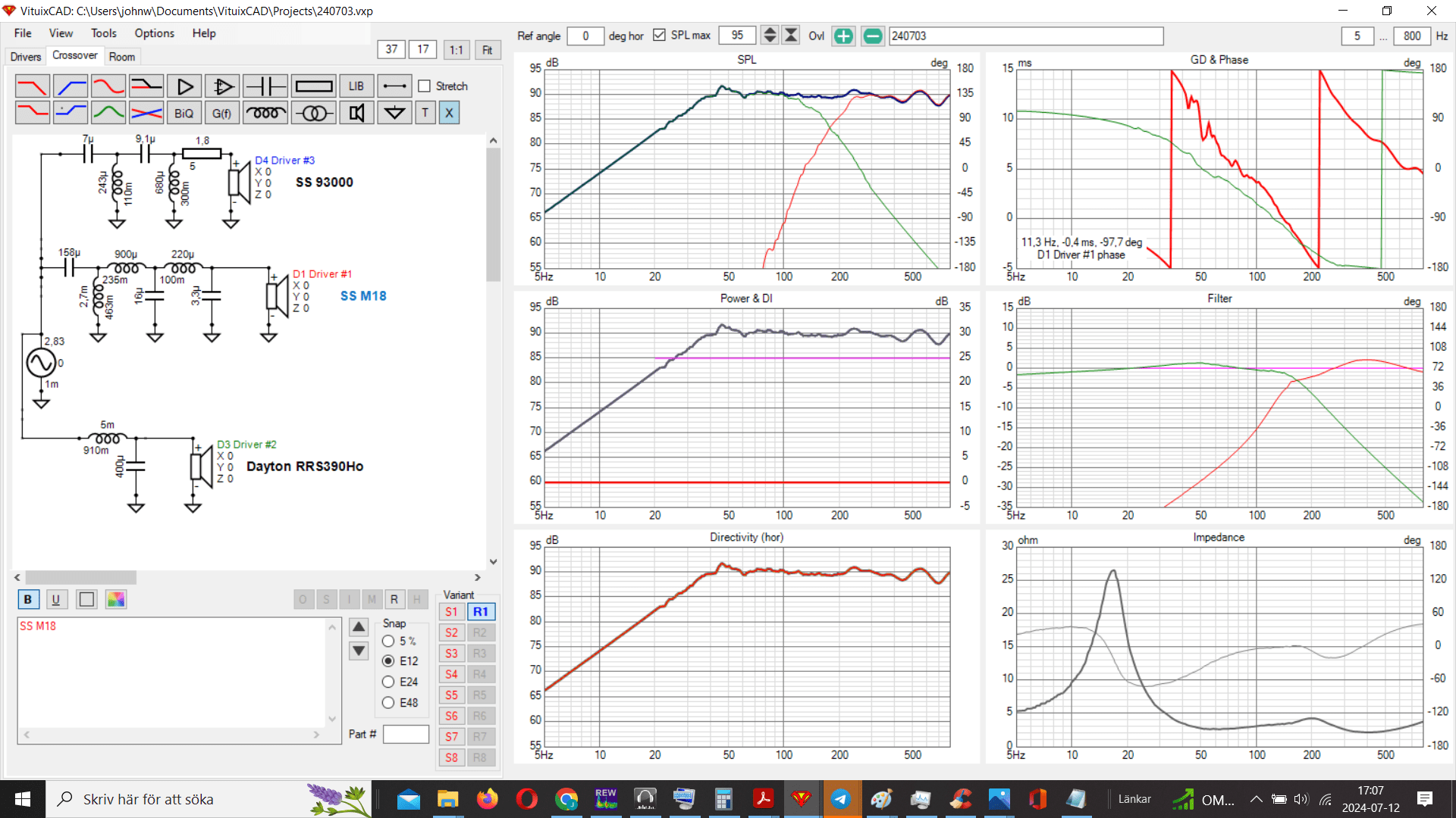

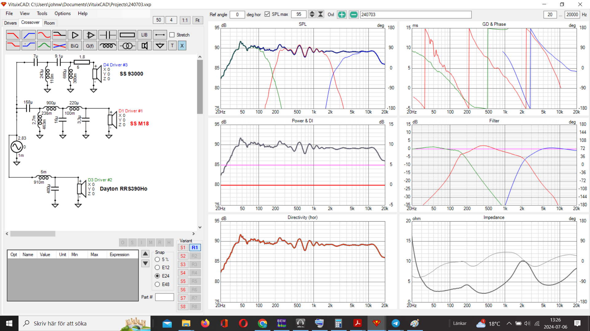

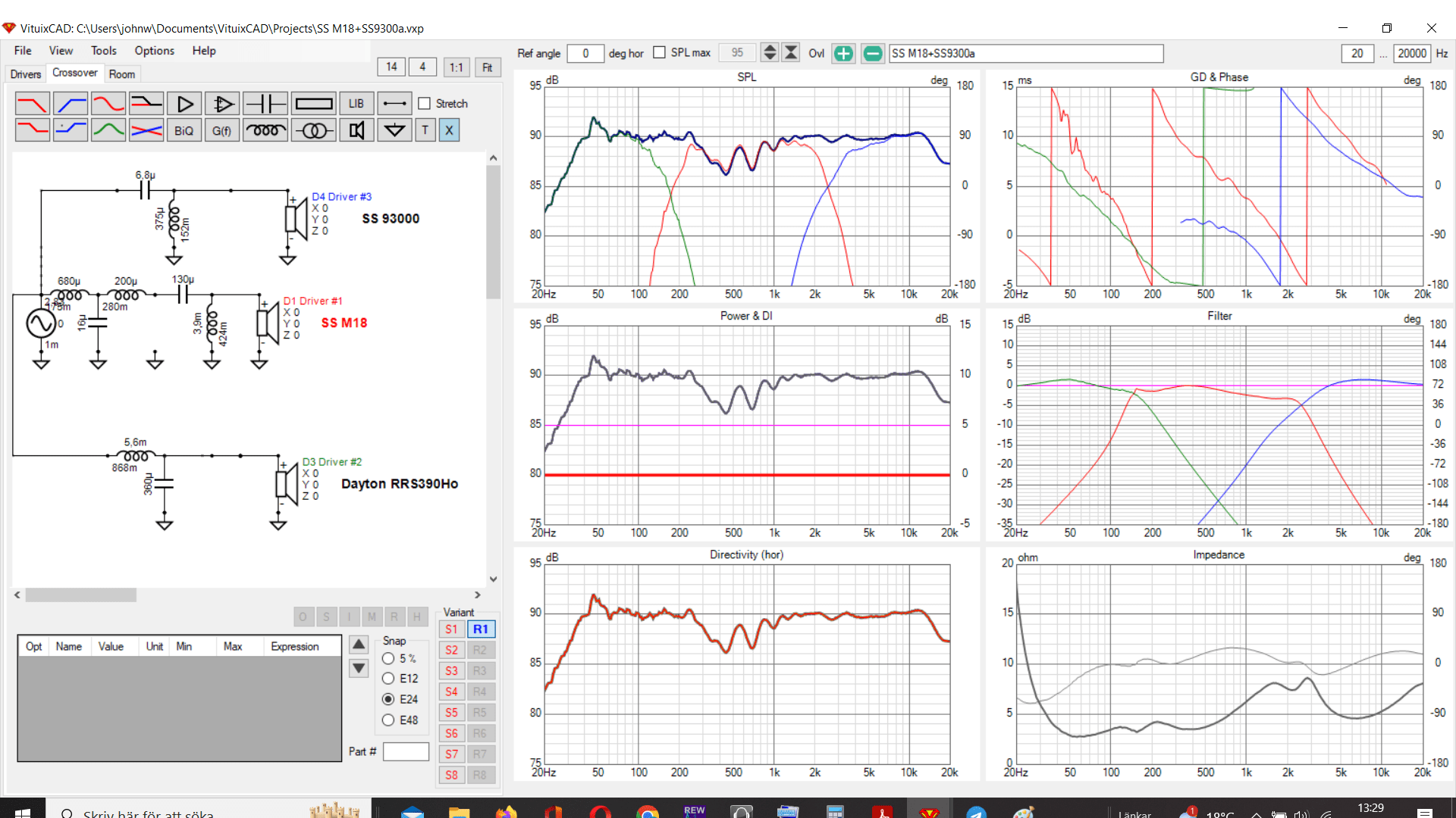

Possibly in terms of knowing you like to listen at higher volumes the first option rolls of the tweeter the fastest which should stop it from being stressed. The on axis response looks good to me and the off axis levels hopefully decline smoothly and maybe the 500Hz wiggle isn't there at 30 or 45 degrees of axis.
The 500 Hz dip aligns with the woofer phase change shown in green, maybe scroll down in level in the first window when you are in VituixCad and see how the woofer response dies away below 75dB. If there is a bump or step that down at 70dB that may explain the wiggle ?
Impedance and phase do look OK, although below 50 Hz it will take current. At 50Hz the overall impedance is around 3ohm at -45 degree phase. Fortunately a lot of recorded music tends to be tailing off in this frequency area , although there are exceptions, and I guess we all have a few examples in our music collection. At 400Hz the impedance is also 3ohms approx. but almost zero phase which will be fine for lots of amps.
The second crossover maybe a little better from a impedance viewpoint, and it has a flatter response than 1, although the flatter response means very little in the scheme of things.
Interestingly which one did you prefer sound wise? Is one nicer to listen too at low or high level. which one ticks the most boxes for you?
The third one highlights how much care is needed with building a three way with individual boxes for each driver, judicious placement in the differing X, Y and Z planes maybe would smooth out the dip to the point that it would be not noticeable to many people, and would only show up in the measured response.
As a caveat I have never designed or made a three way and if we could instantly pop over to your listening space we would probably still be discussing what we actually hear for many hours.
Happy listening.
Happy listening.
Both first two crossovers have an ugly dip down to 2Ω in the low midrange. I wouldn’t do that, much music energy is in that frequency region.

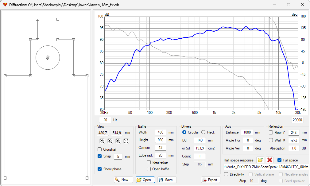

I simulated your project in VituixCad2 guessing the sizes and coordinates of the drivers on baffle from the images you posted.
Find attached a folder with the main project, the baffle step/diffraction and merging projects. The woofer Vb is 66L tuned at 25Hz while the mid is a closed box of 4L. I used traced curves to simulate the x-over.
Hope this helps
Regards
Saverio
Hope this helps
Regards
Saverio
Yes i maby must think on that with my listeninglevels Ray, did¨t before you drew attention to it.in terms of knowing you like to listen at higher volumes the first option rolls of the tweeter the fastest which should stop it from being stressed.
Think the 400 hz wiggle is an artifact because further away it does not exist, and a little toe-in I usually does.
Mean this ? (see pic)The 500 Hz dip aligns with the woofer phase change shown in green, maybe scroll down in level in the first window when you are in VituixCad and see how the woofer response dies away below 75dB. If there is a bump or step that down at 70dB that may explain the wiggle ?
Used manufactor specs imp and SPL on the Dayton 390ho, so not measured from me!
Will also try to get a little better impedance at the lowest "areas", but hard when working with 4 ohm woofer and 4 ohm midbass/midrange and 6 ohm tweeter.
My xover-parts ( especially caps ) are entirely finish from 36 uf and down, so i haven´t had the possibillity to listen on more then 1 or 2 xover¨s.Interestingly which one did you prefer sound wise?
And after 2-300 soldering on/off the components arent exactly "nice" to work with hahaha.
Your are completely right Ray, every movement of the mid and tweeter-boxes make slightly different measurements.The third one highlights how much care is needed with building a three way with individual boxes for each driver, judicious placement in the differing X, Y and Z planes maybe would smooth out the dip to the point that it would be not noticeable to many people, and would only show up in the measured response
And I can use that if I want in a possetive way, but my original design was ment to be "thin" like in woofer playing sideways with the side facing the listener, and mid/twe on topp.

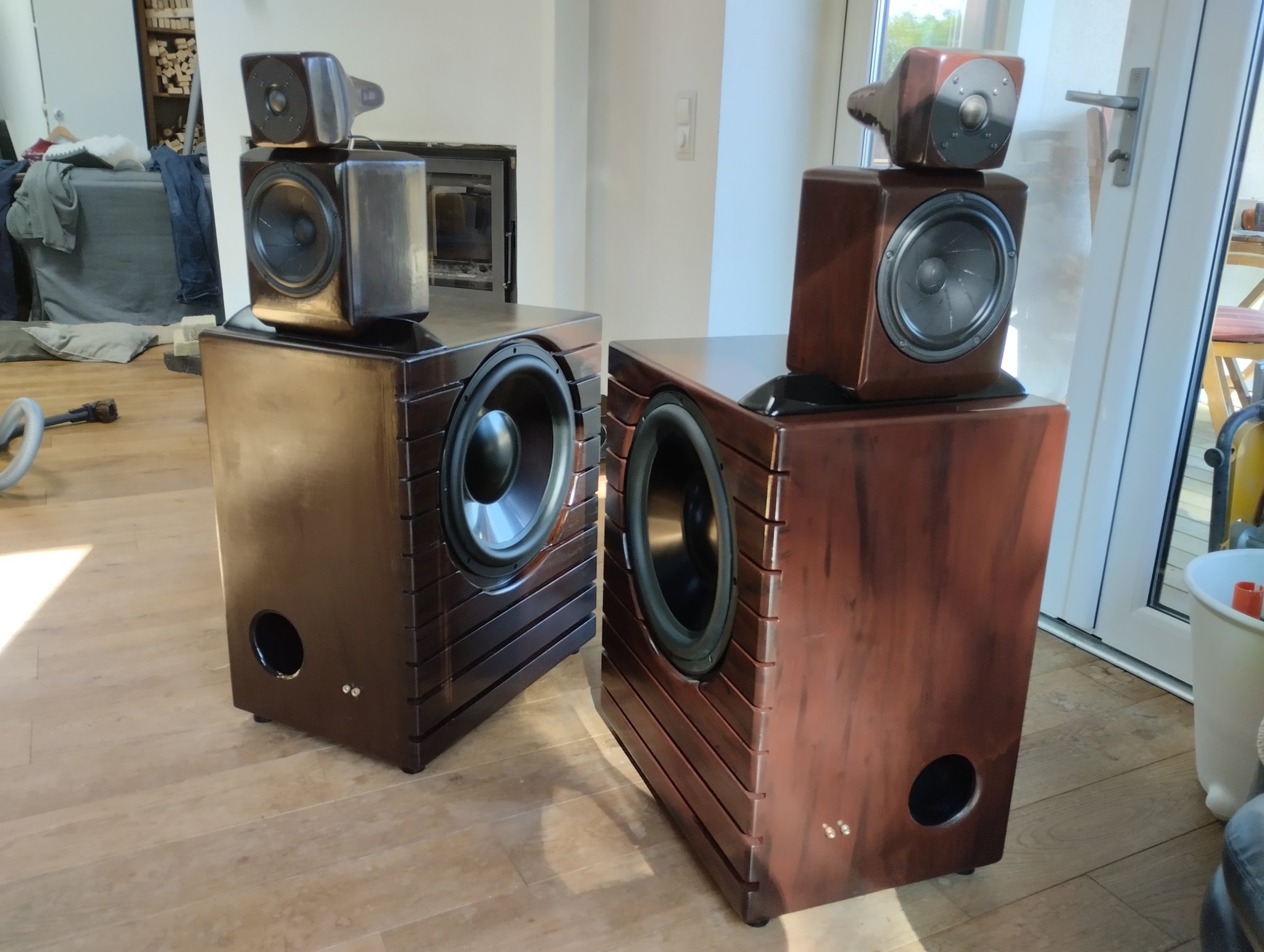

Like the pic but woofer-port backwards.

Yes but its real hard to get real "good" impedance with these 4 ohm woofer and 4 ohm midbass/midrange and 6 ohm tweeter.Both first two crossovers have an ugly dip down to 2Ω in the low midrange. I wouldn’t do that, much music energy is in that frequency region.
I will try to reach 3 ohm and accept one 2,7-2,8 ohm dipp.
And even if I have 2 ohm stabile amp, I want to "make the best of it", so even receiver can be used.
Do you have any suggestions for me ?
And you can have my FRD and ZMA files if you have ti,e to simulate a little.
Regards john

My original design was ment to be "thin" like in woofer playing sideways with the side facing the listener, and mid/twe on topp.sizes and coordinates of the drivers on baffle from the images you posted
But no doors are closed regarding woffer playing sideway´s or forward.
Woofer have 113 liters box ( before port/driver and 2 reinforcements )
So around 100 liter netto.
I downloaded you´r folder, but don´t know how to use it.attached a folder with the main project, the baffle step/diffraction and merging projects.
Best regards john
Hi Jawen,
With the file that Shadowplay62 kindly produced for you. Using windows explorer move the file or copy it into the VituixCad folder. Then you should be able to open VituixCad , select open file and select the jawen.vxd file or the only .vxd file in that folder, and open that, the information should load from there.
Have fun.
Have fun.
