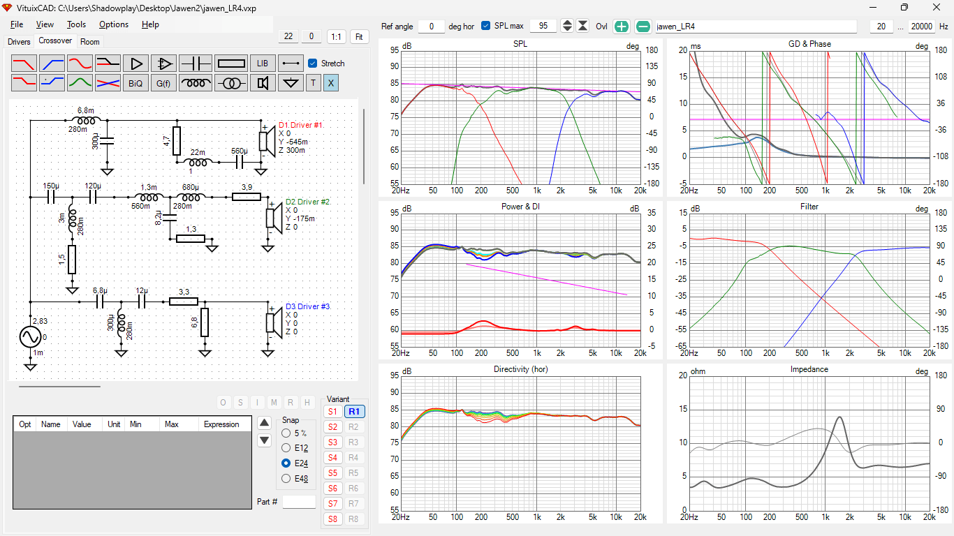

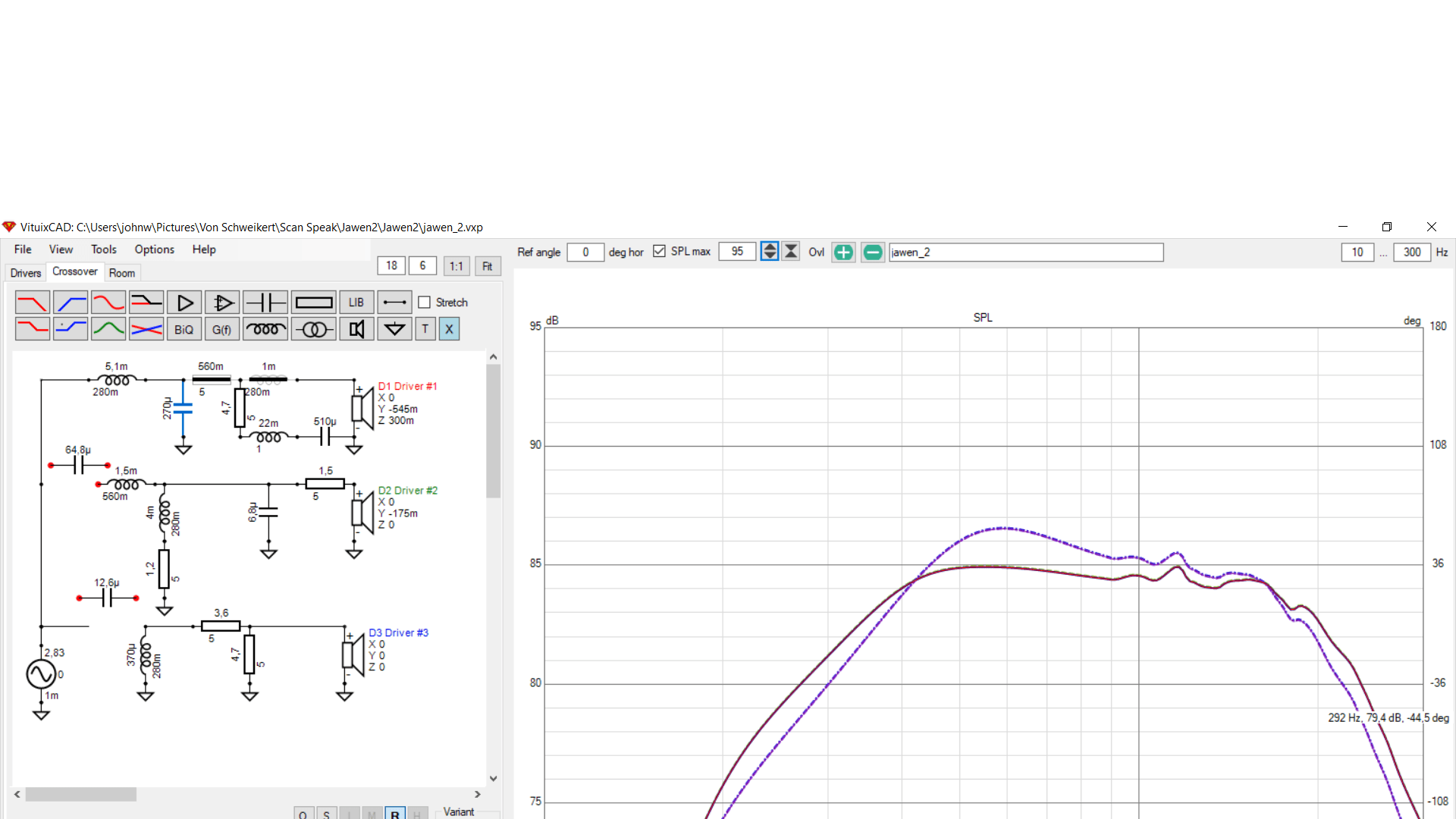

4-800 Hz wiggle i my 3 way diy
Hi John
  • The difference you see in the circled area is caused by the side-firing woofer: if you set both the 90° rotation and the 300mm distance of the woofer to zero in the main program table I attached (meaning that the wf is on the frontal baffle) that problem will disappear. Of course the filter should be adjusted.
  • I know that big coils are expensive but the LCR notches are almost mandatory when your x-over frequency is very low (<300Hz) in passive filters. Removing the notch will also incresase the F3 frequency of your wf to about 40Hz. Consider that the coil can have a bigger DC resistance as it is not in series with the wf (they are cheaper). Just subtract the higher resistance form the 4,7 Omhm resistor. Another problem is that if you remove the LCR you have to increase your x-over frequency to about 300Hz and that may be a problem with the side-firing woofer.
  • A 150-180Hz is very low considering that the midrange resonant frequency in closed box is about 120Hz.
  • Thank You
Reactions: jawen
Thanks! (have someone buy anything from that site...RumoH ?..they doesn't even have an article number on the product.
So can use a 0,5 mm wire 22 mH coil?
Both DCR of 3,6 ohm and "max power" is okey just because it´s not in serie?
The 22mH is also available in the 1mm/1 Ohm dcr version at 25€.

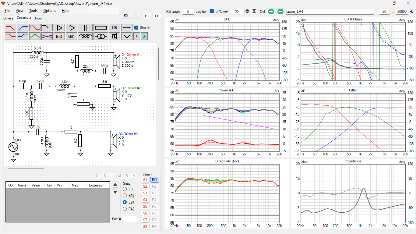

Also played a bit with higher order slope filters (I don't like them, but that's me) to achieve a 200-2200 x-over frequencies and here it is:
ciao
S.
Thank you for explaining.
So if i understand it right about the LCR filter, it "creates" a F3 at 32 hz in this case?
-5 dB at 27 hz and -9 dB at 20 hz ( without room)
And without (as my modified filters shows) an F3 at about 38 hz?
-5 dB at 33 hz and - 12 dB at 20 hz? (without room)
So in total 1 dB extra at 20 and 30 hz.
1 dB less at 50, 60, 70, 80 hz ?
Best regards John

Had to come back on that. People tend to forget the power limits of crossover coils almost never are the weakest link in passive crossovers (unless one designes in a dumb way). Conventional electrodynamic drivers have far worse distortion problems at the same powers.
The DC resistance in these circuits can simply be accounted for by changing the R value in the LCR accordingly.

LCR notches are not that strange, TG and many others uses them a lot in their x-over. Besides, there's also a technical reason, if the x-over frequency is not that low (400-700Hz) it's possible to avoid them.
Regarding 100.000 € speakers, that's just product placement as there is no effective reason that a speaker costs that much, especially considering that the cost of 1000 pieces is about ten times lower the amount you pay buying a couple of drivers.

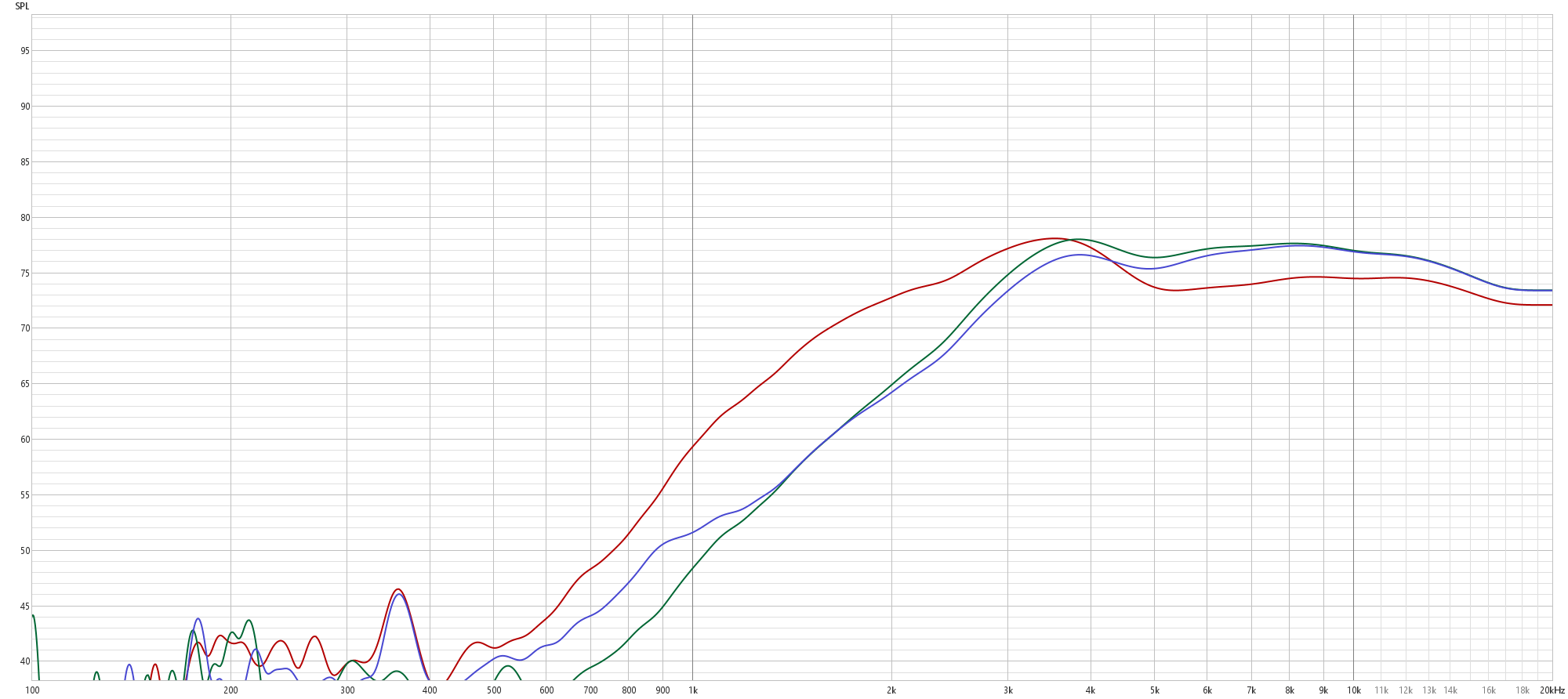

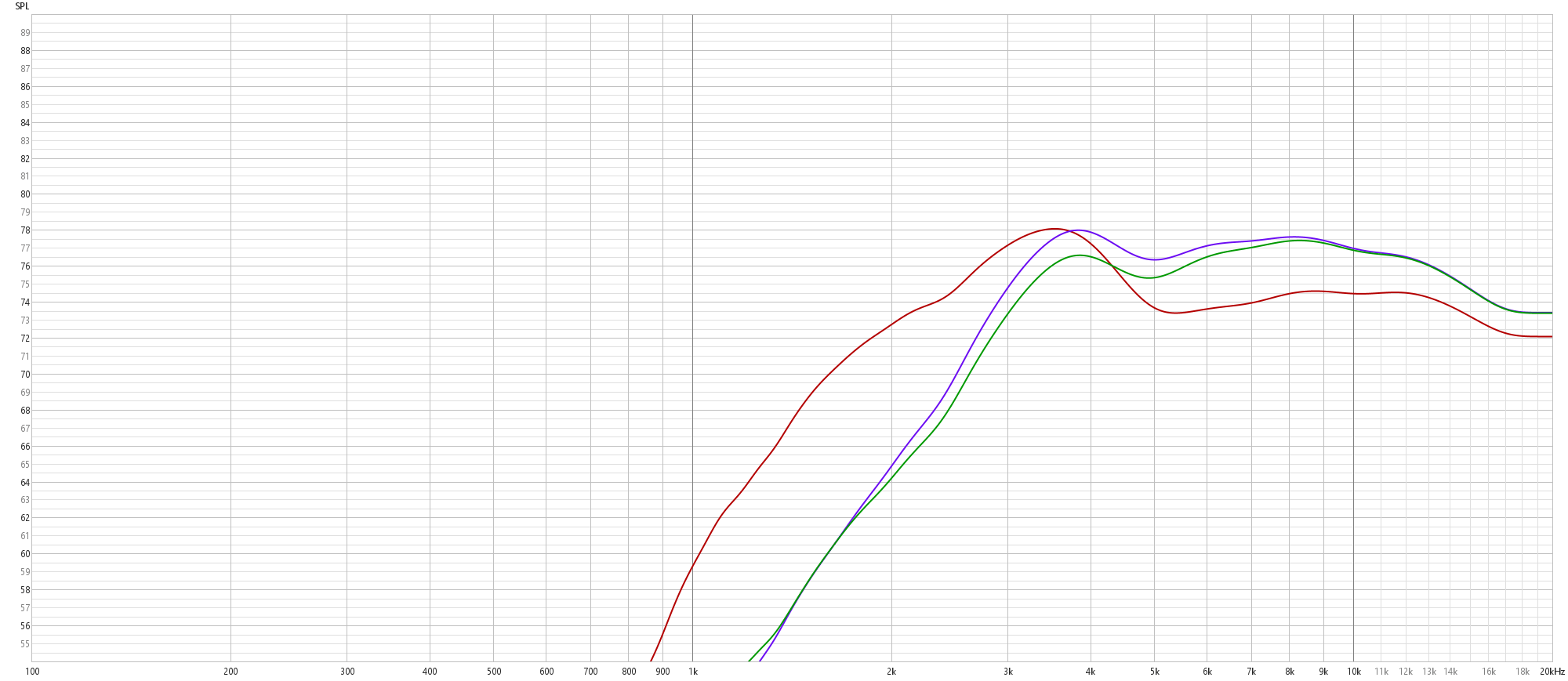

Begain again with measurements, but going ceazy at SS 9300 "knee" at 5K
And have realized that it is not possible to have a resistor before the tweeter, gets the "knee" bigger however I do..
Wonder if the Ferrofluid can be a problem?
