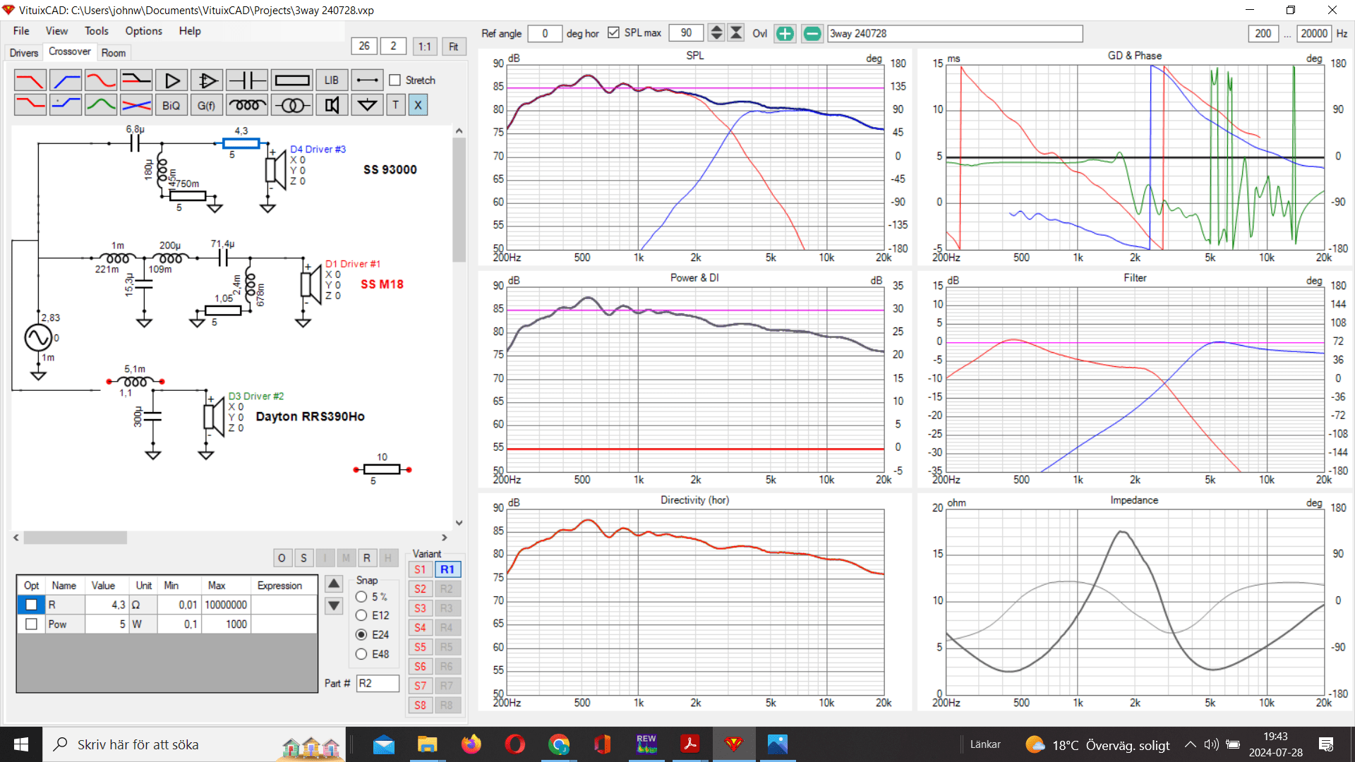

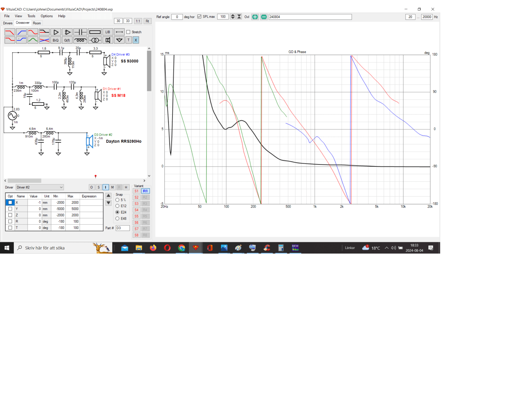

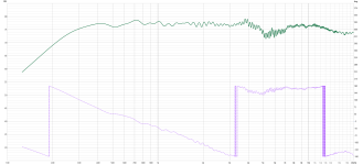

After many hours trying, i get it to be "flatter"....But still not down to 2,4K ( and more beer, at the end i fellt happy anyway hahaha)
At 2,8K i "dropps ca 1-2 dB around 5K, but still testing different things. ( 4 dB dipp at 4 K....hate it)
It look´s like this now without smoothing, and no woofer. ( I will reduce the twe a few dB at the end later)
The phase looks "strange" or?
Best regards John

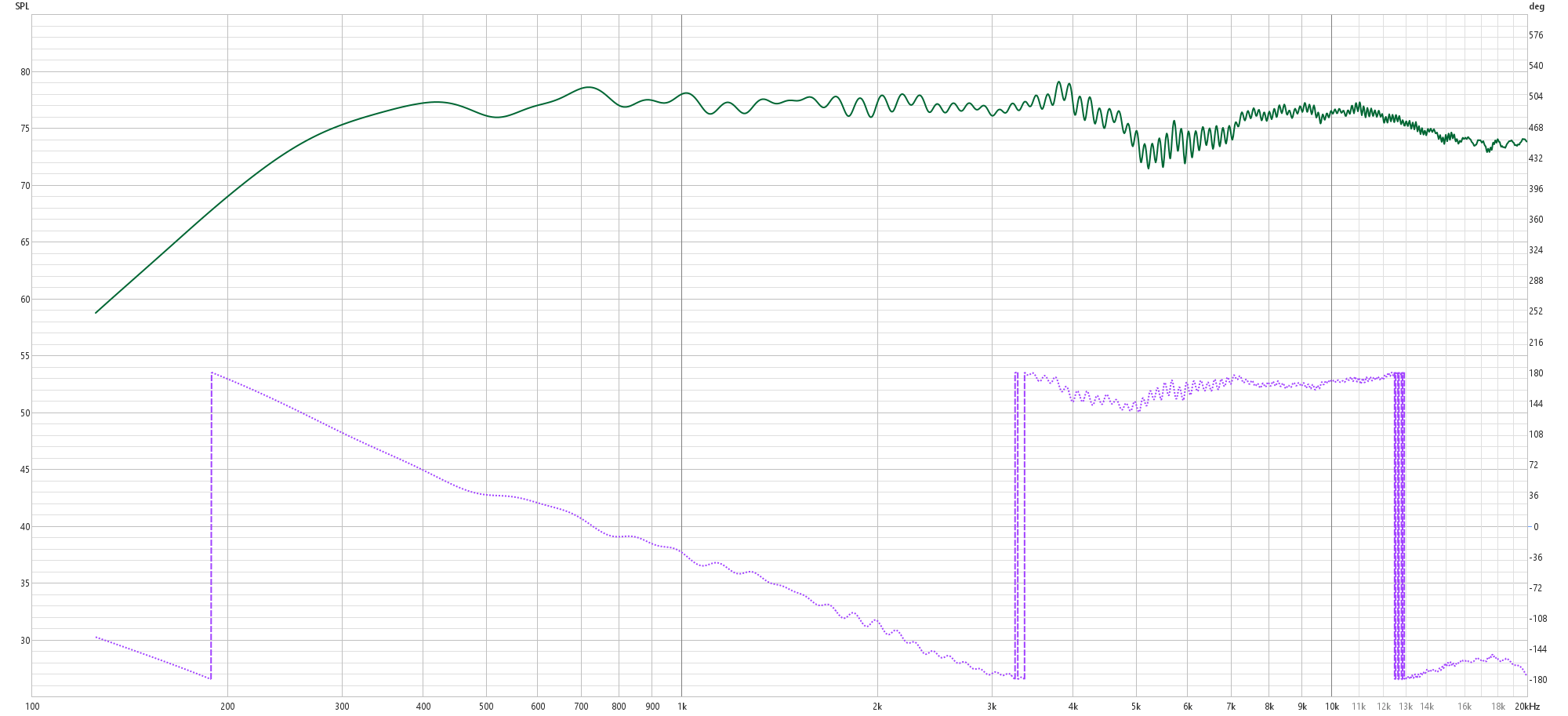

Measure obove have this filter.
And as you see "in real life" the tweeter don´t dropp like the simulation shows, and no "knee" either.
Here is also measurements on midrange alone, tweeter alone!

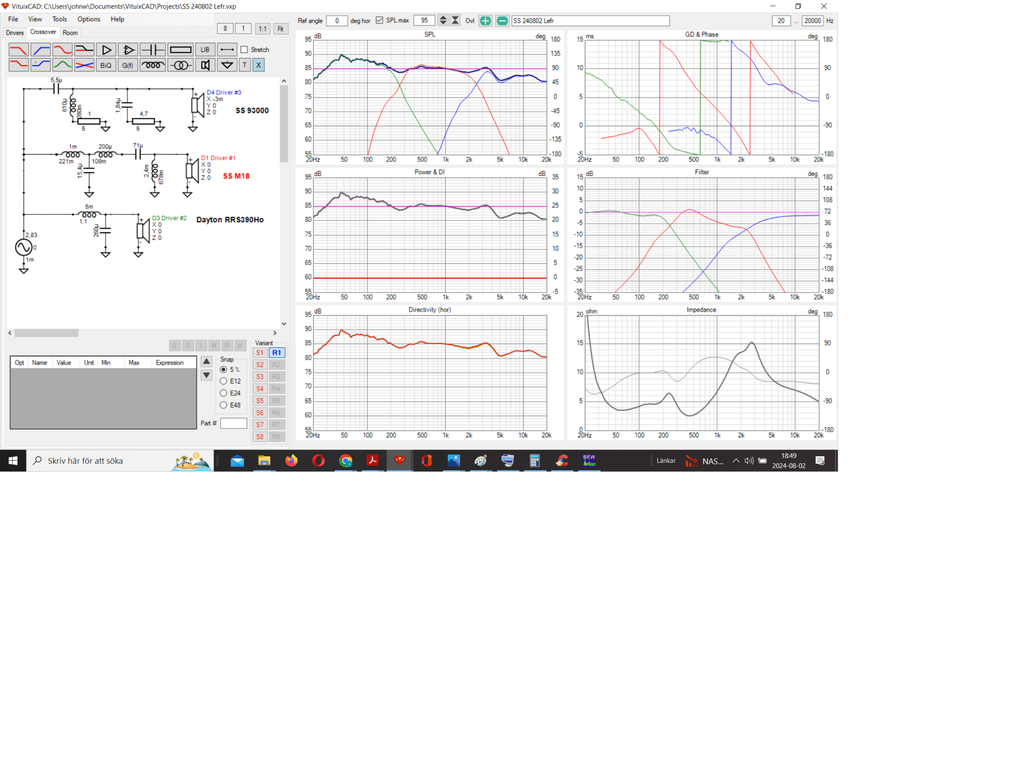

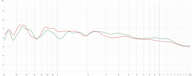

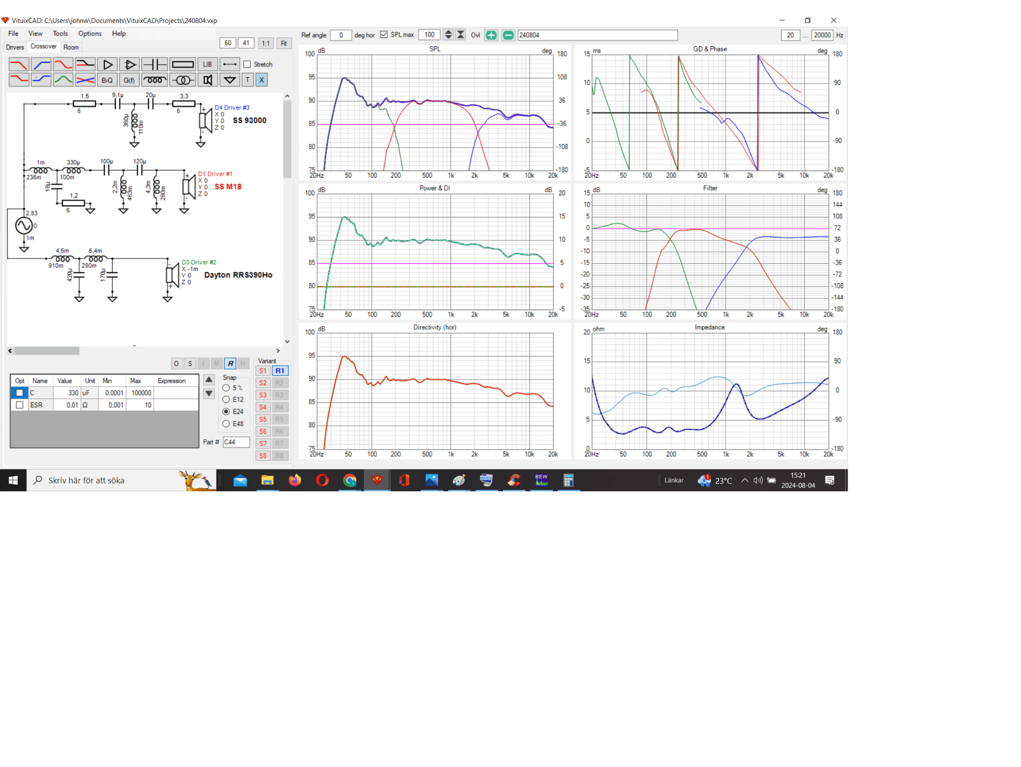

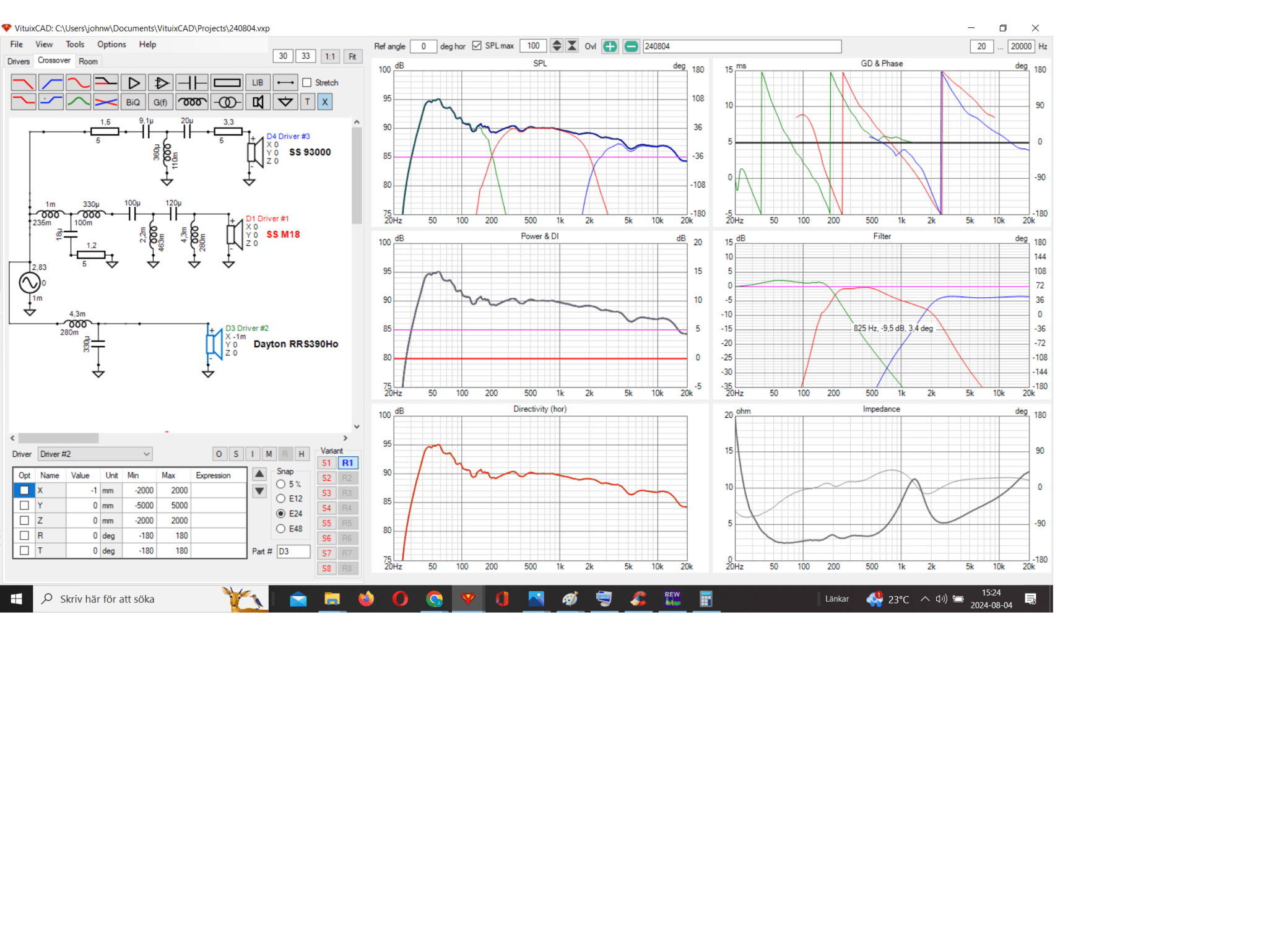

Work some on the 3 way, and tested 2 different xover´s.

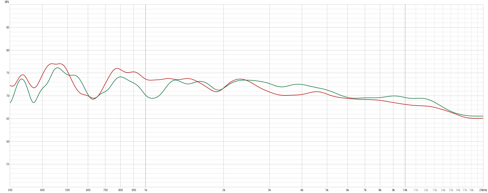

The SS 9300 dipp at 4-5K seems to be worse when measurement from 50-150 cm, it flatens out at 2 m.
This is from 2,9 m and where my head is in the sofa, Red is Left xover and Green is Right xover.
Is any of them "better" than the other?
Phasewise?
Regards John

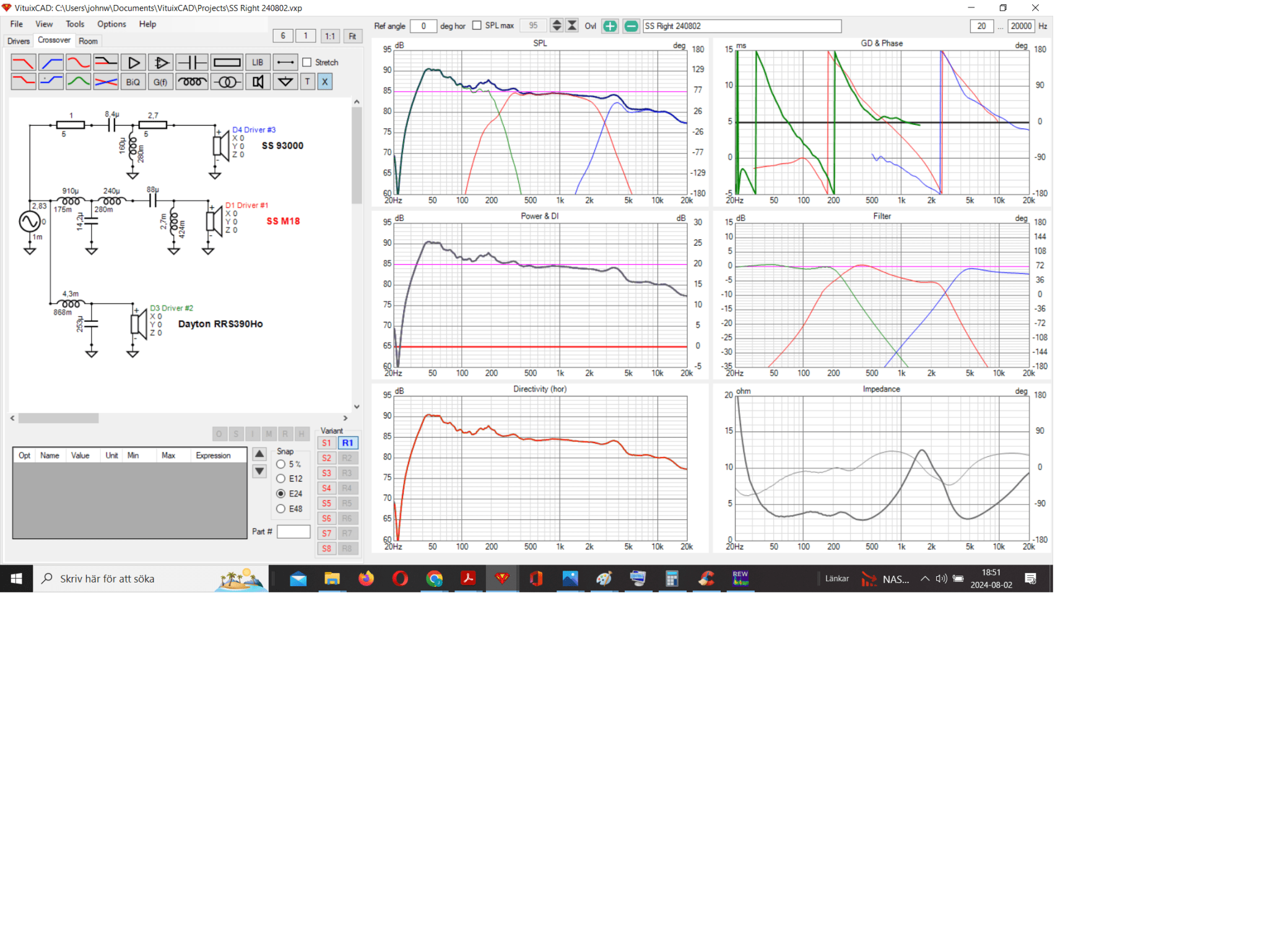

I Like the right one for its better phase alignment.
Also the impedance and electrical phase angle behaviour is slightly better in my opinion.
I don't know if this data could be input into Shadow play62's simulation maybe he could drive VituixCad to show how it behaves over differing angles?
A question about the tweeter crossover, it models with a little bump at 4-5KHz but the measured data doesnt show it. I wonder how it measures and sounds as you reduce the capacitor by one or two values. This is something i would take a day over measuring and listening just to see what I like the best. As long s values and other things are sensible the ear has the casting vote.
I hope you are feeling a bit better, and enjoy the day.

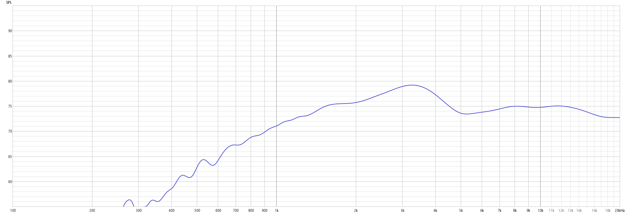

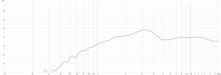

So in the end i did a new measurement in the room without xover, mic at 1 m. (speaker at 1,5 m in high)
And this is what it look like!
It dropps 5,5 dB from 3,5K to 5K
So last week I work with that "new" tweeter SPL curve in these 2 last xover´s.

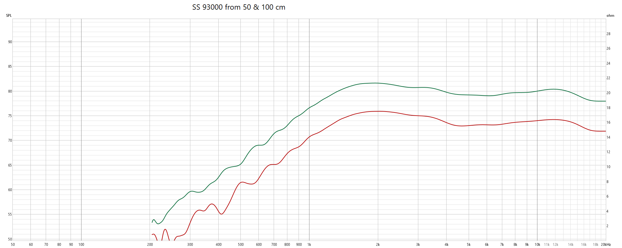

Seems "more difficult than usual" to measure the SS 9300 tweeter, & some measurements show about 2 dB dip & some show larger variations
As you see at the outside measurement from 50 and 100 cm, the dipp is at exaktly the same "spot", but only 2 dB outside.

In terms of phase tracking the first one is has all the drivers being well aligned for phase. Which is a sensible place to be, and shows that some effort has gone into the design.
Remembering everything to do with loudspeakers is a compromise, you can use it good sanity check of the design.
I.e. it doesn't have to be 100% accurate. therefore being slightly off is not a big problem. If another component change gives a better overall sound yet degrades the phase so be it. Some speakers from the 70s and 80s don't have such good phase match and still sound reasonable.
For group delay I am not sure what is going on there as there are no wiggles in the line which I would expect certainly in the LF I am not sure why that is as you have phase ? Maybe the GD tab is not clicked, wild guess on my part?

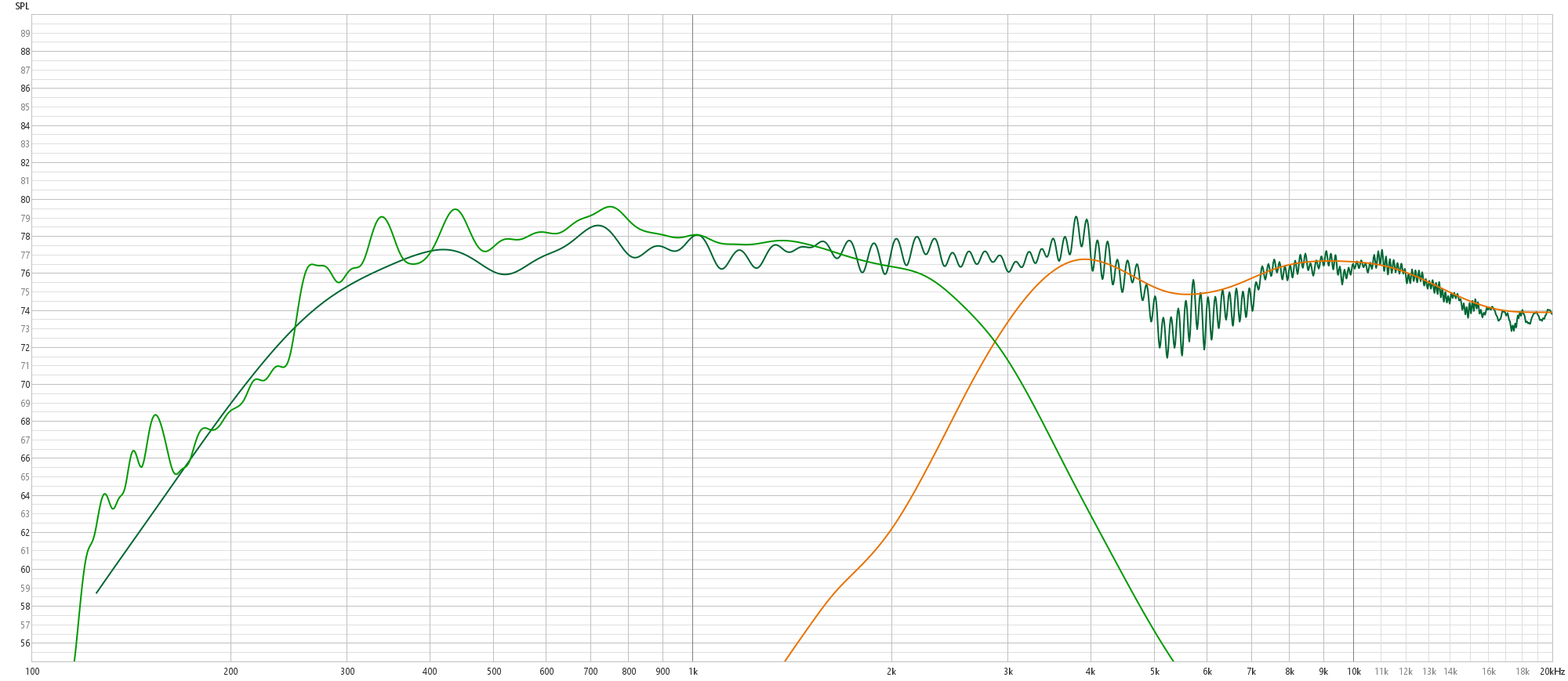

Begain again with measurements, but going ceazy at SS 9300 "knee" at 5K
And have realized that it is not possible to have a resistor before the tweeter, gets the "knee" bigger however I do..
Wonder if the Ferrofluid can be a problem?
Have to come back on this. What you most likely see is the baffle step function of the tweeter enclosure. It looks pretty similar to every tweeter with a 104mm diameter front plate that is measured in free air.
