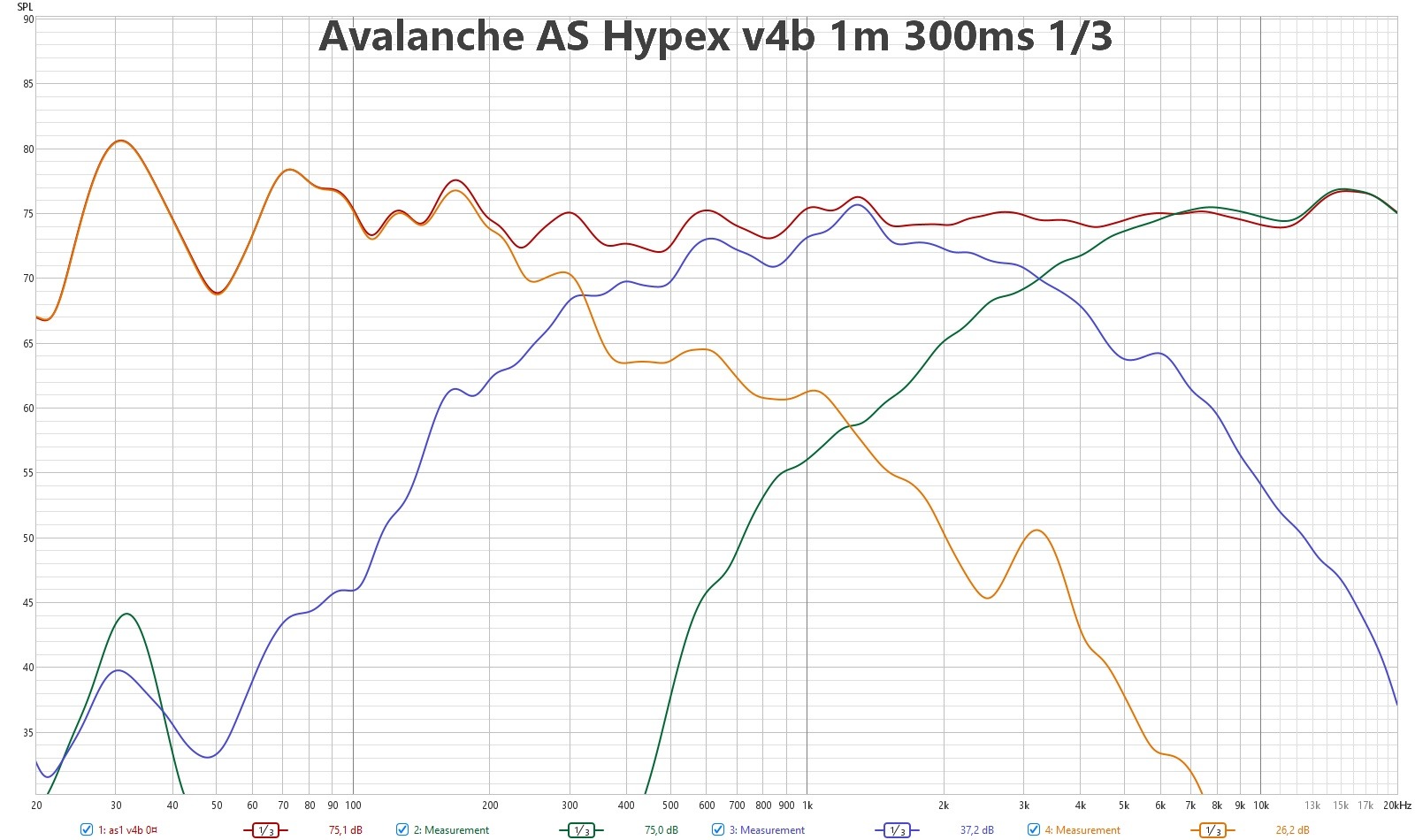

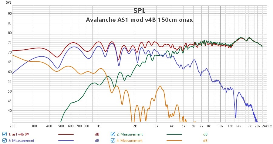

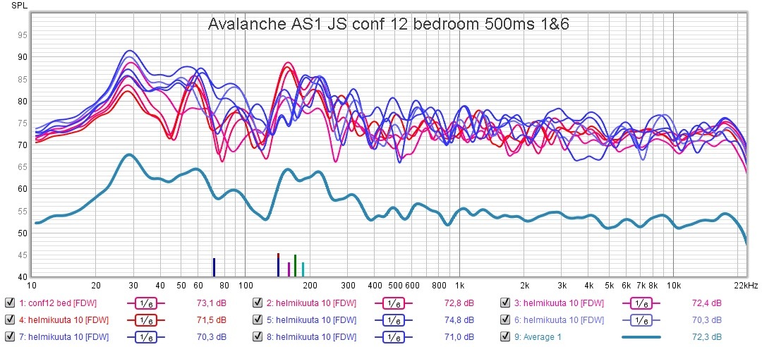

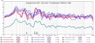

Below my measurents, just different windowing and smooting settings. Measured indoors 60cm from a WWMT tower active speaker with Hypex FA123 dsp-amp. This was not the final version...
as1 v4b all ind 6ms 1nosmo.jpgas1H v4b all ind 300ms 13.jpgas1H v4b all ind 30ms 13.jpg
and near listening spot using handheld mic at several positions (different version of dsp settings).

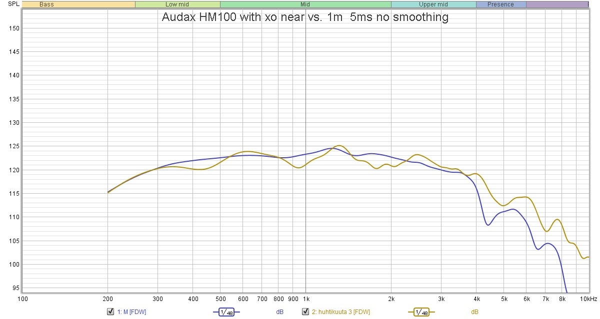

and nearfield vs. 1m of the mid with dsp

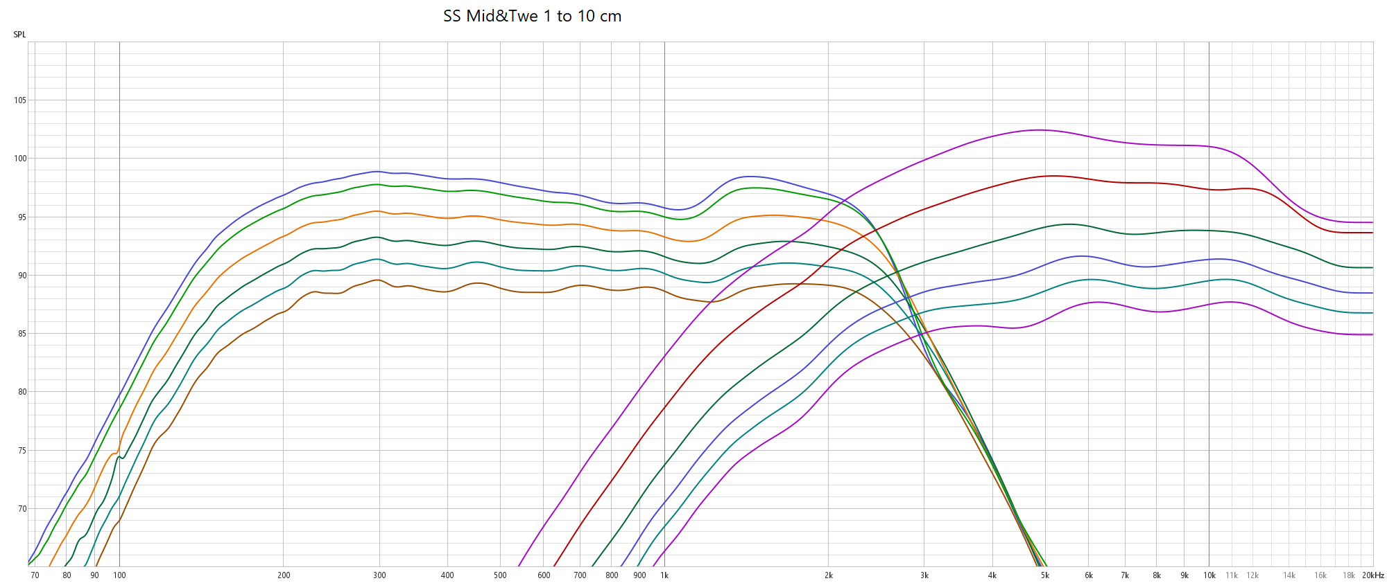

Okey, her comes first serie of measurements on tweeter and midrange with xovers.
I measure both separately from 1, 2, 4, 6, 8 and 10 cm, with other drivers possetive cable dissconnected.
You can se that both drivers get "better" from mic 6 cm and further away, and also maby my crossing-point a little high.
Real interesting!
Reactions: Juhazi

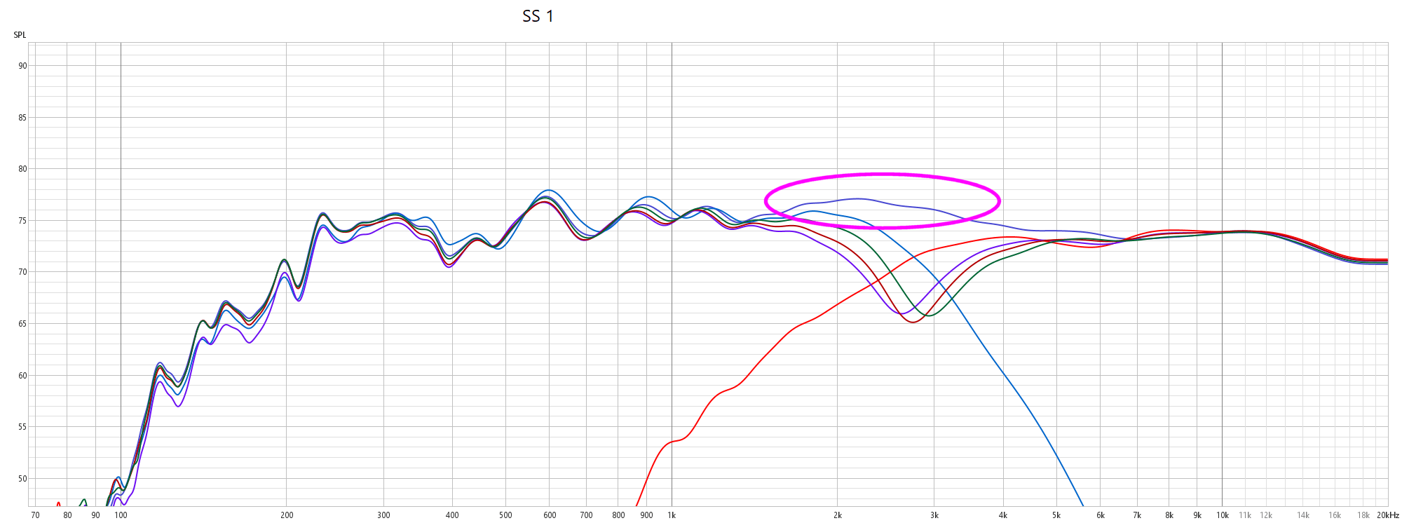

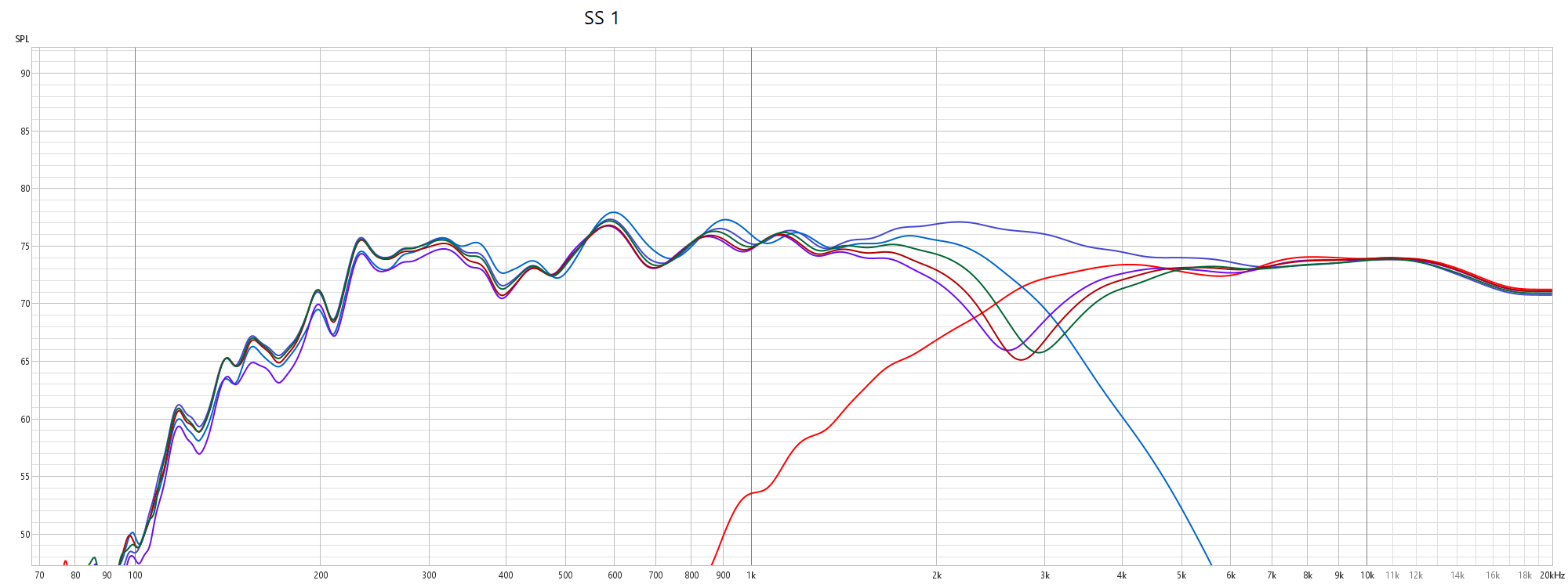

Here is measurements on tweeter and mid, separate, together and twe out of phase all is mic from 50 cm.
The 3 measurements with out of phase have small differances because i made a test lowering the mic a few cm. (real hard to se if mic i exact between twe and mid and i have separate boxes for them)

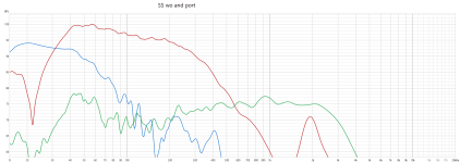

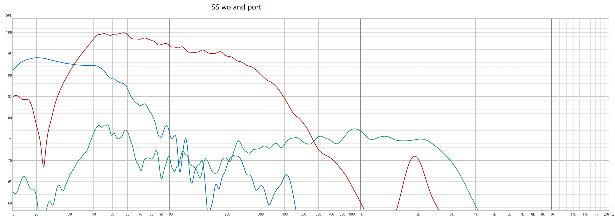

Okey now measurements from the woofer and port, mic at 2 cm. (port=Blue, woofer=Red, woofer/mid=Green)
And woofer and mid, mic from ca 50 cm and ca cc woofer/mid.
All data from same sound level on the measurements
Now more understand that if you want "more correct data" on your woofer/woofer-low midrange measurements, you have to go outdoors.
Even if me myself still thinks that a few different measurements & using your hearing & feeling go a long way.
But if i was a company producing and selling speakers, of course i want to show best measurements possible (but that is a different thing)
Tell me if you want to see other combinations of measurements on the same screen with overlays 👍
best regards John

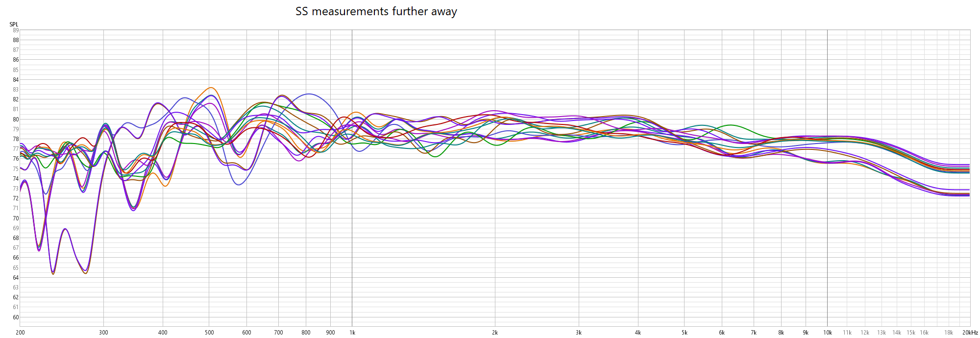

it "disappears" when i measure further away?
Thanks for pointing that out. I missed the distance.
Measurement anomalies can happen when the microphone is too close to a multi-way speaker. For typical speaker designs, "too close" changes based primarily on driver spacing and crossover slope. The larger the spacing and the more shallow the slope, the more distance you typically need for proper integration of the individual drive units' outputs.

Good progress here! I’m pretty certain the original 400-800Hz wiggle was a floor bounce interference. The midrange near field doesn’t show it. It seems the system response shows a downward slope up to higher frequencies. Is that meant to be? Furthermore, the mid to high crossover could probably be improved as is said.

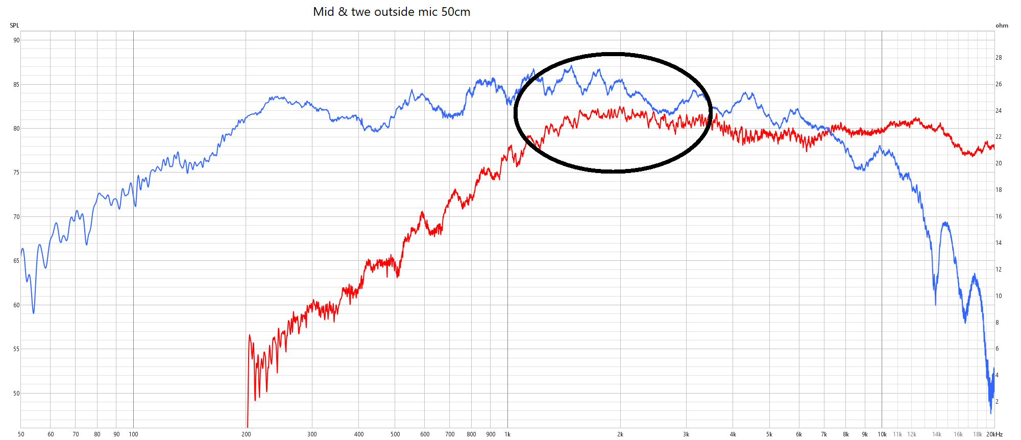

The SS M18 is a little "hard" to get to a "perfect" LP slope with, and i shows up in measurements outside even without xover. (se pic)
And when i "damping" that hz-area in the xover, dB also falls back to 700 hz 1-2 dB. (and i really don´t want SPL to drop anything more then what bafflestep does)
Maby my well-stuffed 4 liter mid-box "doesn´t help me" regarding to LP slope "irregularities" or what to call it.

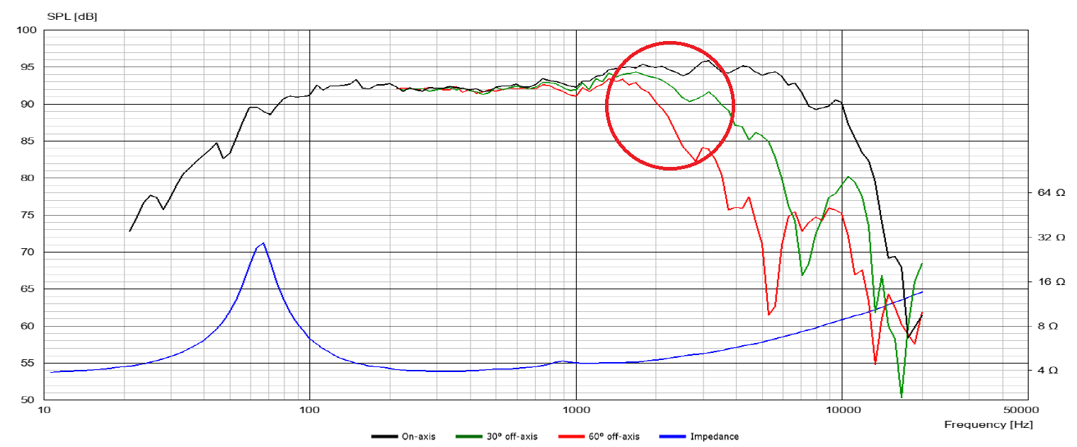

But even if you look at manufacturer Scan Speak's own specs, you se that something "going on" in that area.
So maby you have to cross it little lower or accept 1-2 dB lost in sensivty.

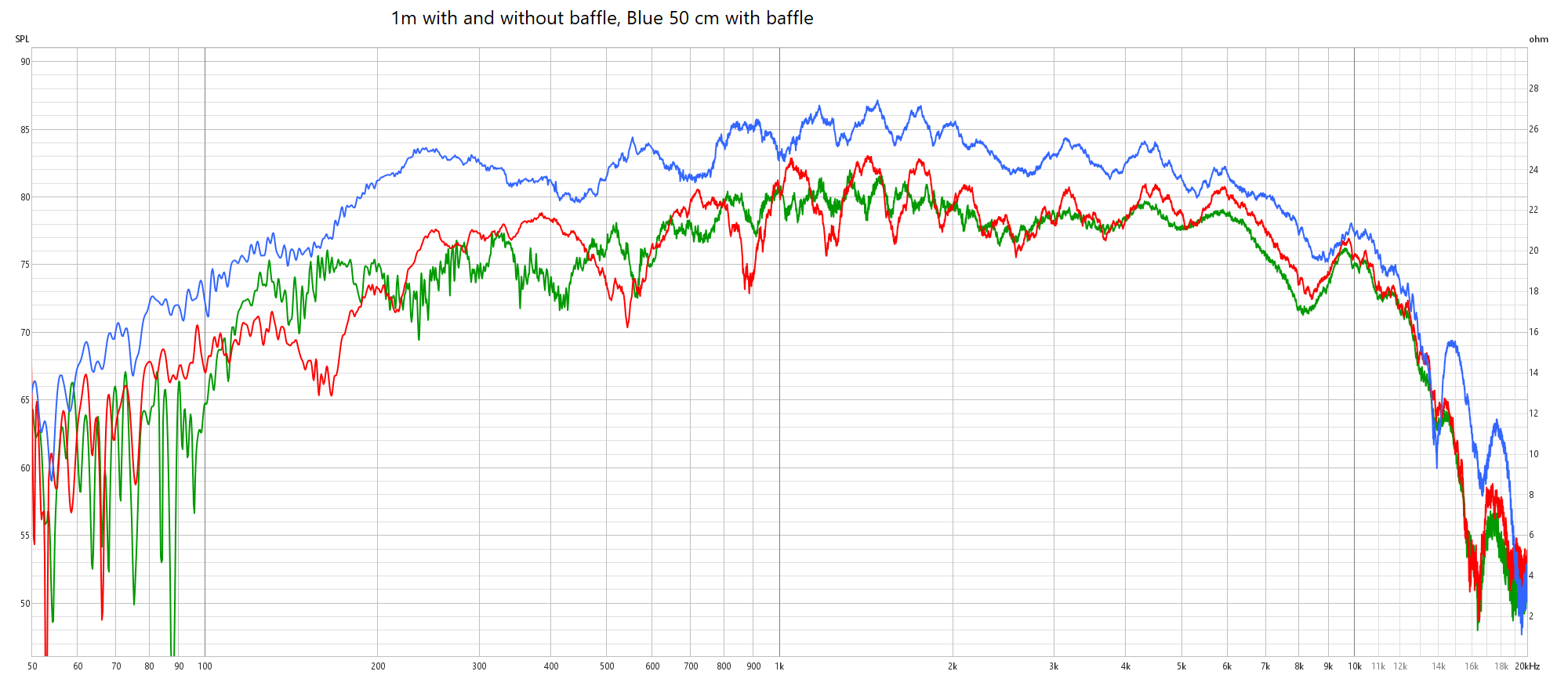

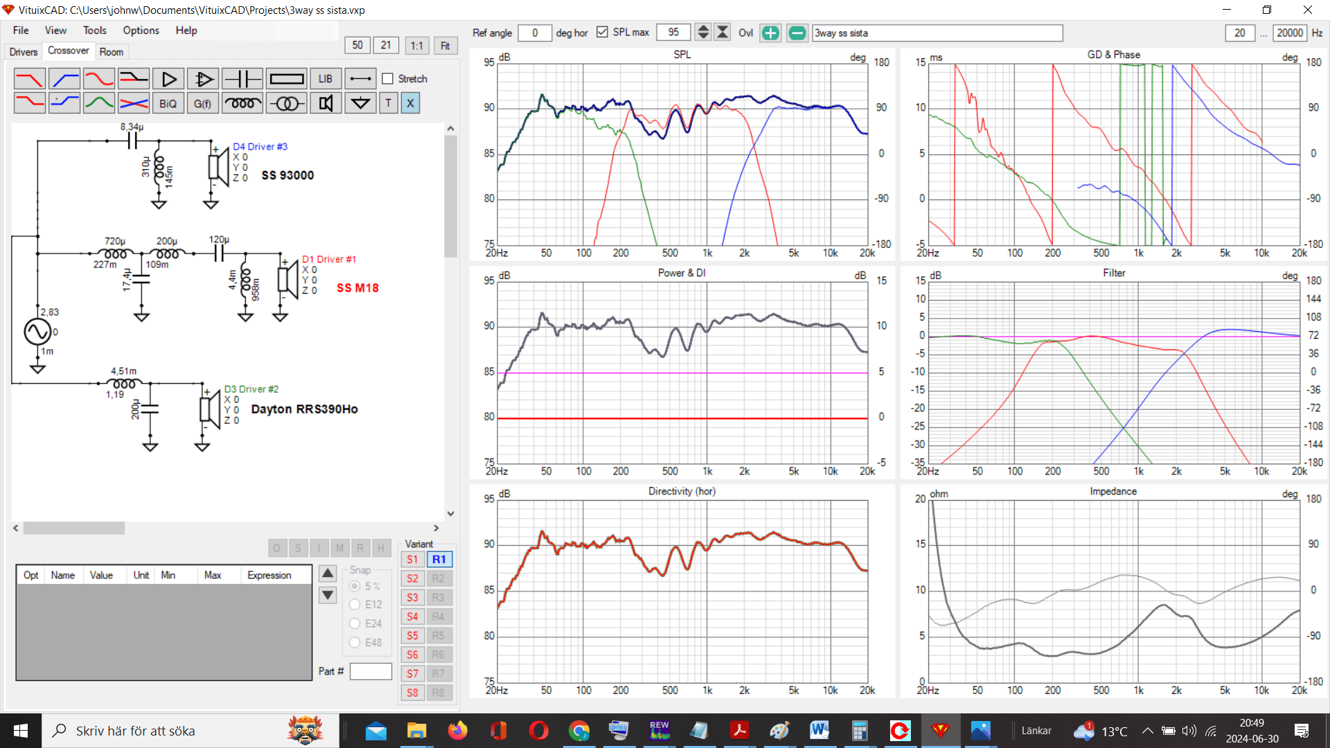

I don’t know your crossover topology. But you can’t correct the baffle step of such small enclosures without knowing exactly what it does and using appropriate circuitry. Iow using the standard solution with a (too big) series coil doesn’t work.

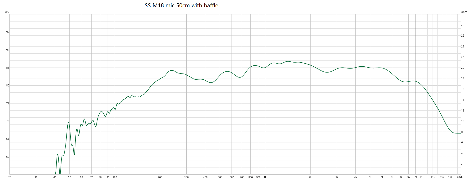

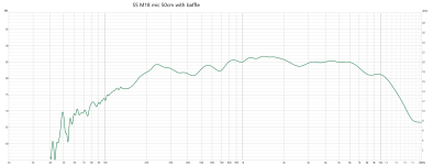

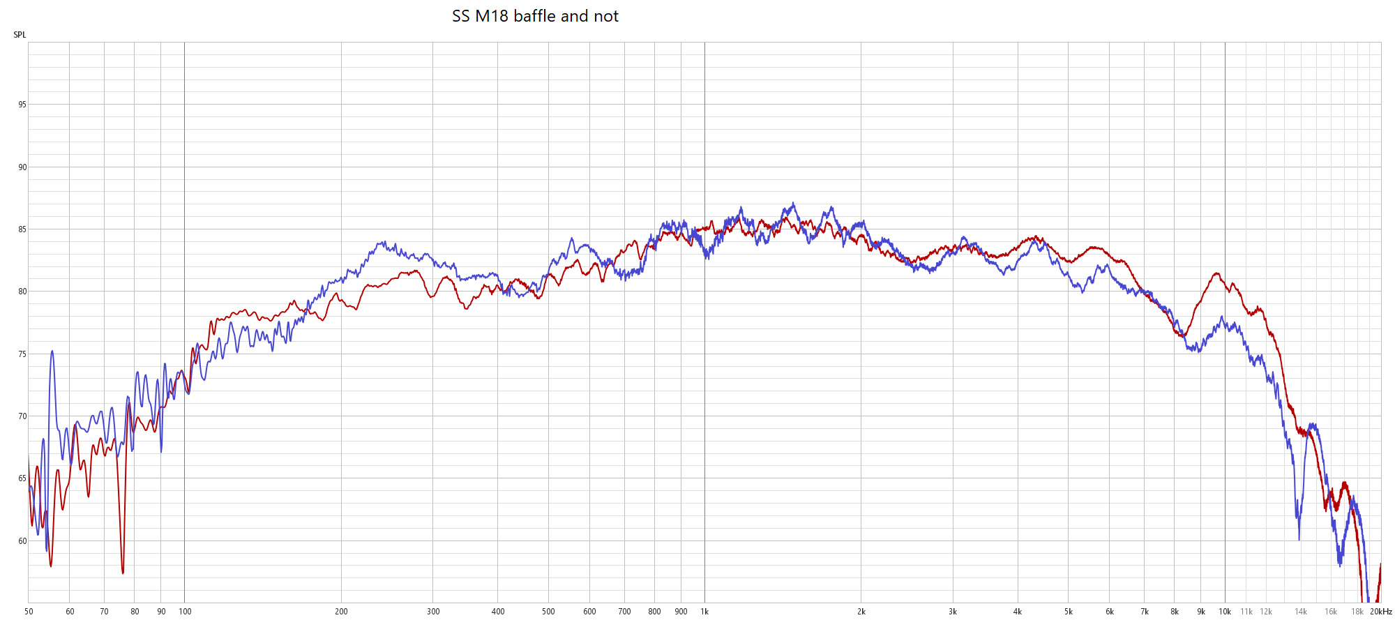

Here is outside measurement from 50 cm with balle= Blue
And from 1 meter with and without baffle = Red is with baffle and Green is without.
And xover look like this at the moment.
regards John
if brown trace is 1cm, this shows the resp of driver w/o baffle effect - it is quite flat 200-2k
whereas if blue trace is 10cm, the dip has appeared
farfield gated test is needed on mid box, which should be raised up (>1m) to be out of "floor bounce" issues
(if bass box is heavy too raise, replace it with a flat baffle of similar size)
