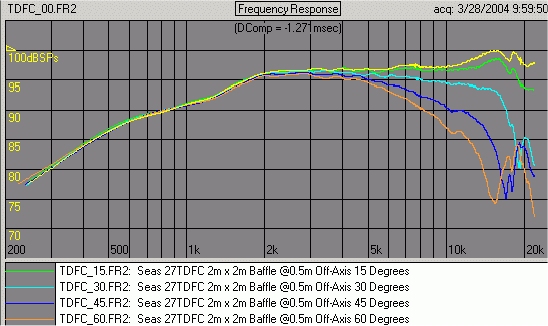

Omni, I found a site: http://www.speakerdesign.net/raw/rawdescr.html
that has measurements of your 27TDFC's, so I thought you might like to compare it with your results? It also has FRD/ZMA files! I hope this is interesting for you? (its in 'tweeter large', I think, if not I can
email)
Btw, from lots of reading, I think maybe the 27TFFC and MCA15RCY with my old Vifa P25's could be ok? But Troels infers inductors DCR's of less than 0.3 Ohms which will be really expensive! They would
cost more than a driver! Hmm, what to do? grant
Grant, I checked out the site you posted and observed the TDFC graph...............It looks similar to the manufacturers plot and overall, I think they are accurately representative of the TDFC. The only difference being is that the graph on the site you posted appears to be a little bit smoother throughout............I am heartened by the validation..............Tinitus, thank you for your observations. I will be tweaking a bit today, as I have been studying these graphs diligently, and believe am gaining a bit of understanding as we have progressed.............What is your thought on the series resistor on that midbass series inductor?........We'll be in touch......Respectfully...........Omni
