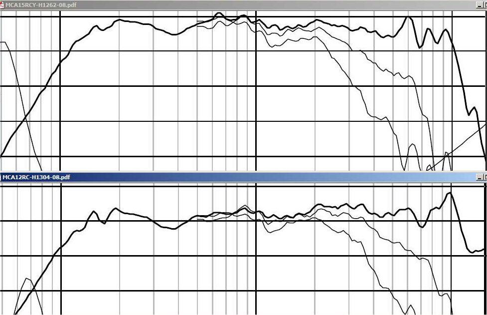

Wow, the MCA15RCY seems even better than the MCA12RC! To quote Troels: .."MCA15RCY: Not an everyday sight. Flat from 200 Hz to 5 kHz and modest wrinkles from 5-10 kHz. Sensitivity = 90 dB/2.8V. This driver is flat over almost 5 octaves! Too good to be true. Playing music on the midrange alone didn't sound bad at all. The sound appears neutral with no aggressive tendencies".... You couldn't get a much better recommendation than that, thank you!
To me the MCA15 has some advantages (over the MCA12), higher SPL, nicer looking response curve, slight 'BBC dip', no peak at 10kHz and it would probably fit better into the existing hole!
Have you listened to both of these/ any experience with them?
Troels mentioned (in 3wayClassic) that the MCA12RC transient response was superb. Would this be related to the voice coil height? For the MCA12 its 5.8mm. To quote Troels again:.."the only thing that differentiates the MCA15RCY from the CA15LRY is a slightly higher Fs for the MCA and most importantly, a short voice coil. You can make a short voice coil as the membrane doesn't have to move much and you get increased sensitivity as more of the voice coil will be in the magnet gap. The MCA15 has a 9.4 mm voice coils (height) compared to 16 mm for the CA15RLY. So the membrane in the MCA15 can only move +/- 1.7 mm and still be fully in the magnet gap". ...So would the transient response of the MCA15 be nearly as good as the MCA12?

with Vas = 12L and Qts =0.25 optimum Q=0.71 volume = 1.7L.
So a well stuffed 1.5L will be fine.
I'd go with any of the fabric dome Seas tweeters mentioned.
They are very near equivalents. Also consider Troels modifications.
The transient response of the MCA15 will be as good as the MCA12.
🙂/sreten.

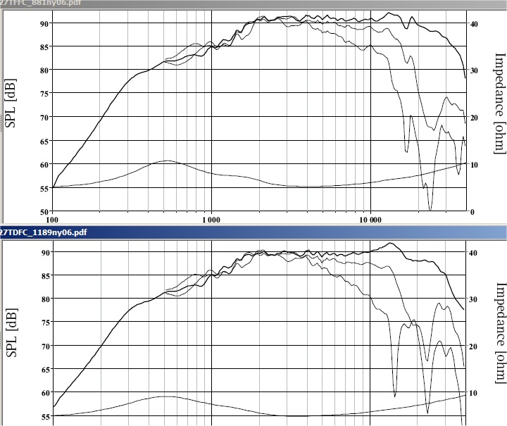

From the Seas web-site, the choice between 27TFFC and 27TDFC seems to be a 'no-brainer' if the published charts are to be believed; because surely they would be correct. The 27TFFC has a nicer
response shape, better off-axis response and also slightly higher SPL. I guess thats why Troels uses it in his Poor Mans Strad (PMS), and as I could be copying his design, I guess thats what I'll choose together with the MCA15RCY (thanks Sreten for 'putting me on to it'!). I don't know why Zaph said the TDFC was 'smoother', could it somehow sound better given the attached charts? Any opinions please?

Hi Augerpro, Thanks for 'dropping by'!
In TweeterMishmash Zaph tested the 27TBFCG and the 27TDFC I think. Unfortunately I misquoted him in my last post regarding his comparison of the TDFC with TFFC. His desciption was that the TDFC had a 'slightly cleaner performance' than the TFFC (as I correctly quoted towards the top of this page). So yes its weird, and I'm confused! lol. However, as I'll be more or less copying Troels PMS, I'll probably stick with the TFFC anyway.

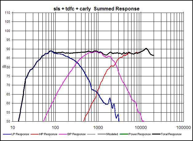

Hi Grant, Tinitus, Sreten.....................Thank You for your Inquiries and support.....Baffles are done and mounted to Cabinets.......Finally......... Just a little touching up.....and on to the internal cabinet work...........I have resolved to finish crossover sims this weekend, which I will post beginning of week for reviews, if not sooner........ Hopefully, I will be able to order components soon..........Grant, looks like you are getting closer to gettin some drivers. Though the FRD and ZMA files for your drivers are not posted on the FRC website, I can Trace them for you.....no problem and process em for you when you finalize your choices. I will need cabinet specs, etc, when you are ready..........Keep me posted............Tinitus, I have been experimenting with your resistor concept and am getting some neat results, even in the woofer........check back here for graphs. I will definately look forward to your assessments.........I have missed a bit here in the last few days...............Looking forward to some wonderful things.....................Respectfully.......Omni

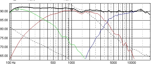

Also Omni, you are indeed correct about the xo-point being where the lines intersect! Silly me, trying to make things more complicated than they are! The attached IS 340 and 3800 Troels PMS. Cheers, grant

Hi, ... look at the graphs you posted from Troels
Look at the round "shoulders"....thats what I was talking about
BUT you will also see a very small dip at the point where bass tweeter meet, though I am sure its insignificant its there
A great danish innovator mr. Steen Duelund, who is sadly not among us any more, made his own filter to take care of this - put simple, the whole filter was calculated from this exact point

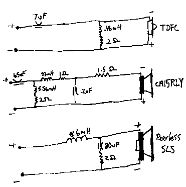

Here's the circuit for the above graph.........If it is hard to read, the first inductor in midbass is .93mH, and the woofer inductor is 8.6mH.............Again any comments, and or suggestions are welcome....Respectfully............Omni

Yes I do think an ideally smooth and constant rate driver rolloff with 'round shoulders' would be beneficial in achieving a balanced acoustic response. I thought the slight dip at around 1400Hz was primarily a function of the mid's dip there, but the minimal contribution of the woofer and tweeter at that point could be a contributing factor too, I suppose. thanks, grant
