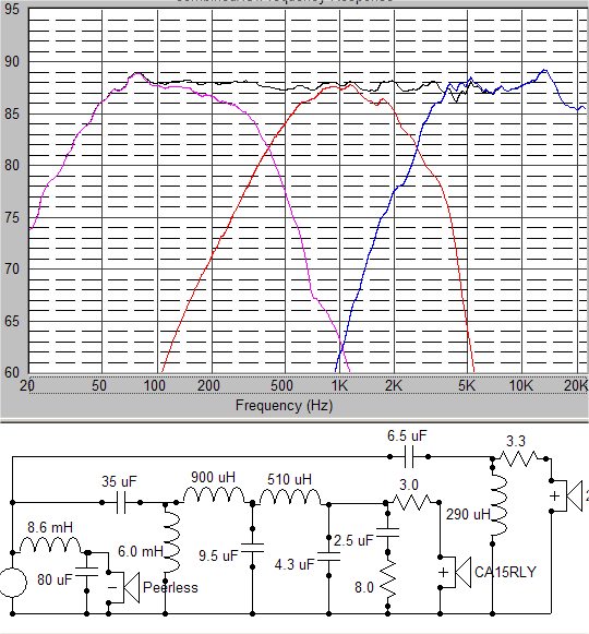

*OMNI*, I couldn't help myself! I just had to try to achieve an xo that better met your design goals.
The latest circuit (attached) would need to be considered vis-a-vis Sreten's off-axis modeling procedure.
Anyway, its now '4th order electrical' on the CA LP; the steeper rolloff now looks like it may be (xo-point on LP) at 2500-3000? ( I don't as yet have a resonance formula for a 4th order). There is also an oddly valued (but seemingly effective) Zobel on the CA.
*I do hope it won't blow up your amp!*

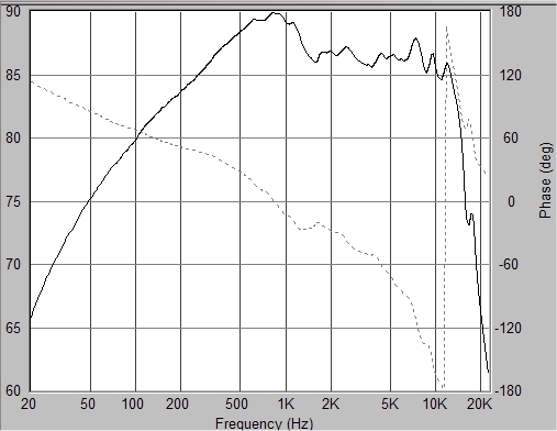

The Zobel values look good because they eliminated a new nasty CA peak at about 4500Hz - other values didn't!
Minimum overall impedance does not drop below 4.2 ohms at 4800Hz. (maximum impedance is a whopping 147 ohms at 25HZ!) The CA peak/dip seems to be nicely smoothed and the response is now +- 1.5 dB from 50 to about 18kHz, - not too bad? Without those particular Zobel values, I could not get a smooth response - I truly hope they are valid.
So, superficially, it seems that your design requirements are now met? The CA's values were chosen purely by trial and error, they were the best I could get this way. Unfortunately there's 4 more components than the last 'full 2nd-order' I emailed you.
The CA's FRD data showed it was still at 86 dB at nearly 12kHz!, so that's why I thought a 4th order would be beneficial wrt your requirements. Of course, in this respect the CA response looks vastly improved over my earlier '1st on mid' design. Also, please note the inverted woofer.
I'm very interested to hear anyones comments on it. I think I might finally be getting somewhere OR is it puerile rubbish ( that is, fundamentally flawed)?
Many thanks to you both, and Tinitus!.........grant

Err, a Jpeg compression error caused the loss of the link from the
Zobel to the CA '4th order'? Anyway, it is there!
Omni,
I forgot to mention that there still seems to be a 'nice symmetry' about the rolloff curves, and that the tweeter seems to be 'well protected' at resonance, so hopefully low distortion, and also because of the steep CA rolloff.
The 1 dB Peerless peak at 80Hz? should be of no concern, its too small to worry about, imho. Also, imho, trying to eliminate it, would be very costly indeed. Are there other issues which I may not have addressed yet? I did try various Zobels on the woofer, but they didn't seem to provide any useful benefit. thanks, grant

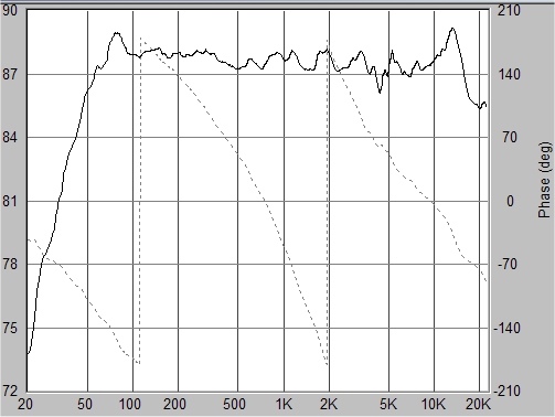

Hi Sreten, thanks for your reply,
Re: 1) ...high phase angles. The attached shows the phase for my last circuit. Does it look ok to you? That is, is the abrupt +- 180deg phase shift, a concern? Or is it desirable? I assume it's ideal, but
I really have no idea!

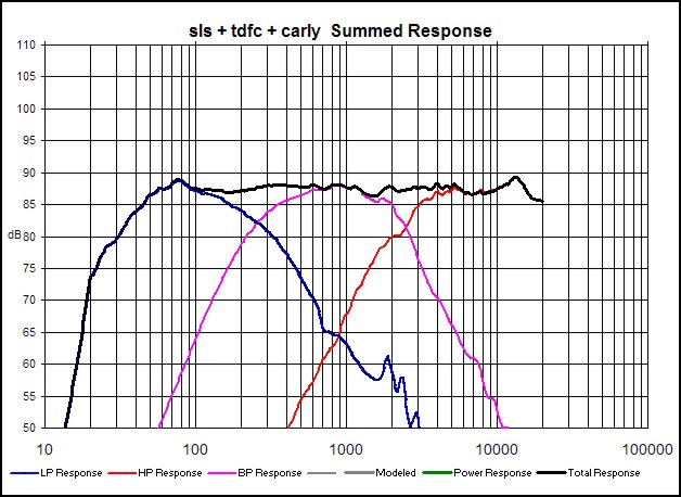

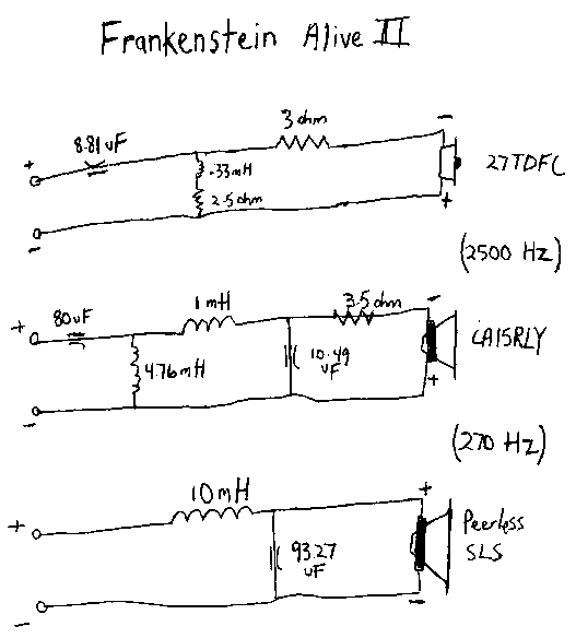

Hey guys, I have been simming and simming, trying for the simplest xover, been incorporating series resistors on shunt components, and here is the latest graph. Check it out. New crossover points..............but not straying too far off my original goals...............Has some advantages, I think.........Any input is greatly appreciated...........Respectfully.......Omni............If it needs some tweaking, any constructive critique is welcome.......Minimum impedance is 4.58 Ohms...........Too low? or OK impedance wise............Omni
Omni,
It looks great to me! The CA seems nicely controlled too. Would you kindly put your circuit here for interest? thanks , grant

shunt resistor - I place them on negative, like you have done
Looking at your crossover makes me speculate....
I wonder why you have to reverse tweeter polarity ..... maybe some values are just a tiny little bit off .... making you reverse polarity
I dont like those big series resistors on mid and tweeter
And I still dont understand why people tend to use such big
Inductors on MIDS
And that big inductor on BASS might eat too much sensitivity from the midbass range and the whole speaker as such
I have always learned to reverse midrange polarity only, but ofcourse I could be wrong....in all of it 🙂

Tinitus,........ Big series resistors on mid and tweet: Neither do I..... Seems that they may really lower SPL...............in combination with the amount of juice the 10mH inductor is gonna draw........Big inductor on mid: Somewhere I read {not sure where} that the large inductor on mid has a tendency to stifle the sound of the driver........Weird how it produced a relatively smooth summed response................At any rate, to quote Grant "back to the drawing board"......Seems as though I am learning a little bit as we move along in this endeavor......Oh Well...........Thank You very much for your candor...............Respectfully.......Omni..............Polarity of tweeter issue....I don't even know what to say..............
grantnsw said:Hi Sreten, thanks for your reply,
The phase changes are not abrupt at all, its the way its graphed.
However you have shown the acoustic phase, the issue is the electrical phase.

4th order electrical on the mid doesn't seem a good idea to me.
My starting point for the crossover would be the following :
No zobels ......................
First order series between the bass and mid unit.
Second order parallel for the mid and L-padded tweeter.
So 1st order low pass, second order high pass on the mid.
It seems a parallel LCR circuit in series with the mid may be needed
to control the rather large peak around 1Khz, after getting this near
then consider any other other series resistance for level setting.
If the first order series bass / mid will not work only then consider
2nd order parallel for this c/o point.
Question :
What is the difference between a 1st order electrical parallel high pass (inductor in series) with
driver zobels Cz and Rz and a 2nd order electrical parallel high pass filter with no Zobel components ?
Answer ?
🙂/sreten.
Hi everyone,
Your responses here are truly insightful, fun and interesting!
Thanks, particularly to you Sreten for answering my uneducated questions. I'll need to carefully, (as best I can) consider everything and hopefully post some 'meaningful' replies, asap.
Sreten, (briefly)
I do like/appreciate you notion of a LCR trap for the CA, it seems appropriate to me (qualified as usual!)
Also, I'm very interested in your suggested combination of series and parallel filters. Would it be ok to ask you to post a 'raw' schematic of this scenario, that is, in general terms only (no component values) of what your suggested network would look like? So that I might be able to further research it? The only 'series' link I've found so far is Graddon, I think, maybe also Elliot? I'm still very much lacking on series theory. Many thanks, grant
Sreten, (briefly)
