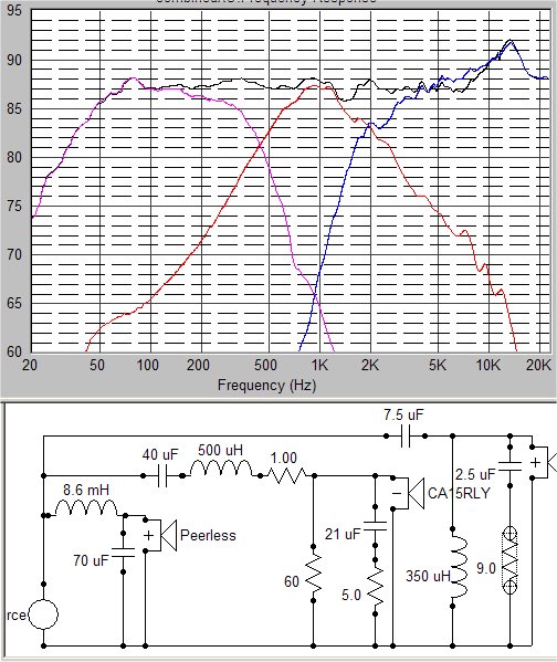

Hi Sreten,
firstly re the tweeter Rzobel (was 2 ohms) being too small, I increased it to 9 ohms, (just as a guess as I don't have time at the moment to
'work the theory' unfortunately!), here's the new chart&circuit.
(I haven't changed any other values, just wanted to model only 1 value at a time).
The only real difference I can see is that the 13?kHz tweeter peak is now 2dB higher with 9 ohms. This is why I specified 2 ohms.
Any comments appreciated, thanks grant

Sreten,
the 60 ohm lpad R on the mid makes so little difference it would be inauble, but the response looks a teeny bit nicer, lol. thank you grant

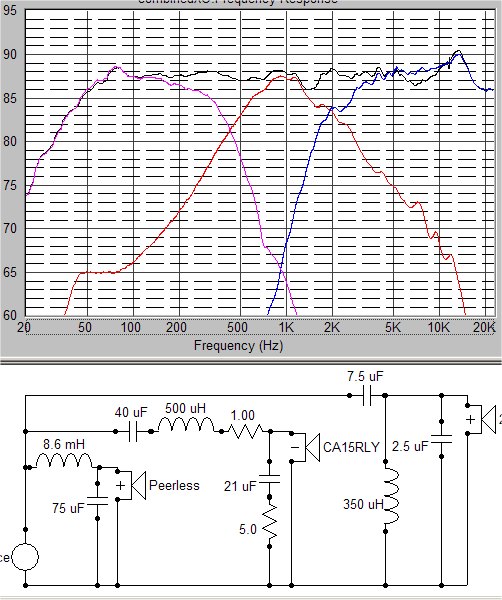

What I don't understand is this:
firstly, with no tweeter Zobel the tweeter response is err, yuck!
A 2 ohm tweeter Rzobel has a lower peak(2 db) than 9 ohms.
So I thought what would happen if I removed the resistor?
The response looks the best yet! How could this be so? thanks grant

Ok, you have discovered the amplifier melting capacitive voltage divider.
It works like an L-pad except overall impedance plummets with frequency.
Go back to a standard L-pad, and keep an eye on overall impedance.
🙂/sreten.
(see attached)
look at the (lack of) impedance at high frequencies for this case.
You've modelled a highly impractical capacitor L-pad.
🙂/sreten.

Grant.......You mad scientist,you.............You have been working like a beaver on these sims, and it appears you are settled on the woofer 8.6mH coil and between 70-75uF on the cap. I agree with that particular rolloff. I think Tinitus mentioned that it looked like a good rolloff and then to simulate the other drivers to the same shape... So it seems like woofer, for now is cool...........Tinitus, I have studied your comments closely and have a similar philosophy, however, less experience. I deeply appreciate your analysis and encouraging thoughts. In one of your posts you said "fact is, you are actually close". Were you referring to the woofer rolloff? After reading your ideas on the series resistors I hope I know what direction to take.....It appears the midbass IS the biggest problem, as also exemplified by Grants' sims................Grant, as far as tweeter crossover points are concerned, it has always been my thought that Xover for tweeter should fall at least 2 octaves above Fs. Though a lower crossover point may create a louder sounding upper end, and appear to create a summed response curve that looks good, I think a bit higher crossover point will remove unwanted resonances and curtail "ringing" in the response, lending itself to a faster, more transient response, and sound cleaner. It would also greatly protect the tweeter from harshness and potential damage. This then puts the onus on the crossover design to deal with the midrange, which seems to be the challenge..........Grant I also saw your sim utilizing the components I used in mine, and though there are similarities in our graphs, there are also major differences. Your midrange curve appears steeper on both ends than mine. This is curious, and I am wondering if this is a function of the programs we are using..................Not sure here. Also, your crossover points appear alot different as well. Yours are higher on the low end of the xover, and lower on the high end of the xover. Again, I am not sure why. Are you using 300-3000 Hz crossover points? Anyway, I will keep simming as I learn more from all of you......... I am deeply moved by the fellowship that has developed on this thread, and that includes EVERYONE who has shared here. I am grateful to be part of it....Respectfully..........Omni...............PS a few of lifes' twists have occurred, which has delayed new sim charts, which will be forthcoming this weekend.....................Warm Regards to you all 🙂
Hi Sreten,
I truly deserve the 'DIY Dunce of the Year Award'! That deleting Rzobel idea was utter madness, the amplifier would have been short circuit. I wish I had taken a little time to think about the dire
consequence before I had posted it! This was my most serious blunder, I'll try to be more wise next time before I post total rubbish! <embarrassed> grant
