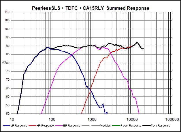

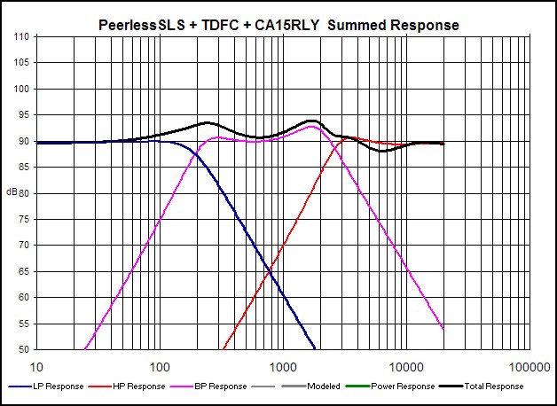

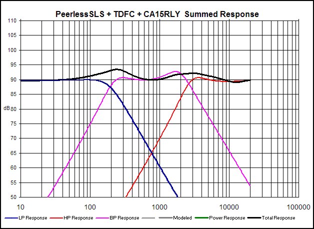

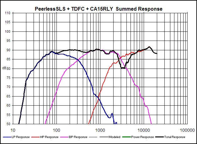

Here's a few more response graphs to check out...........Any analysis would be greatly appreciated, but I think they still need a bit more work? I have not been able to draw the schematic correctly in SW so here ore the component values: Woofer:8.6 mH series inductor, and 90uF shunt cap, classic 12dB set up...Midbass: 90uF series cap, and 4.59 shunt inductor.............. .37mH series inductor, 11uF shunt cap.......Tweeter....7.5 series cap, .31 shunt inductor..........Zobel in tweeter 2 uF...9 ohm............Midbass polarity reversed
This graph has the tweeter polarity reversed in addition to the reversed midbass polarity....Woofer is normal polarity.........Like I mentioned before, still more "tightening up" required.......But any observations, analysis, and guidance will be greatly appreciated..........I have been working obsessively on this and think things are starting to shape up slowly..............Grant I have been playing around with multitudes of combinations and component values and I sincerely believe that, though it is in it's infant stages..............This is a testimony to your work thus far..........Respectfully............Omni.................The Midbass and Tweeter FRD and ZMA files are new trace files processed through thr FRC Tools............I think they are more accurate than the original files we started with.
Omni,
Are you saying that you have finished re-processing your files already? So soon? Are these the final versions in such speedy time! IF processing is now complete, may I have a copy of the (6, lol) new files please? Because I would like to sim it myself with your values, then experiment and compare results. Btw, what are the coils DCR's please.
Of these latest graphs, the second one looks pretty good so far! I tried inverting both mid and tweeter just now in my first 'higher order' circuit for your drivers, and got something ugly looking. I think you're well on your way to taming the beast! <grin> Soon it will be 'alive'! grant
