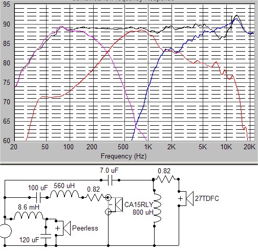

Hi Tinitus, thank you,
I think its safe to delete the Zobels altogether. ( Sreten's comment on page 23 applies here ).
Re: "Your lower end of mid is higher excactly at the frequency where tweeter and woofer crosses...", please excuse my ignorance, but is this (not) how it should be? grant
Omni. Hi!
Please feel free to correct me on anything if I'm wrong! (and there could be plenty of opportunities for that, lol!)
I was considering that (despite Sreten's valuable comment) a 2kHz tweeter xo was 'too low' in your case?
However ,see the attached. Its still '1st order on the mid' , no Zobels, and looks quite acceptable. What do you think? The Tweeter xo is around 2100 Hz , but it seems too low? As far as Q's go, as yet I have no idea,...so I don't know what the resultant 2nd-order-name is yet, lol.
(and of course Sretens comments apply) Sreten, could you help me out here please? grant

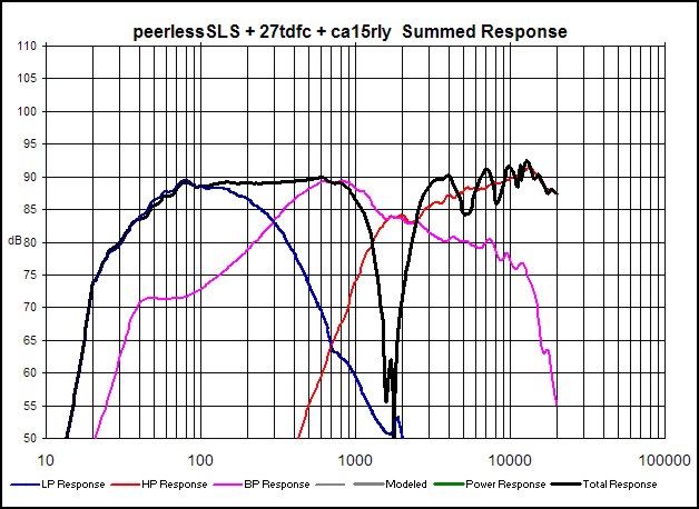

Grant, here's a graph of your latest figures put into the sim program I'm working in.................Pretty weird stuff....I can't figure it out.........Almost identical driver response curves per each driver, but the summed response is totally different................Respectfully.....Omni
the second graph indicates I presume relative reversed tweeter polarity.
Both of them indicate the CA15RCY is in a large box for a mid.
I'm not sure that the mids actual Fb and Qb are correct.
The graphs do show the relatively broad overlap of simple crossovers.
It fairly pointless tweaking the on-axis response to perfection.
The next thing to do is use 30 degree off axis responses and
recalculate drivers offsets for 30 degrees and rerun the sim for
vertical +/- 30 degrees.
If this looks good, also look at 30 horizontal (normal offsets).
The average of all three is more important than the first being flat.
🙂/sreten.

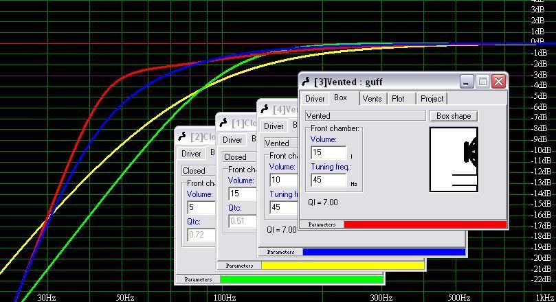

Sreten, Thank You for your reply............I used the same component values as Grant did and kept the polarity of all speakers the same as Grants schematic above in his post so everything is identical, except, of course, the summed response, Unless I did something wrong, however, I will double check it................Here's the story with the Midbass and my cabinet; Driver: SEAS CA15RLY, According to Vance Dickasons dissertation on mid cabinets, He recommends a non-parallel sided box. Did that. He recommends a box frequency of at least 2 octaves below crossover point. 300 Hz crossover point would yield a box frequency of 75Hz. Through intensive research through several sources, I found that a .5 Qtc was desirable or in that area {critically damped}.........So here's what I did, and what I have: I modelled the CA15RLY in WinISD using manufactures data, as well as Zaphs TS measurments, in addition to the data base in WinISD, so I used 3 sources to do various models. I came up with a 15 liter box rendering a box frequency of 73.3 Hz on average. The Qtc is in the range of .517 to .53. So it appears 15 liters meets the afformentioned criteria, so I designed and built the midbass cabinet to be 15 Liters, sealed, and expect for a Qtc in the low to mid .5's.................Here's the weird thing man.........Grant and I used the same FRD and ZMA files to do our models..............Beats the **** out of me.............I hope this information can be useful........................Respectfully..........Omni
Omni, I think yours and Grants last sim looks very much alike, looking at driver slopes - only yours actually show the phase problem which ought to be there, looking at slopes between mid and tweeter
To me it seems you are close, but it needs a bit adjustment - upper crossoverpoint is too low
Hmmm........
so you end up with a midrange volume higher than most would use for using the driver for bass also.
Its what you get for taking technical wafffle too seriously and too literally.
I wouldn't call it extensive "research", I'd call it extensive "misinformation".
Sadly all too easy to find once you start looking for it.
🙂/sreten.
Sreten, Thank you for taking the time to model the CA in WinISD. It definately shows different response curves for the given volumes.........1 : Being that I am using it as a midbass for my bandpass at 300Hz and above; Is the response below 300 important to my scenario, being that all four graphs converge to identical responses at 300Hz and above ? And if so, How?....2: I am astounded that sources such as Vance Dickason, Dick Olsher, and Lynn Olson may be considered misinformers.....Maybe it's my naivete....I don't know, man, I have studied their works extensively and they all have solid reputations.......3 : Is a .5Q box NOT advisable for a midbass in the 300Hz to 3000 Hz range ?....and if so, are you recommending the values on the graph you posted OR do you have a different recommendation ? 4 : That fact that the midbass cabinet is currently 15 Liters does not preclude the idea that I have the option of making it smaller, which was one of my considerations when I designed it. If so, what volume would you choose, bearing in mind that it's a sealed cabinet? Like I said before, I am grateful of the time and interest you have put into Grants' and my project, and I look forward to your continued input and support.................Tinitus, Hey man, I have been playing with your resistor on parallel components concept, and have gotten some neat preliminary stuff......Heres the deal,..... and my observations. I put a 2 ohm resistor in series with the shunt capacitor on the highpass section of the midbass, and it seemed to "round out" the response curve, shaping it into a smooth, rounded curve, almost completely tracing over my target curve. { Bessel Alignment is the Target Alignment I have chosen }. That seems like pretty cool stuff.............Is this "rounding out", so to speak, the desirable phenomenon you have been advocating..........Unfortunately, I haven't had the time to really sink my teeth into this, however, it's slowly in the works.........Grant, this crossover simulation stuff has been quite absorbing, and the amount of work you have put in is quite respectable...........I'll bet that by the time you get your boxes done, they will sound incredible..........At any rate, I gotta get back to yhe sims............................Respectfully...........Omni
