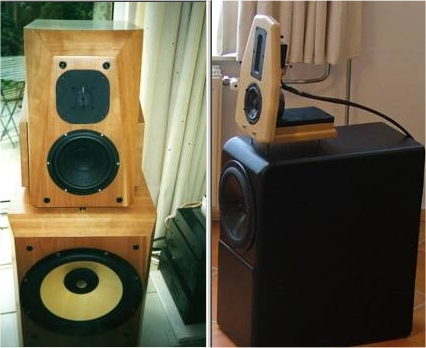

It turns out that I probably will have to place M/T's in separate boxes on top of the existing boxes. I'm wondering about the relative merits of say 4-5? Litre closed MT boxes versus infinite baffles.
Also trying to find in Dickason relevant infinite baffle formulae. If say, my bass/mid xo-point is about 300Hz, I'm wondering what would be the minimum allowable baffle size for this frequency?
I've attached 2 Tony Gee designs, Andromeda left, Modulus I.Baffle right. The infinite baffle looks really small to me? I thought it would have had to be much larger? So I'm thinking of a kind of hybridised TroelsG/ TonyG design with a P25 - haha! could work?......Thanks Sreten!...grant

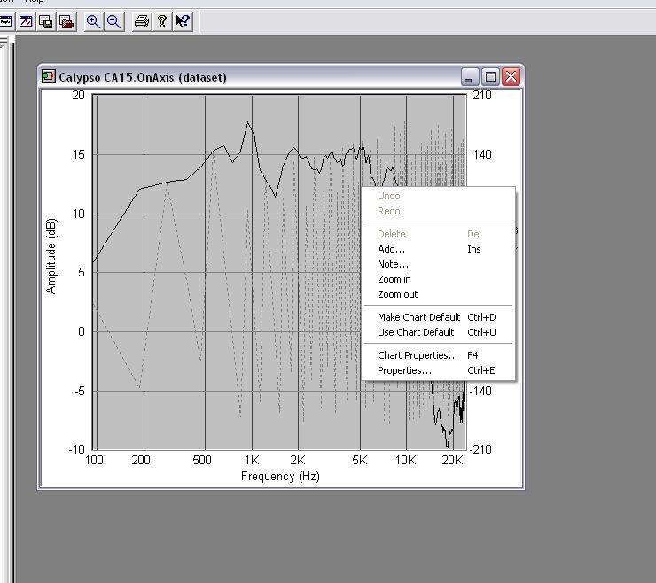

Look at the Calypspo files e.g. Calypso CA15.Onaxis (dataset).
The graph shows acoustic amplitude and acoustic phase.
zma shows electrical impedance Z and electrical phase.
Orthogonal = all angles 90 degrees,
i.e. the point on a plane nearest to a point in free space.
The Modulus is a highly idiosyncratic design for a particular case.
Following it would likely lead to mistakes due to wrong assumptions.
Open baffle midranges are whole new can of worms.
And much more difficult to simulate.
I'd use a Neo3 tweeter in dipole mode rather than a dome tweeter.
Troels Point 75 design would be a place to start.

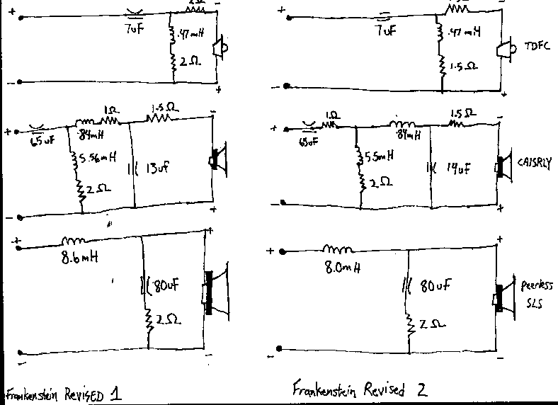

Tinitus, I am very sorry if my last post sounded harsh to you, as it was definately not intended to be. I have a high regard and respect for you and am definately in no position to talk "down" to you. I would never do that. If anything, as I reread my post, I would say that it had an air of impatience, for which I am profoundly sorry..........At any rate, I will be posting those graphs I spoke of, later tonite, And I hope you all, will give your assessments and interpretations upon viewing them..........Grant, I am running Windows XP Home version.......When you downloaded SPL Trace, did you get all 3 parts, as a new installation requires these............The DLL file you mention, I thought, came with the download, but I am not certain. I did not experience the squashing problems or problems with the Trace, and arrows, so I am sorry that I cannot give you more input........Maybe you can E mail Roman with these issues, as he was very gracious in dealing with my learning curve in all the FRC programs............I will be in touch....Respectfully............Omni
Here are a few revised xover diagrams from the last one I posted...........Tinitus: I am taking your advice about using standard value components, and what is here shows a few of those. I will finetune to standard values after I get some direction, hopefully from responses to this post..............Note the difference in the Woofer inductors.............Response graphs will be posted following this one. Any and all comments and advice is welcome, as I believe I am getting closer................Respectfully.........Omni

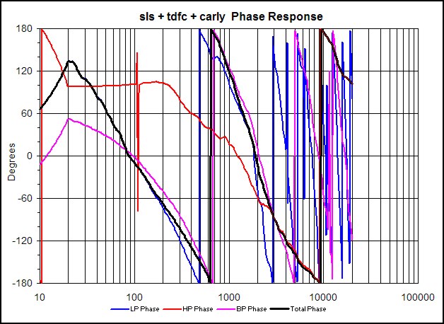

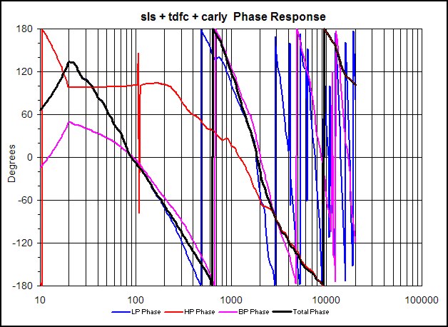

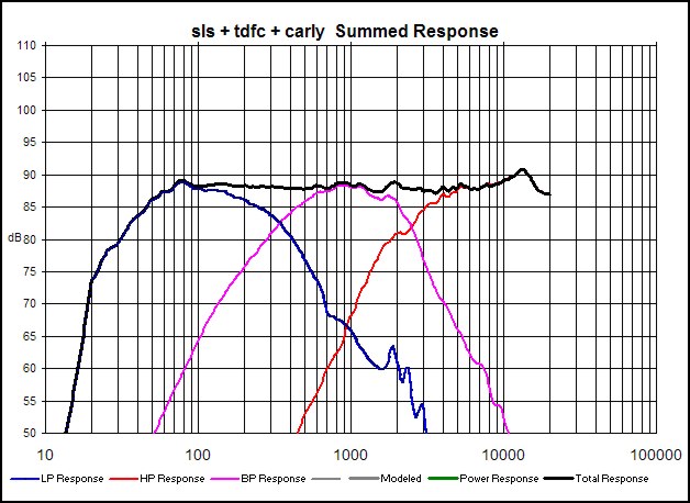

Here is a graph for the summed phase response, which also includes the responses for the individual drivers..............Please give me comments on this, as I do not know what to look for in a good phase response, and I cannot interpret this due to my lack of knowledge................This one is for Frankenstein revised 1

Omni,
the revised 2 xo and response look good! Not sure about the phase though. Sreten posted a graph on page 38 which indicates the
electrical phase should be less than +-45degrees where the impedance is low. I hope this is correct. Does your program offer this type of phase chart? Sreten's comments on this began on page 32 I think. I hope this helps... grant
Acoustic phase and electrical phase are completely different things.
Electrically 90 degrees = a pure inductive or capacative load = maximum.
Acoustically its is completely different due the absolute phase
information also representing path lengths and the relative phase
information used for intraction of drivers.
To check you have "good " phase in a 3 way crossover generally
you reverse the phase of the mid unit. How big the dips are at
the crossover points tell you how well phase normally tracks.
In the diagram below the phase wrapping and huge total phase
angles are due to the phase representing distance, and as frequency
goes up a number of degrees of phase represents shorter and
shorter distances.
So a delay / offset of 0.3ms / 10cm has an absolute phase angle of
36 degrees at 340Hz, 360 degrees at 3.4khz and 3,600 degrees at
34kHz. The relative phase is 36, 0 and 0.
(wavelength of 1Hz = 340m, 340Hz = 1m, velocity = 340m/s.)
🙂/sreten.

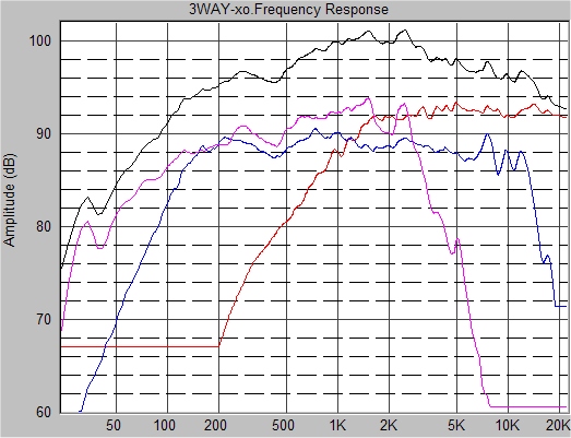

(Btw, I finally got the SPLTrace prog working, the RAW manufs. data is attached - NO crossover yet) Many thanks Omni for your huge effort with the MCA15RCY files!). It looks like this 'beast' might have a 90dB? SPL after xo, as long as the 50Hz SPL P25 response in my box is ok?
If my new MCA15's don't fit into the existing holes, then it looks like M/T in separate boxes on top! Thanks Lots! grant
