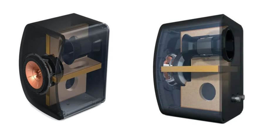

Probably not. Most metamaterial absorbers are a one-way street. Basically a complex version of a sealed transmission line.
The KEF LS50 has foam in it's port.

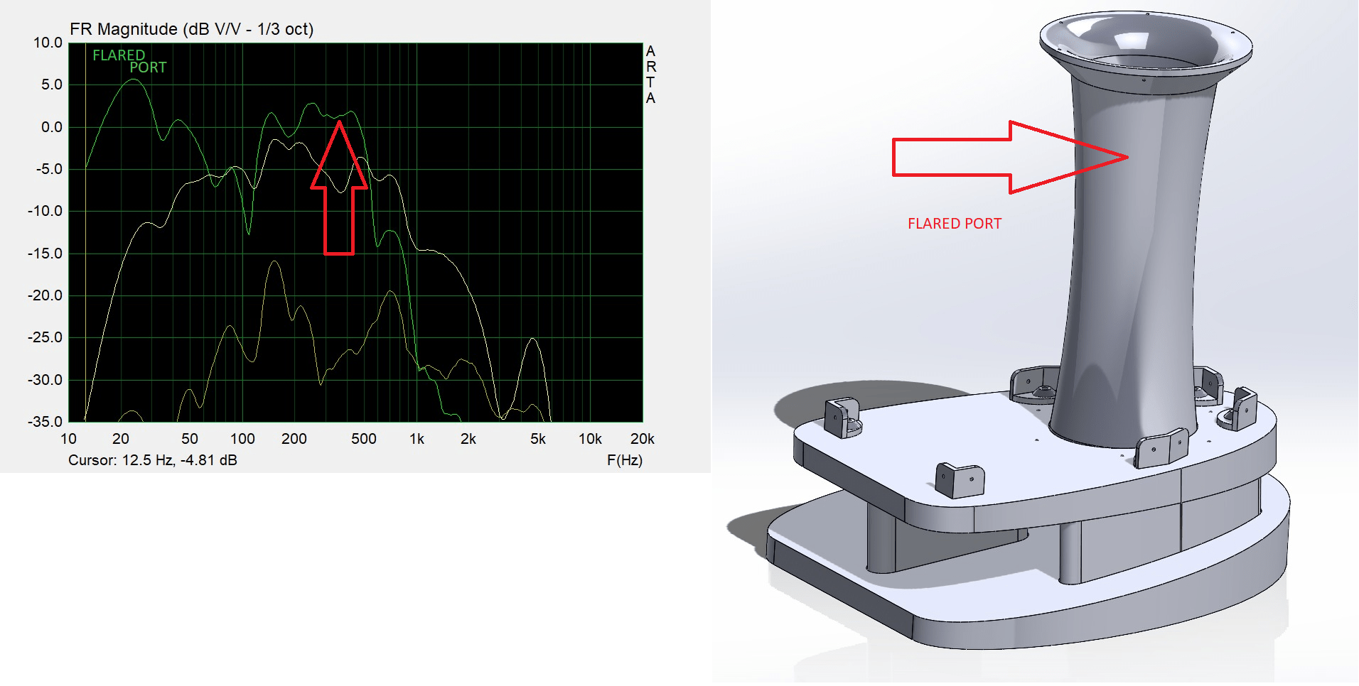

Augerpro tested some port resonators, didn't work too well if I remember. However holes to relieve pressure nodes of port pipe harmonics work somewhat. Augerpro commented that some kind of chamber around the port to relieve to worked better (distortionwise) than just venting back to the main enclosure, with some damping material of course. That solution might also have some resonator thing going on.
For closed bass/mid enclosure this might work though, quarterwave resonators on the long ends damping modes that fall into pass band. Similar design like for the tweeter but perhaps only few chambers needed for those few lowest and problematic modes who fall on the pass band. One would have to care about impedance match, perhaps bigger box results etc. Perhaps just too complicated solution for most situations. Nice for tweeters apparently, but not sure if long wavelengths need this solution as there is possibility to crossover to smaller driver and box before issues, except with the tweeter.

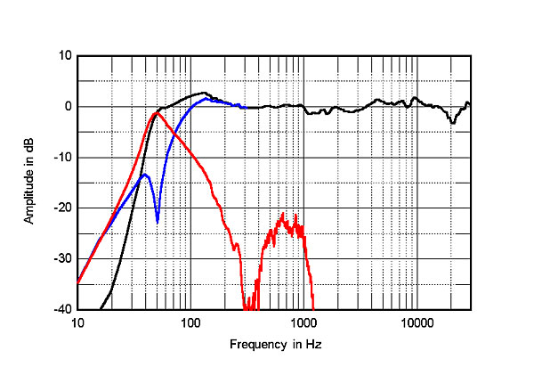

This is the LS50 meta: https://www.stereophile.com/content/kef-ls50-meta-loudspeaker-measurements

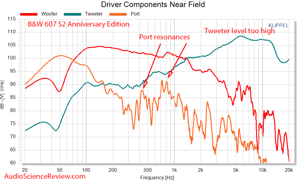

Port output above tune does appear reduced compared to simlar speakers with 'standard' port designs: ( https://www.audiosciencereview.com/...kins-607-s2-anniversary-edition-review.21597/ )

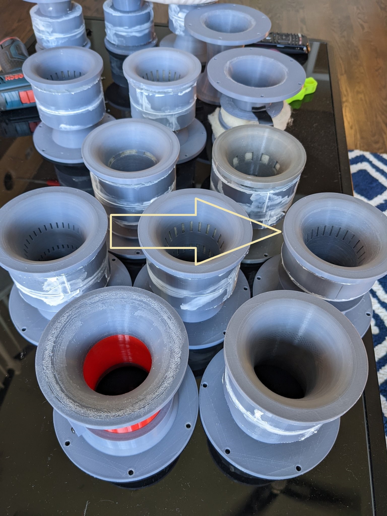

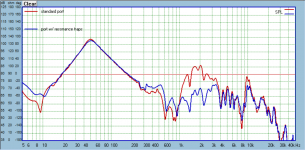

What did not work very well is any damping material in the port, a resonator in the center of the port as by Polk, or my attempts at duplicating a Kef. I think the foam I used was pretty similar to theirs, but I wasn't too impressed. Here were the first results of port testing: https://www.diyaudio.com/community/...s-shootout-thread.356130/page-12#post-6411676 And the full journey: https://www.somasonus.net/box-construction-methods
The Kef style port had the lowest amount of output above 1khz. Admittedly, the difference is about 1-5dB but it's something.
I suppose so, resonant traps placed at 1/2 and 1/4 wavelength. I did try a chamber depth equal to 1/4 wavelength as he mentions, and is common in these sorts of traps, but it wasn't all that different in performance. Although my traps were pretty close to 1/4 wavelength already. I'm doing final checks right now, and that will include printing a larger port and see how things scale, chamber depth being one thing I need to focus on.
Once I finalize the design, I'll be posting the F360 file with instructions on how to use it so anyone, can do this for themselves.
