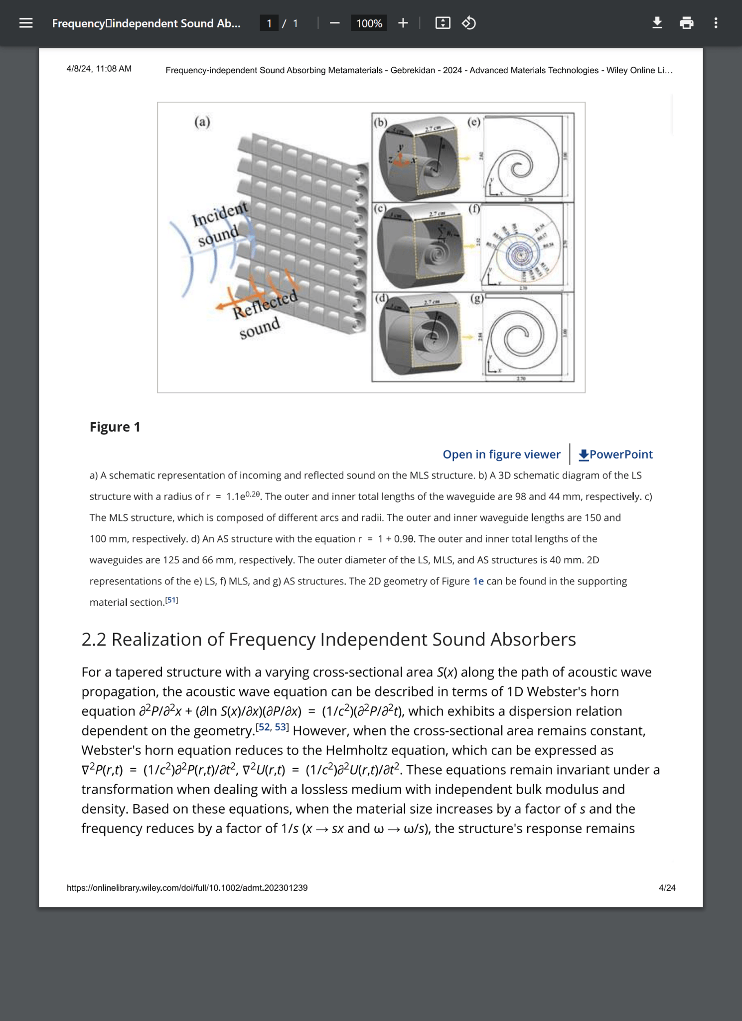

You can't make it that short.
5khz is 6.8cm long and one quarter wavelength of that is 1.7cm
The wavefront from the back of the tweeter has to travel through the pole piece, which means that even if the metamaterial absorber is really really short, it's still not going to work at 5khz to any significant extent
More importantly, I'd argue the main purpose of the absorber is to reduce the magnitude of the impedance peak. That's down around 500Hz, so there's no real reason to try and make the absorber work at 5khz, it won't be accomplishing anything
I figured this out the hard way when I made an absorber for a planar tweeter and it did absolutely nothing. It literally measured no different than the back cup you get from Parts Express
Realized that it did nothing because there's no impedance peak to dampen.
I'd speculate that it's possible that the "clean" sound of ribbons and planars may be attributable to their lack of impedance peak. If true, then one could "tame" poorly behaved drivers (like compression drivers) with an absorber
Also, I'm really curious if the sealed transmission line works as well. It's much much bigger but certainly easier to calculate and design. Those absorbers that I published and printed were quite a p.i.t.a. to design. Not trying to brag here, but I've been building speakers in 3D for almost ten years now, and those absorbers were a struggle for me. I can make a conventional waveguide in literally ten minutes, I got that down to a science, but those absorbers are gnarly. I had some designs that I abandoned after 20+ hours of sitting glued to the computer.

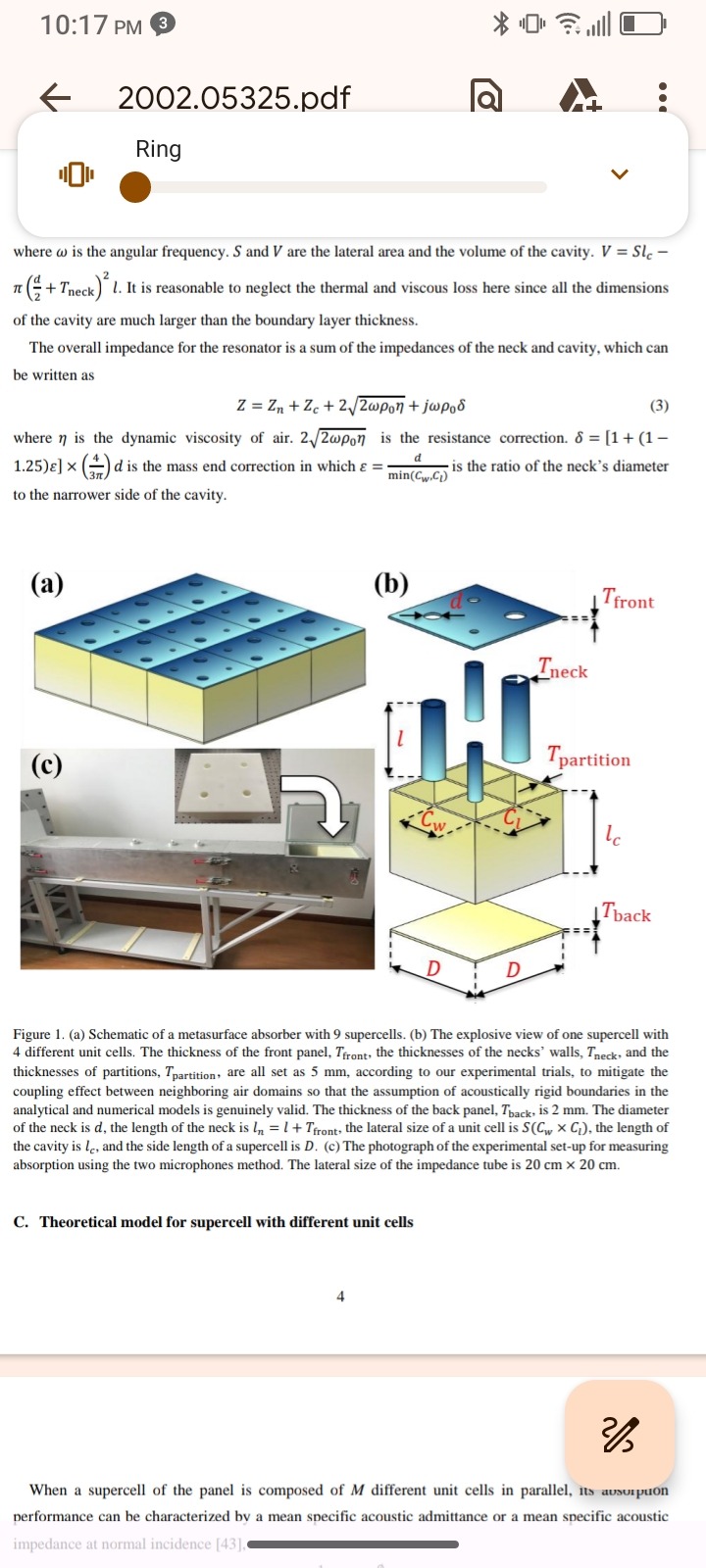

it seem a critical aspect of the kef plate is the waveguide in front of it
This is an interesting way of integrating the guide with the channel
This one seems potentially doable. Plus I think there might be enough info to create their 1 octave example 50-100hz
. Credit https://www.semanticscholar.org/pap...i-Li/47df6d471882ea5efddd4367cc06488eff385ccc

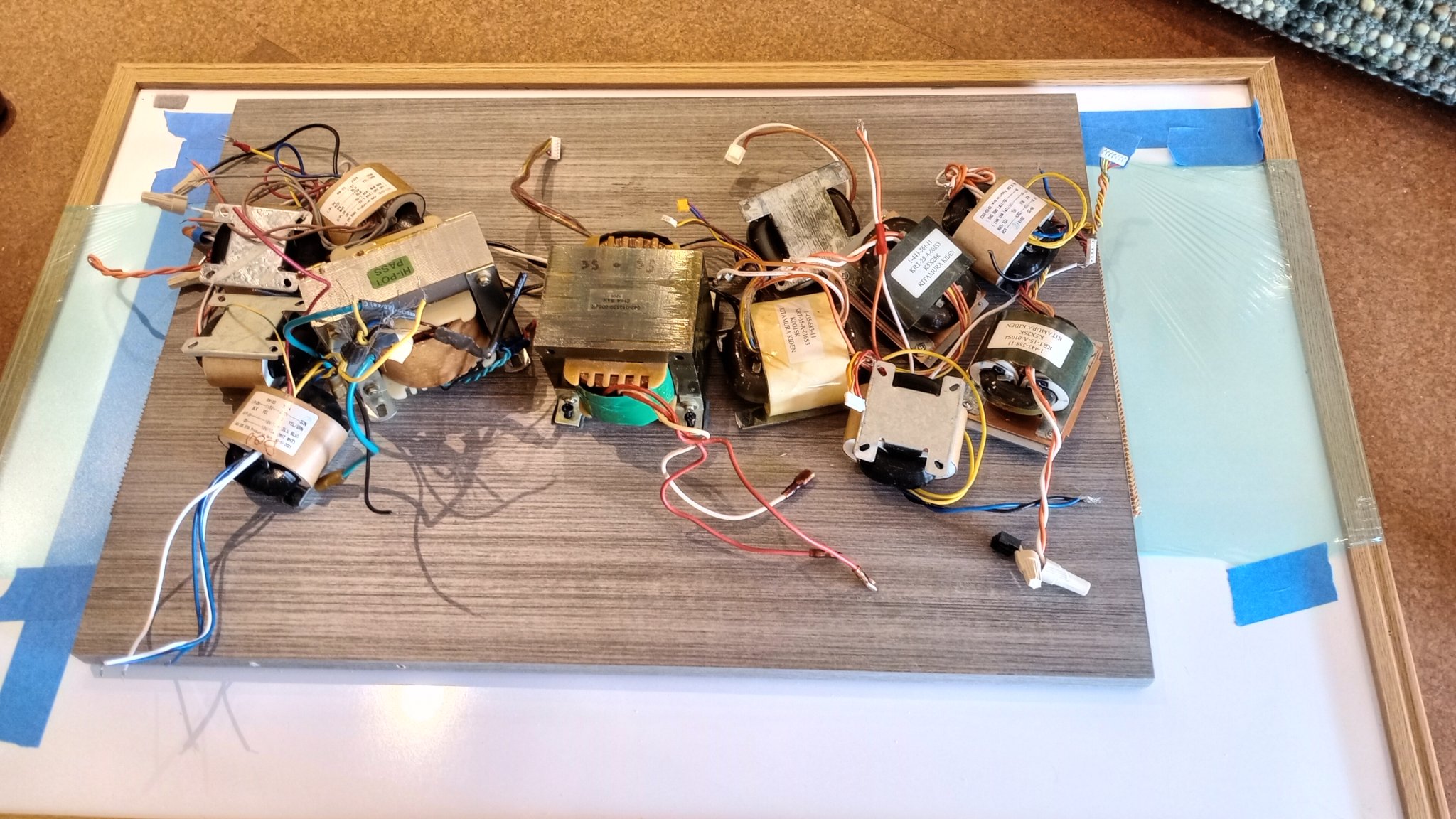

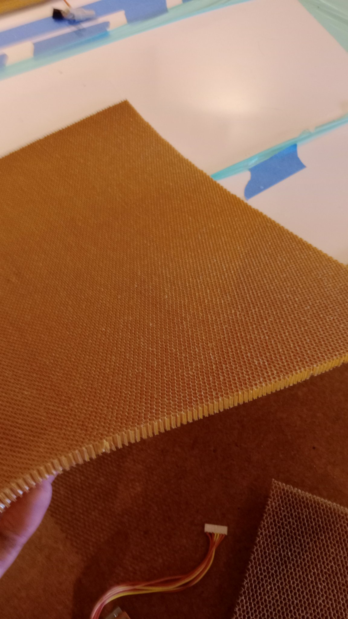

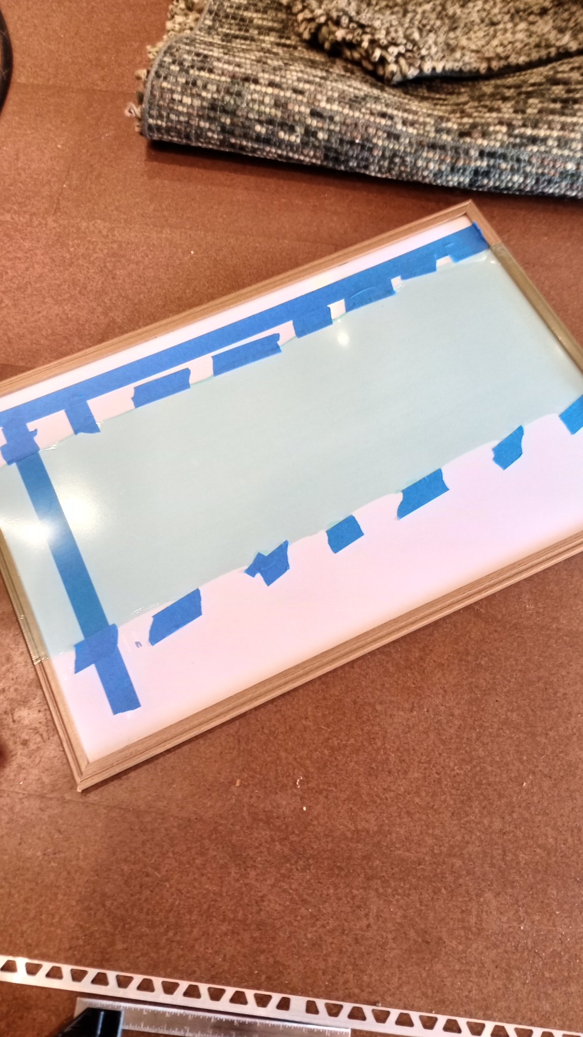

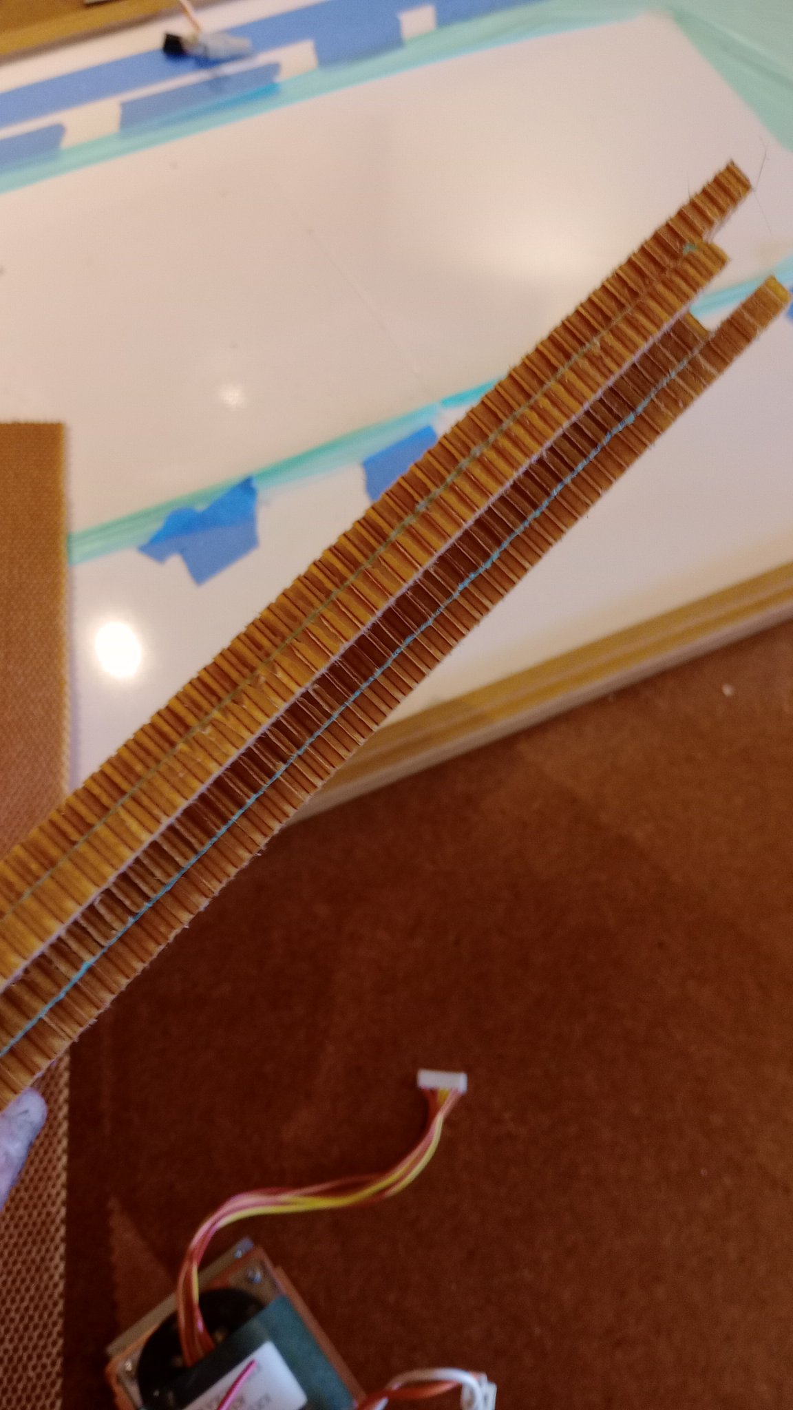

Living in Boeing town allows for cool composites to be found on offerup.

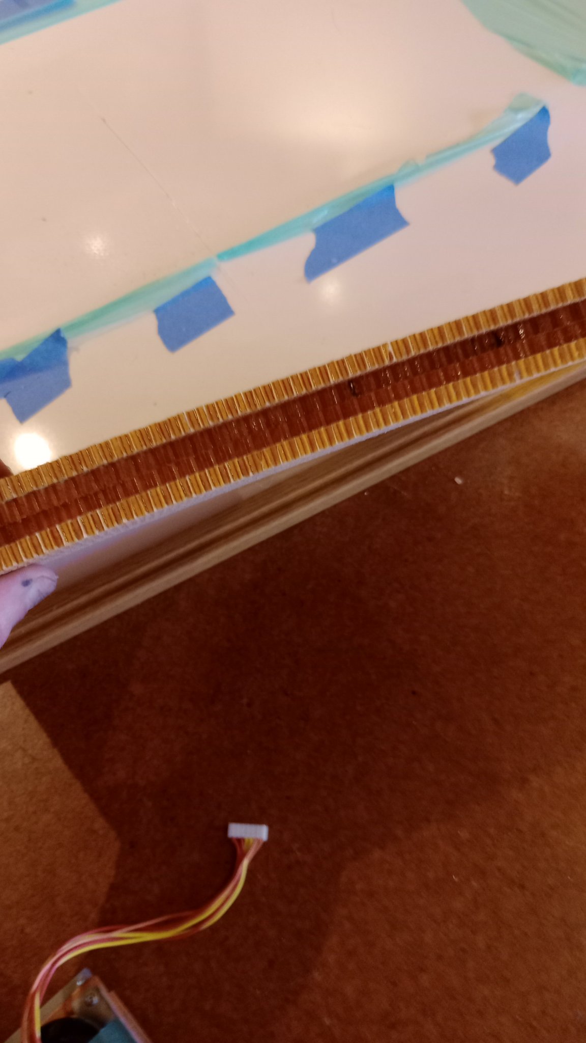

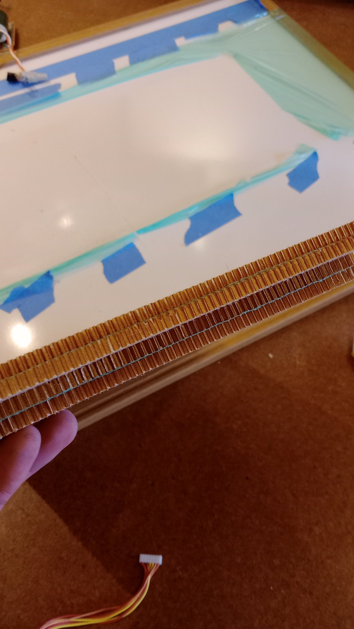

A quick prototype made with kitchen plastic wrap using the esl tensioning method. The honeycomb is 1/4 nomex
The study above used carbon fiber for the rigid material on either side but once I find a cheap to free fire safe material I will try enclosing.
