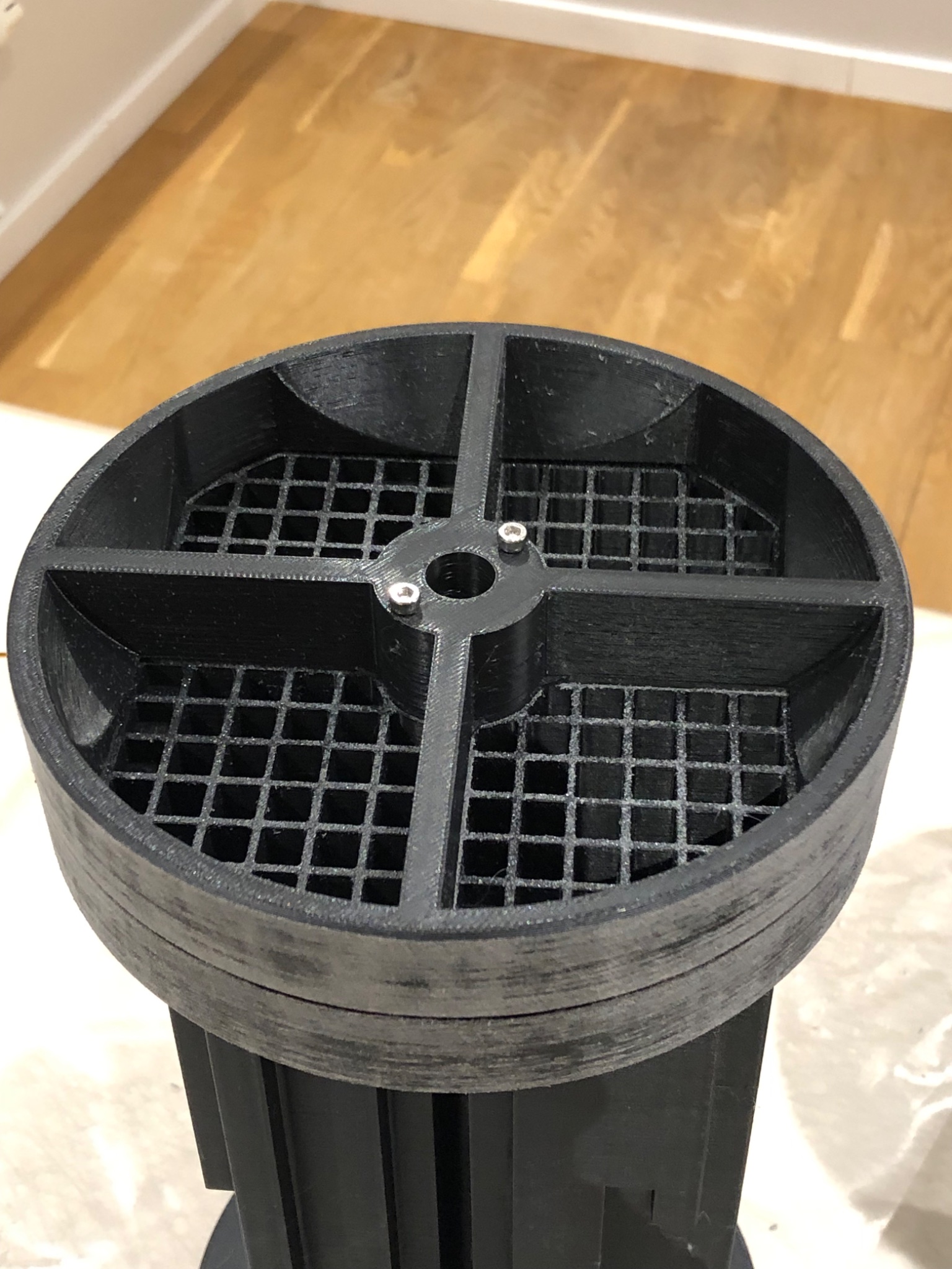

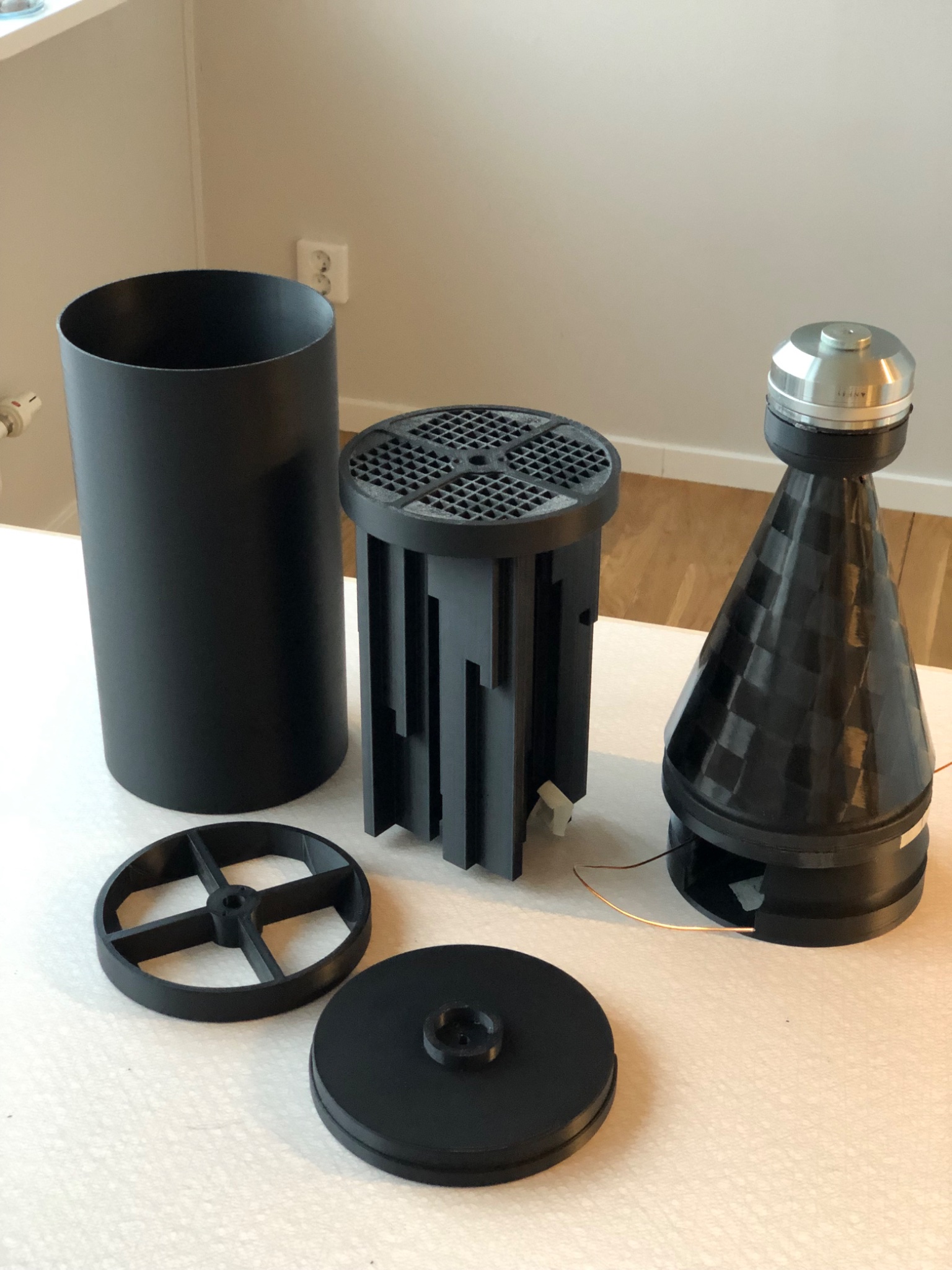

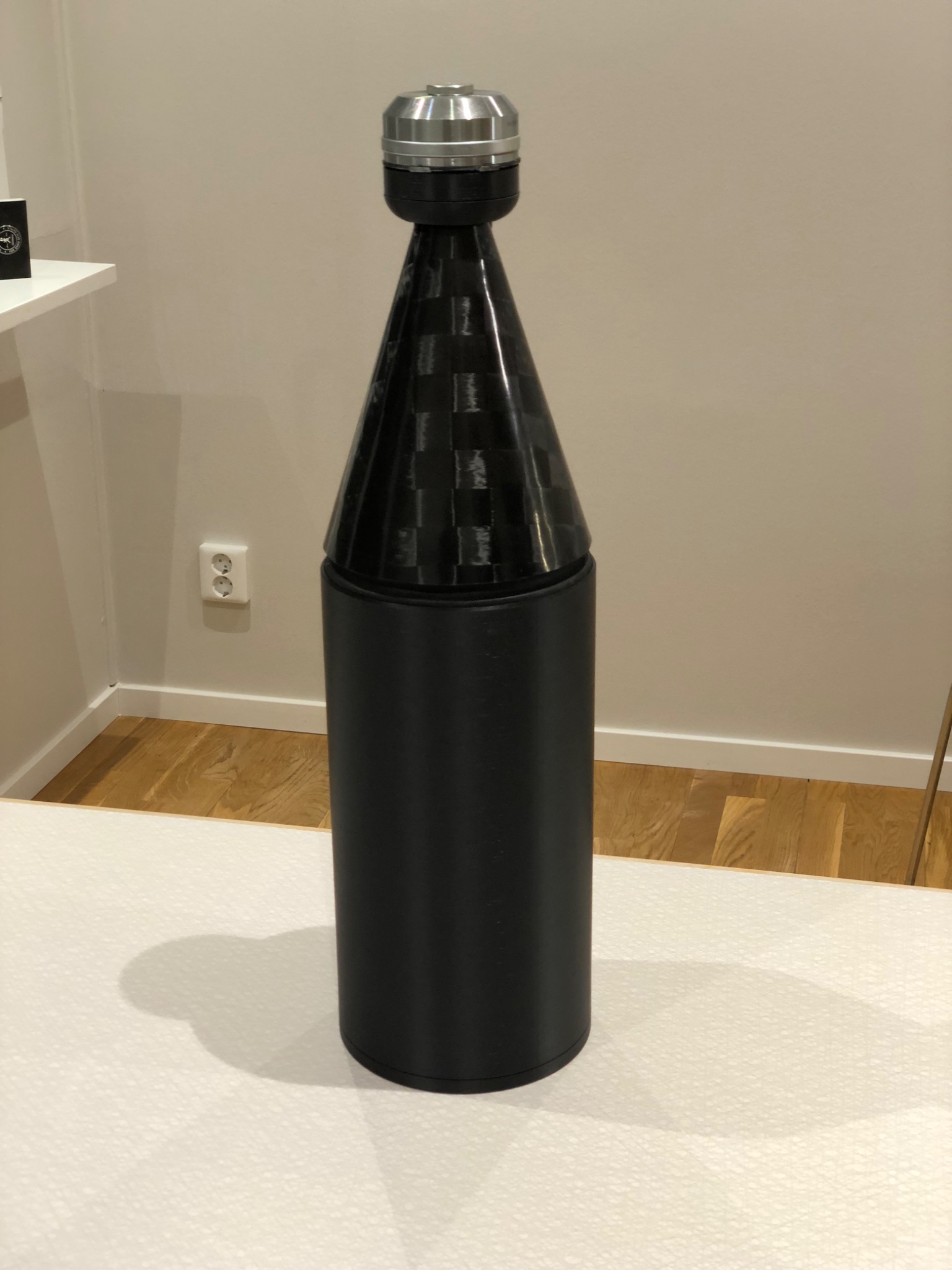

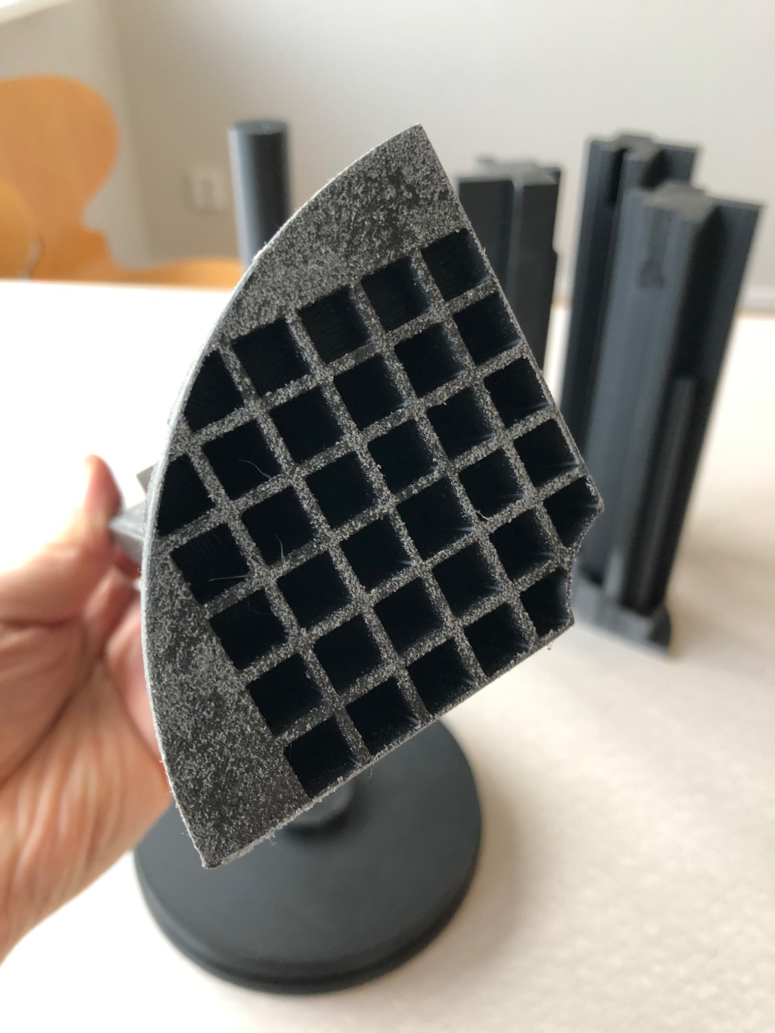

They are designed to cover 150 to 20000 using 36 tubes times 4 in total 144 tubes . The heght of the absorber is 230mm. I’m using a 20 mm melamine foam between the absorber and driver.The absorber is 3D printed in pla. A bit of an effort to draw the design in fusion…
I have tried 3 versions of ”boxes” to my Walsh speakers closed box, tapered horn according to Terman/b&w nautilus patents and now also metamaterial-
The closed box creates a heavily box colouration of the sound.
The tapered horn is almost clean with some minor colouration.
The metamaterial is really clean with no noticable colouration.
Thomas

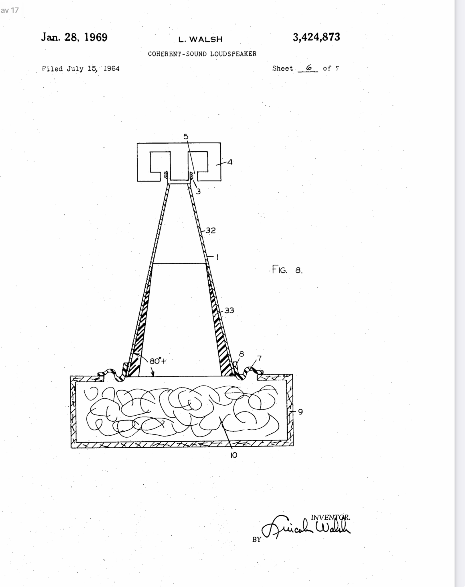

No, it’s a Walsh driver.You did a crazy job, I do understand that it’s an horn ?
https://patents.google.com/patent/US3424873A/en
Which is a bending wave speaker.
It has been a long struggle to find a solution to the ”box” that doesn’t colour the sound.

Hej,Cool project! Can you share some measurements of the driver pls?
Yes I will share some new measurements. I'm preparing to do measurements of three versions of the "box".
1) closed box with damping material
2) reversed exponential horn similar to B&W nautilus
3) metamaterial
This will give me the opprtunity to compare the three solutions.
Thomas
